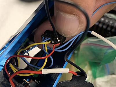

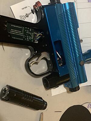

    Wiring diagram really helped! Thank you Opus!!! I was nervous about which wires went to each side of the solenoid, not sure if it matters. I work in a speaker factory, so in speakers - reversing polarity is a bad thing- things move backwards- not sure if it's the same for solenoids but regardless followed the diagram. The ground wire for my power switch pulled out at some point and the pin was still in the harness- instead of fishing the pin out with a pick I stripped the wire a few mm long and flooded it with solder. Gotta do that operation quick because you can melt your harness. All in all it looks good- gonna fish around work for a 9 volt and test this puppy out in a bit.

      plugged a 9v from my workbench at work into the frame on my lunch break and it was dead in the water. took a voltmeter to the 9v and its the culprit! Charging it now to test when i leave work today.

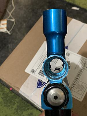

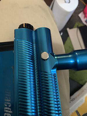

        How critical is it to drill the second detent in there? I got tools together to do that today if it's necessary
        • Myrkul
          Myrkul commented
          OpusX doesn't dual detent his and hasn't reported any issues yet. I always dual detent mine, but that's only because I always have since like 2010....

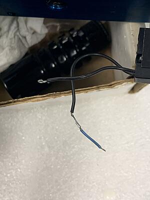

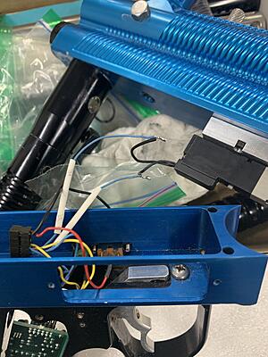

        should I be hearing the solenoid click when I pull the trigger? I can't remember what marker I use to fire without air and I would hear the noid click- maybe this ones really quiet?

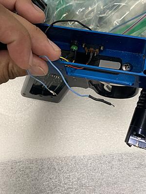

          Ok- noid isn't clicking- so it might be dead- anyone have any ideas how I should suss that out? 9 v directly to solenoid wires?
          • Myrkul
            Myrkul commented
            I wouldn't do that. I don't think it would really damage the noid (I could be wrong), but it's just an extra step that really isn't necessary. There is a 99.9% chance it's something else that broke free on the harness. Noid failures are almost always cracks like I encountered in my Lachesis thread, or ONCE I had a noid that had been exclusively run at 24 BPS auto-response mode, and it was used heavily and hard by a regular tournament player before it made it's way to me. (I'd like to see someone attempt that firing mode in todays tournaments) That noid still "kinda" worked to, but was starting to fail from too much heat generation and needed 350 PSI to hit field velocity. Those are the only two kinds of noid failures I've personally seen.

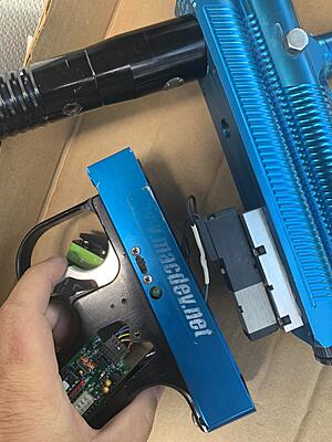

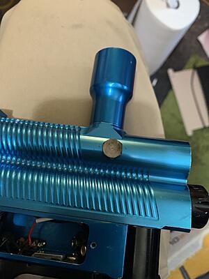

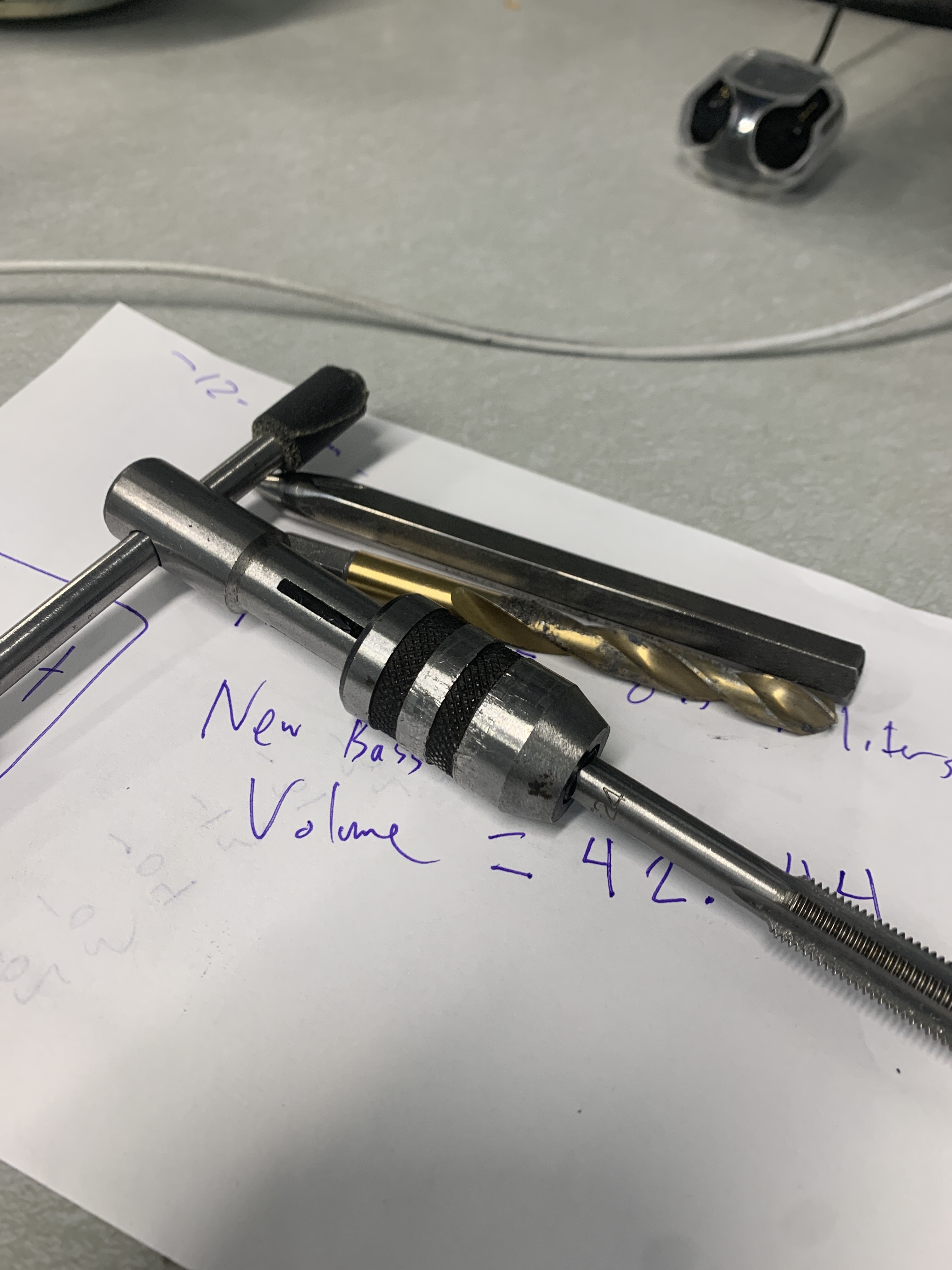

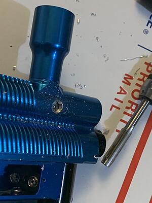

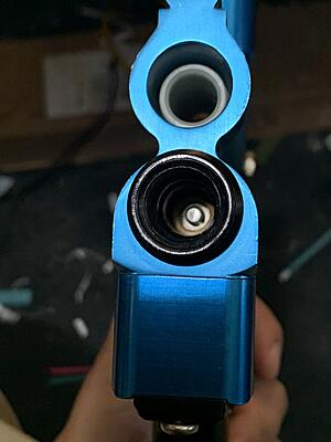

          No drill press, but I was able to drill and tap that second ball detent in there. Used some calipers to mark a spot- punched a hole- went small drip but first and then the pilot drill bit and then tapped!! This puppy's gonna love the Rotor
          This gallery has 4 photos.
          • Myrkul
            Myrkul commented
            Hell ya!!!
            This is the way!!!

          Let's not forget to throw this #11 O-ring onto the rear side of the ram. Gonna follow that Myrkuls page! I have some quad- rings coming also!

            Thanks Myrkul! I will go over my wiring harness again and check to see what it could be

              Work is starting to get busy so i broke down this morning and ordered a new wiring harness from Vaporworks.

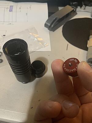

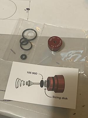

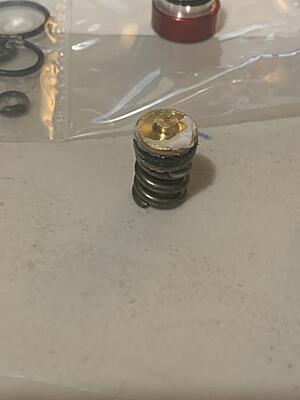

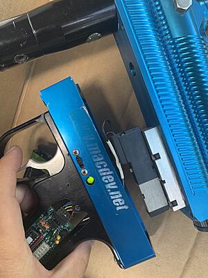

                  Just threw in the docfire macdev gladiator upgrade!!! Very mellow install- I think dad tried to service this regulator before giving it to me- super clean inside and the bottom of the gladiator came right off
                  • Myrkul
                    Myrkul commented
                    It makes a lot of sense that your dad tried to service it. B2Ks are WILDLY sensitive to the regs being dial in EXACTLY. These are not like modern guns where the reg is just a scale that controls velocity. On these, it's a balancing act. The HPR pressure has to be X, the LPR has to be Y, your valve spring has to be Z, and the ram itself has to be polished and have the stock spring. All three of those variables have maybe 5-15 PSI varaiablity per gun, but you really don't have a ton of wiggle room if you actually want this thing to perform. These regs were THE BEST when they worked, the main issue is eventually the delrin seat would eventually always fail from dirty air fills, it would just eventually get scratched and it was inevitable. Once they were scratched, the reg was done. When they are dialed in though....God they were THEBOMB.COM. The doc fire kit fixes every single problem with them, and pretty effectively turns them into a lifetime repairable part. That and they just feel "right" in only the way a 20+ year old upgrade feels right on a 20+ year old gun can.
