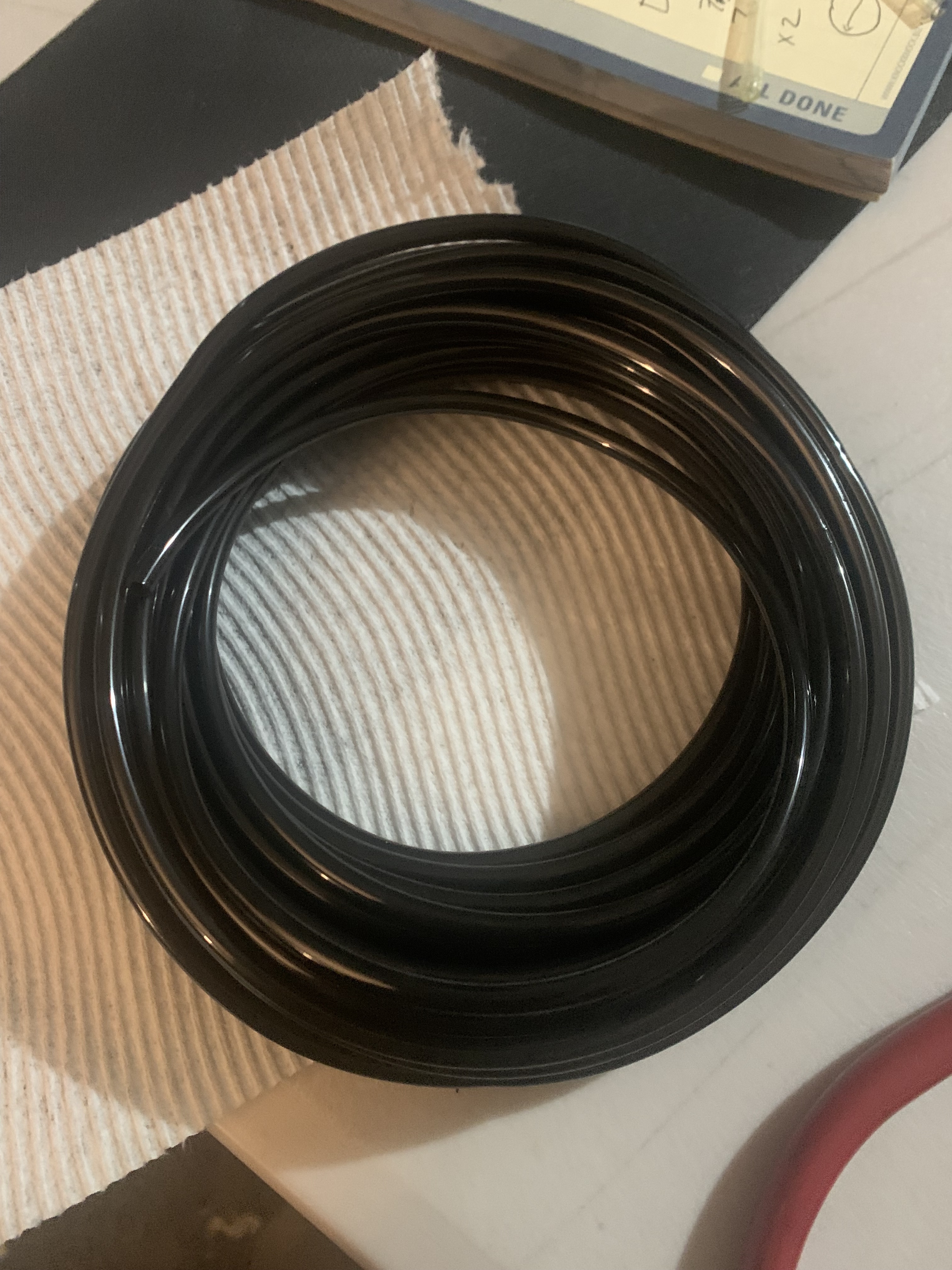

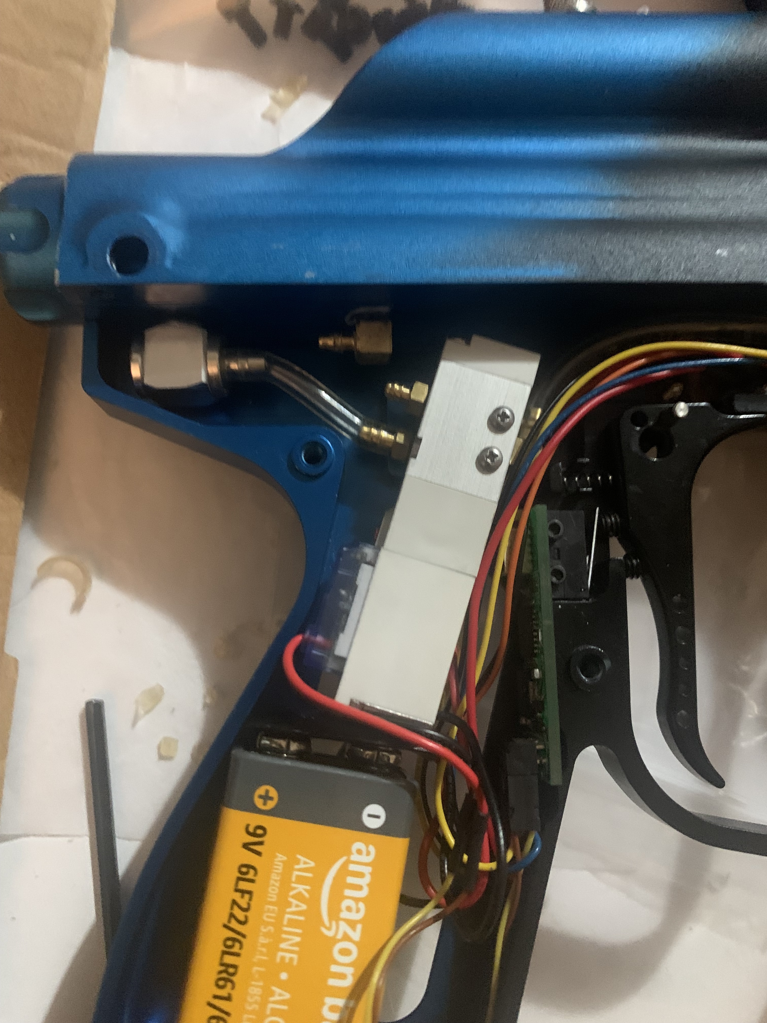

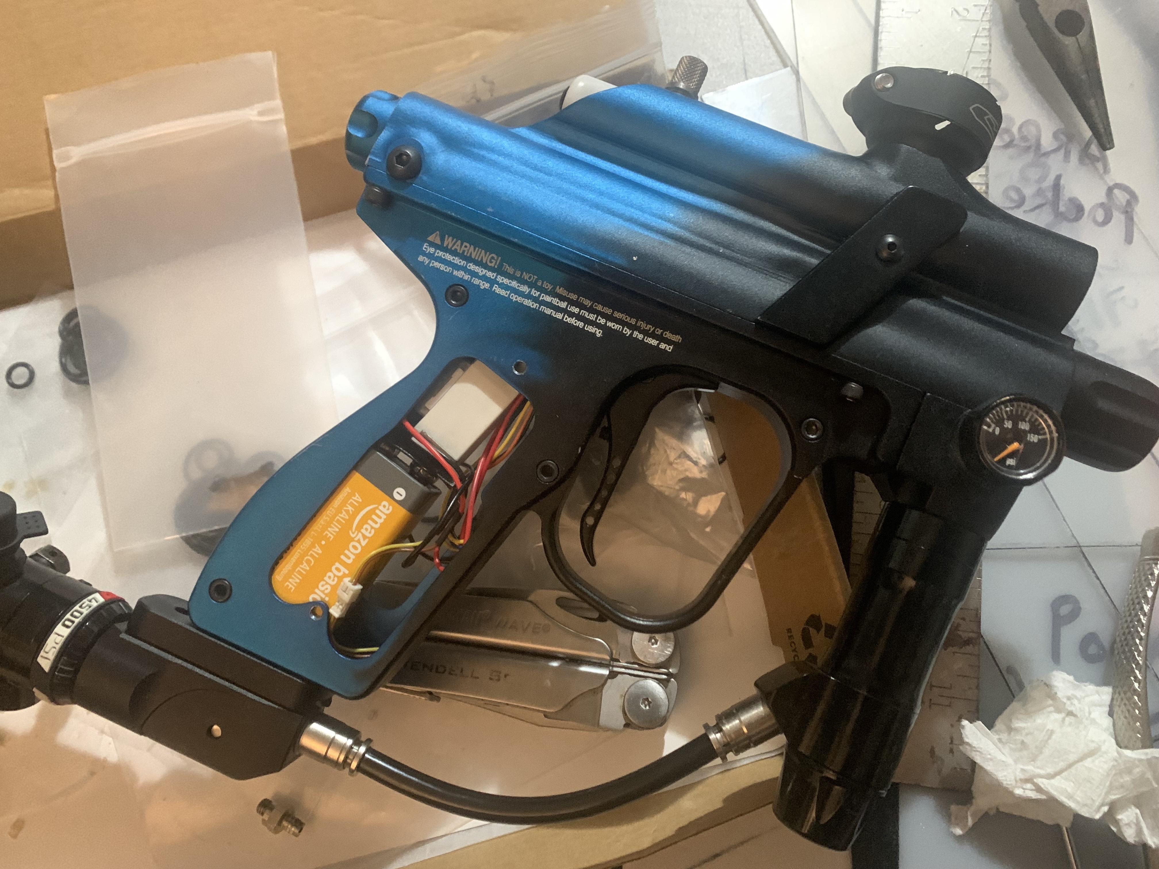

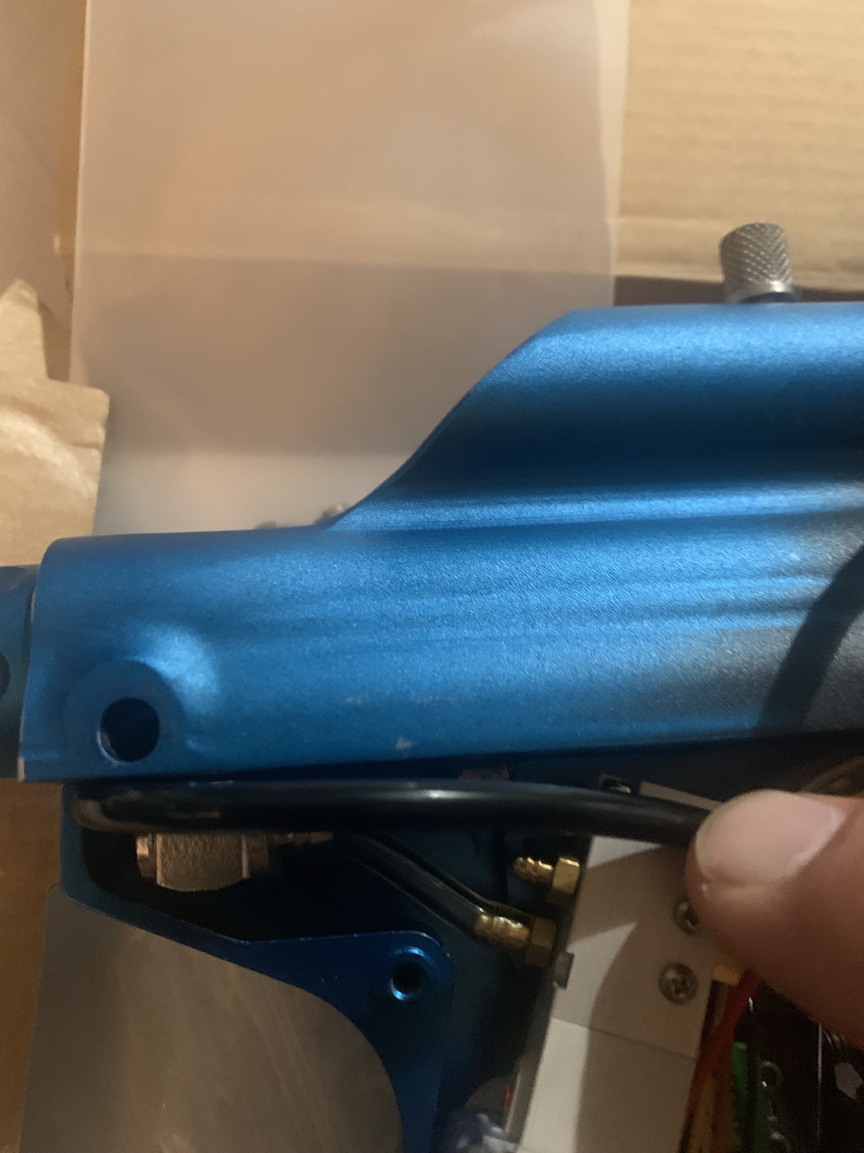

$10 buys you all the hose you can dream of from Amazon!!! I have extra if any of you guys need any! So I cut the hose a little long in hopes of not stressing the fittings. What I found is when increasing the LPR pressure you will find out where the hose needs to be straightened out. My little extra loop needed the grip panel to push on the hose- which is janky but hey! No leaks!! Marker cycles now!! My LPR gauge is still dead but I plan to just plug it with a stud.
