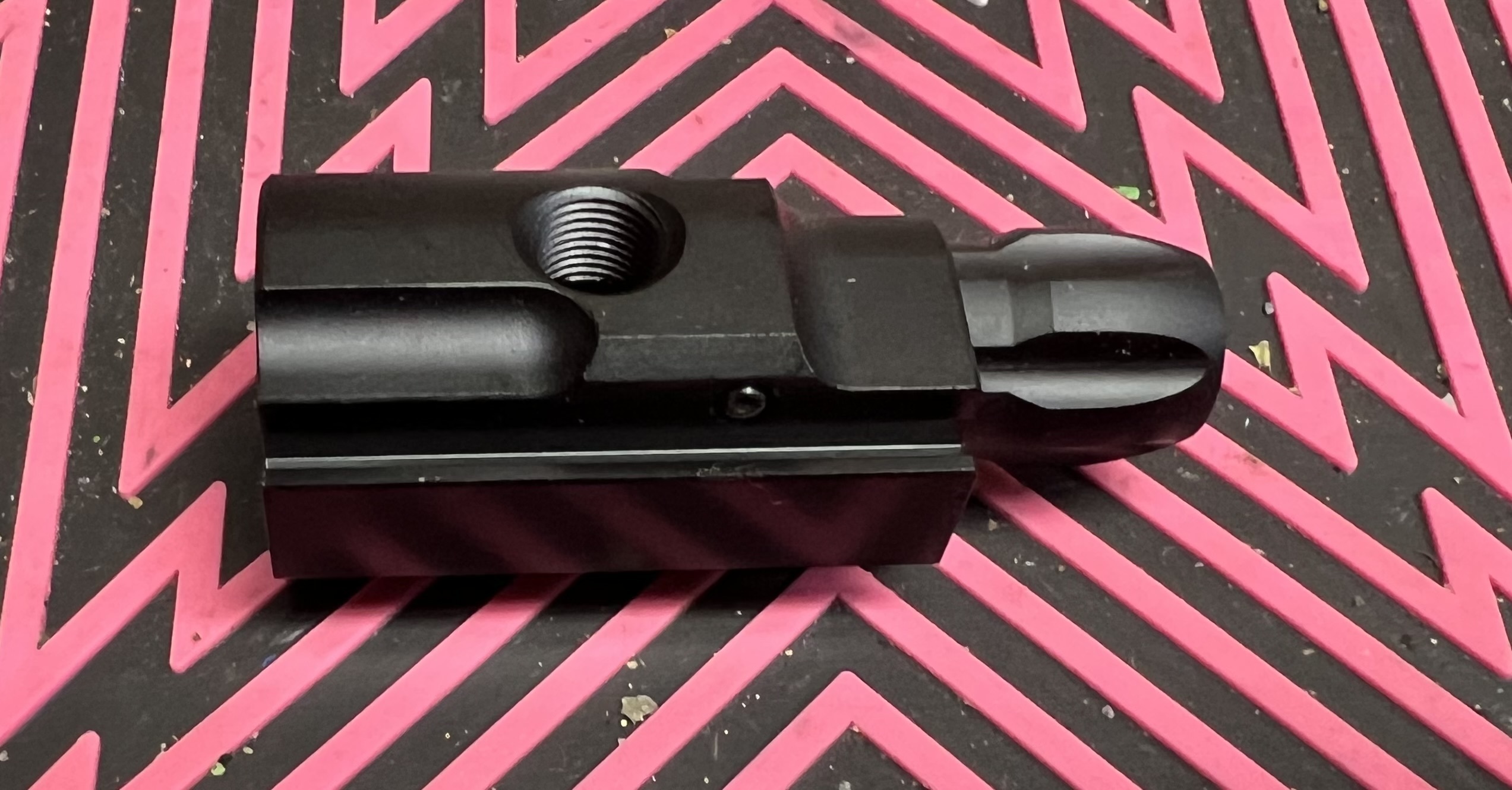

    And here is the body sans guts:

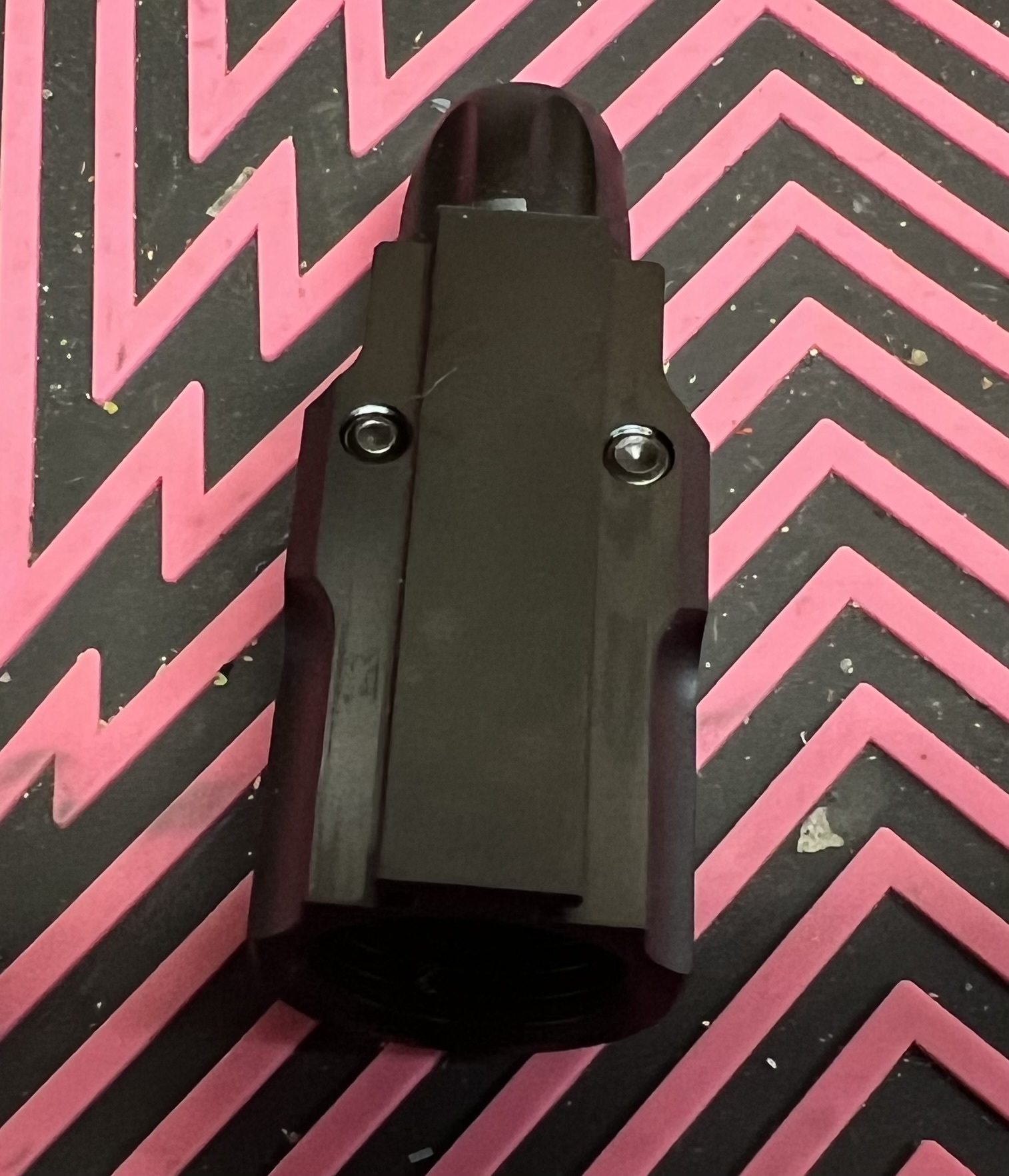

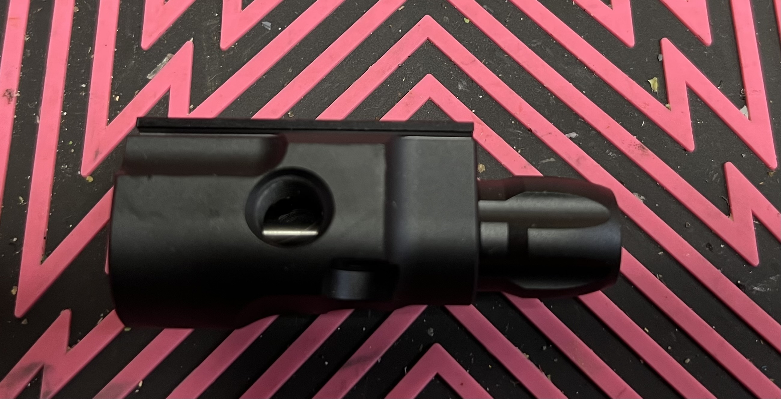

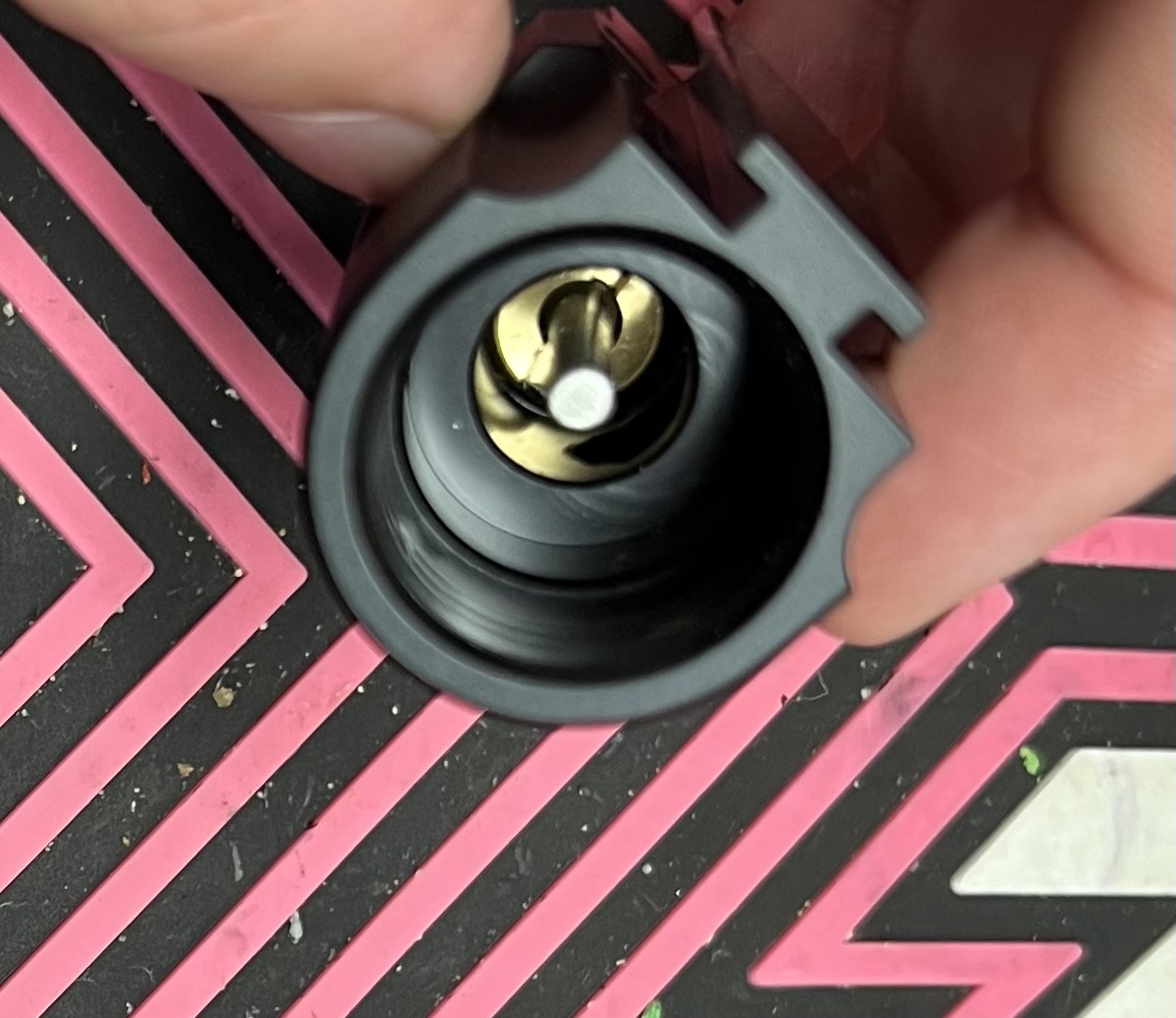

      And because I had removed it at the start, here is the ASA On/Off.
ID:	582022 Click image for larger version
ID:	582023 Click image for larger version
ID:	582024 Click image for larger version
ID:	582025 Click image for larger version
      My marker didn’t come with fitting but it does have an ASA plug. Happy I can get the side the macro is on as I shoot left handed.

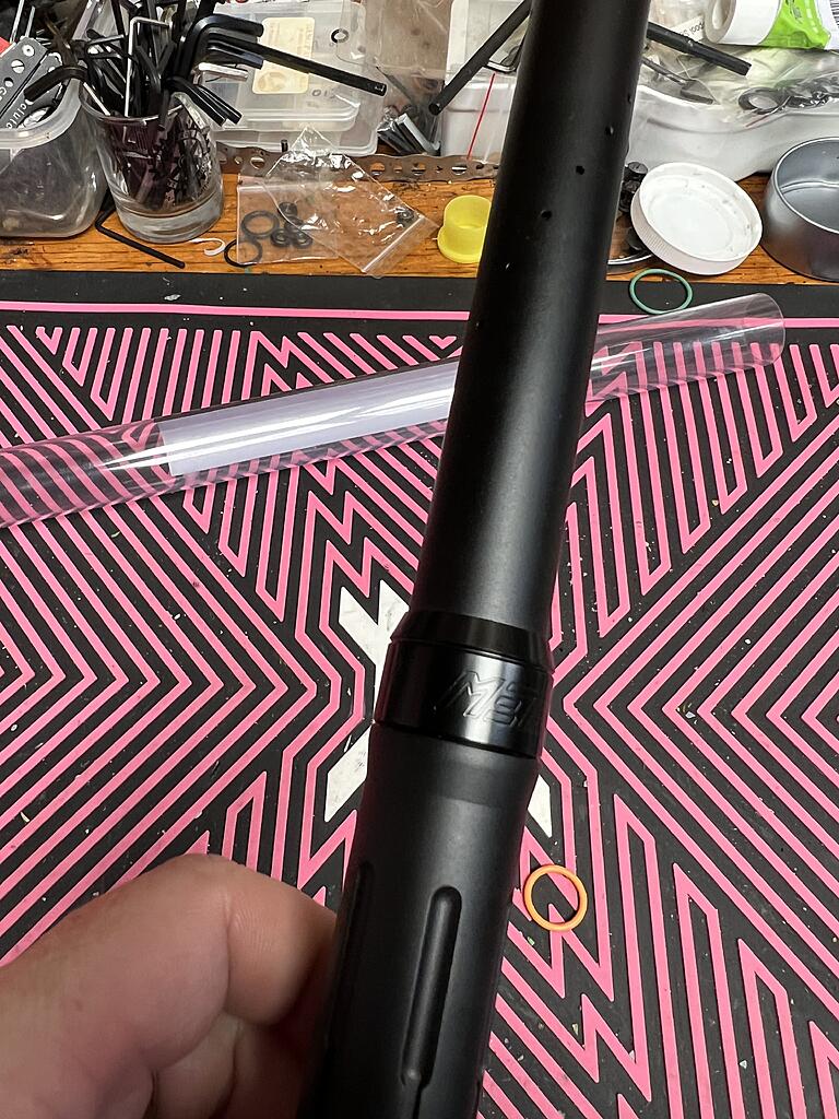

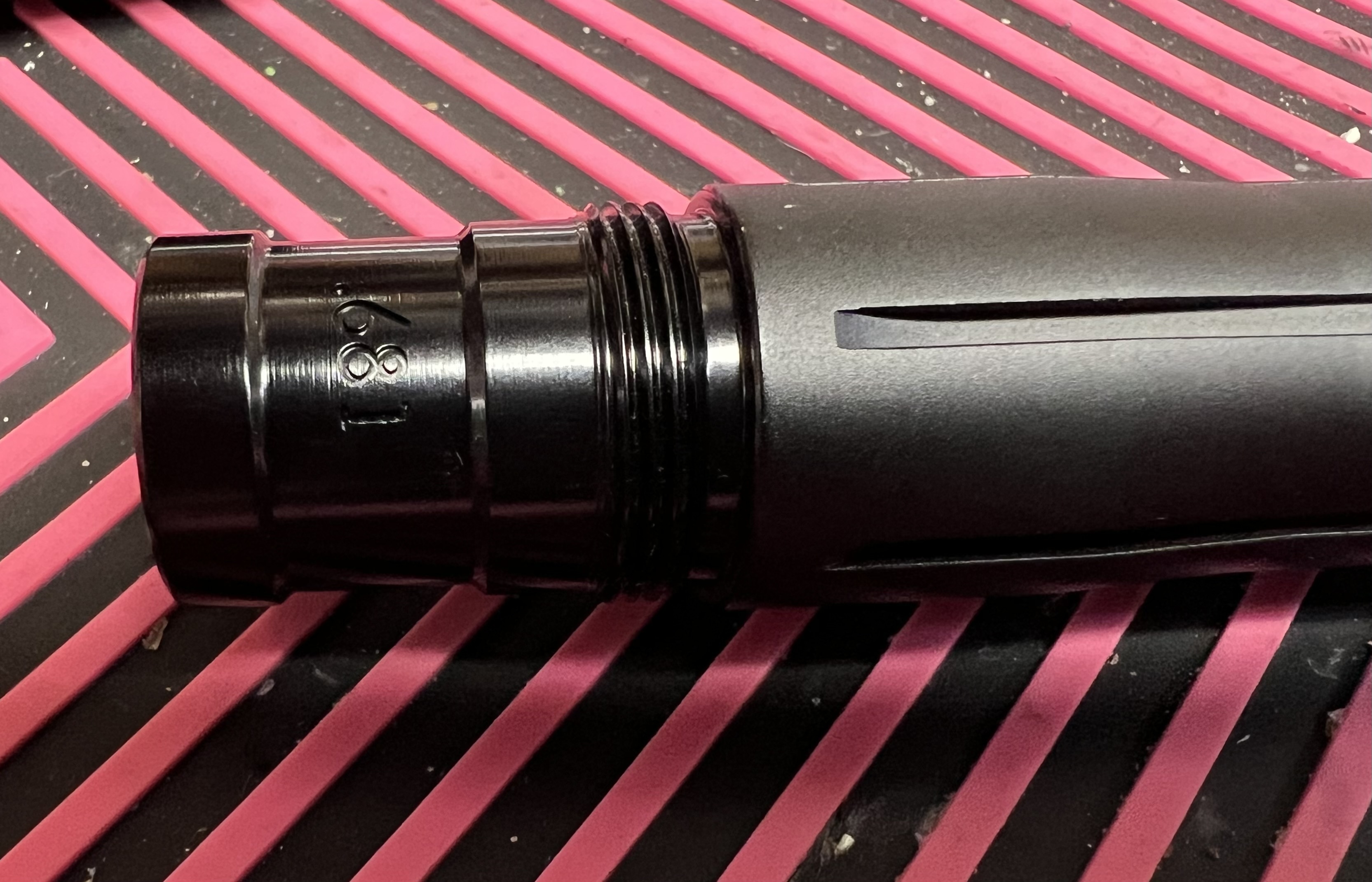

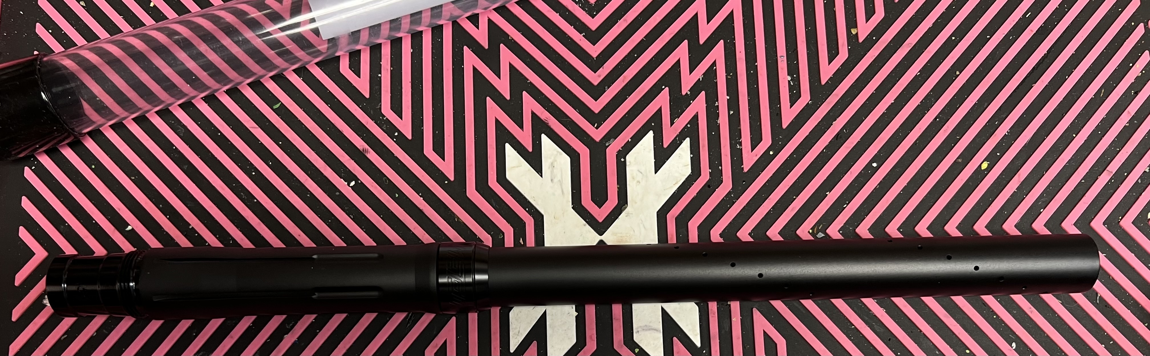

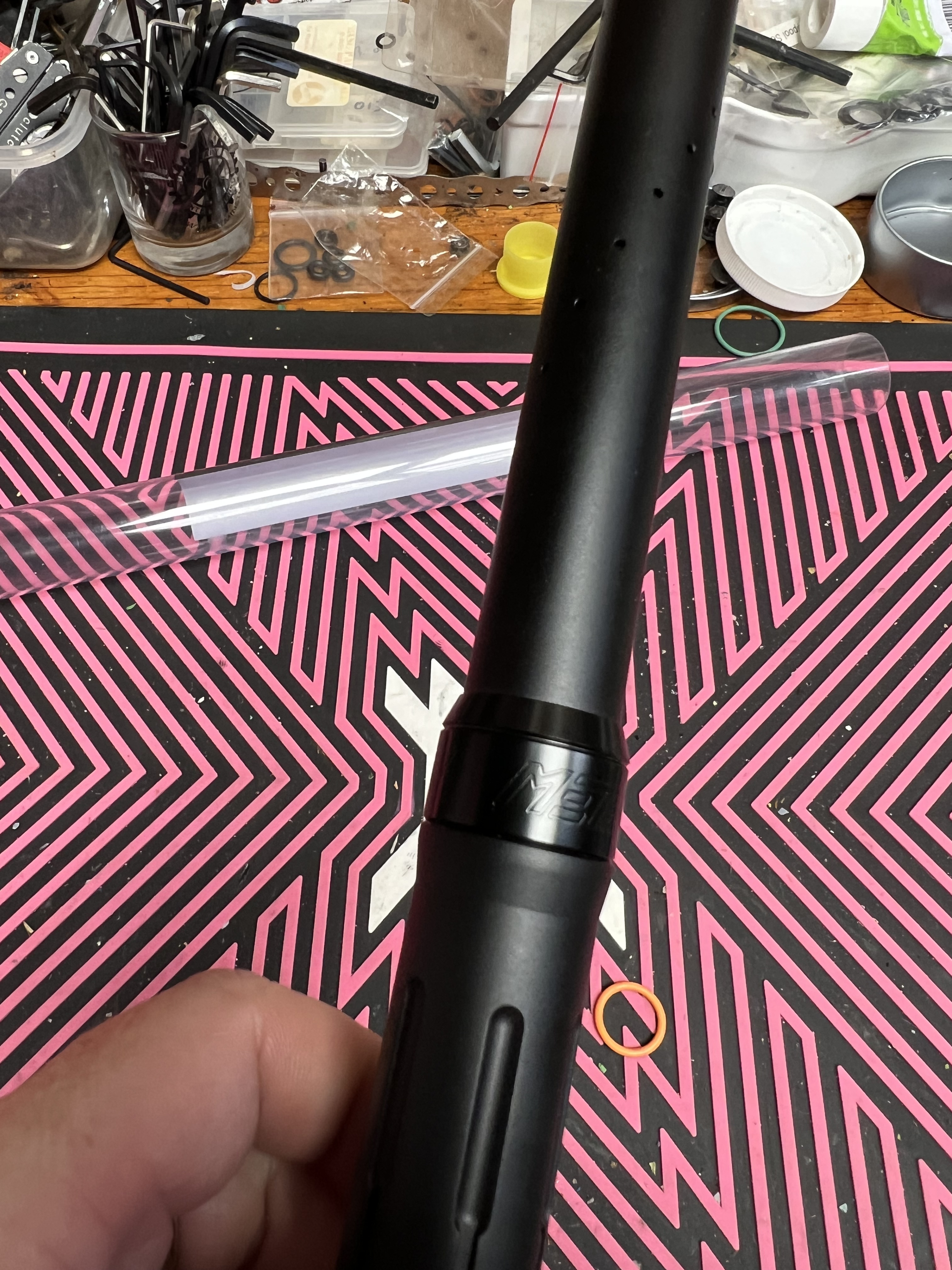

        And last but not least the barrel. Sized at .681 so might even be usable! It goes nice and has Meteor’s name on the beauty ring
ID:	582028 Click image for larger version
ID:	582029 Click image for larger version

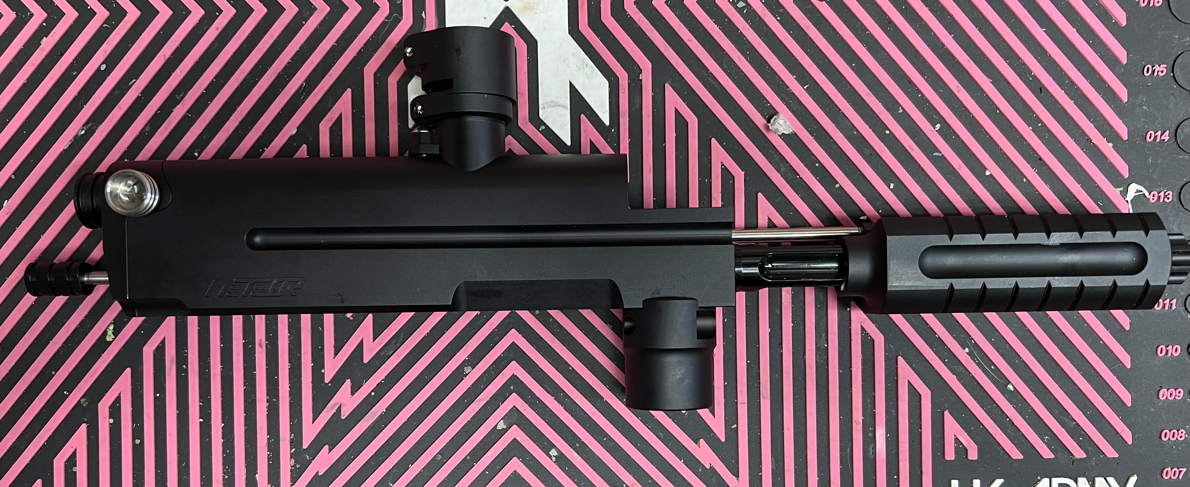

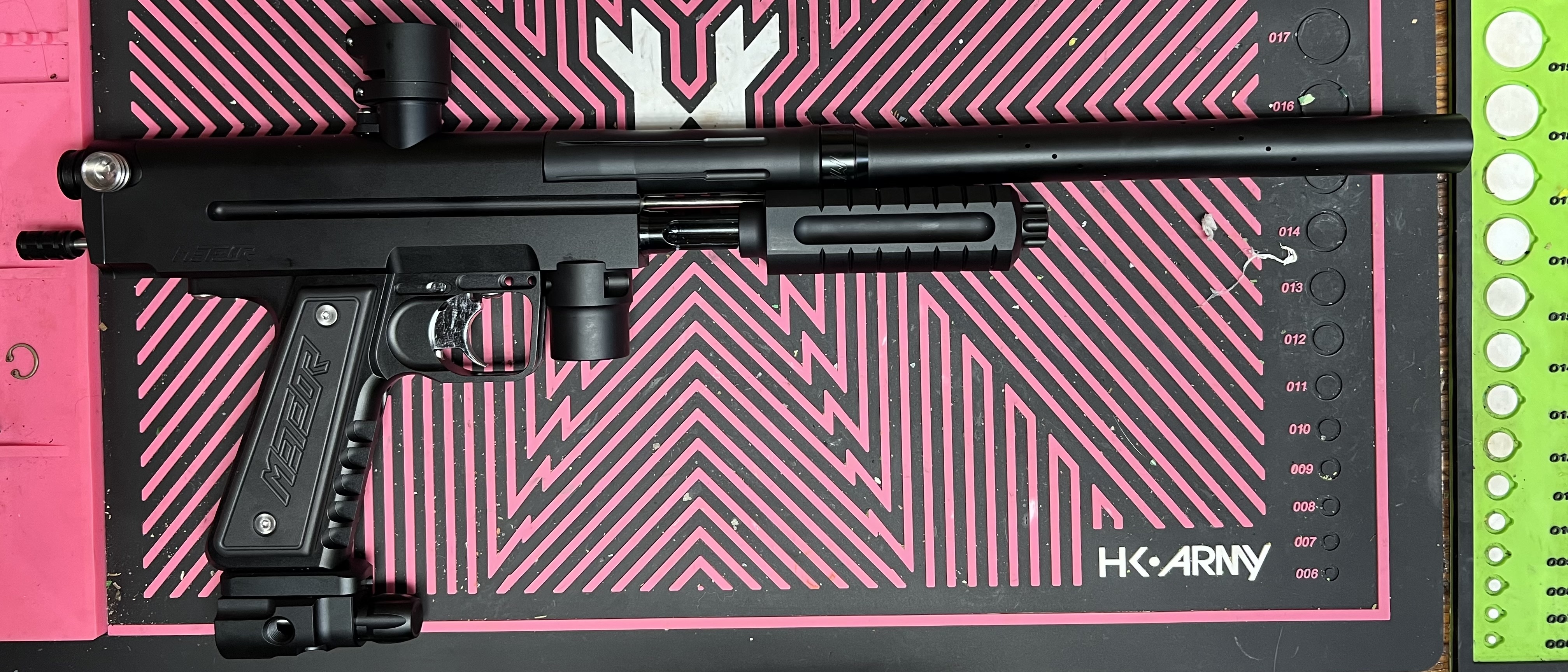

                  Alright, got the body back together:

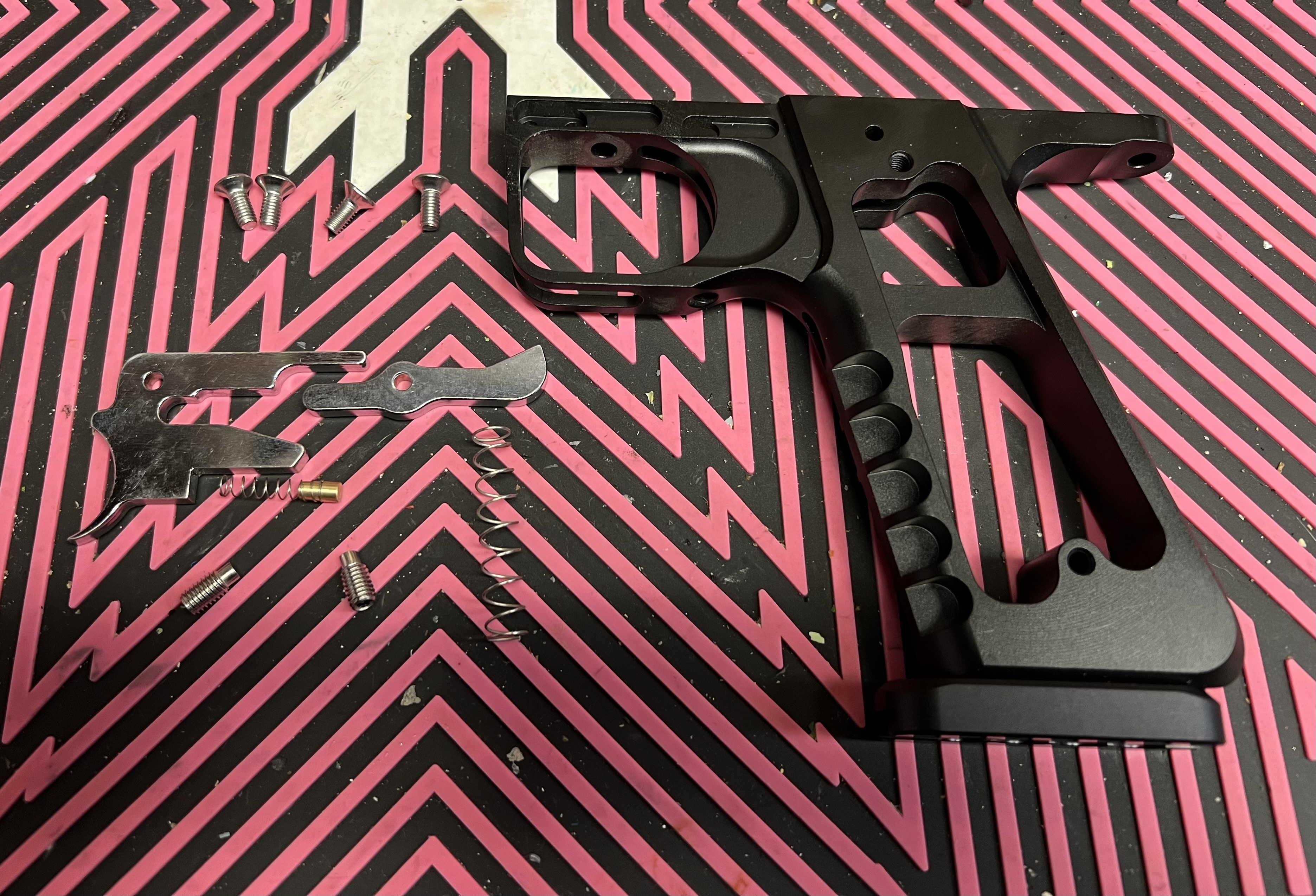

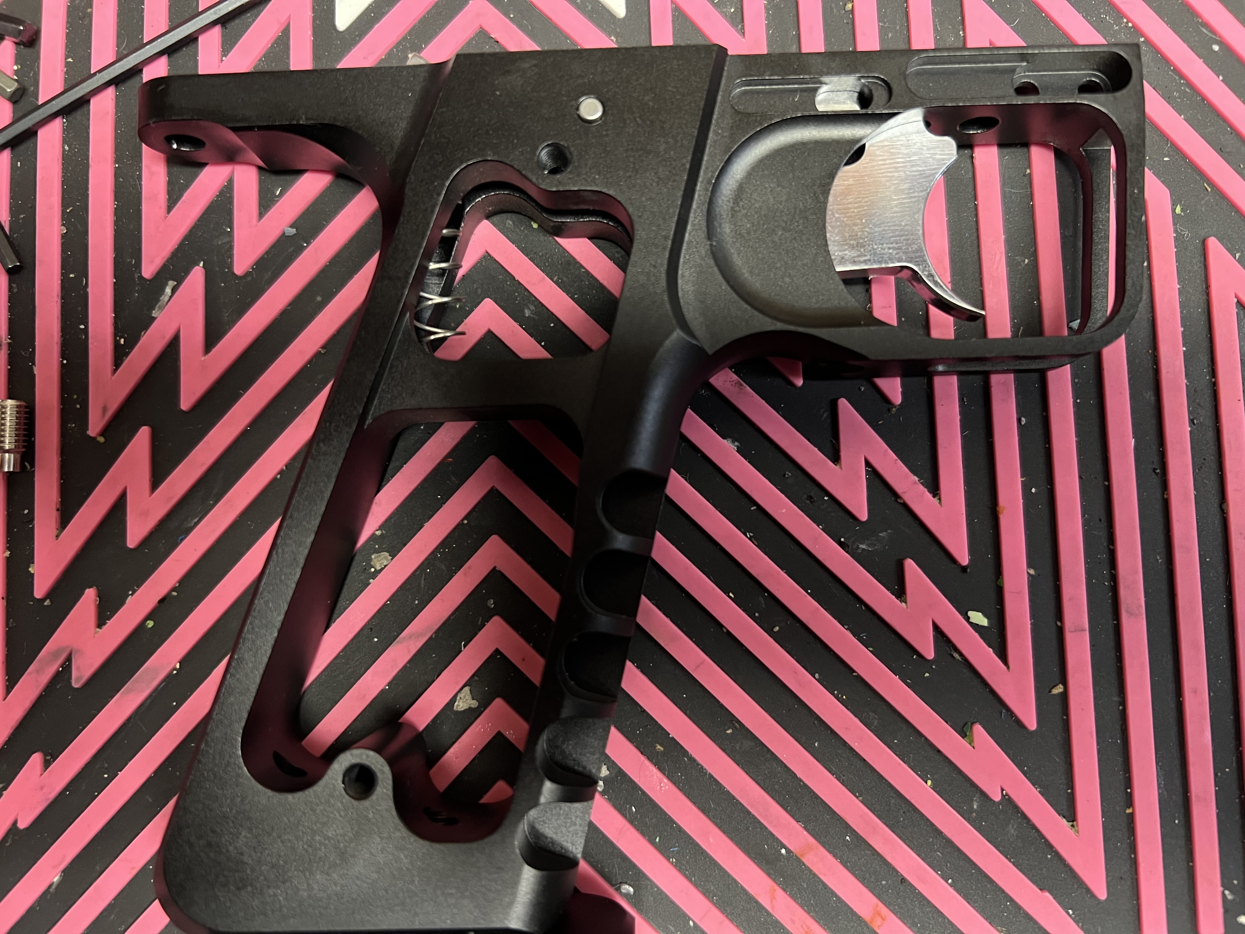

                  And now I need to assemble the trigger frame, which came in pieces.
                  And here’s it going together. The little spring under the trigger is a bit of a pain, but after some effort it’s in the right place:

                    • 4561
                    #26
ID:	582247 And now I have a fully assembly Meteor! My sear is not engaging though, so need to adjust my lug more:

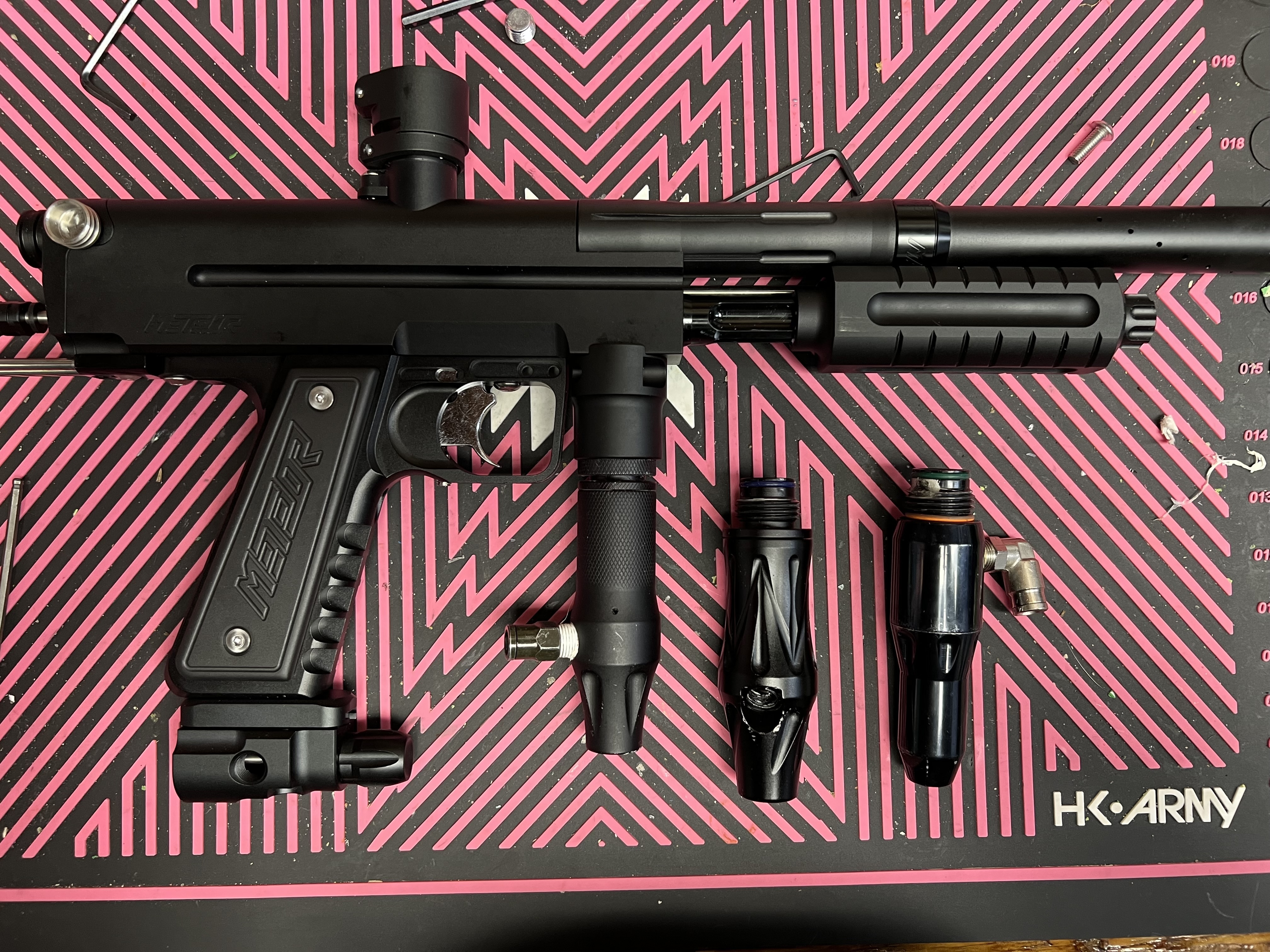

ID:	582254 And now the difficult part, choosing which HPR to use. They’re all a little marked up, but work.

                    Setup notes and thoughts:
                    I tried to get the Meteor tuned in but I’m only hitting about 200fps the the Karni HPR and the current springs. I’ll
                    likely swap the main spring for something a little firmer.
                    The pump stroke feels nice and the knob at the front of the pump does not bother me at all. I wear gloves when I play but not when I tune, but find everything pretty comfortable bare handed.
                    Given I’m going to have to play with springs anyways, very tempted to drop my Lazarus valve into this. On the other hand though I want to try to get a feel for the marker in its original form before modifying and seeing what different it makes.
