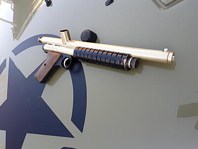

      #34

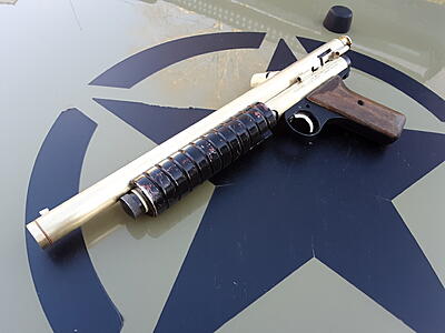

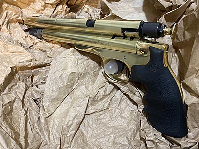

      Check out the Single Shot PGP Creeper Customs just built me. Complete with K Frame, Speed Demon straight pull bolt, the body’s been quick slotted freak bored and cut for First Strike, with a palmers quick change.
      This is a fun build! Figured I would get some good pictures.
      This gallery has 3 photos.
      • Brokeass_baller
        Brokeass_baller commented
        Is that a brass drawer handle on the back of your bolt? I actually really dig it.
      • JeeperCreeper
        JeeperCreeper commented
        Brokeass_baller it's the same knob I'm putting on yours
      • Brokeass_baller
        Oh hell yeah. I must've been drunk or something, because I didn't even notice.

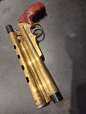

      #35

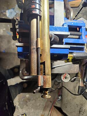

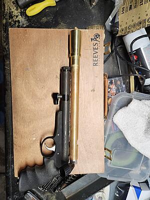

      So the pump guide made its way back on this build. It's going to be finished off with a cocker style rod which will get affixed to the brass bolt "sled." It's smooth as (insert innuendo here)

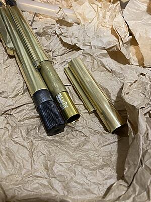

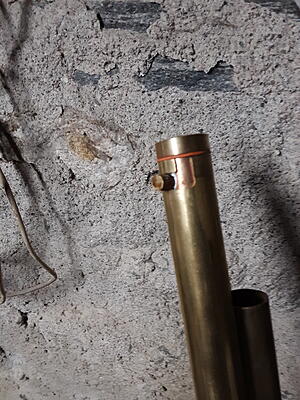

      I made a new tip for this build in my signature style. It looks great and it works. Now to get it cleaned up and shipped out!

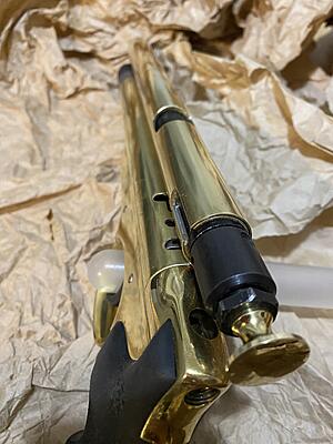

        #37

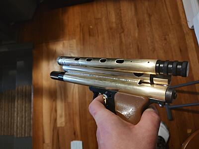

        This one is done and ready to go to Brokeass_baller.

        • jeramiej
          jeramiej commented
          Beautiful transformation.
          JeepDVLZ45 commented
          That front site/barrel retention keeps getting better and better! I love that you shaped it a bit
        • Brokeass_baller
          God, that thing is beautiful. Thank you so much!

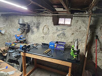

          No brass updates yet, but I did manage to snag a free work bench. So much room for activities.

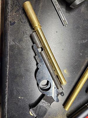

            #40
            Well this one needed a new thread insert, the old one failed. This thing is beautiful with the K-frame on it.

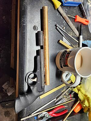

            #41

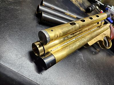

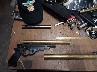

            I finally got a few hours to myself, so I started doing some fitment for the compensater tip,and prep work for this barrel.

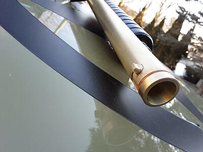

            Forgot to post it, but I remade the tip with the o-ring for tension for this one before I sent it out.

              Very nice work,love the tip design πŸ‘Œ Could tell me what type of solder you use. Thanks
              • JeeperCreeper
                I get the Oatey brand silver solder and flux in the plumbing section of Home depot. It has a decent temp range and has proven to be durable. Very workable with a MAPP gas torch, but you can use propane, it just takes longer.

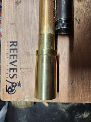

                #45
                Not quite finished with it, but the tip is really shaping up nicely.
                  ..blood, sweat, and tears…I love it!! Nice work
                • JeeperCreeper
                  There's no crying in baseball, erm I mean paintball
                • Lt. head-shot
                  Lt. head-shot commented
                  F Yeah, that looks awesome. I'm up for some holes in it like Solo's blaster if you still want to do that to shave weight. But not sure how that would end up working with the blade sight. Regardless, awesome update and looking forward to it!
