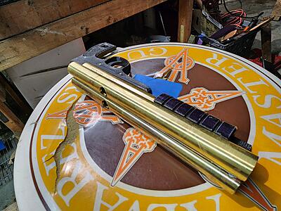

    #182

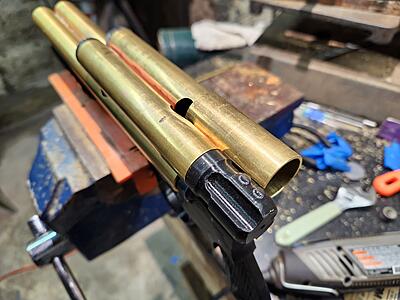

    Working on the feeds today on this double. It was a lot of work, but they came out pretty even. Now to make the other set of cram n jams.

      Damn son, what is the wall thickness on the barrel stock? Thats gonna be a beast!
    • JeeperCreeper
      JeeperCreeper commented
      It's the same OD as the ol WALZ method, 0.875 OD, and 0.686ID. I just use different tubing so I don't need to butcher feed tubes for Freak barrels.

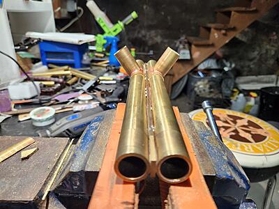

      #185

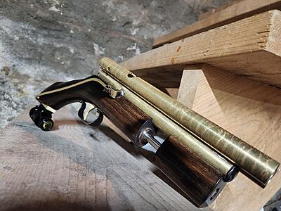

      So close. I snuck in a couple more hours on the pirate double. I just need to do the last complex bend in the airline, and finish up all the little details. As soon as I did this rough assembly, I couldn't stop smiling. It's not perfect, but it's freaking awesome.
      This gallery has 3 photos.
      πŸ’€Team RagnastockπŸ’€
      Ion Long Rifle
      Spyder Pump
      BST Feedback
      Brass Thread
      - - YouTube - -
      • Swedgin!!
        Swedgin!! commented
        That is Rad!!

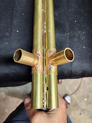

      #186
      What a pain in the butt that was. I cracked and kinked the first line. This is #2

      • Grendel
        Grendel commented
        Did you anneal the brass tubing? It makes it a lot easier to make complicated bends then you can just wait a few weeks and it will age harden back to where it was.
      • JeeperCreeper
        I didn't the first time that's why it cracked

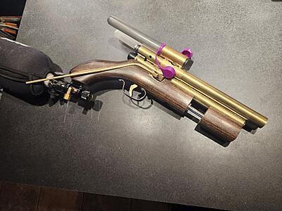

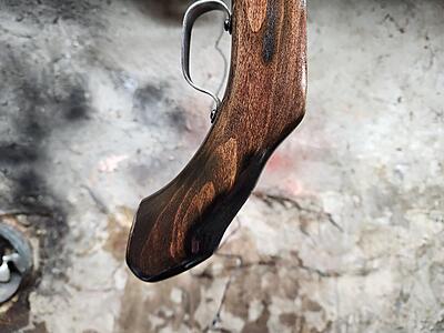

      #187

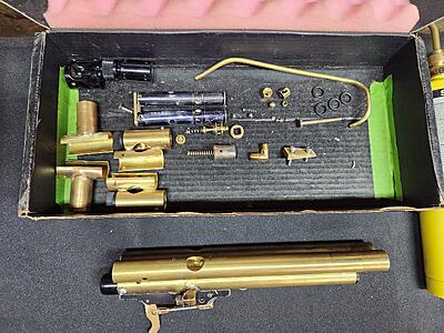

      I didn't like the feel of thw stock after I got the ASA mounted, so I shaped it to be just a bit less chunky. Also I didn't like the angle of the ASA, so I made an angled plate to get it to a more comfortable position. All the little details are getting done. I'm adding laquer to the stock now, and my final assembly and testing is near.
      God damn that's alot of small parts.

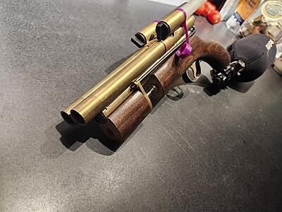

          #191

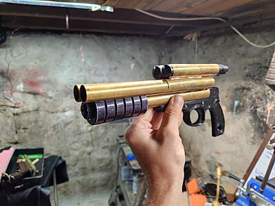

          So, I had another idea. 2-5 round feeds both fed by one Fast Feed. One 10 round tube fills it up. The crazy part is I think it's going to work. The 5 rounders look perfect on this Short N Nasty inspired build.
          https://youtube.com/shorts/XGd4AKQU5...gEmP5gQqWNVuDN
          Ion Long Rifle
          Spyder Pump
          BST Feedback
          Brass Thread
          - - YouTube - -
          • Cal440
            Cal440 commented
            All I can say is WOW, that is fantastic! Like the shorter look also.
            Alexndl commented
            Let me know if you need more parabolic feed plug I can print more and bring you some at Slim
          • JeeperCreeper
            I'll probably take a couple more, they are nice for lots of different builds.

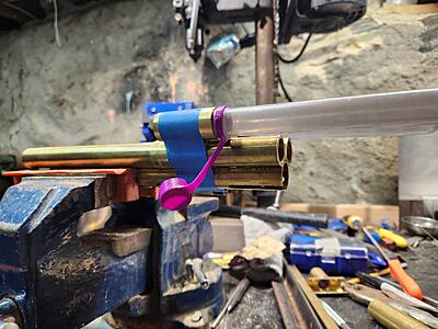

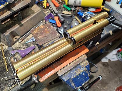

            #193

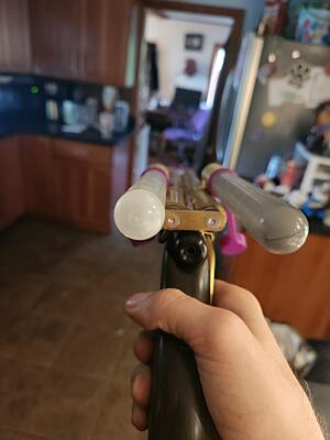

            Working on it, I need to drill lots of holes still, and make detents. Brass Kframe ordered. And Im done soldering the detachable feed. This is gonna be a fun build. I bet this could even potentially fit in a holster. I need to make one for me now.
            Ion Long Rifle
            Spyder Pump
            BST Feedback
            Brass Thread
            - - YouTube - -
            • Cal440
              Cal440 commented
              Nice work, I really like the look of the shorter feed system πŸ˜€
            • JeeperCreeper
              Thanks, me too. It's likely only going to get 10 shots per 12g like the other double, so swap out 12g every 2 tubes of paint.

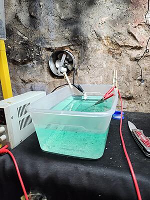

            Finally got around to making a new batch of nickel solution today.

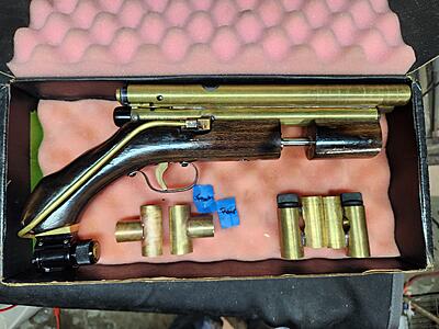

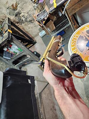

              #195
              Possibly the last time I see this thing. Such an intense build, and I'm glad it's done and it actually works. It's all wrapped up tight now, ready to go.
              Ion Long Rifle
              Spyder Pump
              BST Feedback
              Brass Thread
              - - YouTube - -
                BrickHaus commented
                Where's this one going?
