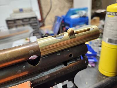

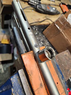

      I got this Hounstooth body fixed up with a new thread insert. These are super picky about the height of that insert for clearance.

      • JeeperCreeper
        JeeperCreeper commented
        Yeah its a fine line between too tall and not enough threads. I did this probably 5 times total, I kept ripping the threads out of any that I cut too short.
      • Cal440
        Cal440 commented
        Thanks for the reply, the one I have to replace is in a Pmi2 so I don't think that will be a issue. But that is good information to know for the future. Just watched the video below,that looks great I think might have to get in line for one!
      • JeeperCreeper
        If the PMI takes 12 grams, you might still have to shave the thread insert down just a touch so it doesnt get in the way. If its CA tapped then no worries.

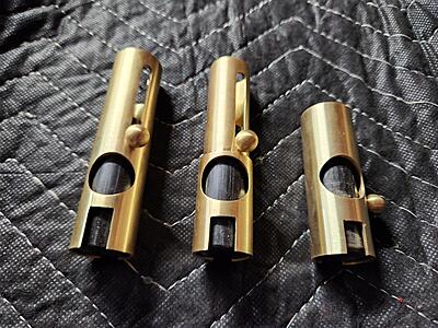

      I'm trying to finalize the design. Which of these 3 do you like best? The one on the right takes more materials, so obviously costs more to make. The one in the middle is a stripped down version of the first. And the left one is the most compact.

      • binson
        binson commented
        I'm a fan of the smallest one.

        I think the last one looks the nicest
      • Cal440
        Cal440 commented
        I like the short one also.
      • 3411
      #218
      I'm with the short pp crew. Stop trying to make us feel inferior with those long ones.

        #219
        oooh that bottom one is nice, if that one goes into production I might just have to snag it so I can throw the original one on the next pgp I buy

        • JeeperCreeper
          Its been a pretty resounding yes here and FB. Its definitely looking like the short one is gonna win.

        #220
        I'll cast a vote for the short one as well. In addition to being more compact, I like how the lever is to one side which clears it out of the sight picture.
        On the whole though, very nice design and execution! It looks clean, easy to use and matches the existing gun well. I take it the thing just sits into the old feed cap's slot, or is there some modification one has to do to the gun?
        • JeeperCreeper
          Yes it fits the old feed plug slot, meaning if you have a 2k, Ill have to make a different style for it to work.
        • Drunkscriblerian
          Drunkscriblerian commented
          Kinda what I figured. Fortunately mine's a classic PGP.

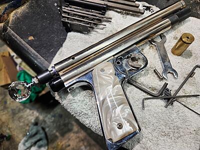

          #223

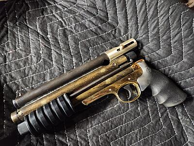

          cougar20th just about ready for solder.
          Ion Long Rifle
          Spyder Pump
          BST Feedback
          Brass Thread
          - - YouTube - -

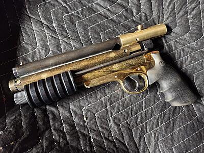

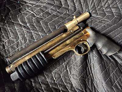

          • JeeperCreeper
            XL inserts, 45* right feed, and a detent for double feeds. Plus I still have to do some patina to hopefully make it look like I never even touched it.
          • Cal440
            Cal440 commented
            Looking forward to seeing how your patina comes out,when using a center fire bolt how much longer do you make your new breach section? The build where you shortened the lower tube for the quick change really made it look better.
          • cougar20th
            cougar20th commented
            Looks great. Don't forget if possible to save and add the old site bead.

          #224
          Cal440
          The gun is a flatback Kp3 that has been to palmers a couple times for mods.
          This is the gun before. Unfortunately the large barrel and small paint had made it useless. It's sort of a unique piece that will be more unique after JeeperCreeper is done.
