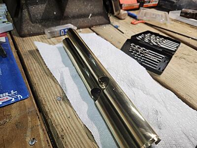

      Plating some little detent covers
      • JeeperCreeper
        Multi-purpose
        • 2104
        • Western MA
        #199

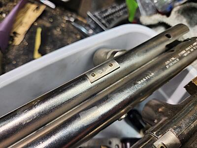

        Can you guess which one I side tapped?
        Just gotta clean these up, reassemble the complete one, and send these back to jdgreen76

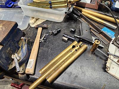

          Trying to do something to distract myself. I've been having back pain for 2 days now, so I am behind on sending out orders. Sorry for the delay.

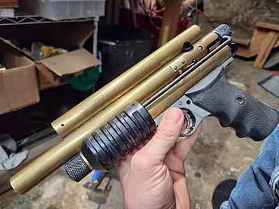

          Anyway, I made a detent for the brass Sterling. I also stripped the body again. Now I'm making it a brass Sterling VSC. I'll probably go with a brass hardline. I'm going to chop up a rear ASA, and drill and tap a new fitting on the side of it for a cleaner hard line. Then I still need to tune it, and maybe I'll use it at Slims.

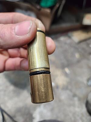

                Double detents. The double feed detent is a new take on an old design, and it seems to work very well.

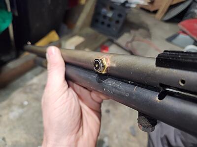

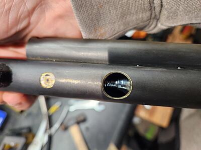

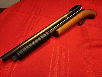

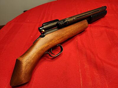

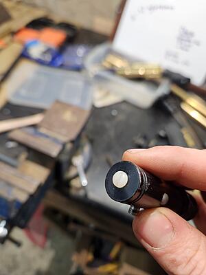

                A nice 2k, made user friendly with light mods. Detents, a bolt pusher, and easier valve disassembly.
                This gallery has 3 photos.
                Ion Long Rifle
                Spyder Pump
                BST Feedback
                Brass Thread
                - - YouTube - -
                • The Great Equalizer
                  The Great Equalizer commented
                  Is the white sphere coming out of the bolt the "bolt pusher"?
                • JeeperCreeper
                  JeeperCreeper commented
                  Yes it was hard to photograph, but its a nylon 6-32 screw

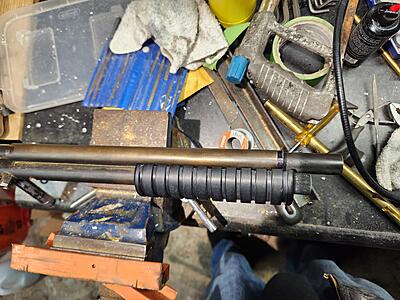

                #207

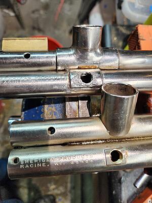

                I managed to sneak into the shop for a few hours pre turkey. I shortened this lower tube 3" and re-tapped the threads. More mods later. Happy Thanksgiving!

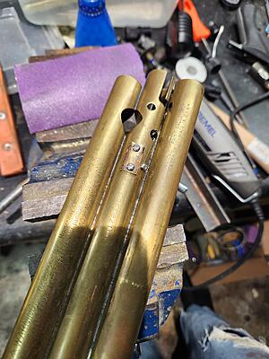

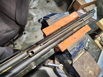

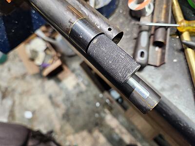

                  I cut a spring feed slot and a window that will be hidden under the stock, for popping out stuck cartridges. I got the spring feed parts from Alexndl. Now to add the detent.
                  Ion Long Rifle
                  Spyder Pump
                  BST Feedback
                  Brass Thread
                  - - YouTube - -
                  • Cal440
                    Cal440 commented
                    I like the pre planing,when you build a center feed tube do you attach it to both upper and lower tube or just one.
                  • JeeperCreeper
                    This one's the stock feed tube, I just adapted it for spring feed. Its stuck to the barrel and lower tubes. I have done 90* feeds in the past, only stuck to the side of the barrel.
