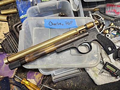

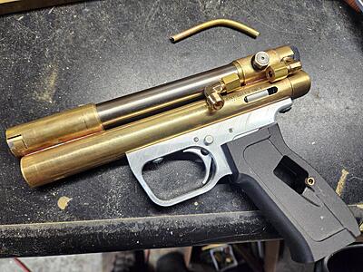

    PGP with Speed Demon conversion, Freak barrel, and a neat brass dohicky for the bolt. Nearly done.

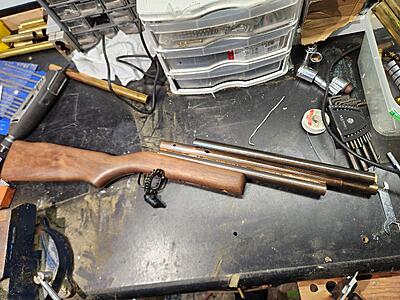

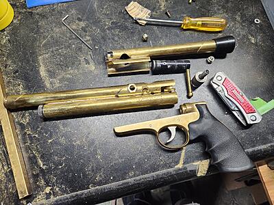

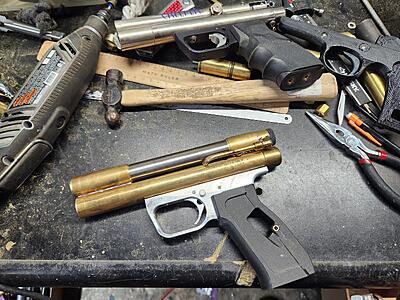

      Today has brought some progress. Detent added, I slotted the lower tube for the cocking knob I'll be adding, I also finished up the barrel tube. I just need to tap the valve, run the tiny airline, and drill and tap that hammer. Then it needs a good clean up and a plate job.
      πŸ’€Team RagnastockπŸ’€
      Ion Long Rifle
      Spyder Pump
      BST Feedback
      Brass Thread
      - - YouTube - -
      • JeeperCreeper
        JeeperCreeper commented
        Yes a single shot, the barrel slides forward to open the breech and pop in a paintball. There's no sliding bolt anymore. I gained 2" of barrel by doing this.
      • Impactfour
        Impactfour commented
        This is wild. Between Jordan's bottom feeding marker and this boltless design you all decided to break all the rules at once
      • Drunkscriblerian
        Drunkscriblerian commented
        A...boltless...Sheridan??
        Just when I thought the builds 'round these parts couldn't get weirder.

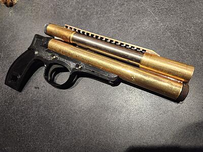

      Oh, but this looks so very steampunk cowboy. Now I can't decide.

        You bypassed any need for a center-fire bolt. Oh man and get a nice all brass k frame on that.. oooh! That's hot πŸ”₯πŸ₯΅ .
        Jordan commented
        Pretty cool - what size line are you running?
      • JeeperCreeper
        I'm going to try it with 3/16 because thats what I have on hand, but I'm almost certain I'll be upgrading to 1/4" fittings for better flow.

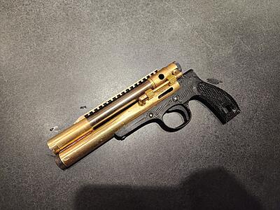

        Oh its nice. I definitely need to go with a 1/4" airline, I'm just waiting for the fittings to show up.

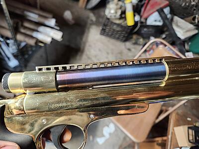

          I tried out the electro anodizing, very simple. Baking soda in distilled water, and a power supply. You need a sacrificial piece of titanium to hook to the negative, and hook the positive to the part. Dial in color by voltage.

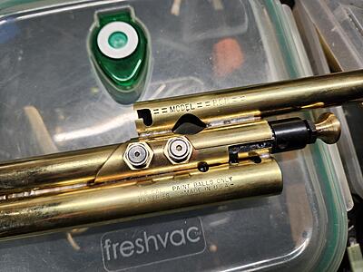

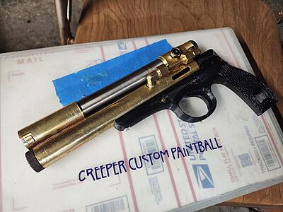

            Ok, back to the normal programmed schedule. I added a detent to prevent double feeds, and added this Speed Demon style bolt for more fun single shot action.

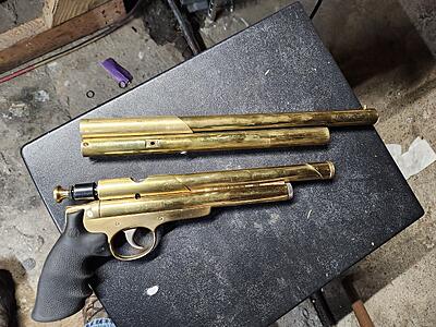

              And very similar treatment to this Piranha. Its getting a detent and a new feed.

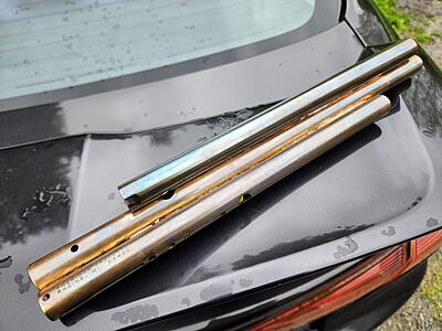

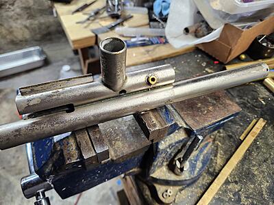

                It looks like the copper is really coming to the surface on this, now to let it turn penny brown.
                Ion Long Rifle
                Spyder Pump
                BST Feedback
                Brass Thread
                - - YouTube - -
                • Cal440
                  Cal440 commented
                  Are you trying to match some original pateena, and won't it get messed up when you do your soldering?
                • JeeperCreeper
                  Trying to match the original dark brown patina

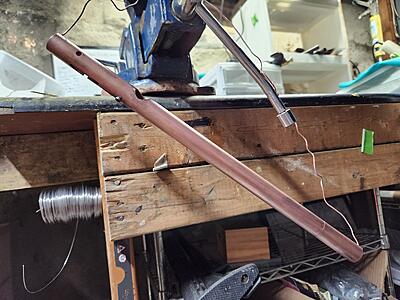

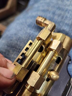

                Finally the fittings arrived. They are definitely more bulky, but they still fit after some fiddling. I went from 3/16 to 1/4" thin wall tubing. Lots of airflow now.

                  This thing was already pretty custom, but now it takes XL inserts and has a breech detent for double feeds.

                    I can share this one, it might spur some creativity around here. Its JAX Brass darkener, available from the jungle website
