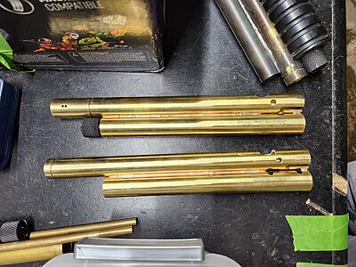

      Things are happening in the shop.
      Alexndl's 2k based sleeper is almost done, just gotta do a custom finish on it
      Got 2 more brewing up for Slims, more on those soon.
      Also still working on Jordan's single shot, but I don't want to show that until I get it just a little farther along, as I can't explain it, I'll just have to show you how it's gonna work.

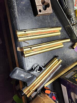

        And then there were 3

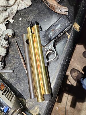

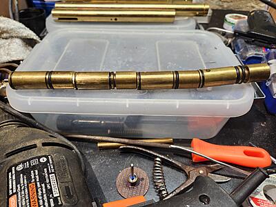

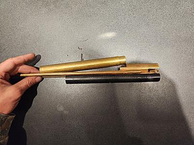

          Jordan, the post you've been dying for
          So with this Break Action build, I had to get creative. This one's a PGP 2K base, so it has the quick change. Pretty much every break action I've seen utilized a lever CO2 changer, and made that the pivot point. So I'm making the pivot point with my little side tubes.

          • JeeperCreeper
            JeeperCreeper commented
            I have alot left to work out, but I like how this is shaping up

            BrickHaus commented
            How far into this are you? I have a lever assembly if it makes your life that much easier I could donate it to the cause.

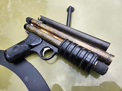

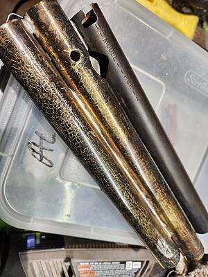

          #82
          Attempted a snake skin patina. This isn't quite it, but still looks crazy. What do you think Alexndl?

              Jordan commented
              How'd you do the patina? Looks pretty awesome, way better than my attempt on my KP awhile back.
              Alexndl commented
              Can't wait to try this sleeper PGP this weekend, I love the patina!
              Was wondering how it would look assembled with the top tube not having the same finish, but the contrast make it look super cool.

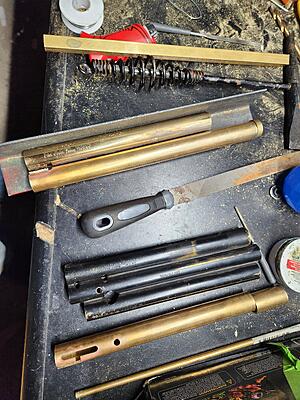

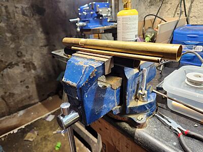

            #85

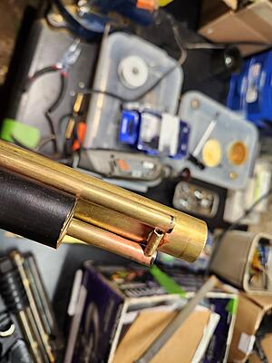

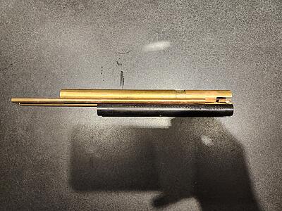

            I hope this helps explain the pivot on Jordan's build. Just gotta add a pin, and file the tubes down until it opens just right. I might add some kind of spring assist so it pops open when the bolt is pulled

              Jordan commented
              Very ingenious... I like the spring idea too.
              Oh I like! Are there issues with that getting in the way of the changer knob on the lower tube?
            • JeeperCreeper
              No issues at all. That's why I put the pivot that far forward

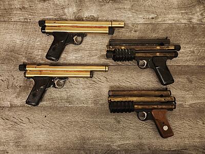

            #87

            • Cal440
              Cal440 commented
              Excellent shooters there,like the variety. When doing a freak insert, does the lug on the bolt need any modification so it will still reach the hammer, because of the additional height?
            • JeeperCreeper
              Sometimes. If it's an old an worn down lug, sometimes it will skip over the hammer. If it's a screwed in lug, I just back it out a little. If it's the spring style lug, I remove the spring and make it rigid, as I always cut the quick strip

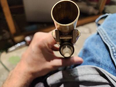

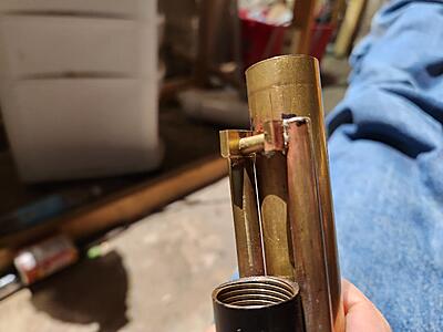

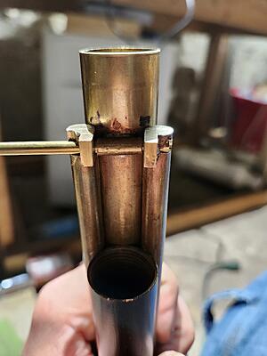

              #89
              Well I wasn't going to have enough meat to add my pin, so I added these tabs. Just need to drill for the pin and clean this all up

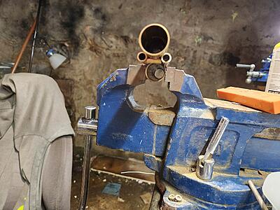

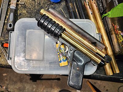

                #90
                This came out better than I thought it would
