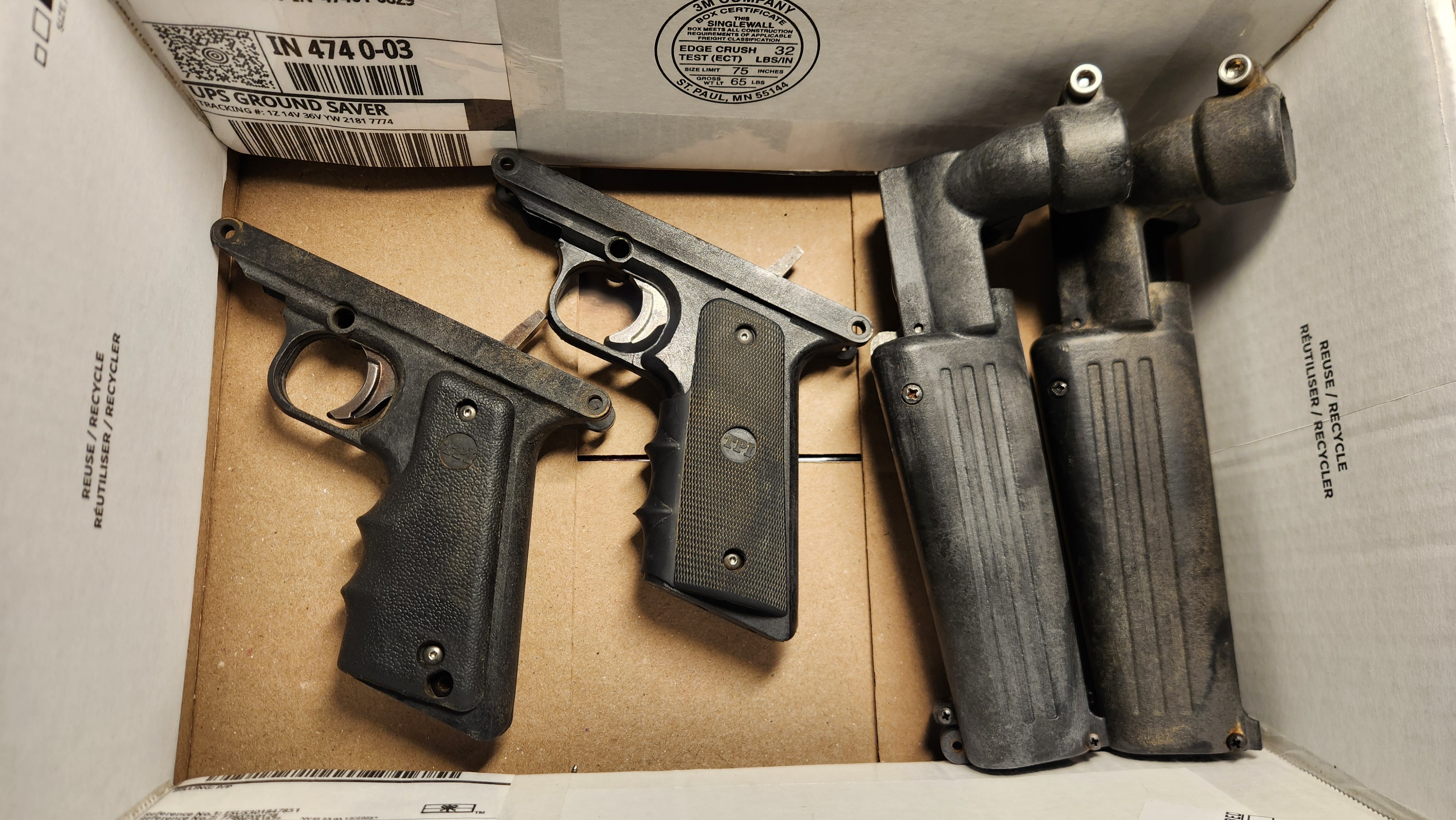

    The Cleanening

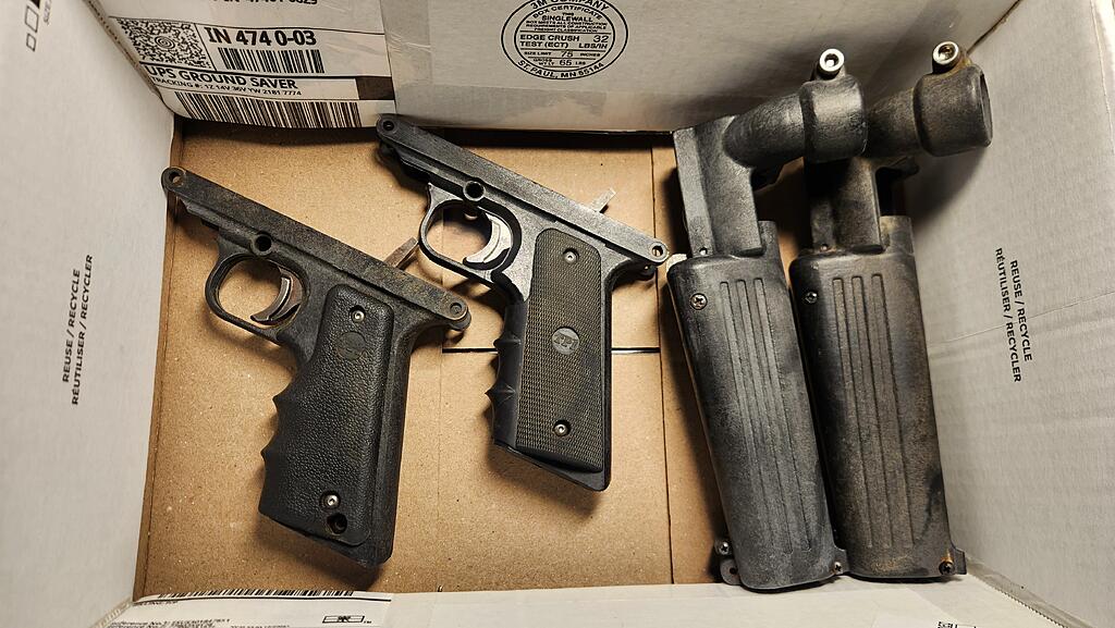

    First thing was airing them up just to see if they still worked in such a completely fooked state. Sure enough, one held air cycled and shot (with a new detent) just fine. The other cycled just fine, but had a slow valve leak. I later found that the power tube was sheared off from it's base and was awol. The velocity screw was also broken off, with the tip stuck in the power tube base. When disassembled, the valve and hammer seals on both crumbled. Absolutely amazing that they still functioned as they did.
    I am quickly finding out that these Tippmanns mean two things, rust and 15 year old paint. After soaking the shells of the foregrips for 2 days in dishsoapy water, I still had to use a steel wire brush to get to the bottom of that paint inside. I didn't know paint could do that. I soaked all the plastic screws in Evapo-Rust, which sorted them out. Got a bunch of stainless replacements for the rest. All the other bits were ultrasonically cleaned for an hour in simple green concentrate and then polished. I now have 2 good forends, 2 good grip sections, and one body that I would consider functional. The Sa-200 should give me a second. I am interested in checking out the valve differences.
    Click image for larger version  Name:	20260119_145716.jpg Views:	0 Size:	1.94 MB ID:	785780

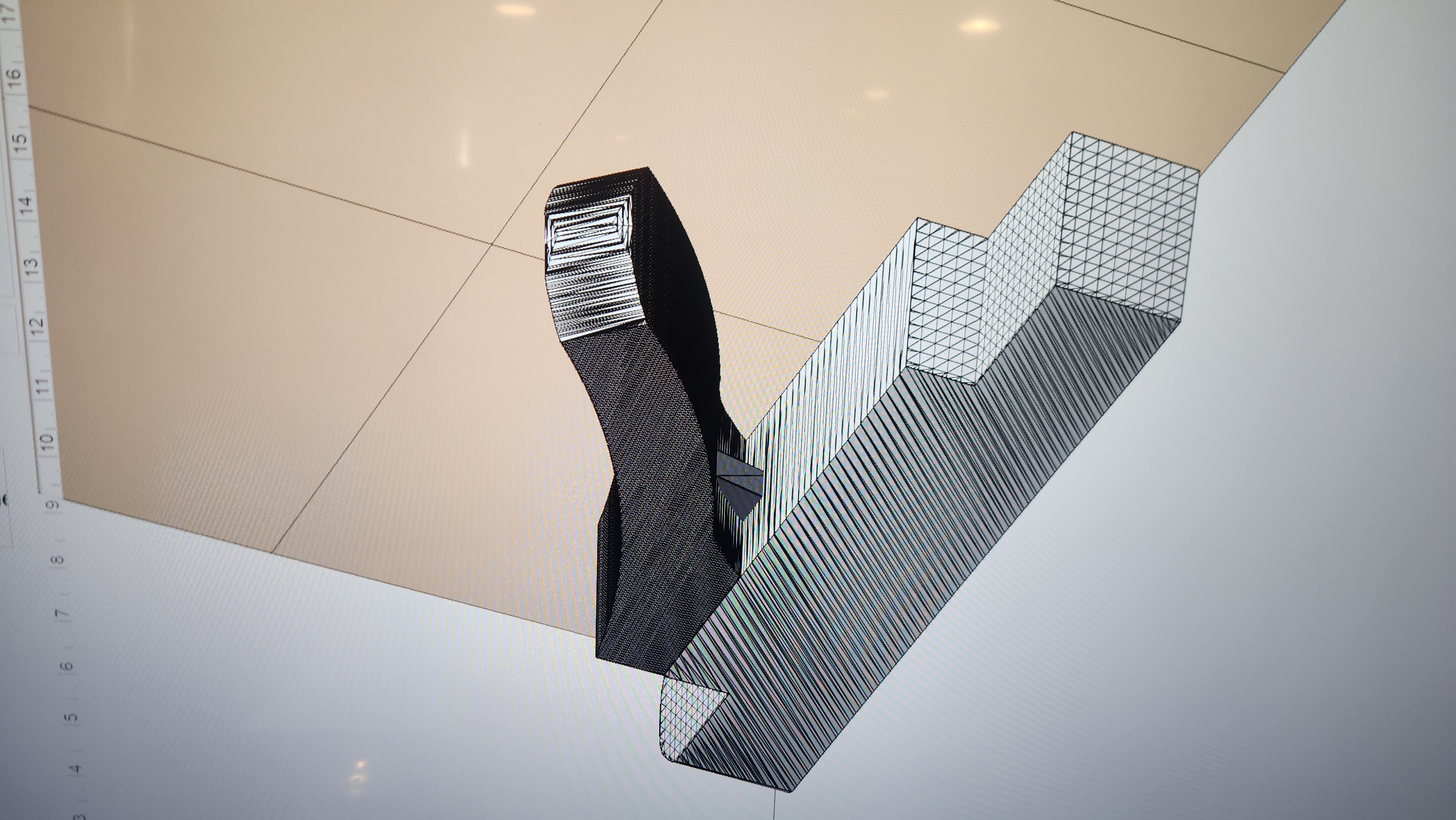

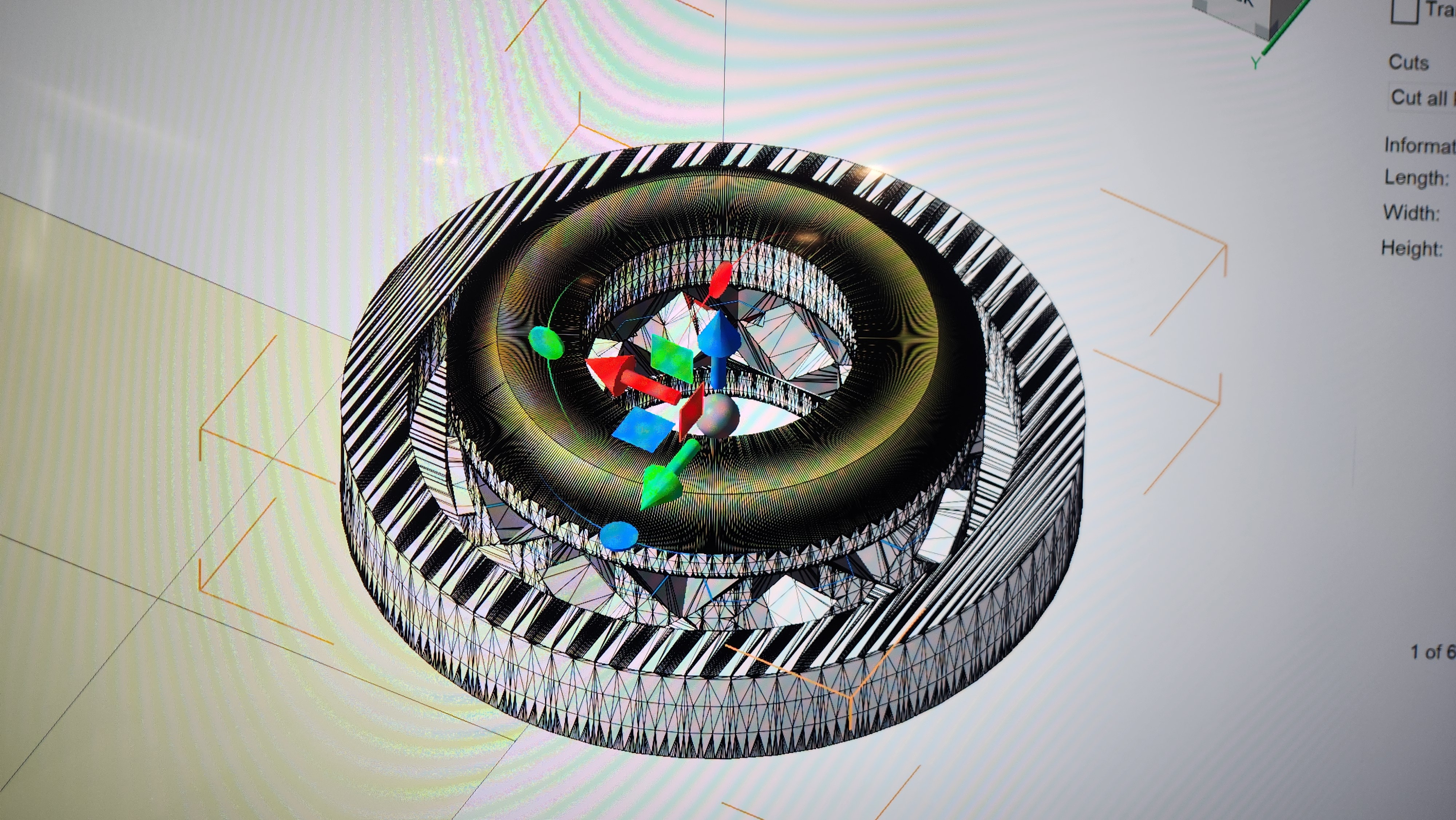

    Squishy bits

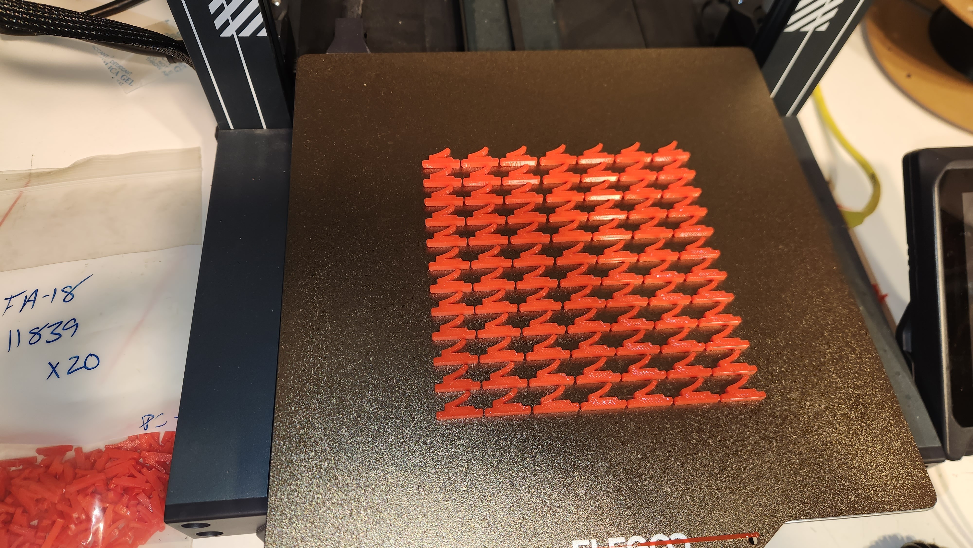

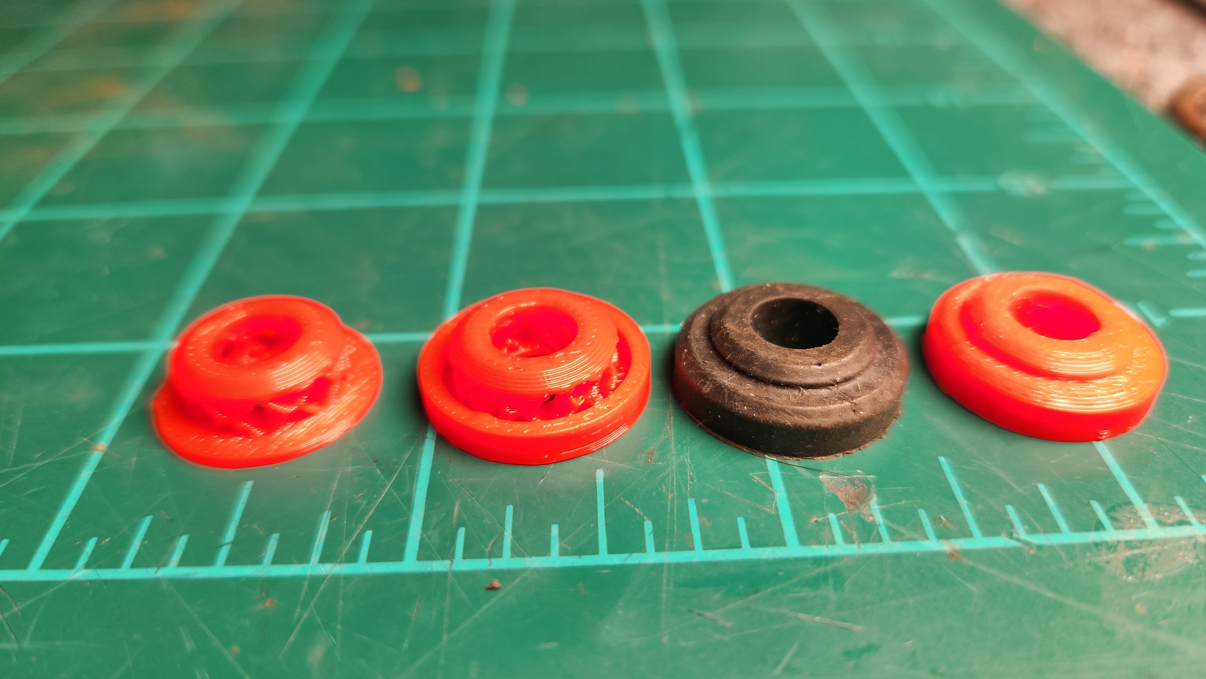

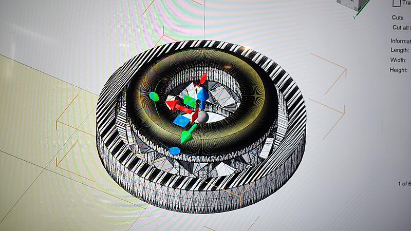

    I downloaded some detent models, which I found to be ill fitting and didn't look like they would function well, so I made my own. About 4 versions later I had a model that fit the detent cutout on the carbine perfectly, and had a springy action. One addition for the 4th version was a tiny amount of structure under the finger in the area where it creases. The helps the tip be even springier and should help them last a bit longer. Not that it matters, because I promptly printed a few plates of 82 detents. I plan on putting a new one in every time I use one cause I can. My local field owner dug out some Carbine parts for me, including the power tube I needed. One part was a bumper that wasn't healthy enough to use, but still had its original shape for measurement. I made a model of it and printed it in TPU with single walls and top/bottom layers and open wavy infill. It would work fine, but I decided on another setup with diamond shape springs in a center piston and an outer rim as a final stop. Has the same outer dimensions as the original and a very nice action that should work and last well.
    Click image for larger version  Name:	20260119_100359.jpg Views:	0 Size:	1.62 MB ID:	785776 Click image for larger version  Name:	20260119_171454.jpg Views:	0 Size:	1.90 MB ID:	785779 Click image for larger version  Name:	20260120_102516.jpg Views:	0 Size:	2.41 MB ID:	785777 Click image for larger version  Name:	20260120_102127.jpg Views:	0 Size:	1.28 MB ID:	785778

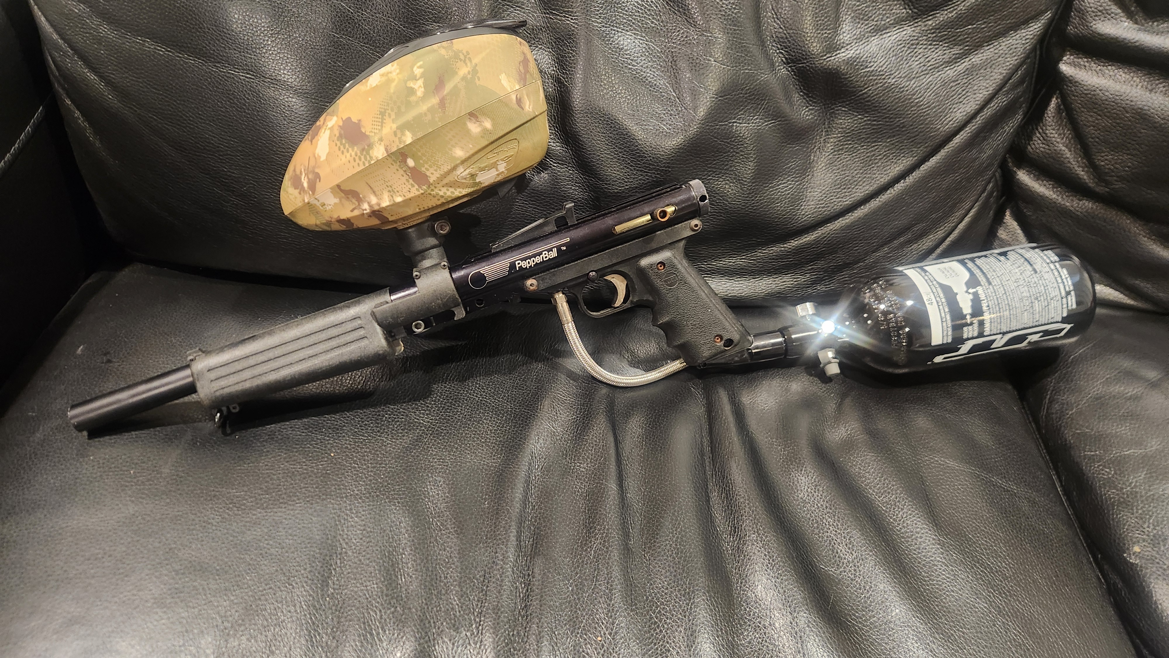

            The Sa-200 just arrived.
            Looks like it just sat in a rack for 2 decades. No wear on the body at all.

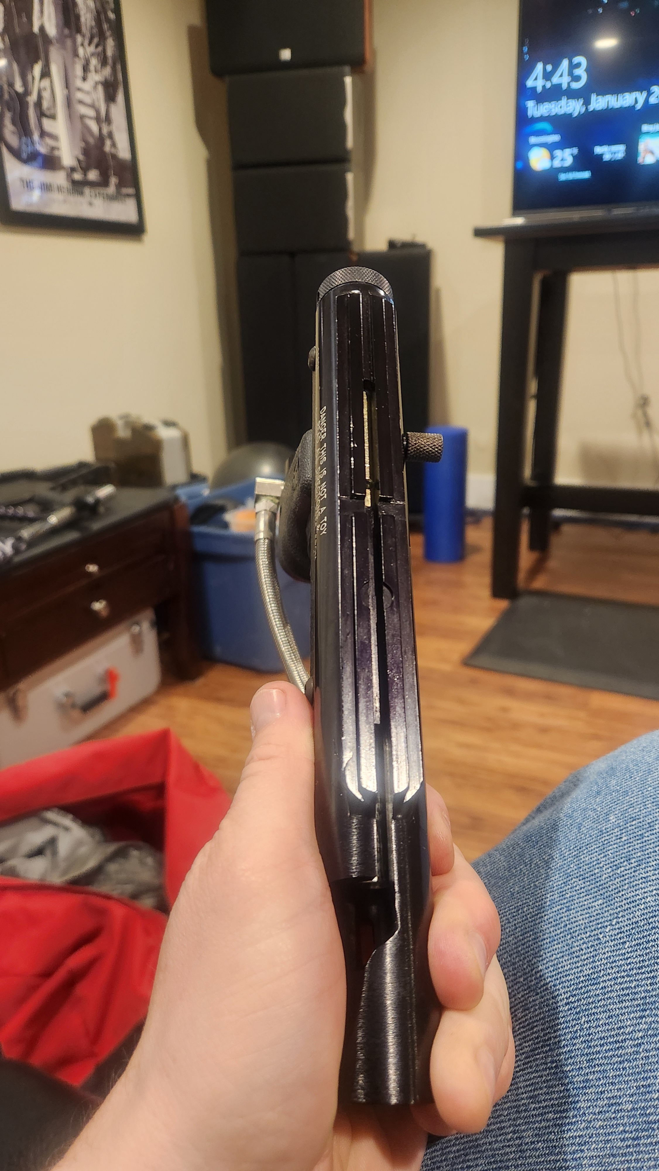

                  I have completed disassembly of the Sa-200 Pepperball gun. For the record, I see absolutely no difference in the valve, air fitting into the valve, power tube, valve spring, or main spring. This is a simple rebadge of a bone stock Pro-Carbine. Period.

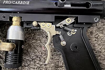

                  • FlightMedic938
                    • Feb 2023
                    • 437
                    Dusty Bottoms With a little work the Pro series triggers are just as good, if not better, than any 98 or A5 trigger. Little filing, sanding, and polishing goes a long way. A Model 98 sear spring works great as a trigger spring in the Pro series and makes it light. A blue Madman sear spring from a Model 98 spring kit is even lighter than that. TechT size 1 trigger pin reduces the travel and #4 Everbuilt brass washers can almost completely remove trigger slop.
                    A lot of the weight and sluggishness in the trigger comes from the hammer weight so lightening it or using a Pro Lite hammer really makes a big difference.

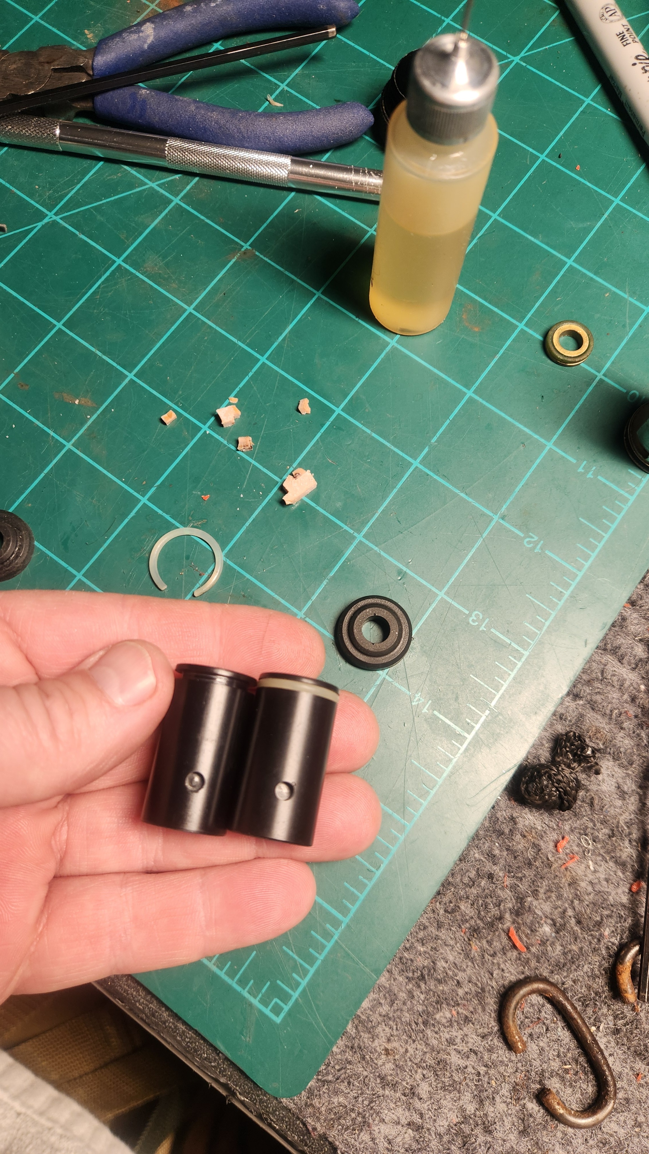

                    I don't think the parts had been swapped out. The seller is clearly a surplus dealer for old .gov equipment, not a pball vendor. I also see no toolmarks, and the aging I see in orings and screws looks consistent throughout. The pics show the valve fittings and valves from the sa-200 and the two clapped out carbines. One of the old carbines has a valve fitting with a larger hole and a slightly different seal contour. The other one and the sa-200 are indentical aside from wear.
                    ​ Click image for larger version
                    The valve with the stem is from the sa-200. Its a standard cvx valve.

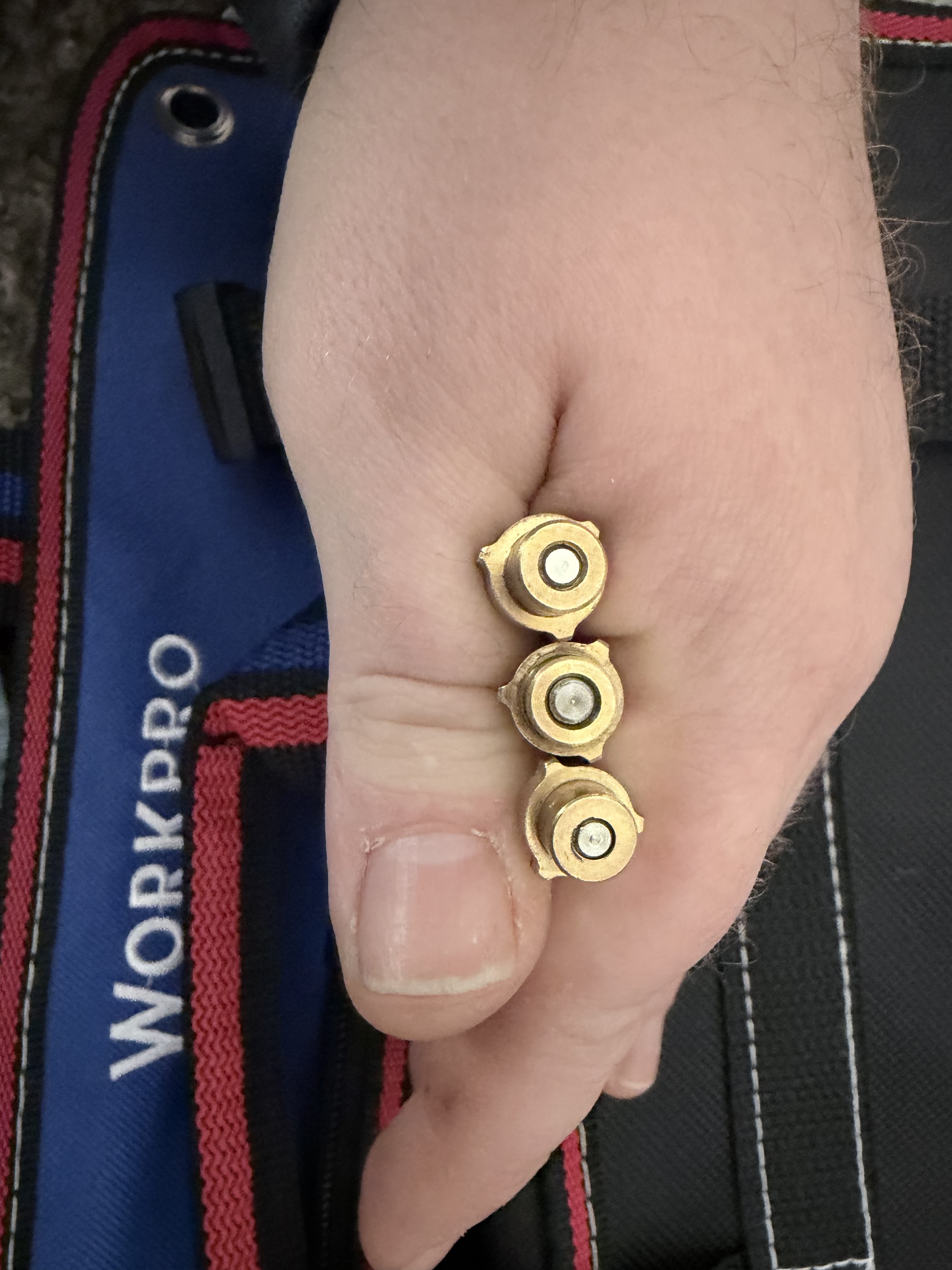

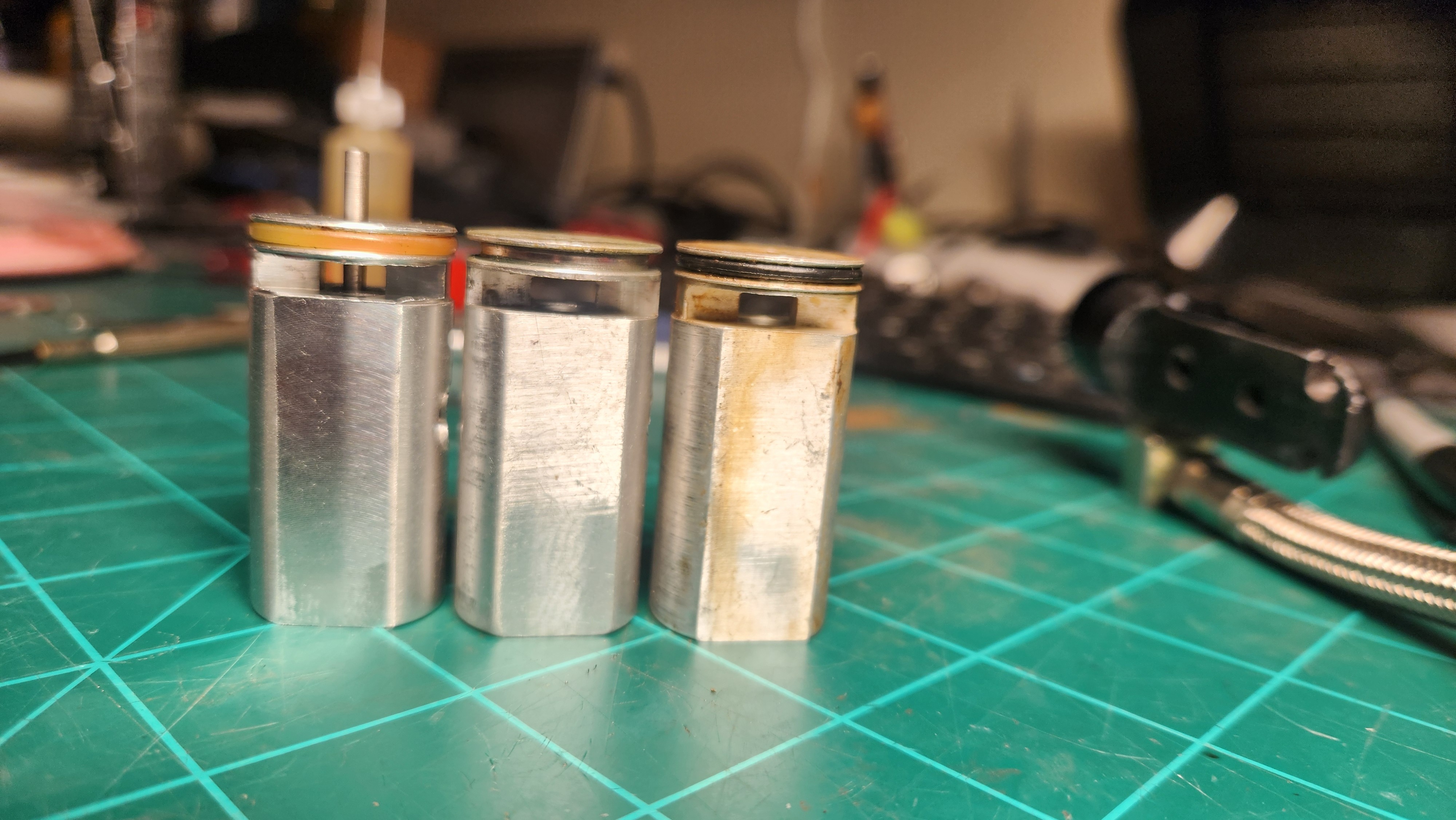

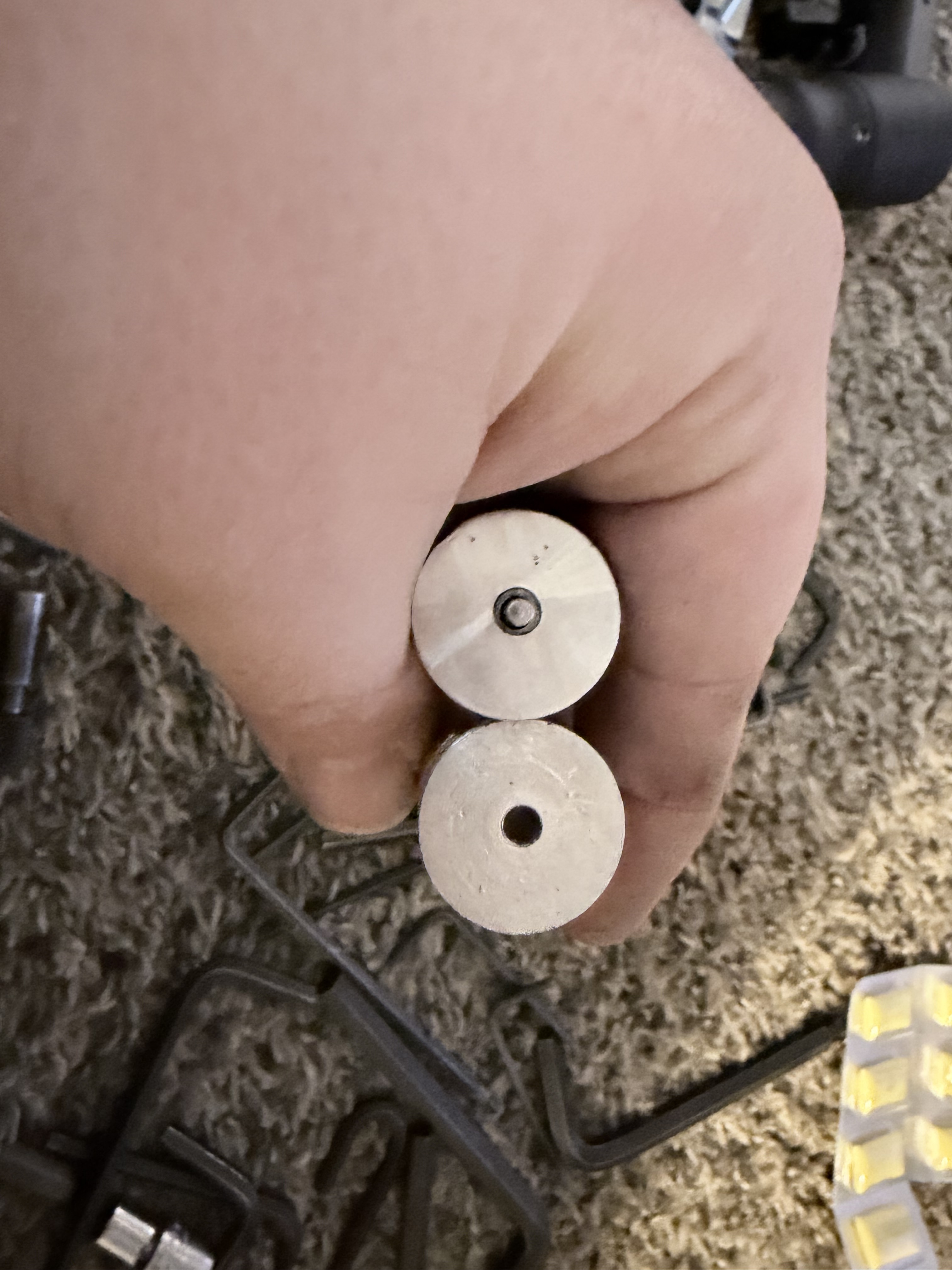

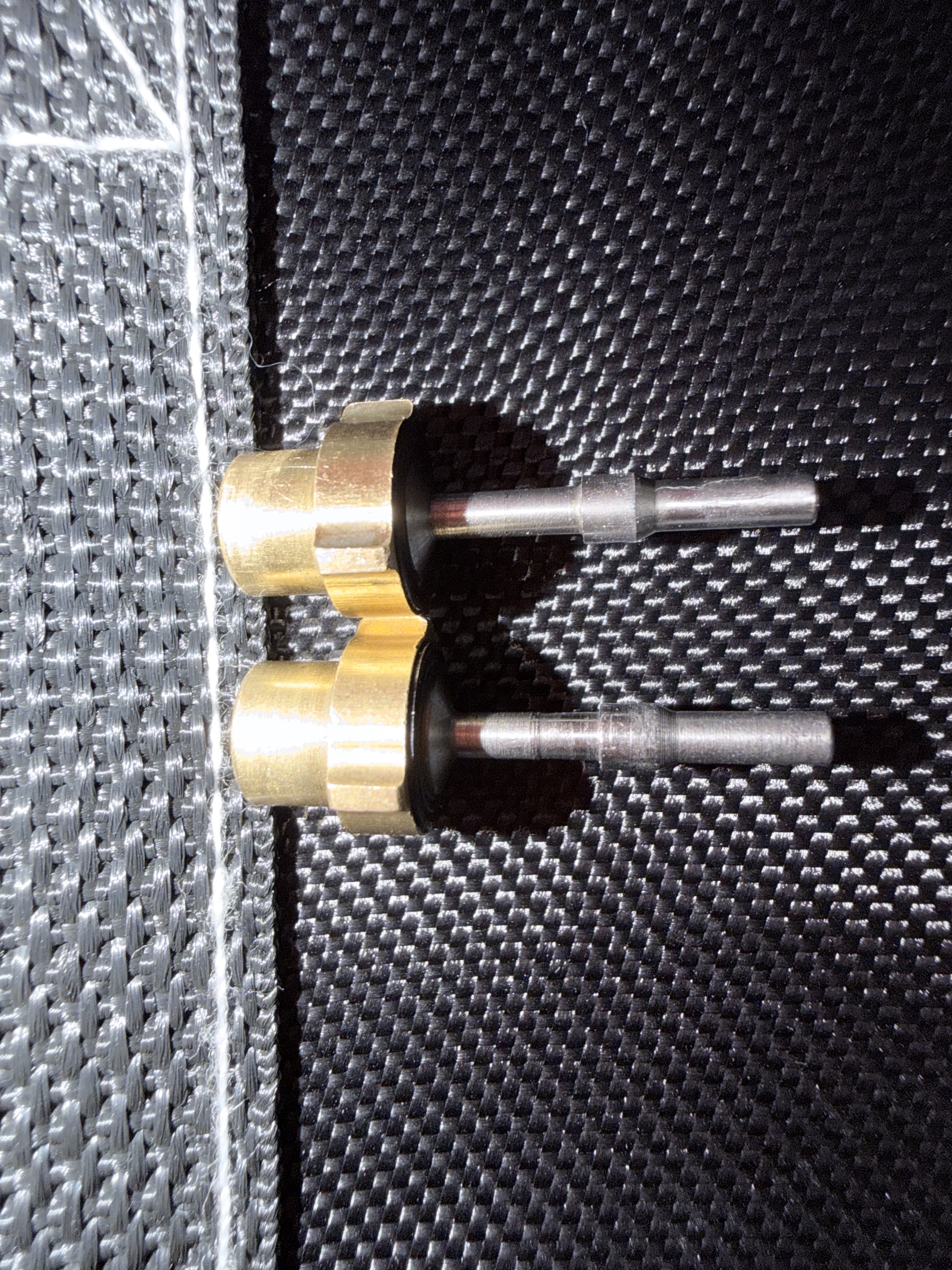

                    Here’s a comparison of just the valve stem compared to an average PL-98 that I forgot to post. The SA is slightly longer with a thicker collar.
                    A pic with the SA valve stem in the middle shows it has a different bottom than the 2 stock stems.
                    Then there is a pic of the blowback channel compared to the stock valve. The SA has a sleeve machined in to it to decrease blowback allowing more air to go down the barrel.
                    I don’t have a pic of the valve spring but it should be silver’ish in color and lighter than stock.

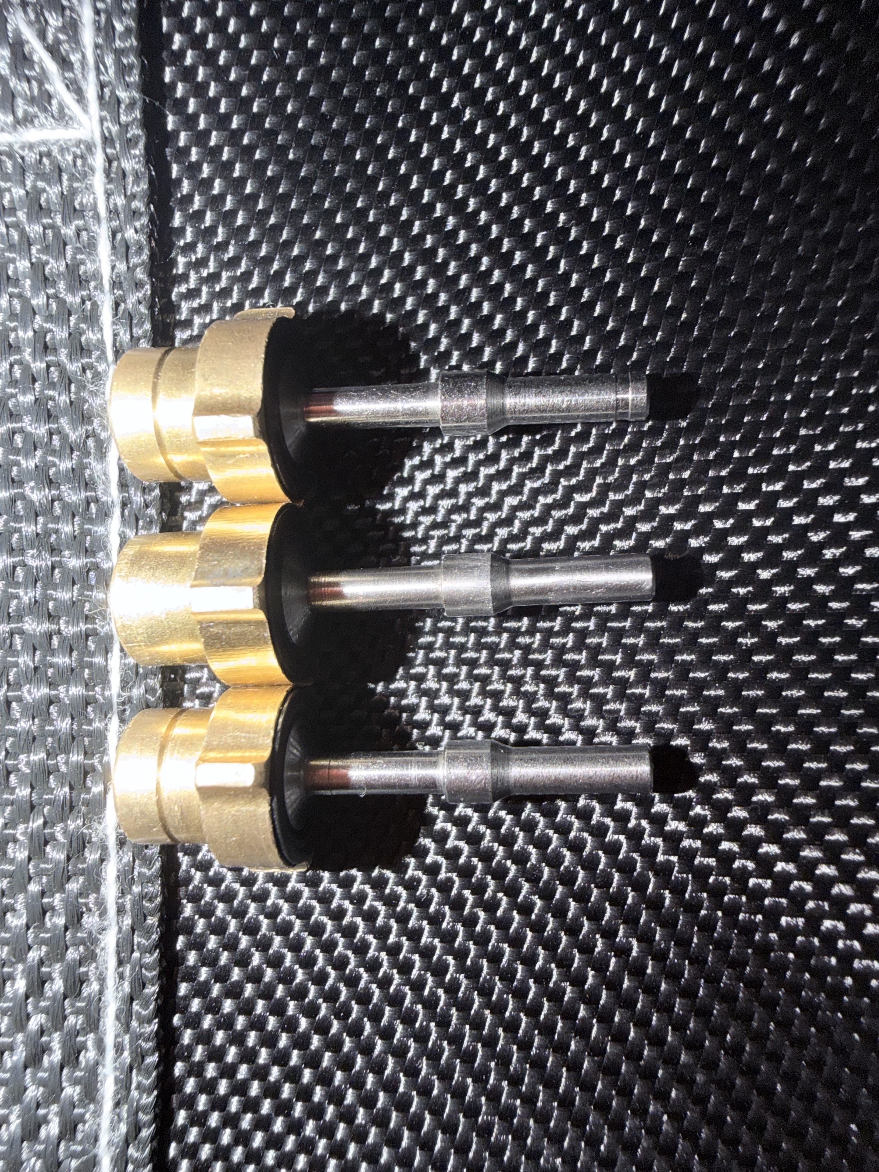

                  • FlightMedic938
                    • Feb 2023
                    • 437
                    Here’s a pic of 3 different stems. A TA10052 on top, SA in the middle, and stock on the bottom. Each has subtle differences in length and collar geometry that change mechanical dwell.
