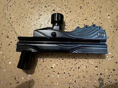

          You should buy these pneumatics. This is a stock WGP front block from a 2k4 prostock. They're really good quality and this is a great deal on them.
