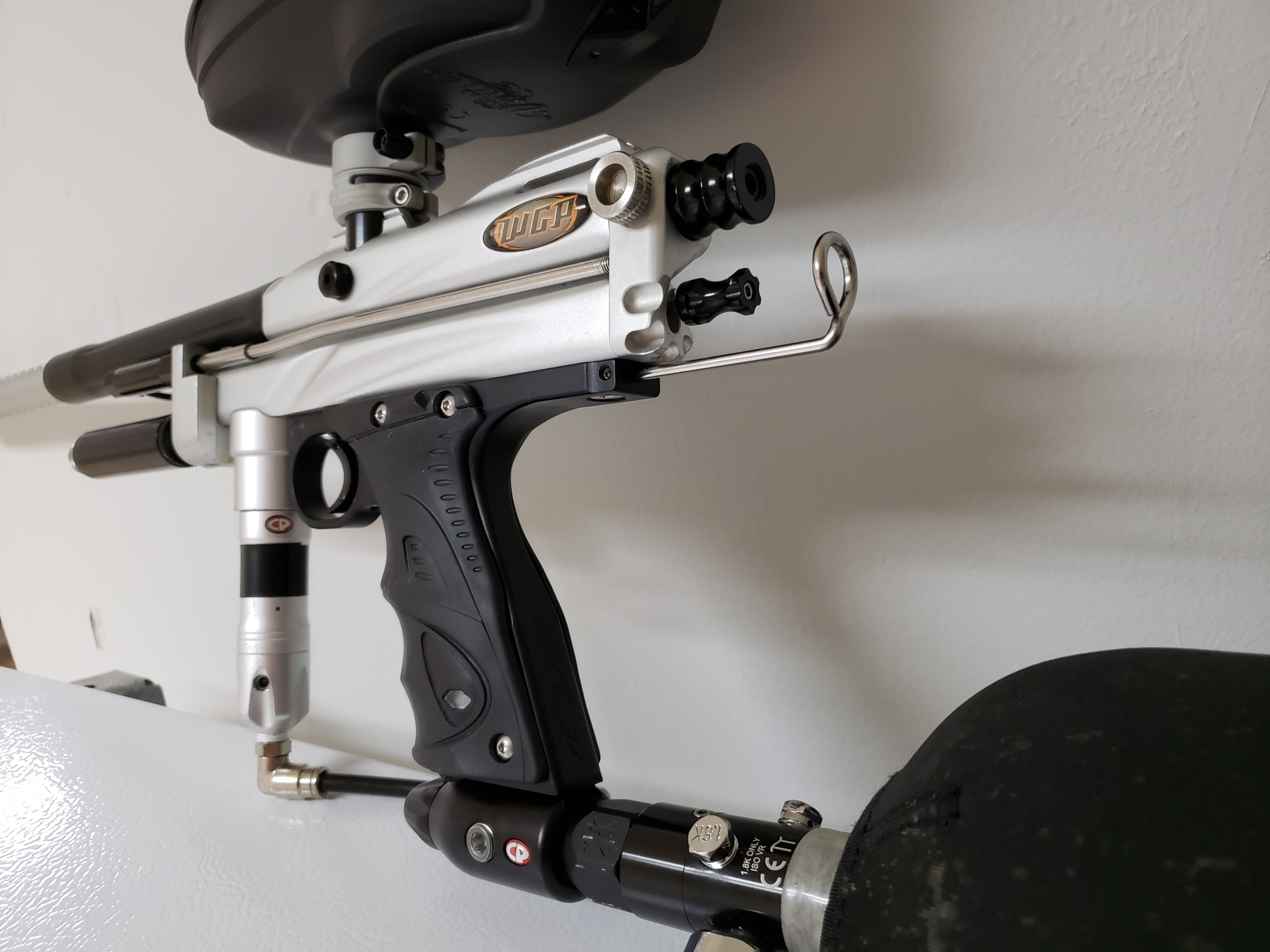

          I'd say so, If you can build/tune a cocker, you'll be very adept at working on other guns if you wanna find stuff you like to work on. I got this project build at my local field from a guy that wanted to try mech/building his own cocker, but lacked the drive/tinkering willingness to get it going. Got it for 200 bucks with the right feed body, dye frame, sconi metal elbow, full inception pneumatics, and a stock reg, I added the asa/upgraded reg for me. All it needed was a 3 way o ring and timing the 3 way. Having some knowledge about the guns your interested in can help you pick up a good deal once and awhile.

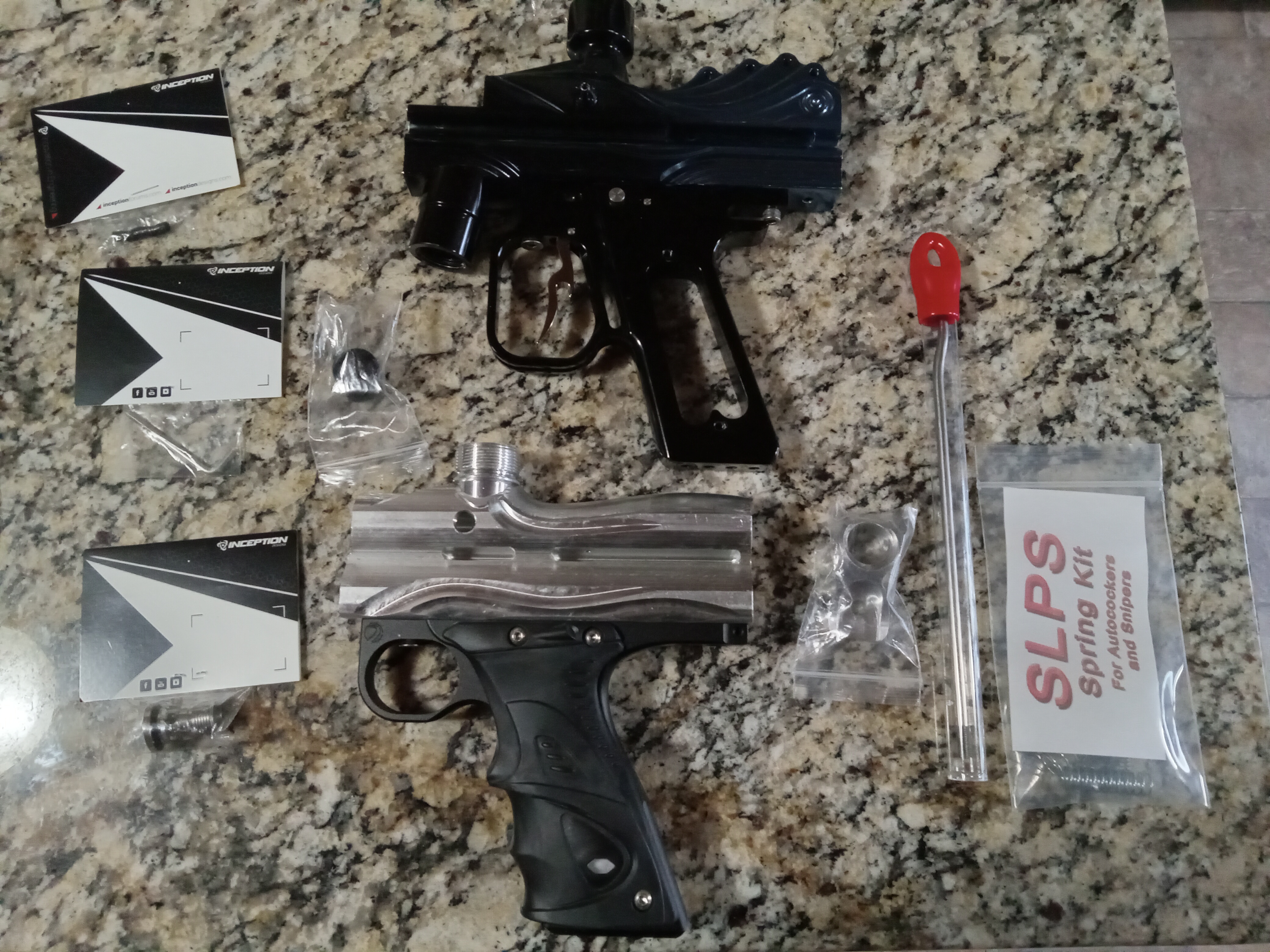

              So what was that yall said about starting a build...buying parts....buying more parts and then buying more of parts you already have, well o kinda fell down the rabbit hole πŸ˜‚
              found this new in package mini orracke body for $80, its drilled but i really dont care, never thought id own an orracle either but here i am with a brand new body, and the dye frame is oh so nice, i hope this thing stays pretty light to, the eagle body ima turn into a pump

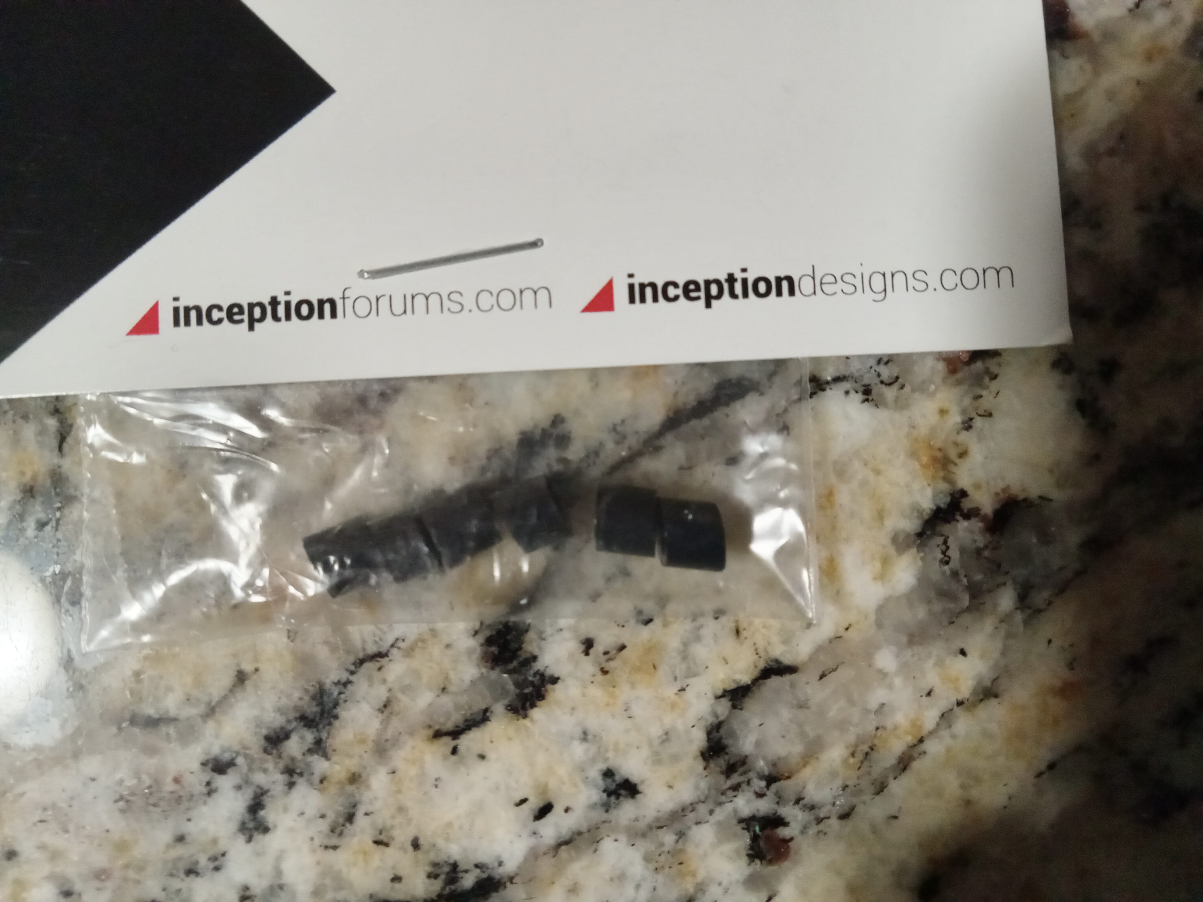

              Got some ID parts as well, thought the cocking rod was for a mini but turns out it's for a full length cocker, also what are these little plastic ring things, only thing I can think of is front hose retaining rings or whatever yall call them
              • heyzeus
                heyzeus commented
                The plastic rings are collars that go over your pneumatic hoses where they attach to the barbs to help the hoses stay on. Personally I don’t use them but I use different hoses than the ones Inception Designs includes with their parts.
