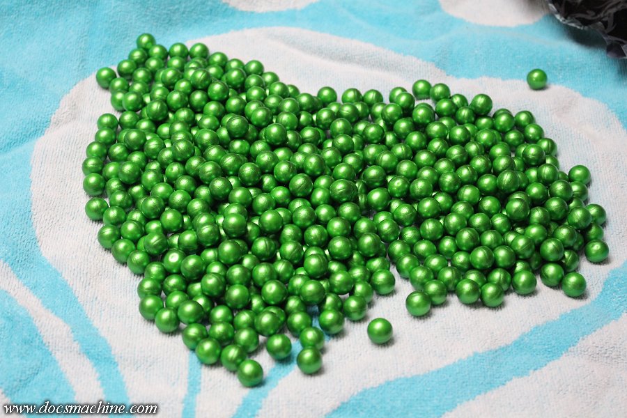

                In anticipation of getting this thing up and running (at this point... maybe Thanksgiving-ish?) I picked up some paint. I only found two stores online that listed .50 cal in stock, and wound up getting a case of GI Sportz off eBay. The bags were clearly worn a bit, but the price was cheap enough that even if I couldn't use half of it, it was still a decent deal.
                Got it in yesterday, and each bag, as expected, has some wet paint rolling around in there, and some obvious lumpiness, but I wiped it off with the usual rolling-in-a-towel trick. Yeah, it's a bit lumpy here and there, but I'd say 90% good. Interesting thing was, I found a small sliver of shell, but no actual broken balls.
                Plenty good enough to test-shoot this badboy, but I'm curious if anybody can guess how old this stuff might be. No "born on" date on the box or bags that I can see, GI Sportz isn't coming up for me online, and any dealer that has the stuff listed, says it's out of stock. Even Amazon. (I can find Empire and JT paint, but again, this stuff should work.)
                Mic'ed at .496" at the biggest dimension, if anyone cares. I bored my prototype barrel at .500"... maybe I should get a .495" reamer, too.
                Doc.
