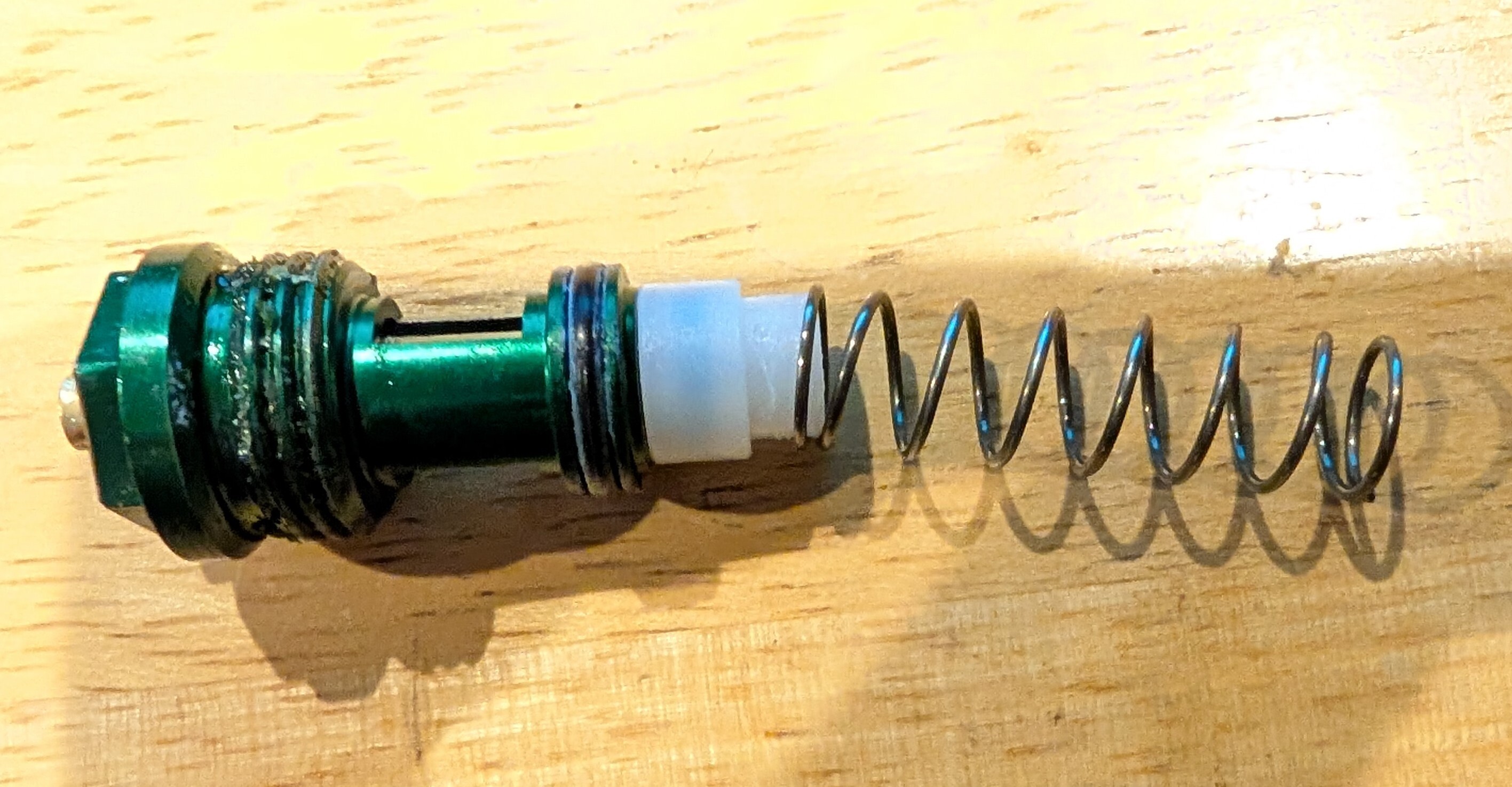

        #72
        Thank you everyone for the responses. I appreciate it.
        I installed the valve tonight. I installed it so the valve lined up centered with the valve retention nut meaning the upper portion of the valve is lined up with the air transfer port perfectly. That was about a 1/8th to 1/4th turn from "fully tight" in my body. I know this can vary based on every body so I was not surprised. I put some blue loctite on the valve threads as well as the valve retention thread. I made sure the valve retention screw was not contracting the valve or its internals. I screwed it in until it was just past flush with the body. In fact I could remove the valve without removing the valve retention screw. I know with the Nova valve that screw is strictly there to seal the valve chamber so I don't think that is my issue.
        I set my inline reg, an AKA Sidewinder, to output 200 PSI. Yes, I have a gauge setup to properly test regulator output pressures. I cocked the hammer to make sure there was no pressure on the valve. I gassed it up and it was leaking down the barrel. I degassed it and turned the regulator up to 300 PSI. It leaked even worse as I expected. I then removed the hammer and fully tightened the valve into the body disregarding it lining up properly with the air transfer port just to see if the leak was because the valve was too loosely installed in the body, Nope. That didn't help either. It was still pouring air out of the barrel which means the valve is not sealing of course.
        Unfortunately I am out of air to do anymore testing for now. I will try to get some air this weekend. What am I doing wrong or what should I do next rather?
        Edit: Is it possible I didn't give the blue loctite enough time to cure and that is the reason for my leaks? It absolutely could be because I applied air to the valve withing minutes of installing the valve. I definitely didn't give enough time to cure since I thought the loctite was mainly there for vibration reasons not sealing. To eliminate this as a possibility I am going to remove the valve and the valve retention nut now, reapply fresh blue loctite and reinstall everything. I will then let it sit for a long time before testing again. I doubt that is my issue though because it sound to me like it was leaking down the barrel like a valve that isn't sealing.
        Edit 2: I uploaded a photo showing how the valve spring was cockeyed on the valve cup seal when I removed it. Could that be the reason? The spring doesn't seem to sit perfectly on the valve cup seal? I don't know why but that is the case with my valve. According the photos on the Nova website the spring sits at the base of the cup seal and not around it like it looks like it should to me?
        Edit 3: I found other photos online that do show the spring sitting around the base of the cup seal as it would in a standard valve. I also saw Docfire's video when he mentioned he turns down the base of the cup seal a bit so the spring isn't such a tight fit.
        • beekermartin
          beekermartin commented
          I thought the spring was supposed to fit around the base of the cup seal but I didn't want to force it. I will force the spring on tonight. I will also check the condition of all the seals.
        • docfire
          docfire commented
          did you put loctite on the oring????
        • beekermartin
          No. I did not but Locitie on the o-ring. That is Dow 33 grease. It looks blue in the photo but I assure it is not. The macro lens in my Pixel 9 Pro XL doesn't appear to take great pictures. It is a new phone so it might be operator error.
