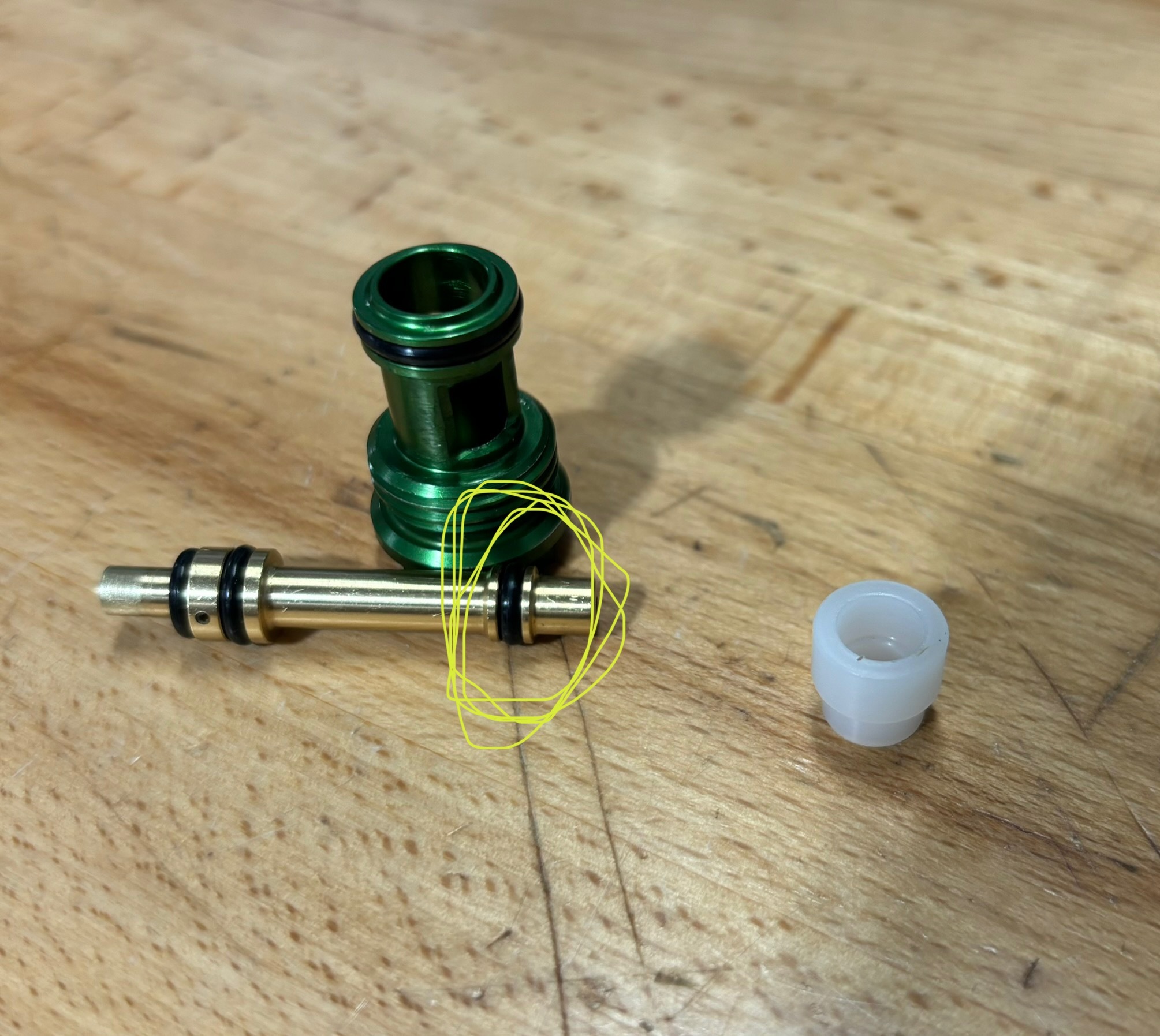

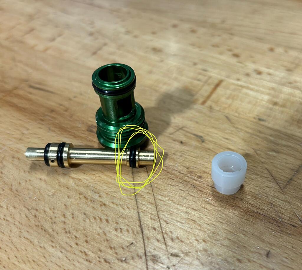

      Originally posted by Frmrspec
      this is the oring that was clipped
      Is there an owners manual or schematic that shows what size every o-ring is? I haven't been able to find one.

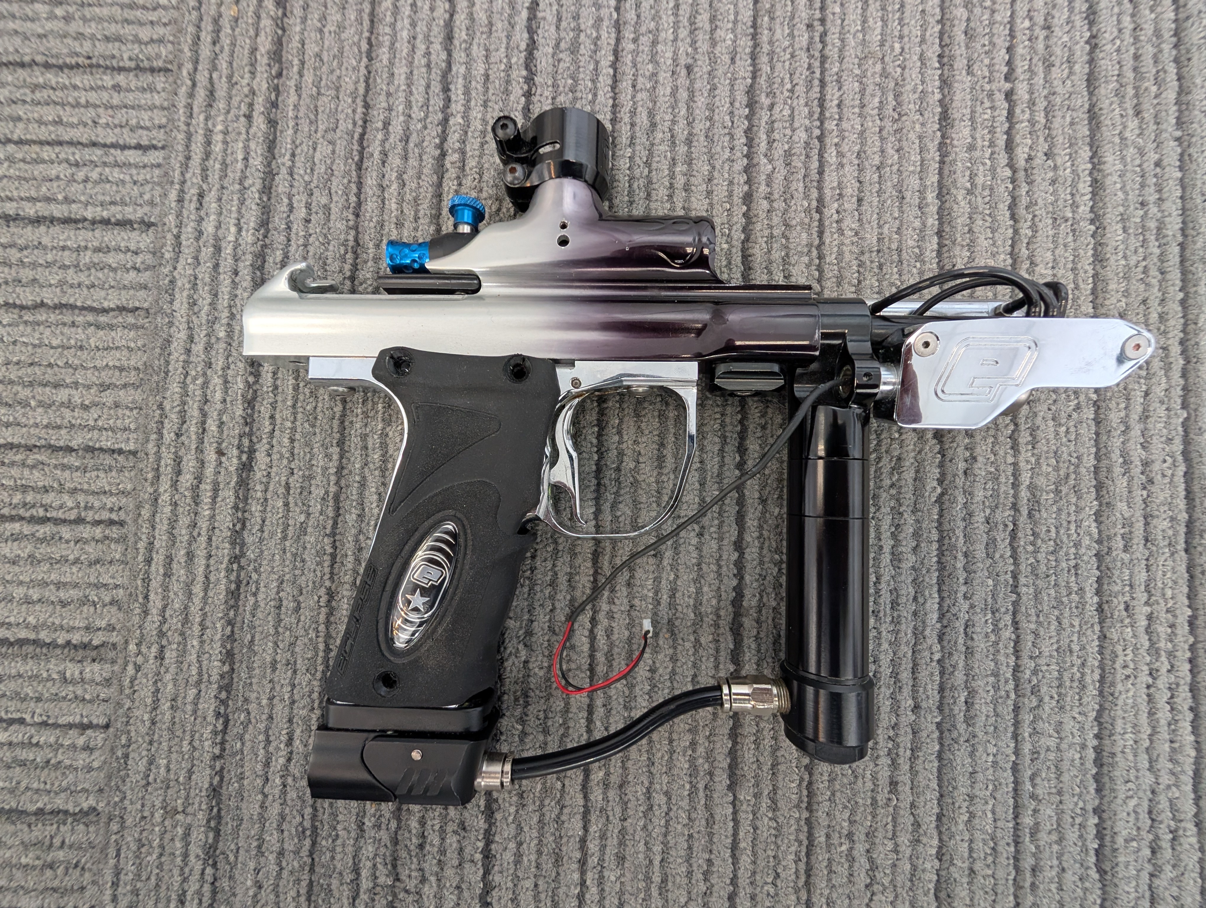

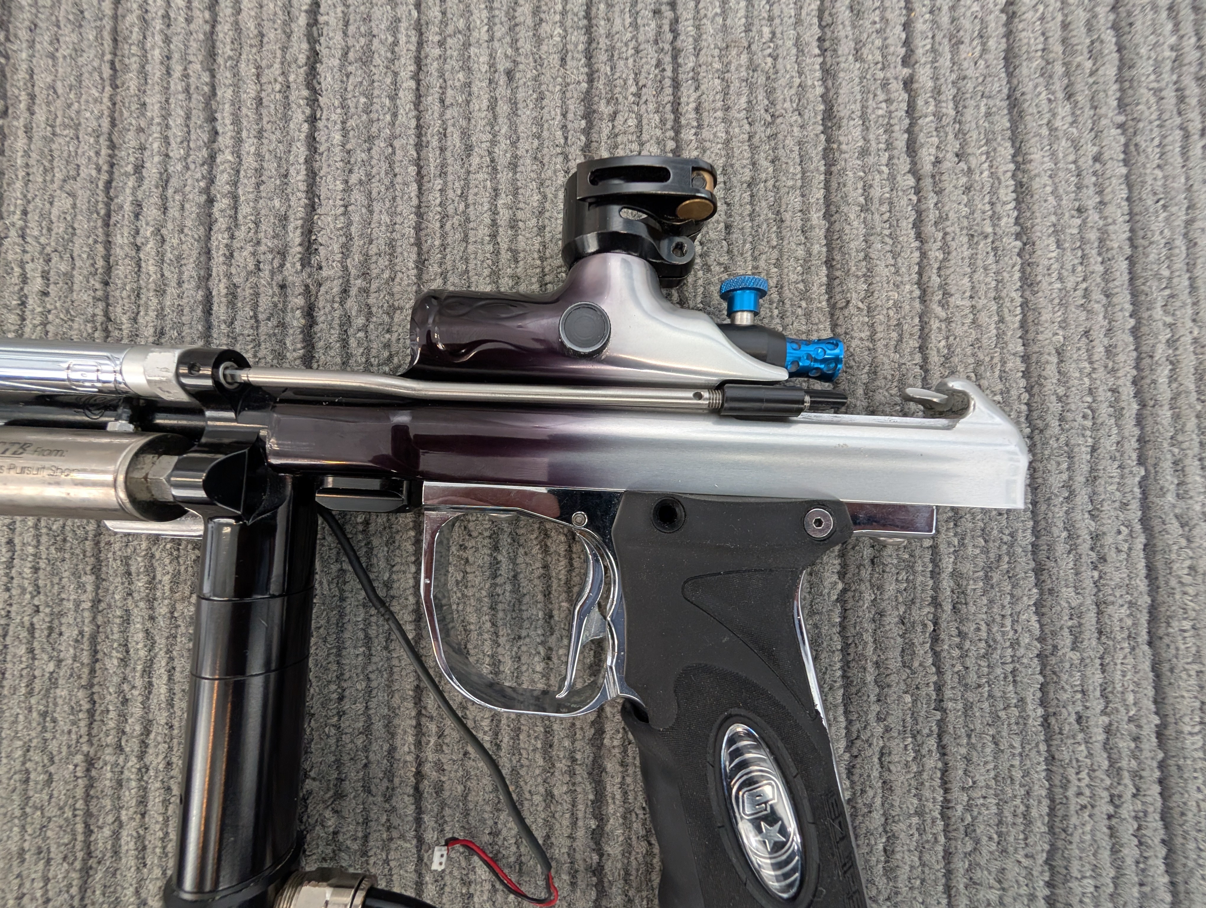

        I am running into other issues with the Nova valve which might make it not compatible with my body. It is a midblock body. The hammer pin contacts the points of the hex nut of the valve if the valve is installed with a point at the 12 o'clock position. On my valve that is where it sits being close to fully tight with the opening in the valve lining up with the air transfer port perfectly. I have to turn it so the valve points at 10 and 2 so the flat spot of the valve is horizontal. If I set it that way the pin doesn't contact the valve. The downside is the air transfer port won't be lined up perfectly which might hurt efficiency some. That isn't a big deal of course.
        I still haven't gotten any air so I haven't been able to test the valve sealing again. If the valve does seal then I will go further into tweaking the bolt distances adjusting the sled and the ram/pump arm connection to get it set perfectly where it won't hit the valve or the body in both ends of the stroke. The issue is I don't think my body was milled far enough back causing the range to be difficult to get perfectly set. First step is see if the valve will seal. If it won't then the Nova valve might not be an option for this body.
        Here are a few pics of the body I am using. The bolt I am using is made by Shocktech and obviously doesn't match the body. I am planning on having a better fitting bolt made as well if I can get a mechanical valve to work properly. I have only used an MQ valve with this body previously.
          Cdn_Cuda commented
          Could it be an issue with the hammer? I have my Nova valve in half block using a CCM long hammer and haven’t had any issues.
        • William the Third
          William the Third commented
          I ran into the same problem in Post 51. Indexing is nice, but really not required. In testing I saw no real significant difference in however the valve ended up, be it opening at 12/6 ("least restrictive"), or opening at 9/3 ("most restrictive").
        • beekermartin
          beekermartin commented
          It is not an issue with the hammer. The pin that holds the bolt and pulls the hammer back is contacting the valve if the valve is indexed with a point at 12. If I index it with the points at 10 and 2 the pin doesn't contact the valve. Since it doesn't matter which way the valve is indexed that shouldn't be an issue.
          I will be sure to post an update once I have air for more testing.
