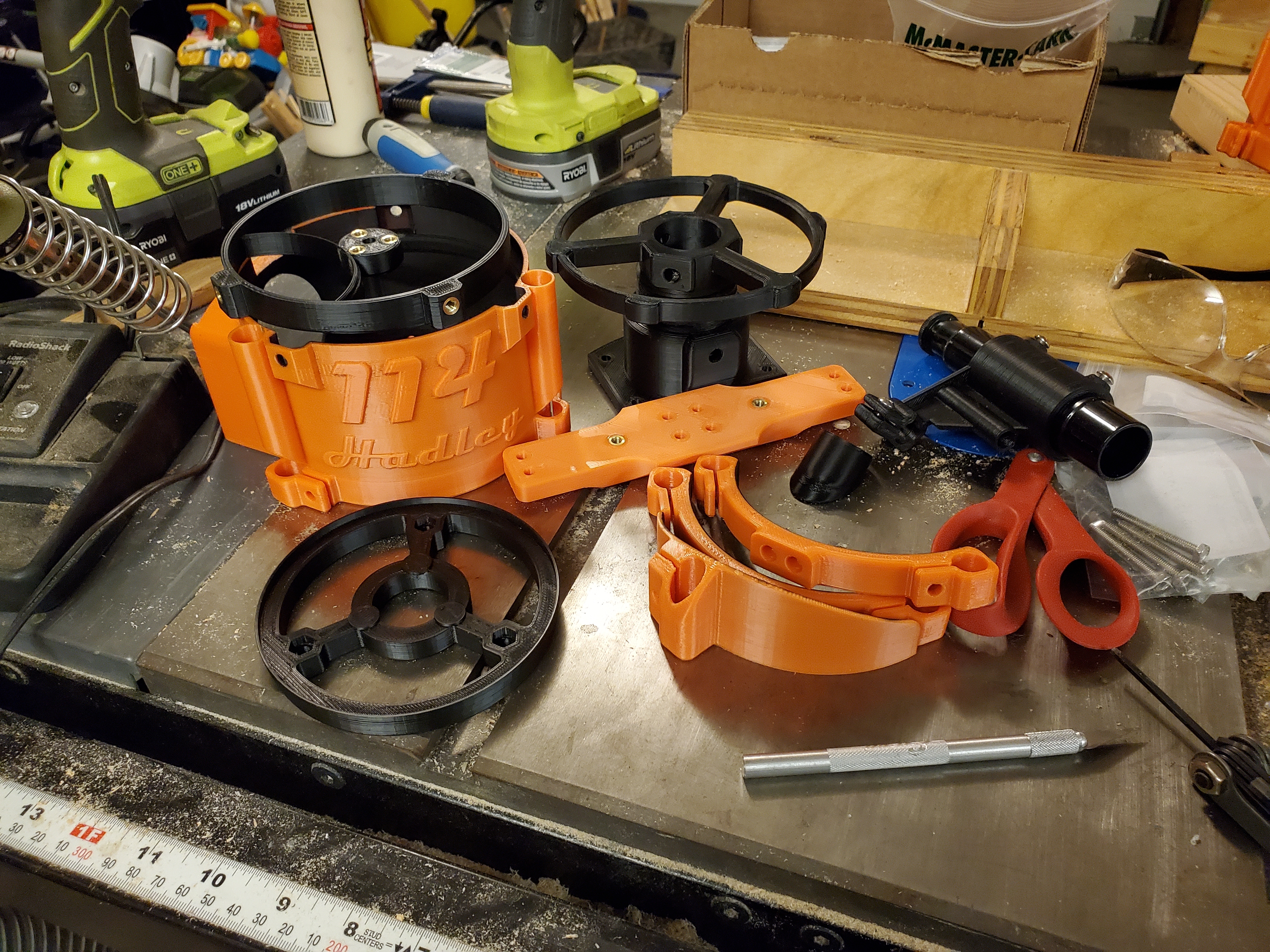

      Some pieces I've been printing over the past week.
      • Jackson
        Jackson commented
        Wexford. I've got one more big +6 hour print left and a number of smaller items.
      • Spider!
        Spider! commented
        Lol, I thought I recognized the parts, just couldn't remember.

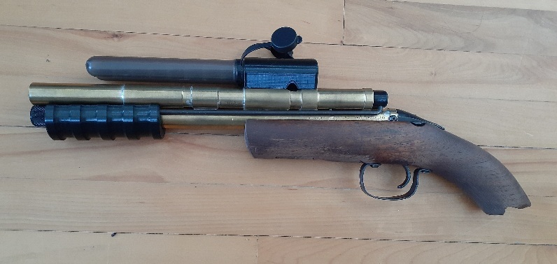

      #319

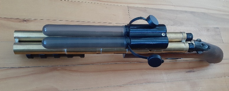

      Brass work was done by Jordan from a PMI 1 and a PGP.
      3d printed the pump handle, both bolt and the double cram and jam

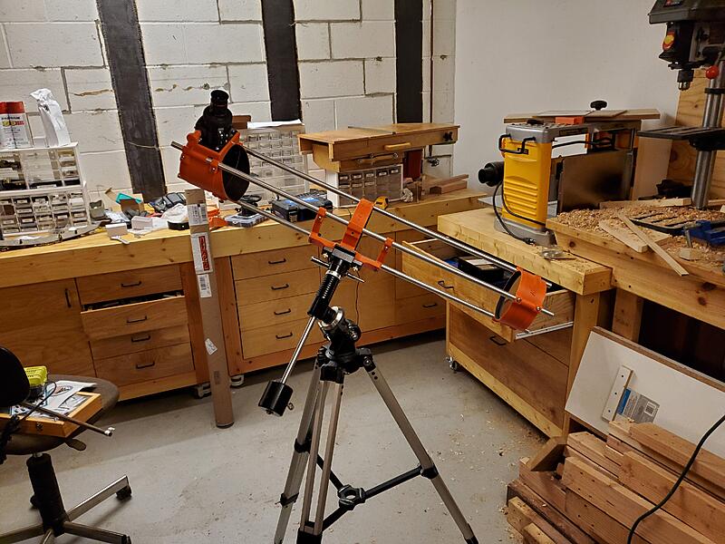

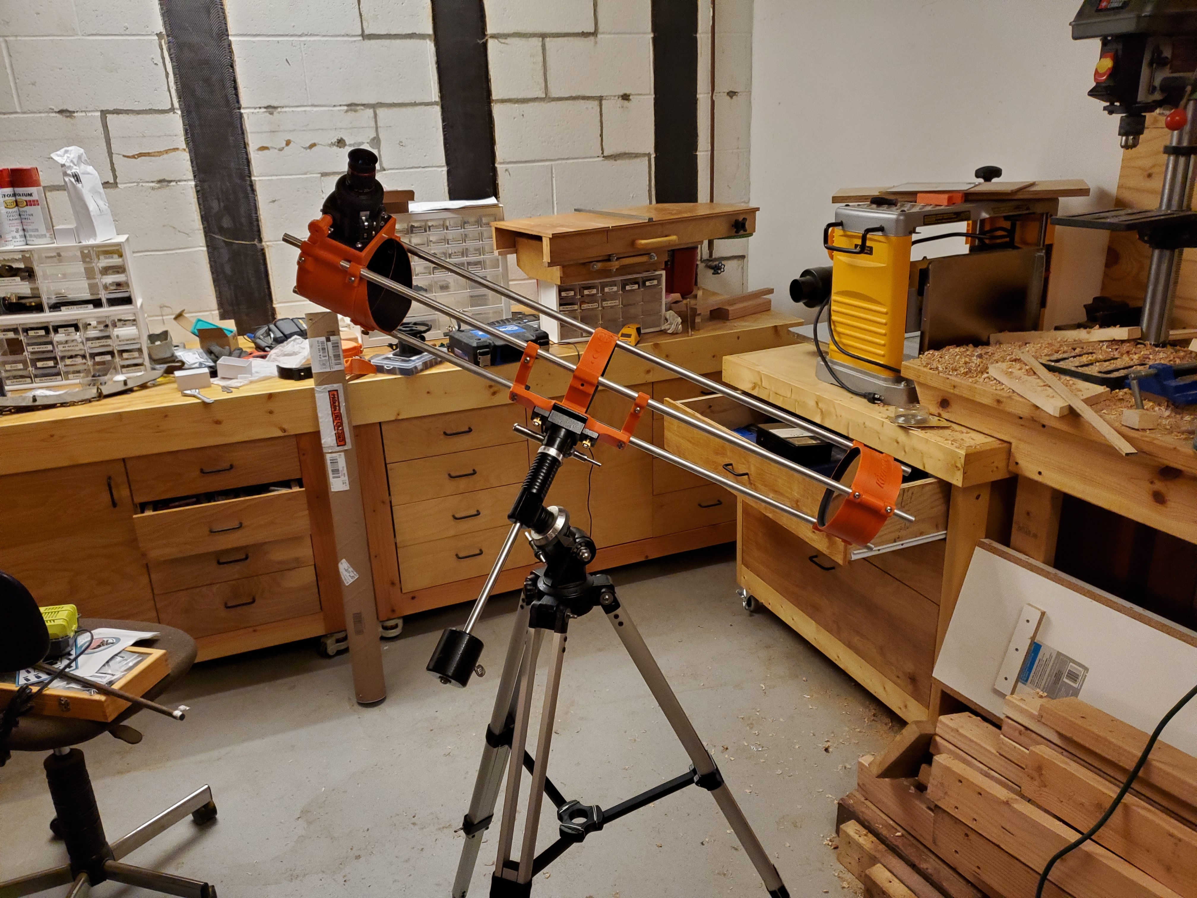

        #320
        Got the telescope mostly together. Still a number of items on the list, but together enough to start looking at the sky. Grabbed a really crappy picture of Jupiter and its moons with my phone. It was way clearer by eye. You could see red bands on Jupiter.

        • pghp8ntballer
          pghp8ntballer commented
          Awesome! Not including the cost of filament, what was the build cost? Or did you already have the optics and hardware on hand? Is that a standard camera tripod that was modified or is it a universal telescope tripod?
        • Jackson
          Jackson commented
          I've probably got about about $350-400 into it. You could buy an equivalent telescope for less. I made some changes to the design to the design to increase usability/durability/etc that added cost.
          The tripod is from my childhood shitty 80mm refractor telescope. It's pretty bad actually. There are tight spots in the axes that make moving it difficult. I need to upgrade that.

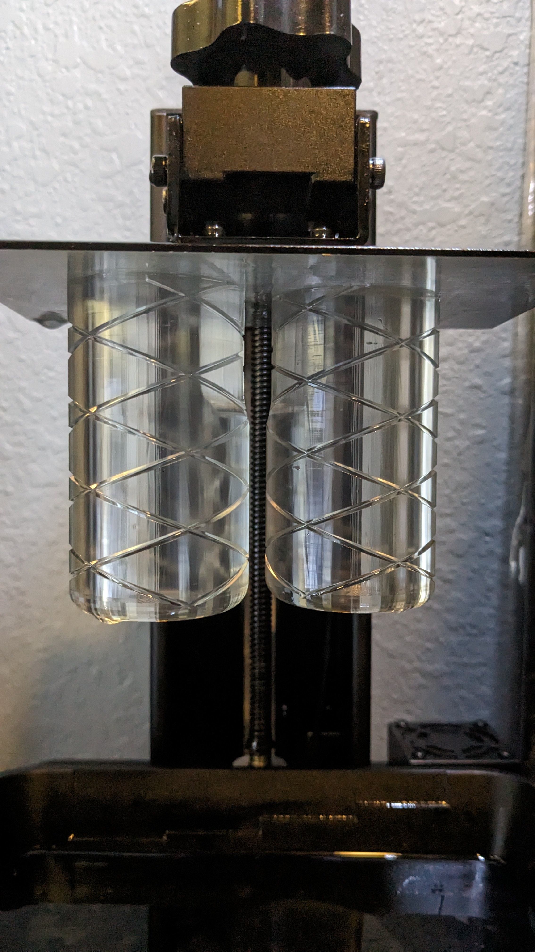

          Testing out clear PGP handles 😁
            XEMON commented
            Thanks for the support.
            This resin stays relatively clear, but it does get a frosted exterior after the wash. It need post processing to be transparent. I'm working on some those processes right now. I have 2 solid contenders ...
          • Brandon
            Brandon commented
            From what I've heard that if you wash, cure it, then brush it with some of the resin, and cure it again that it'll stay pretty clear but I haven't had the time to test it.
            XEMON commented
            It works, but the clear resin tend to bubble and streak causing a rough exterior. I am trying a few different brushes and some other coating to get the same results. Will see how it turns out 😜

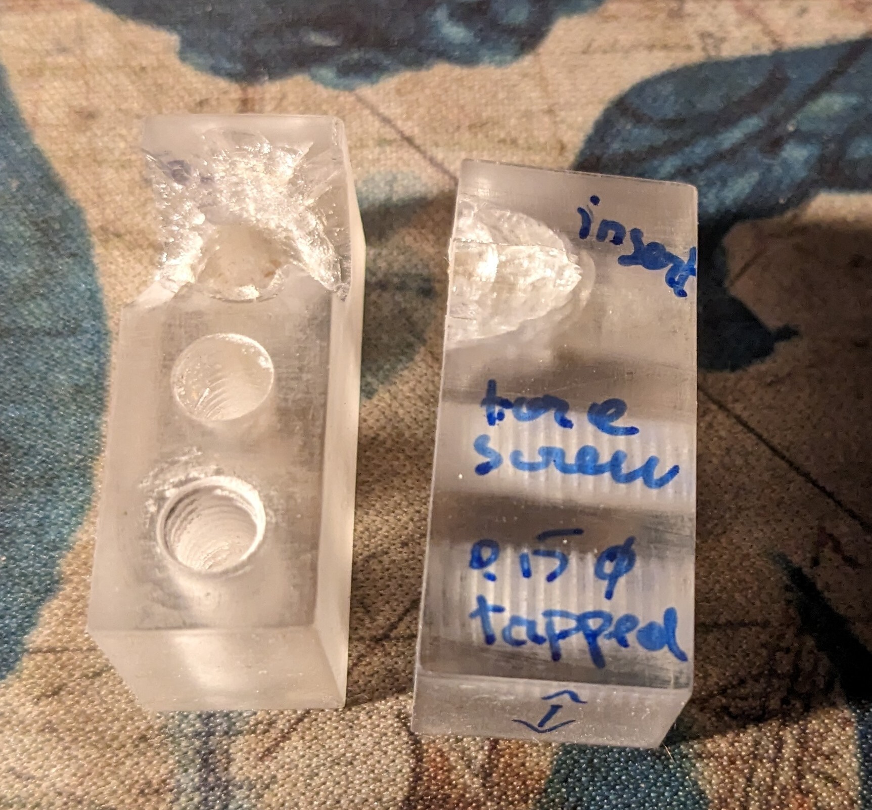

          Does resin melt well with heat from a soldering iron? I use melt-in brass threaded inserts on my pump handles.
          My Feedback Thread
            XEMON commented
            I'll have to give them a go and see if I can replicate it, but so far it seam very different from one resin to the next ...
            BrickHaus commented
            So from that video he seems to say printed threads are the strongest. In the comments people mention printing threads for keen inserts and threading/ setting them in resin.
          • Brokeass_baller
            Brokeass_baller commented
            I had to Google what Keenserts were. At work, we call them Nutserts. If the resin threads are strong enough, the Nutserts are the best way to go. It's what we use after Helicoils fail, and they're quite robust.
          Frenchy is here!
          • 3029
          • Nor Cal
          #325
          The black resin takes them ok but the clear ... not well 😅
          Here are my threads test in 8-32:
          Click image for larger version  Name:	PXL_20231019_130152413~2.jpg Views:	3 Size:	554.2 KB ID:	461713
            XEMON commented
            The heat crumbled the resin ...
            The hard wood inserts are the next step if the printed one don't hold up. But they all use proprietary male threads so I'll have to reverse engineer those to ensure proper fit
          • JonM
            JonM commented
            I wonder if it would be effective to design a part with a pocket for the insert, print it, then set the insert using epoxy resin or UV resin.
            XEMON commented
            CNC Kitchen did some great test on that RAZRBAKK posted the link above 👍

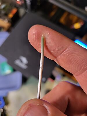

            #329
            Fired up my printers after months of not even considering their existence. Couldn't get either to print a link. I'll have to mess with them some and see if it's something simple.
            So, the best thing I did with my printers all night was this cold pull.

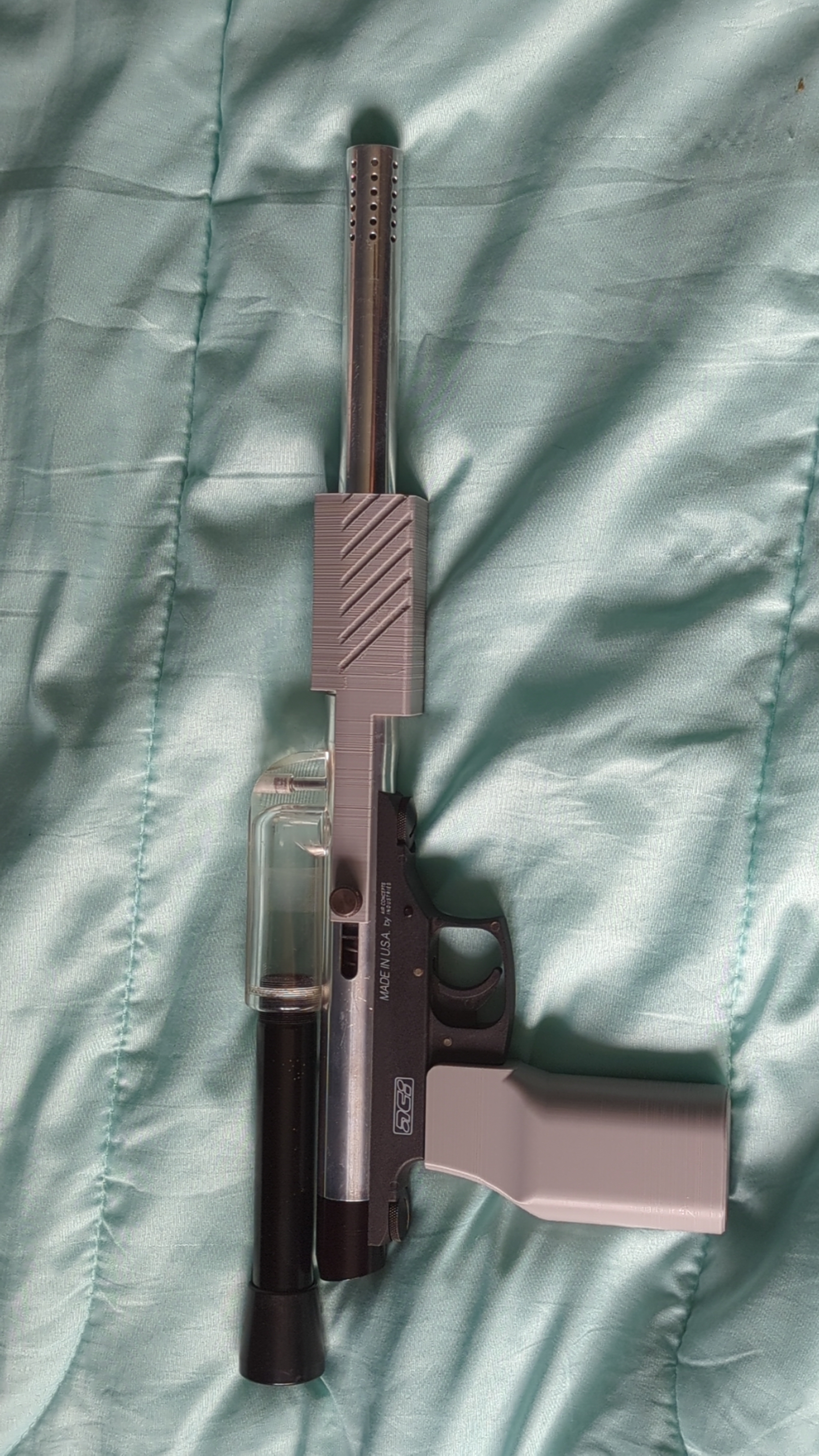

              #330
              I've been experimenting with some ghost ring alternatives. Really enjoying this translucent filament.
              It's difficult to get a good shot of the sight picture, but I opted for fiber optic filament instead of the usual post.
              If anyone is interested in trying one of these, I am working through cleaning up the print a bit and have a ton of this filament, so I'd be happy to throw a few of these together at cost to see what people think. Can and will do black/CF-black.
                BrickHaus commented
                Does it mount on a dovetail? If it does I'd take one. Got a few shooters I'd maybe use it on.
              • RAZRBAKK
                RAZRBAKK commented
                BrickHaus I'm honestly not sure. I looked into it when I was trying to get accurate dimensions. Maybe I'll print a dovetail and test it out.
                BrickHaus commented
                It looks like a dovetail. But not sure if a cci feed tube is a dovetail.
                But yeah I'd buy one if so. I have a few brass based guns with rails.
