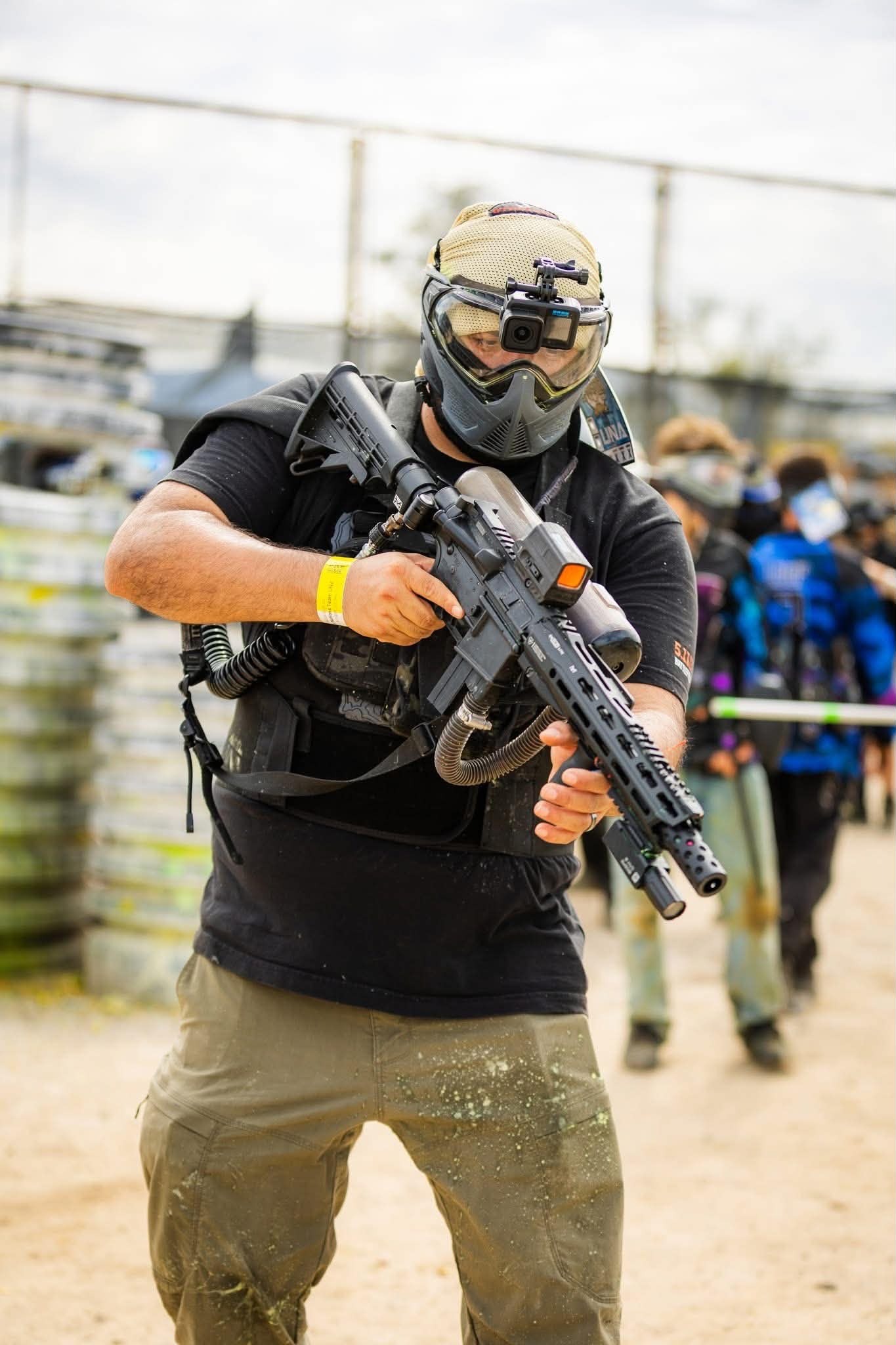

        I wanma thank Levi for getting me hooked by showing me the qloader at supergame this year. I got one, i fiddled, i faddled. It works BUT i noticed something. I have two types of pods. One with a darker internals and the other a lighter internals. The darker ones can do fullauto but the lighter struggle and i keep it at semi. When loading i can feel the lighter ones having a weaker tension on the spring. Is there a way to make em stronger?

          Howdy! That's a cool setup!
          It sounds like you need to adjust the pre-winds in your troublesome pods. I talk a little about this in post #3 of this thread. Also, this old Hustle Paintball video shows a decent walkthrough of the process. While you are at it, make sure the threads of the rotation limiters are clean and move smoothly. Dirty or corroded threads will add friction to the pod's rotation and can cause erratic feeding. To get a baseline reference you can try unwinding one of your good feeding pods while counting the number of pre-winds. From what I recall... the pods shipped from the factory with 10 pre-winds. In general I try to keep the pre-winds as low as possible while still feeding reliably.

            Yes, i spoke to someone and showed me the same video. I miss understood your prewind portion. I did fix one pod already. Im gunna test the others and then adjust them. Thanks again. Know anyone sellin pods?
