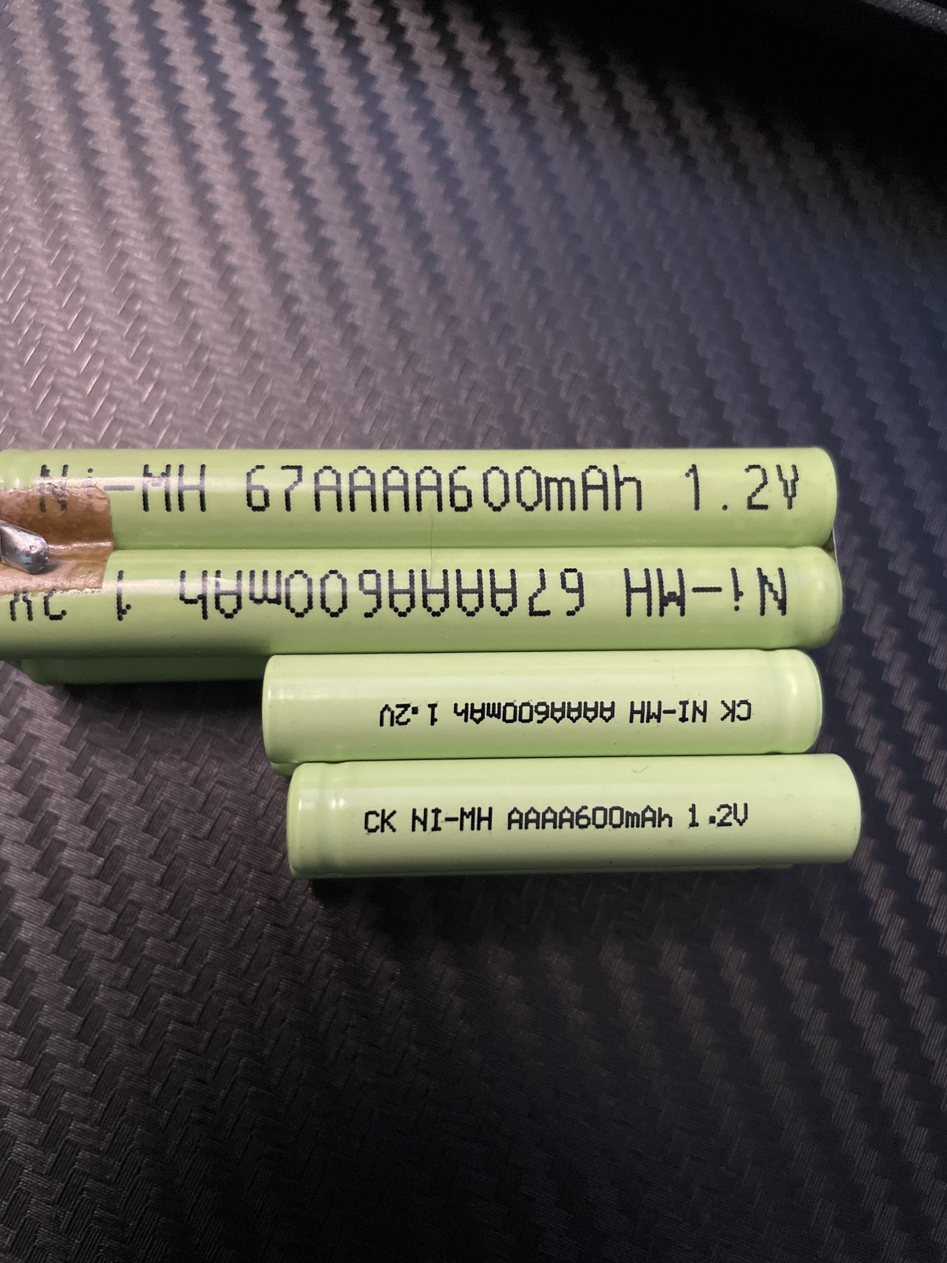

              Something aint right.. These are more like ⅔ AAAA but I’m going to build a few battery packs anyway. They are 600mAh so it should be the same energy density.

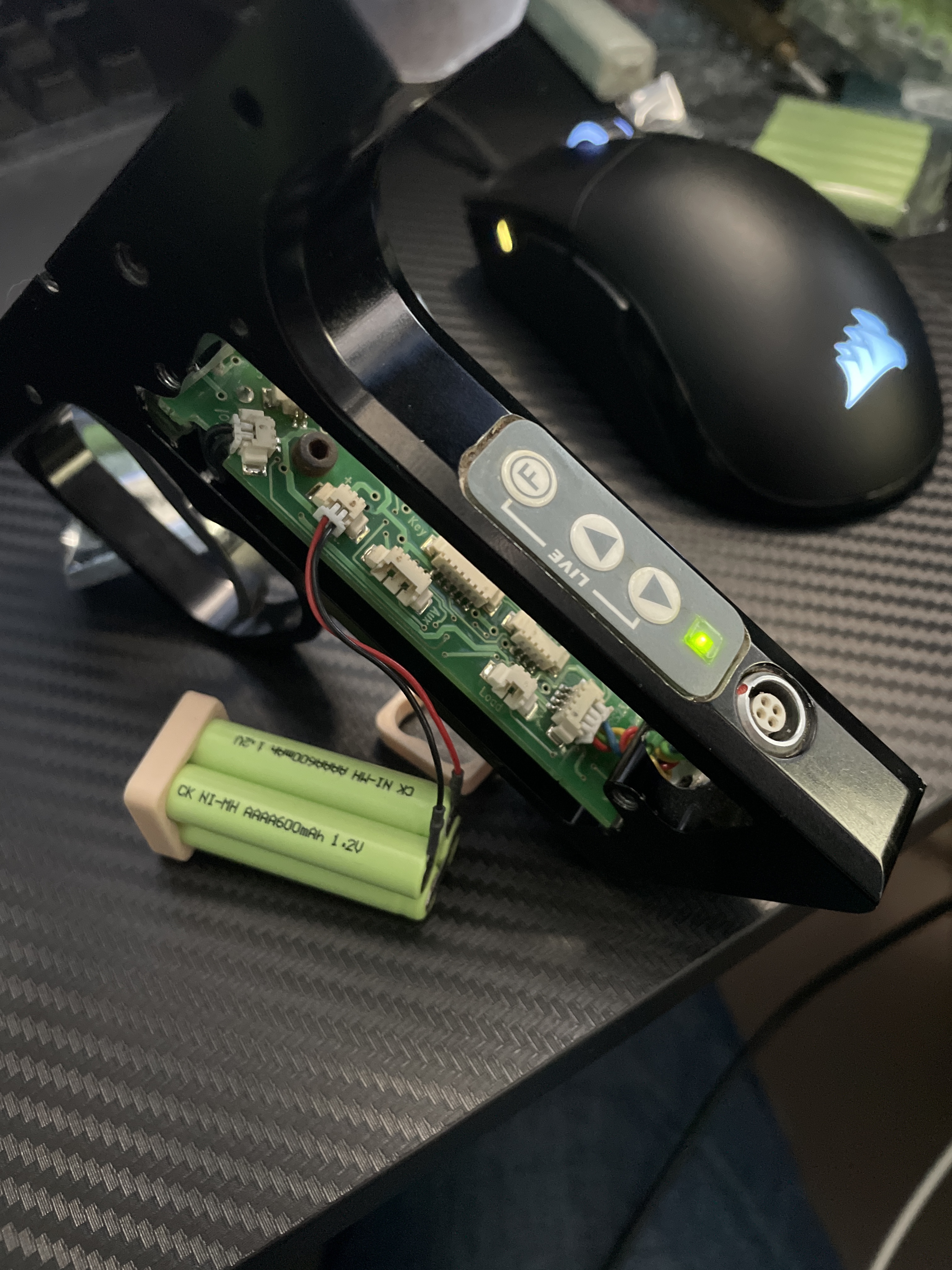

                Battery packs are good to go! I tested shooting as well
                i just need to get some shrink wrap. Click image for larger version
