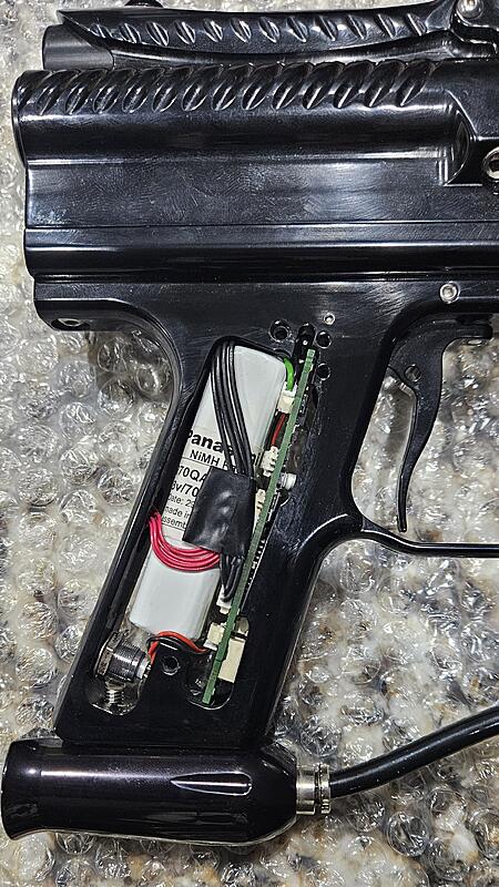

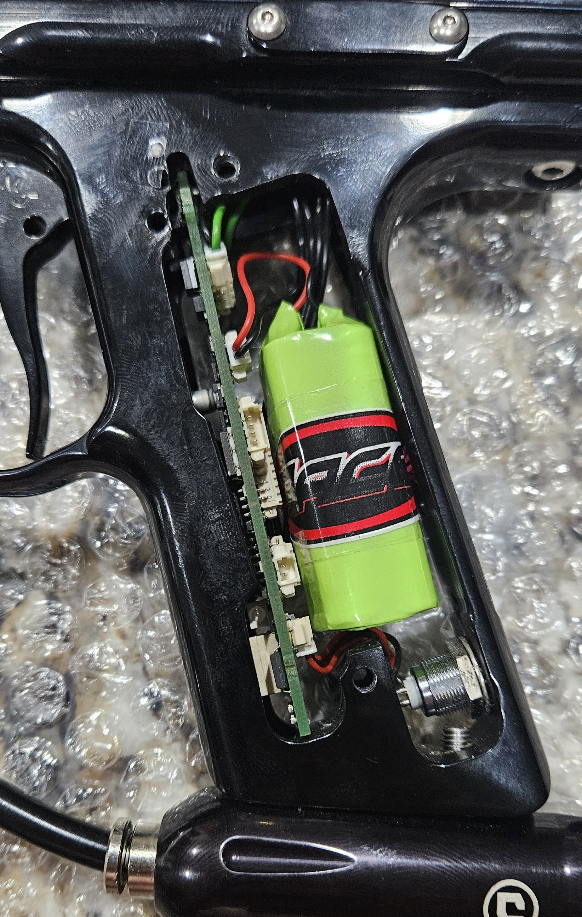

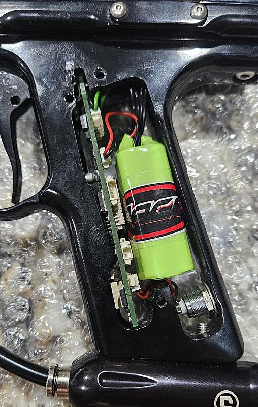

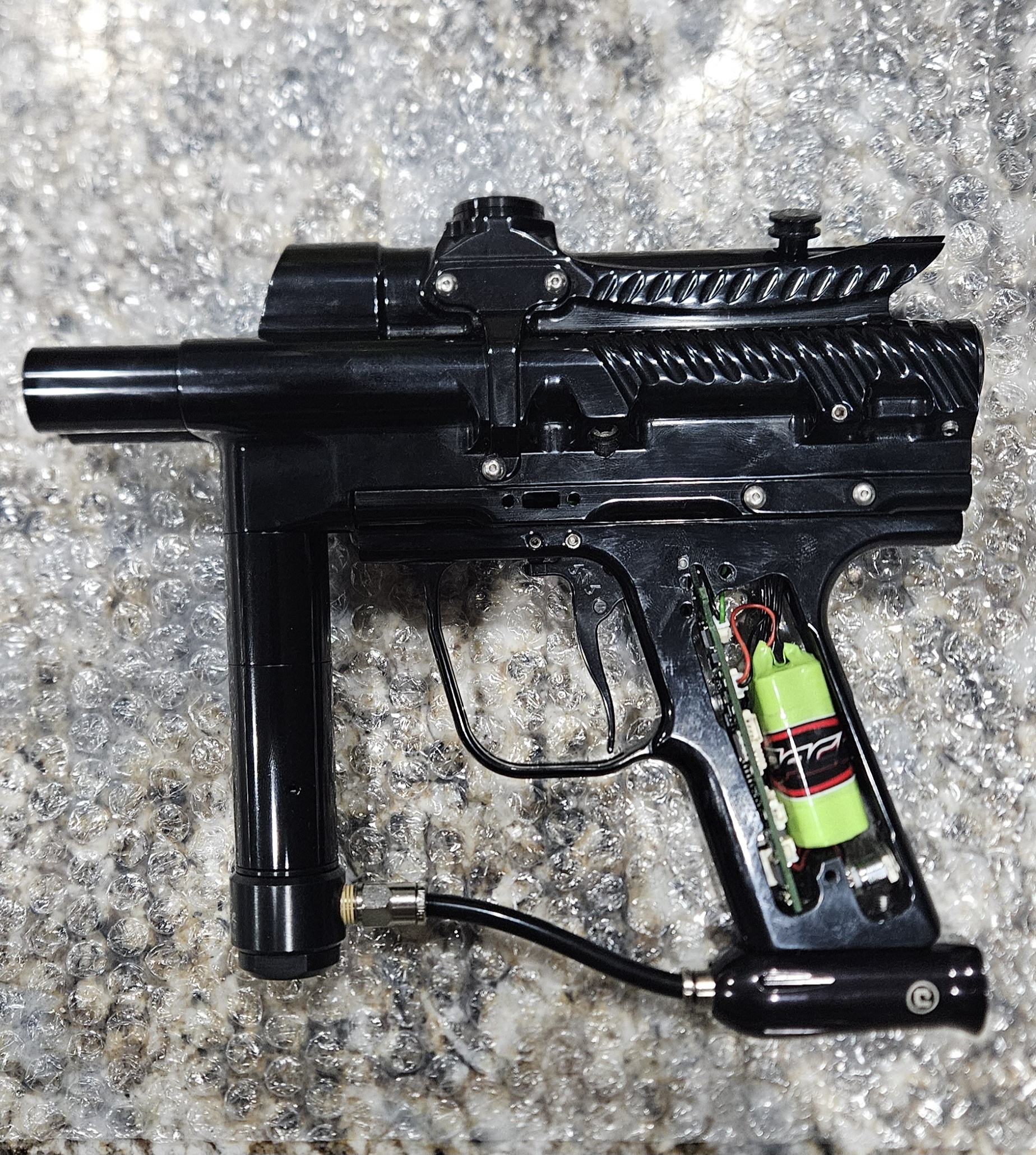

        20250115_213851.jpg 20250115_215359.jpg 20250115_215411.jpg New battery in the 04 DC halfmill excalibur racegun. Very nice! Thank You very much!!

          Woooow, I didnt know that woould even work.
          Now im impressed.

            To do this on a excal frame it had to be UL milled first Then additional milling for the com port, touch pad, contoured in the front for the board to slide in and a new hole drilled to pin the leaf spring switch hole.
            The leaf switch also has to be desoldered and resoldered on upside down on the board to be in the correct position for the trigger to activate.
            Its is a tight fit as you can see with the old battery. But works as it should.
