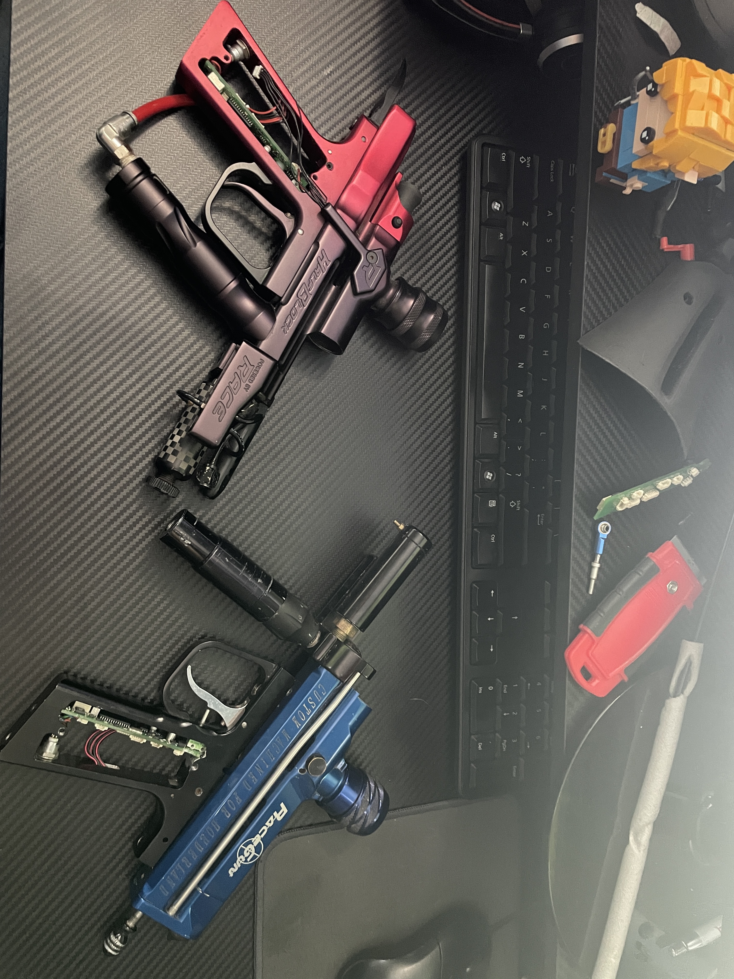

    About 2 weeks ago, I hit the field for the first time in almost 10 years. It has reignited my enjoyment of the game. Sadly most of my gear has fallen into some state of neglect (because they were relegated to being wall hangers). I dug out my old 05 Halfblock and Dye UL Prototype Racegun, both of which are in shambles. My 05 was gutted to repair my last customers Halfy, so it was missing the sear, and sear noid, and they both need new batteries. Thankfully I have still have chargers and data cables.
    The sear is a commonly broken part (which is why I had to gut my personal halfy to fix a customer gun). It breaks when tightening down the frame incorrectly. This part is rarer than hens teeth. I am having some manufactured in order to replace the sear in several frames I have which were also victims of cannibalization, along with their kicker solenoids.
    I have also found a manufacturer of 600Mha AAAA batteries and have ordered enough to build brand new packs for the 5 frames I have. The batteries were the biggest hurdle since the AAAA had been discontinued for a LONG time.
    I have found a manufacturer for the kicker solenoids.
    LEMO Still makes the correct plug, so I am going to try and update the plug to use USB instead of serial and make data cables, I could probably also make chargers.
    I am trying to find suitable replacements for the 3way noid.
    The only thing I CANNOT replace is the actual hardware board itself. Though, I might try to hire someone to design a board based on an updated version of the chip in V2 boards (dont hold your breath.. but that would be fun)

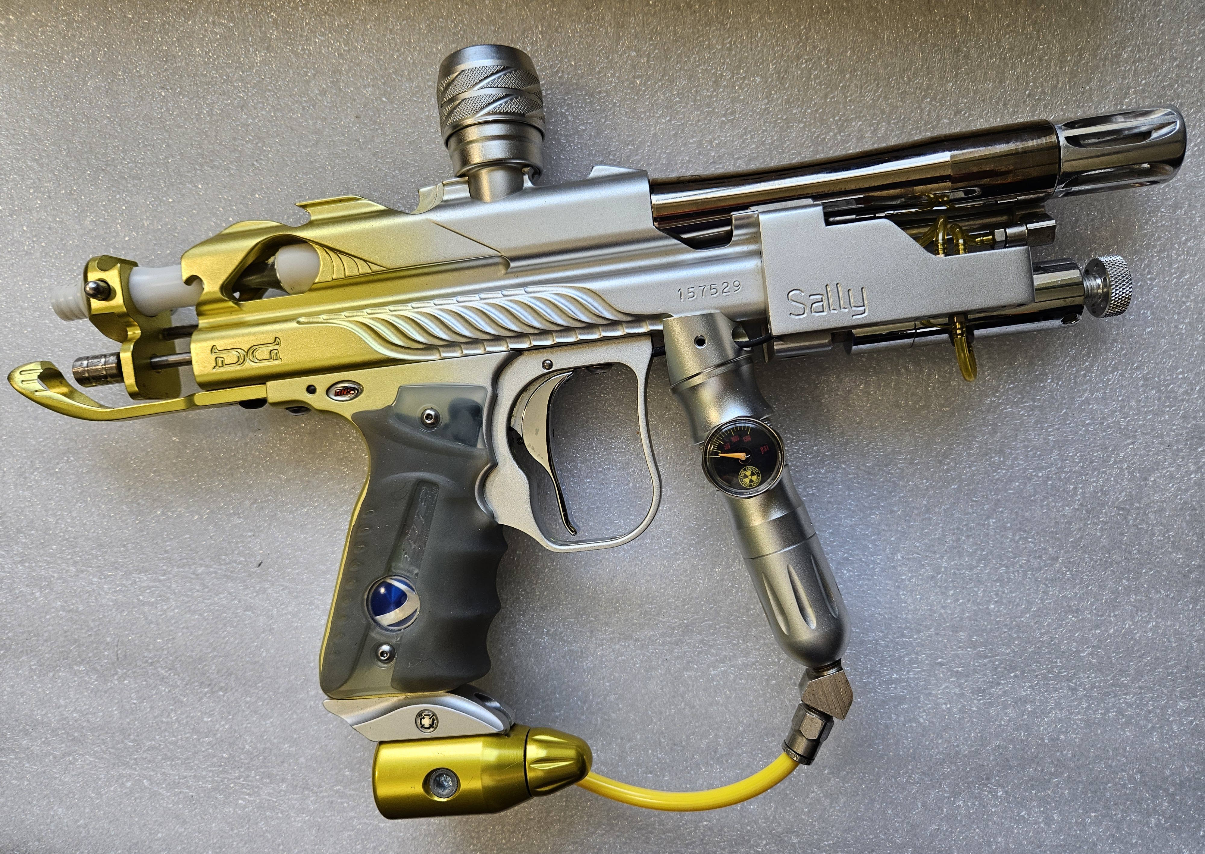

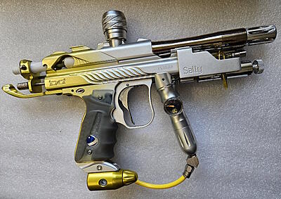

        Interested, I also have one hanging on wall waiting for me to.... learn anything at all about raceguns hah
        It's nice to look at tho!

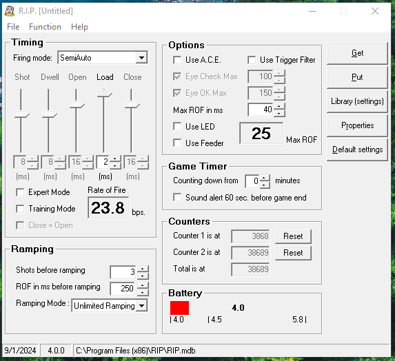

                  While I wait for the new battery cells to arrive, I figured I would plug in one of my old batteries and see.
                  WELL.. It is charging! I am still going to replace it with a new pack when they arrive, but for now I can mess around to see if RIP still works on Window10.
                  IT DOES! AND The Serial to USB cable I picked up WORKS!
                  SWEET!

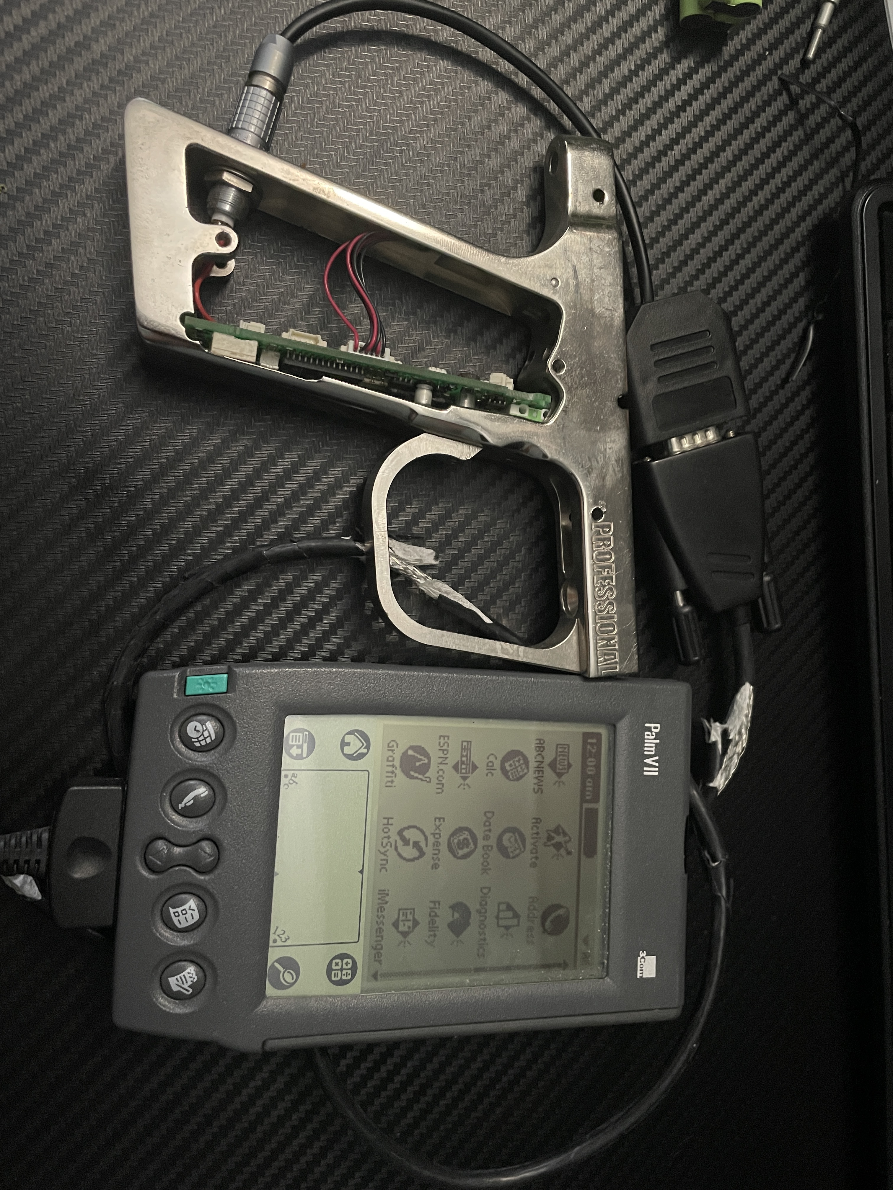

                    taht's an OG interface right there, I dig it. I heard people used palm pilots with these? I worked @ a tech support call center for palm pilots a million years ago... never fielded any calls about raceguns sadly
                • DarkApollo
                  Racegun Guy
                  • Aug 2024
                  • 120
                  • Carlisle, PA
                  PalmVII.. and yep. I have one with the data cable. And if I get another serial port adapter, maybe Ill toss RIP on it as well since I have the firmware.
                  It was easier to use a laptop since I had access to a bunch of my previous known-good configurations. If I was at the field to final tune a customers gun thats all I was doing. I think I only used the Palm once during a game day.
