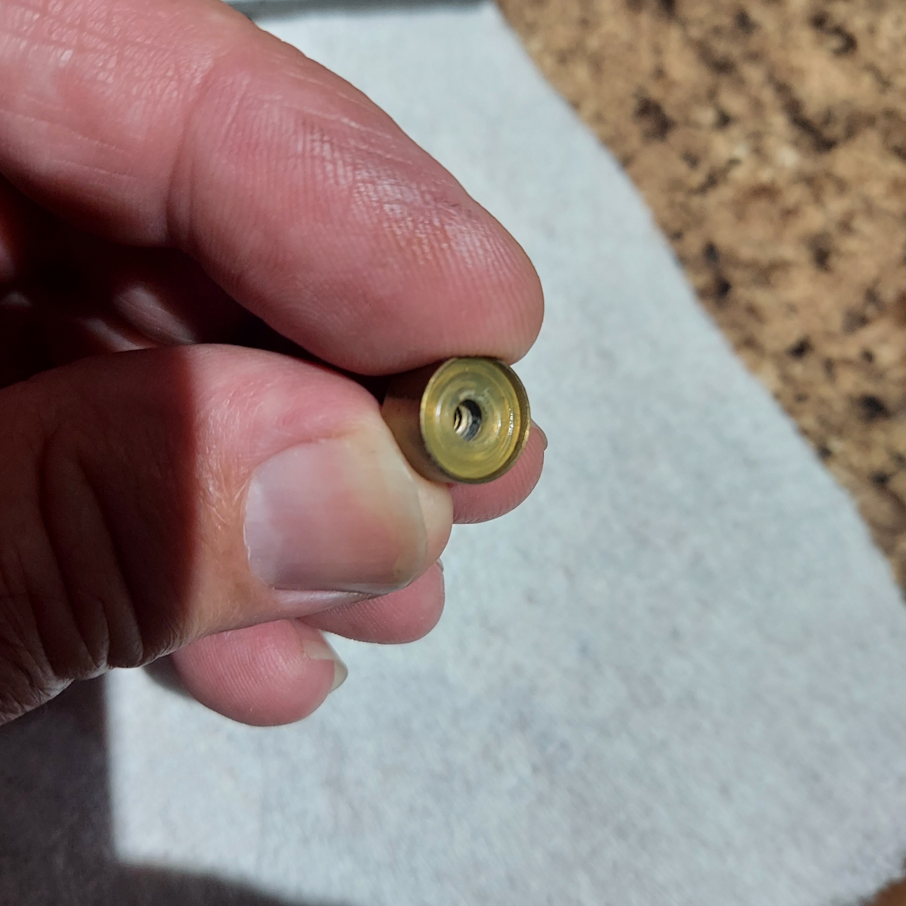

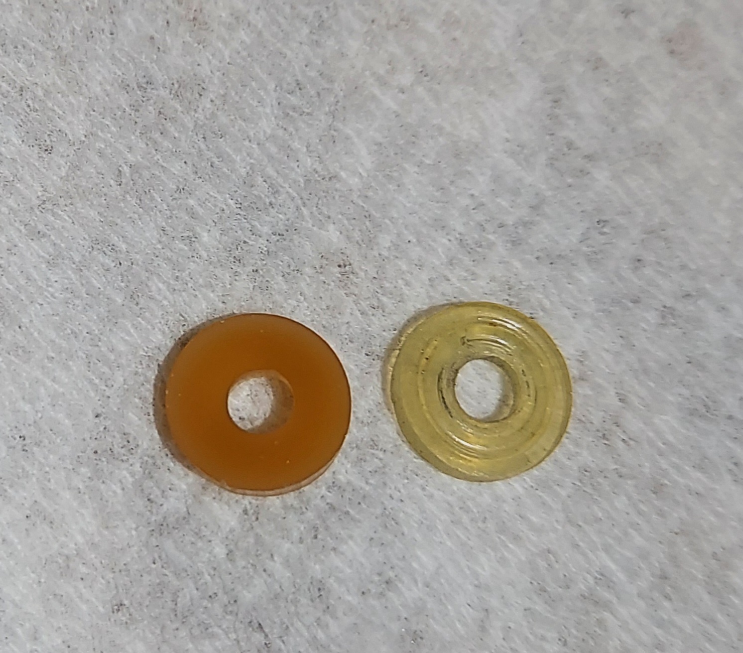

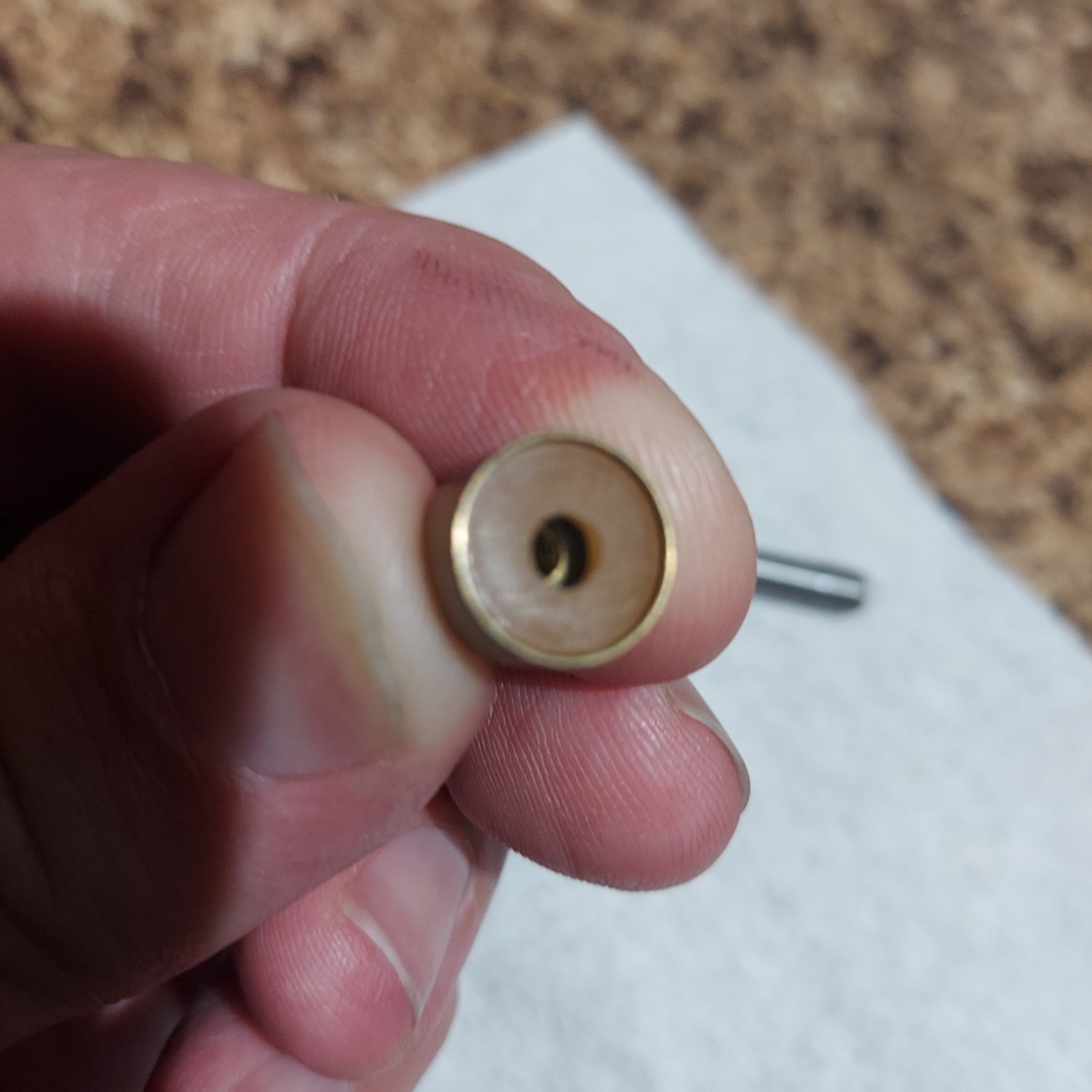

                  Just got my pack of Sheridan Faceseals in from PGP Junkies and gave them a test
                  The first pic shows a stock CCI Phantom Cupseal on the right and the new Sheridan Faceseal on the left. They are a perfect fit and work great so far
                  • StockMike
                    StockMike commented
                    Awesome! I will have to get some of those and keep them on hand! I’m glad there are still some options out there besides EV.
