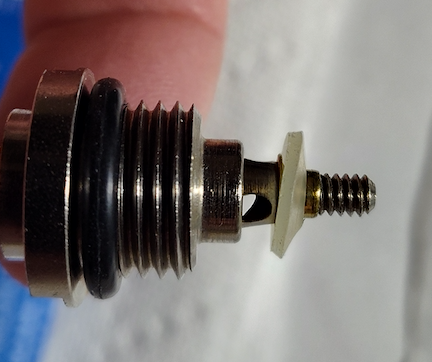

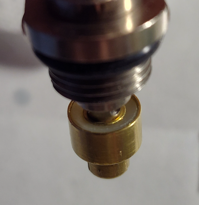

    FYI,
    Here's the nylon seal on the assembly; it won't properly fit. EV was at a loss as to explain why that's the case but I think it has to do with the off center, off sized hole in the seal. It has to be forced unto it, same thing as pushing it into the cup (won't go in easily). Either way, the seal ends up sitting all warped in the cup as opposed to flush as it should.
    Click image for larger version  Name:	Screenshot 2025-06-26 at 11.01.59 PM.png Views:	0 Size:	211.7 KB ID:	707930
    Click image for larger version  Name:	Screenshot 2025-06-26 at 11.02.30 PM.png Views:	0 Size:	588.6 KB ID:	707931

        It seems I had a hand punched nylon seal. They now have new seals which aren't:
Name:	Screenshot 2025-06-29 at 10.30.45 AM.png
        FYI, EV offered me to send me a set for free.
        "Aren't you getting too old for this??"
