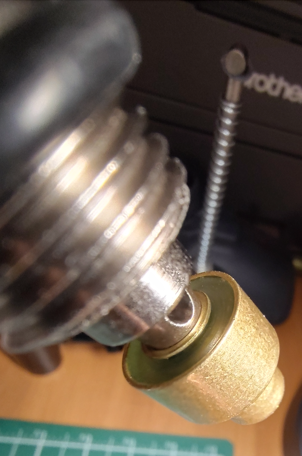

            I just joined the goddamn club it would seem.
            Used my EV Phantom yesterday (had for 3 years, worked fine except for velocity issues which I fixed) and all of the sudden midway through the day it acted up. At first my shots lost velocity up to the point where the balls would fall a few feet away, then it wouldn't fire at all. Checked my 13ci bottle, used another bottle, eliminated the hard line as the culprit, etc. When I got home I took the power tube assembly out of my CCI Phantom and put it in my EV unit and the gun worked fine. So I know it's the EV power tube assembly at fault and obviously therefore it's cup seal.
            While with the CCI Phantom I was able to twist off the cup where the spring sits by hand, the EV one (as mentioned previously) is, for some unfathomable reason, glued or threadlocked. I tried to remove it using wrenches with padding not to leave idiot marks but it won't move. What's going on ?!? I have extra parts including two other cup seals but how the freakin' hell am I supposed to change it if I can't take the goddamn cup off? I have to order a new power tube assembly every time I get cup seal issues?!? I'm in Canada to boot, ordering from the U.S. is quite a haphazard experience nowadays, plus having to add 40% due to the exchange rate on top of that. Obviously, I want to be able to fix this locally.
            For what's it worth, here's a picture of the EV cup seal, as well as a pic of the cup that won't bulge.
            Click image for larger version  Name:	Screenshot 2025-06-08 at 1.46.58 PM.png Views:	0 Size:	768.6 KB ID:	701408
            Click image for larger version  Name:	Screenshot 2025-06-08 at 1.44.47 PM.png Views:	0 Size:	437.3 KB ID:	701409
            "Aren't you getting too old for this??"
            "Nope."
              Have you tried heat. If it is thread locked it should loosen up with heat.
            • The Jayster
              The Jayster commented
              Stupid question here (sorry) but are we talking about blowdryer level of heat or actual fire level of heat?
            • VintageZoomer
              VintageZoomer commented
              Blow-dryer for sure! Don't wanna melt the brass

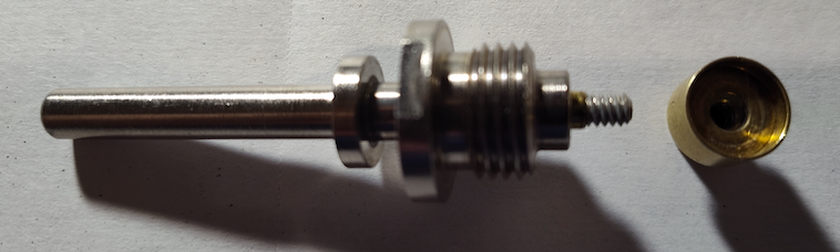

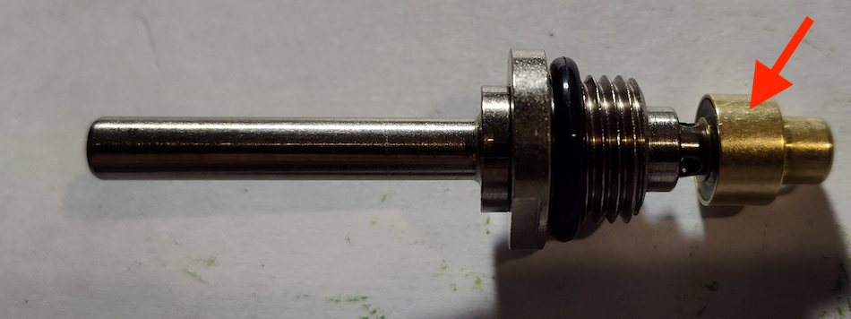

                      Got to visit the head tech at my field and with the proper tools he was able to take the cup off in less than 20 seconds (...)

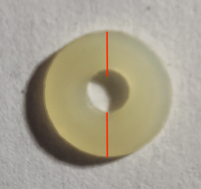

                      I have an orignal extra seal from CCI and the newer version from EV. I tried the EV version and sure enough the gun leaked through the barrel. I replaced it with an older CCI seal and the gun works perfectly.
                      The EV version didn't quite sit properly into the cup, and I noticed that the hole is slightly off center (both red lines are of equal length);
