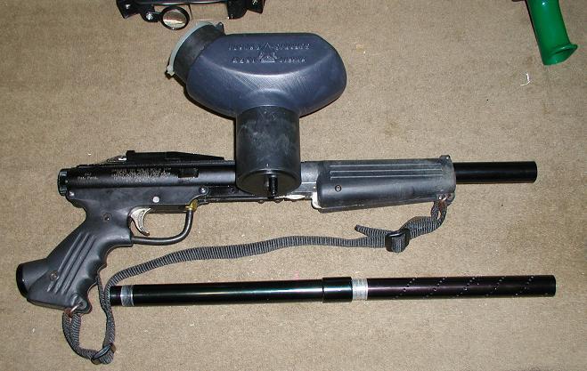

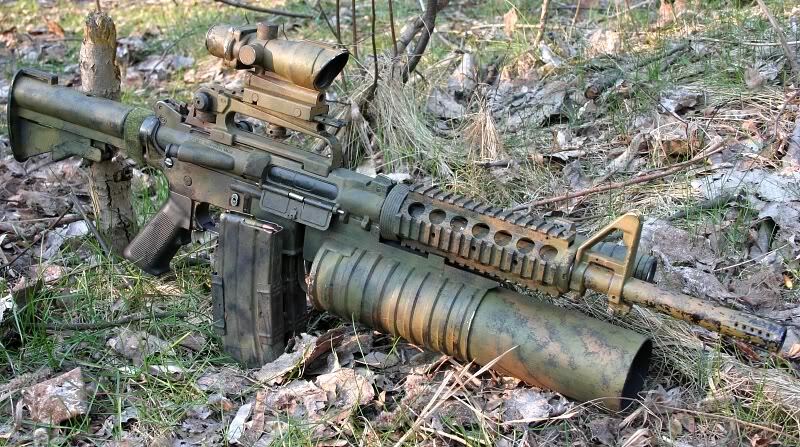

    This is the 98, It was posted on a non-English forum but some posted a link via A5OG forums.
    The "grenade launcher" is actually a Qloader feed, so it feeds from the bottom up directly into the 98. I did have more pictures at one point where you could see the feed hole.

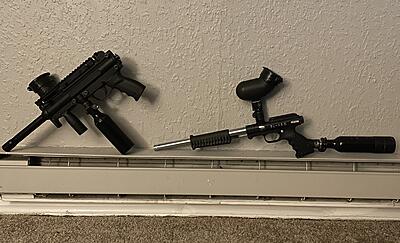

        Part of my Tipps collection

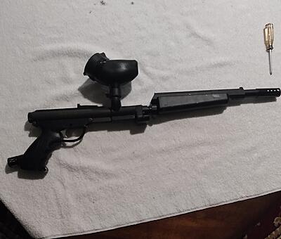

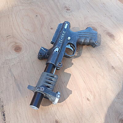

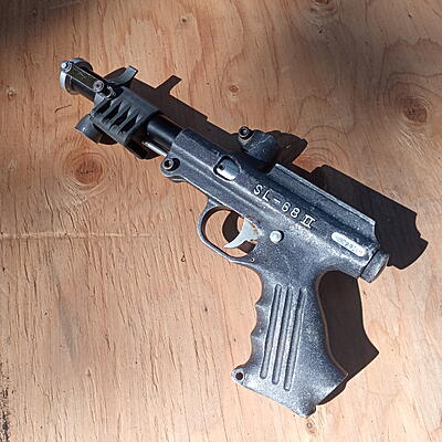

              Rental SL68 II turned into a pistol

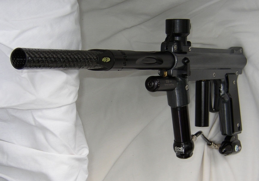

                My 98 Custom ebolt... 2way ram made from an Impulse ram, homebrew LP kit, Evil Pimp solenoid, WGP regulators, Morlock3 board. Way too much fun to use.

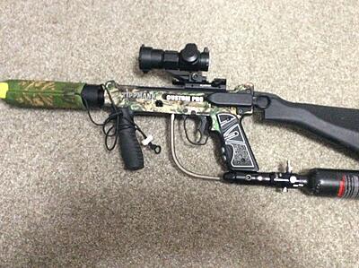

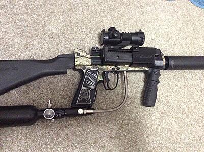

                  Custom Pro with Rocket Cock, sling mount, red dot, magazine adapter, double trigger, hybrid grips, CP on/off, hogue rubber front grip and 7.5” Lapco and suppressor. I also added the peel on camo tape I had still sitting in the gear bag. Lastly a spec ops solid stock.

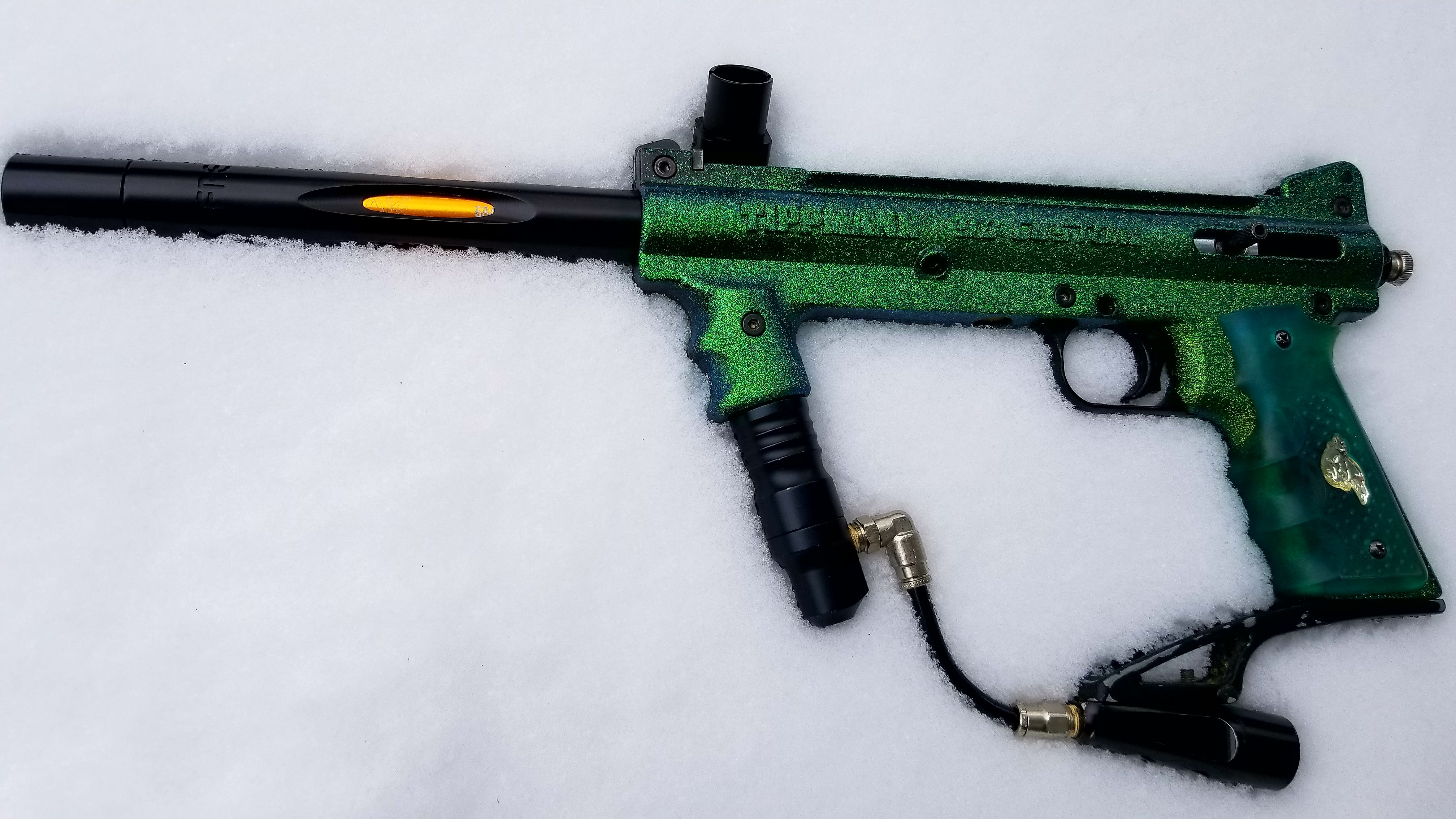

                    98c, MadMan springs, rva, internal polish, ego5 reg, factory drop, freak, extreme rage grips, ptp powerfeed, custom green flake powder coat.

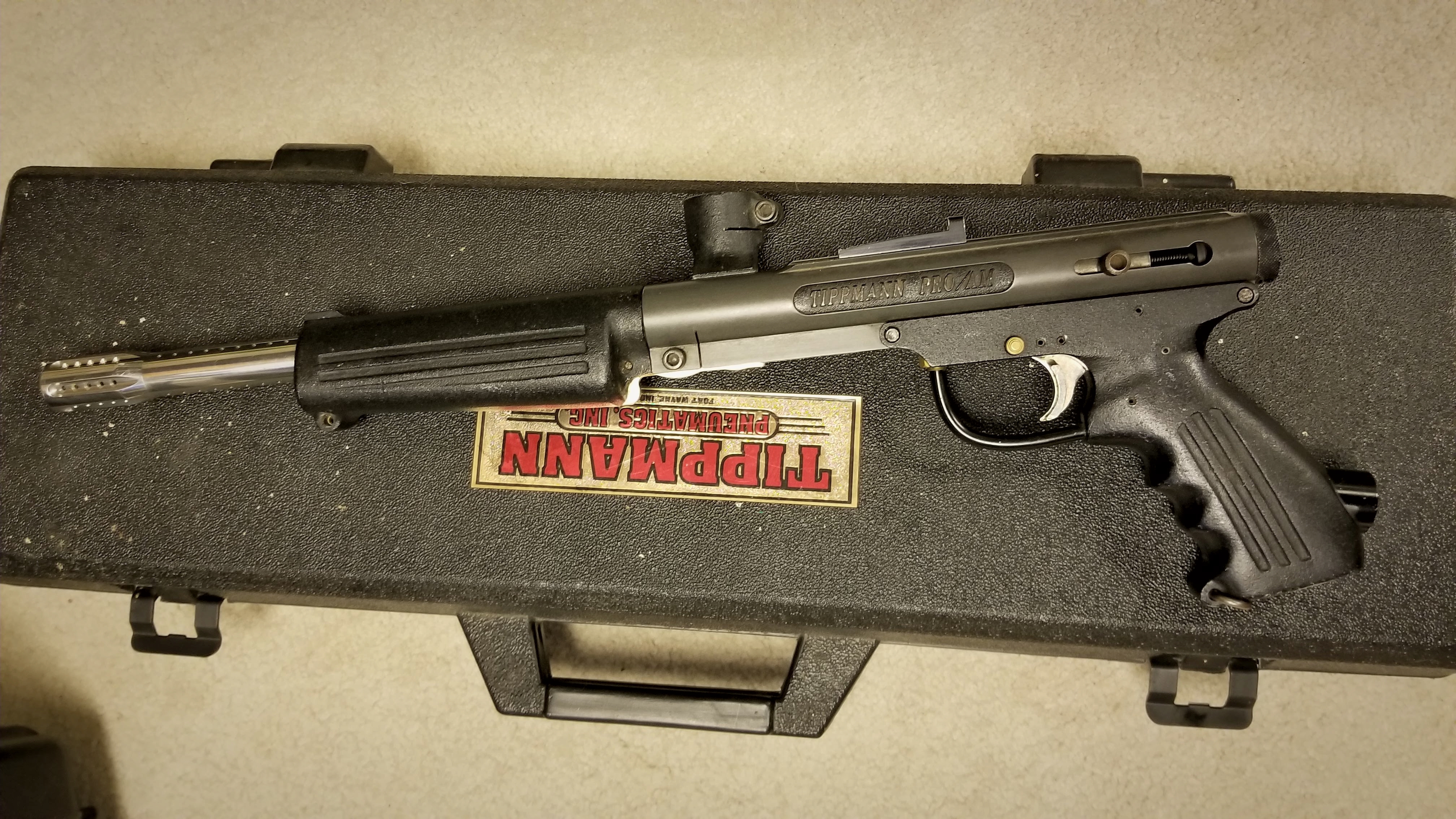

                      Tippmann ProAm, factory case, dye stainless.

                        I really like that ASA protruding from the palm hump of the grip. Gives me an idea for a 3d printed grip.

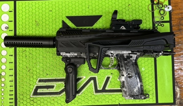

                      Hydrodipped TIPX with MCS CMP-18 body kit, Techt MRT Bolt.

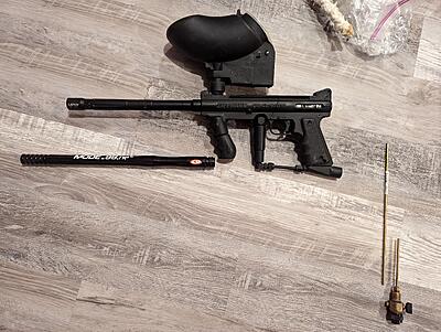

                        Built in 2004. Going to use it for the first time since 2005 or 2006? DIY "LP", ballistic sports valve spring, dremeled out valve channels, 20% weight reduction hammer , green maddmann mainspring, with WGP regulator. Trigger return spring and safety removed, polished internals, tank oring on front bolt and feed neck, 12" lapco bigshot .6xx for the woods (? What bore were they 20 years ago). 16" CP .693 for the inflatable games. This could get 2K+ shots in a 20oz with anti-siphon. Going to redo the ASA and run a 48/3000 now.
                        I sold the 2way ram ebolt supergun in 2011 on PBN. Sold the mech double trigger speedball Tippmann back in 06?

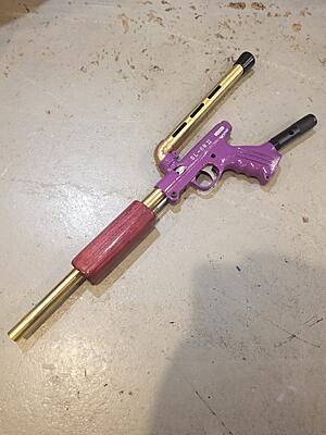

                          Stock class/ open class center feed sl-68 II with purple rainforest wood pump handle, 14" brass freak barrel and brass stick feed.

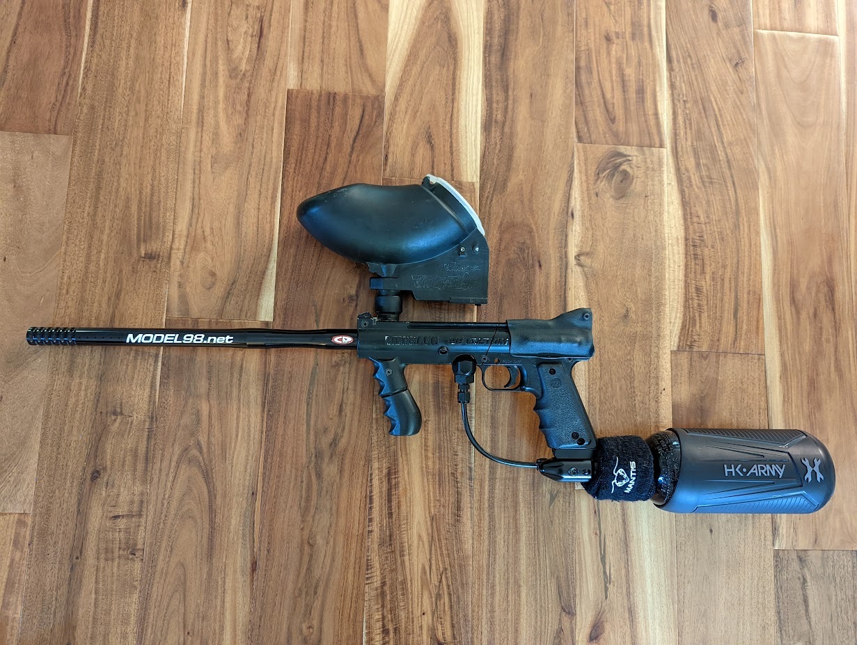

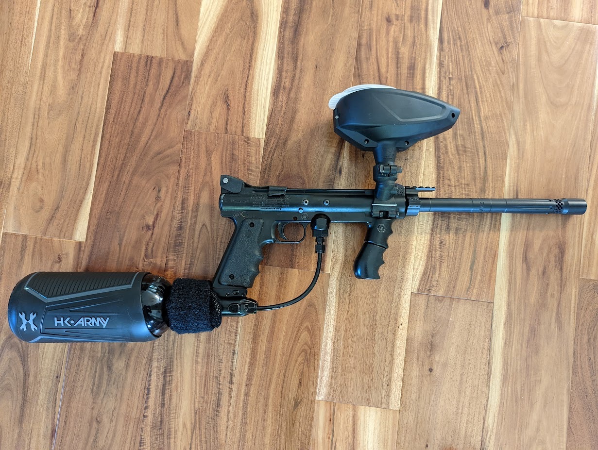

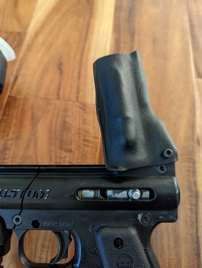

                            it is now ready, for both speedball or woodsball.
                            Swagelok compression fittings and 1/4 stainless steel tubing for air path. CP ASA. Durable and zero maintenance.
                            Made a cocking slot dust and debris cover out of kydex.
                            I might buy one more CP or Lapco barrel, 14" in .684 or .685. Other than that is ready to rock!
