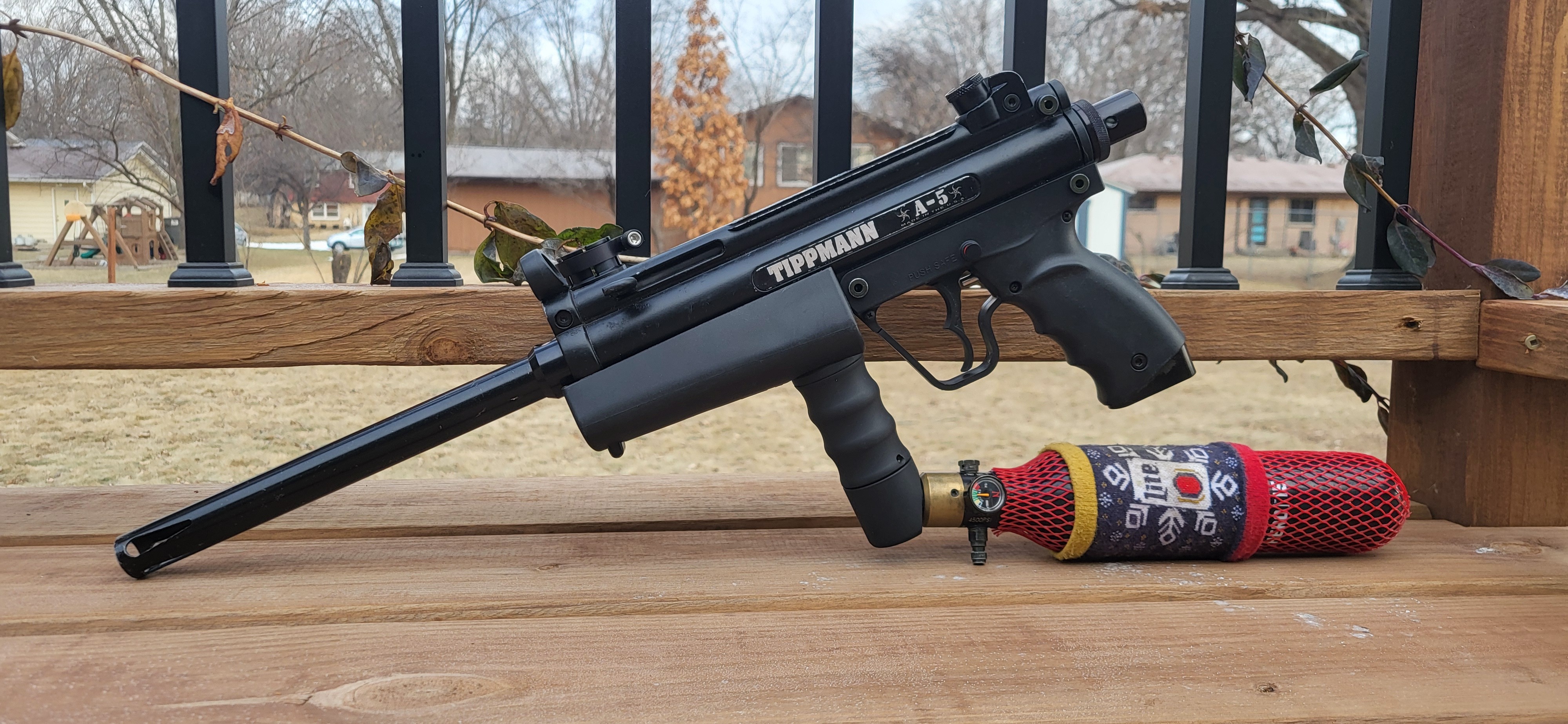

    Got back from vacation and my python feedneck was in the mailbox. I took today off just incase I needed a decomp day. I don't, but I'm using my day off to mess with some projects.
    RAZRBAKK gave me the a2 grip. I had to blow a massive slot in it to make an intruder grip work, but its as comfy as I imagined it would be.

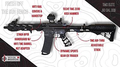

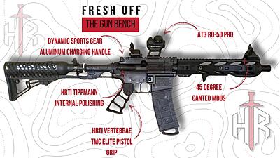

    Custom TMC Elite .50 Cal I made for a customer with HRTacticalin.com

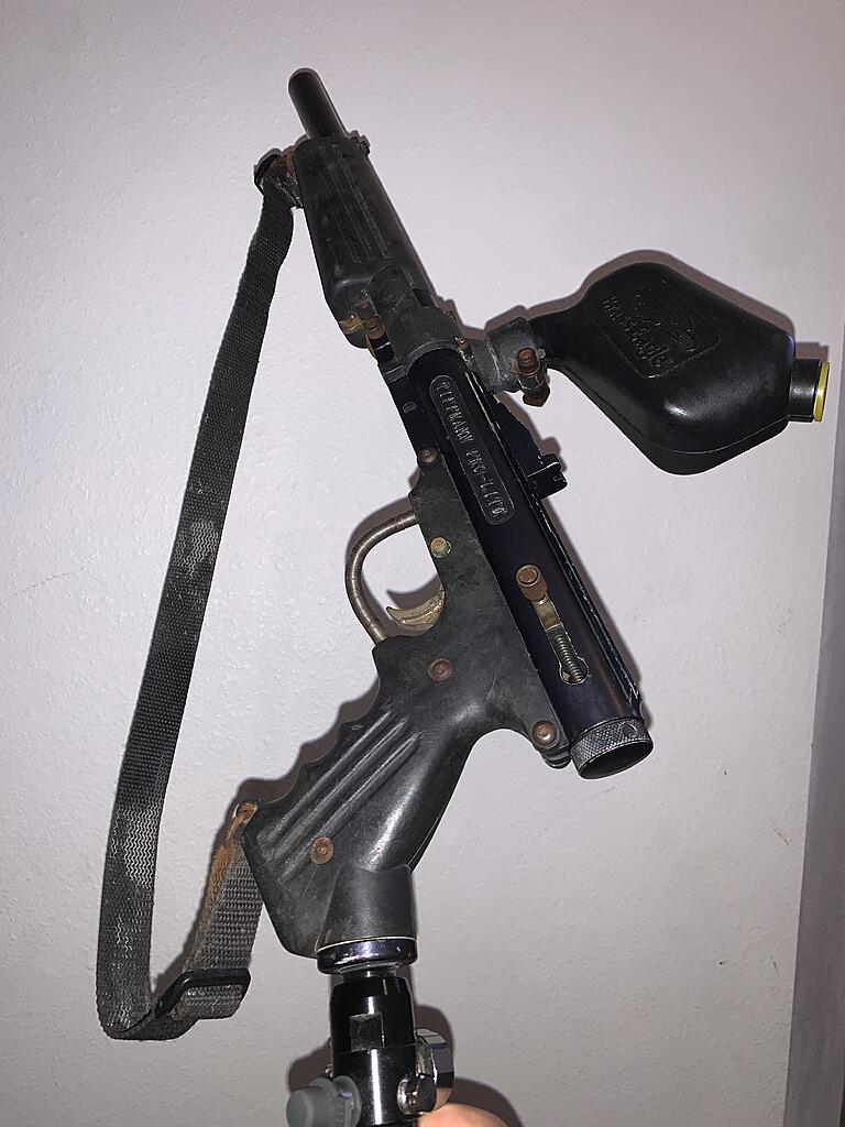

          Got this on eBay for $50. After a frustrating time replacing the valve seals I got it to stop leaking. Can’t wait to try it out
          • Myrkul
            Myrkul commented
            Somewhere around the 25th valve rebuild it just starts to click and you'll be able to get them in your sleep. Just keep practicing!
          • Cal440
            Cal440 commented
            Looks like it's in nice shape 👌
          • mooman978
            mooman978 commented
            Getting that clip out took me almost an hour. I didn’t have a vice and I wasn’t able to push it all the way down to lock it down with a dowel or anything . So I was doing a lot of fiddling.
            The internals look like it wasn’t used very much. Just neglected for a long time.

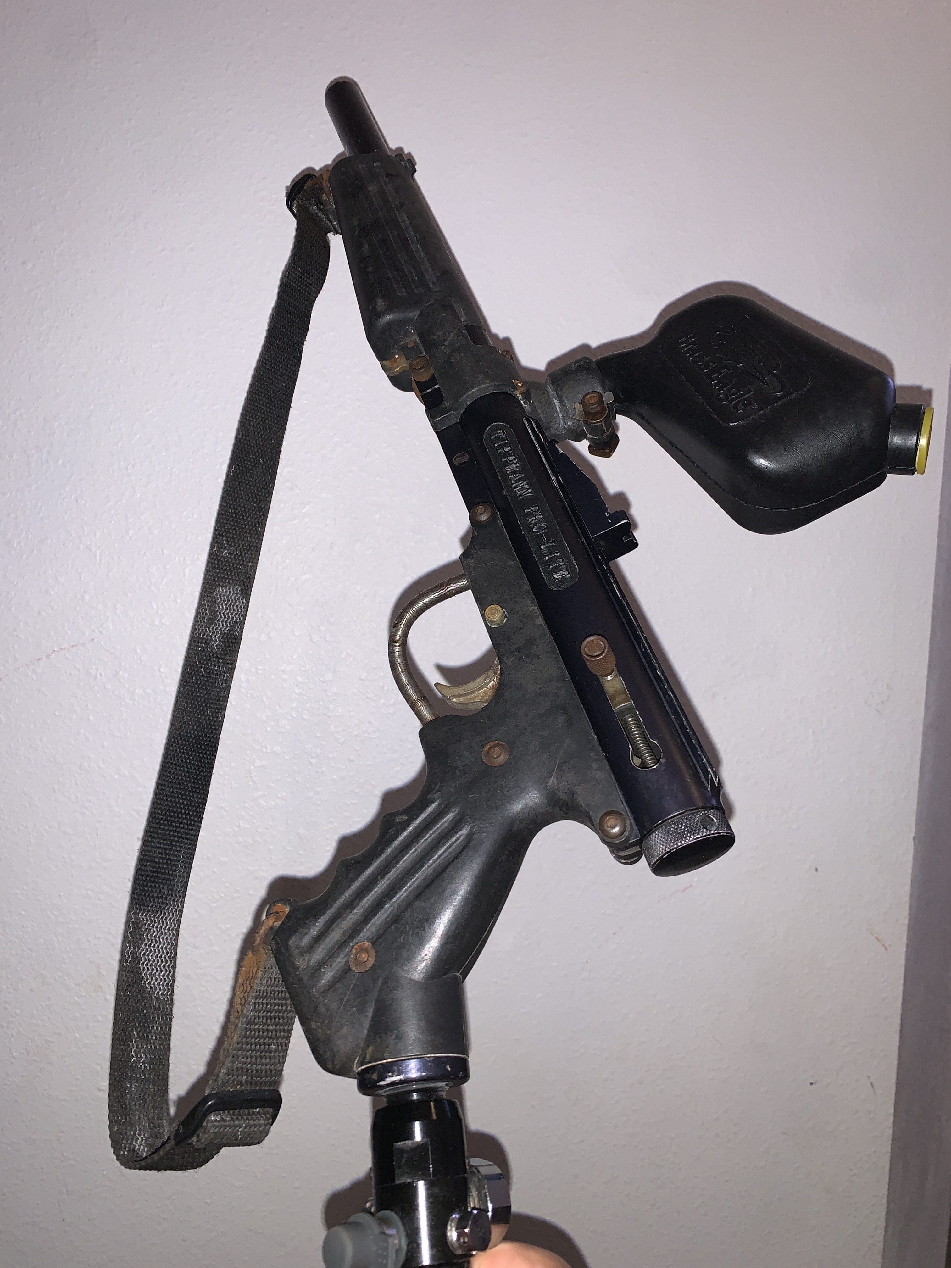

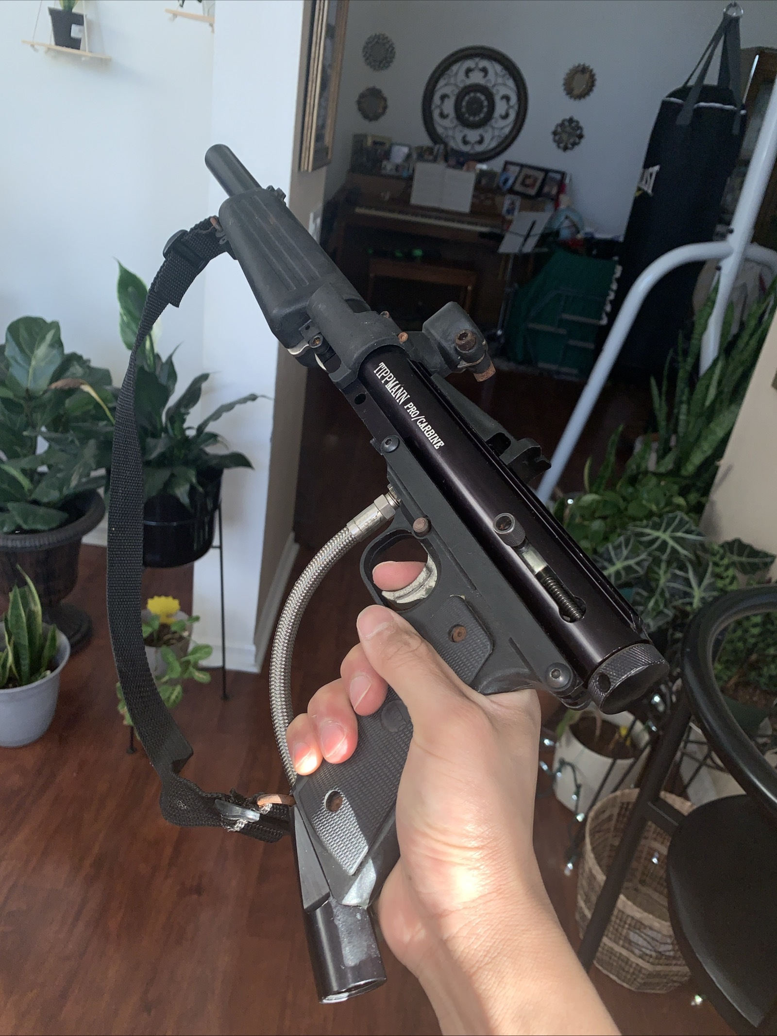

          Another rebuild! After bringing my pro carbine from my previous post to the field and having a fun time with it. I was graciously given this by my field owner for “keeping the classics alive” and knowing I’ll actually restore and use it. It is great to know he shares my appreciation for fun old guns. It was in pretty rough shape but I got it back up in running. IMG_3479.jpg

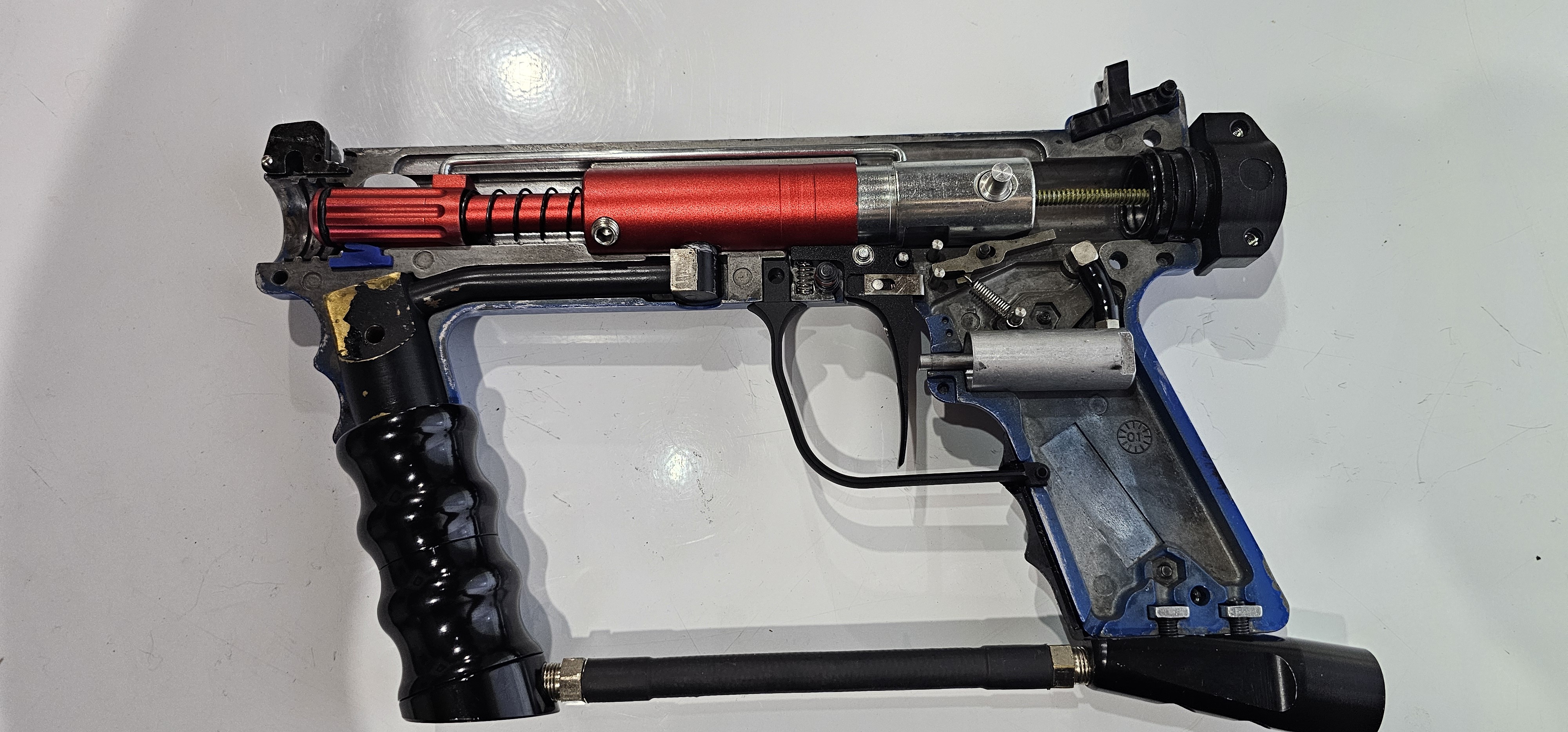

            Finished this up a couple of days ago. Shooting 270-280fps @ 280-300psi
            Polished internals
            Rufus Dawg grips and Wicked Bolt
            OG E Grip with lighter trigger spring
            DOP Blade double trigger
            Low pressure kit
            BT RVA with light main spring
            CP Gen 3 Reg
            DOP ASA adapter with PE on/off OOPS ASA
            All Cyclone upgrades
            Null Deadlywinds barrel
            HK Aerolite 68/45 tank with Powerhouse Hook reg @ 525psi

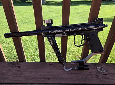

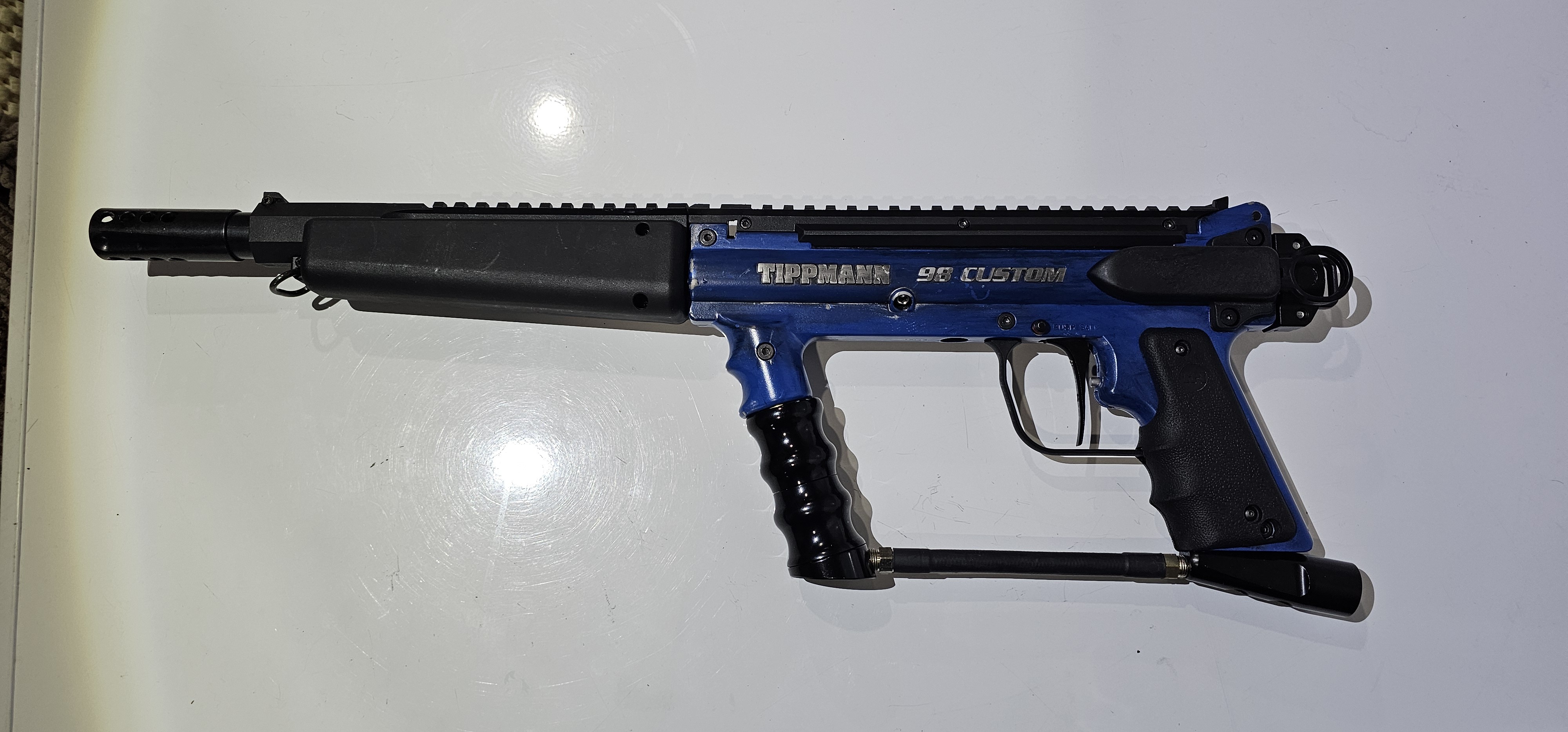

              Here's my early 00's 98 custom. Played 3 games with it this year and it's working great. Repainted it from a Real tree camouflage. Replaced the valve, sear, and rear bolt with new OEM parts as well as all o-rings. Polished the internal receivers where the front and rear bolts move. Installed an aluminum power tube, anti-chop front bolt, RVA, and fang trigger. Installed a response trigger and flatline barrel as well; the expansion chamber has been there since I used to play with CO2 back in the day. Working on some 3D printed parts to slap in TiPX magazines to try some magfed games.

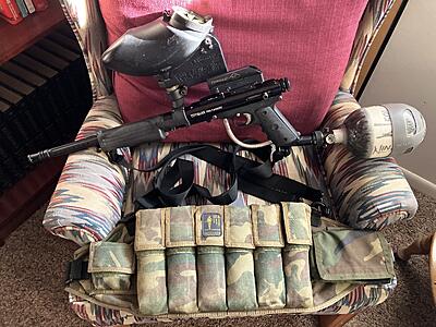

                  Here’s the current state of my Pro Carbine. Featuring a bored out reduction fitting and heavier main spring for HPA. Rocking a CP .685 combat classic, a Daisy Copperhead, a Pro-Lite RVA Calvin pointed out to me, a Revvy from ThatBobbyjoe, and a Ninja 50 putting out 850 psi from jpdgas. Thanks to everyone here who helped so far with this project! I’ve been pouring through threads here about these things, all the advice has been helpful.

                    Thanks! It's a great tank, the best quality of life increase I've made in this hobby so far.

                    That pod pack is sweet too

                    Thanks, it is! Playing with a chest rig is really different in this day and age, but it's a fun different.

                  Fantastic work! That looks like a great rig to play with.

                    Thanks! I'm excited to really get behind it, gonna be a ton of fun this season. It handles great and shoots super smooth, looking forward to taking it to chrono.

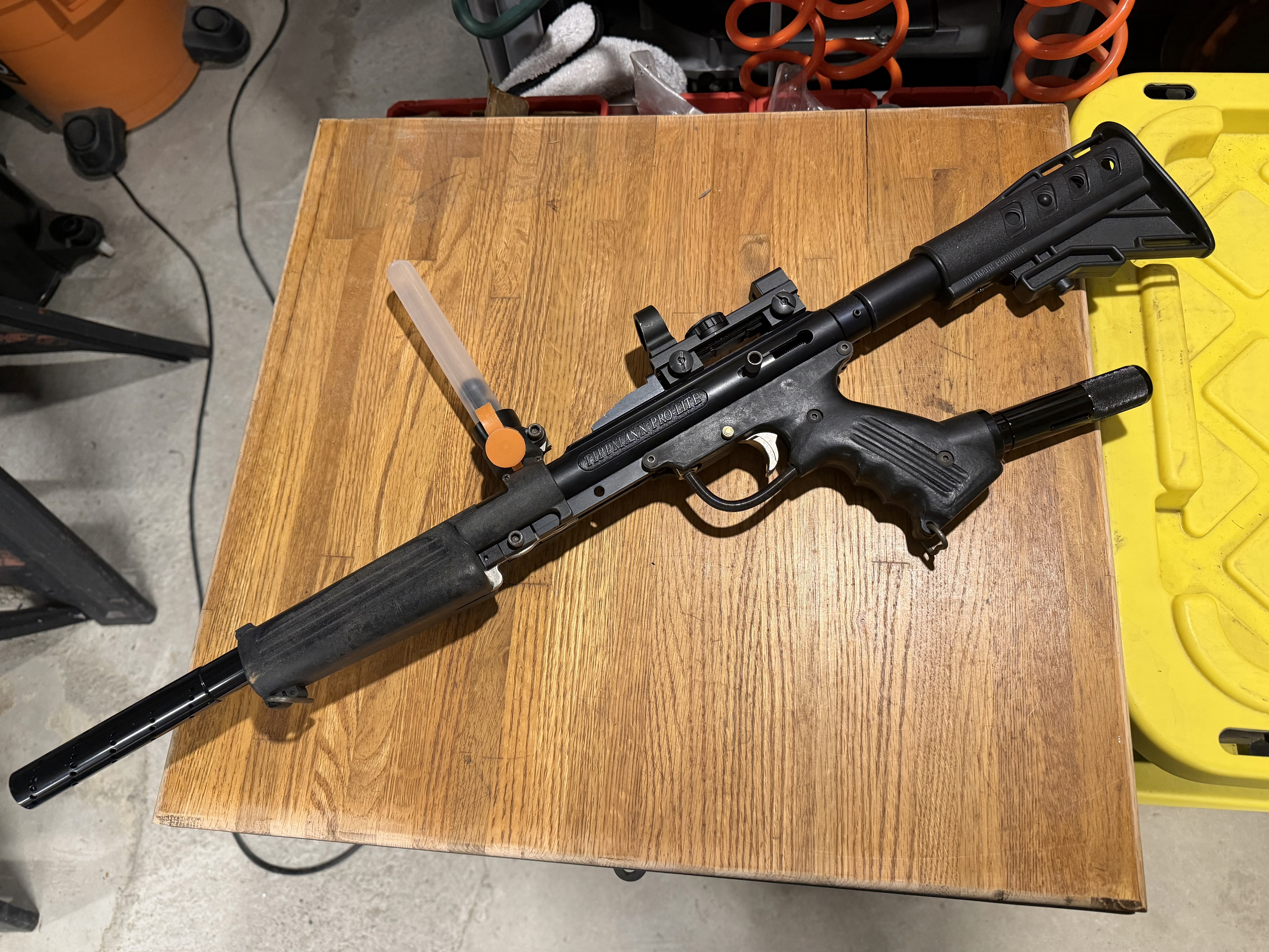

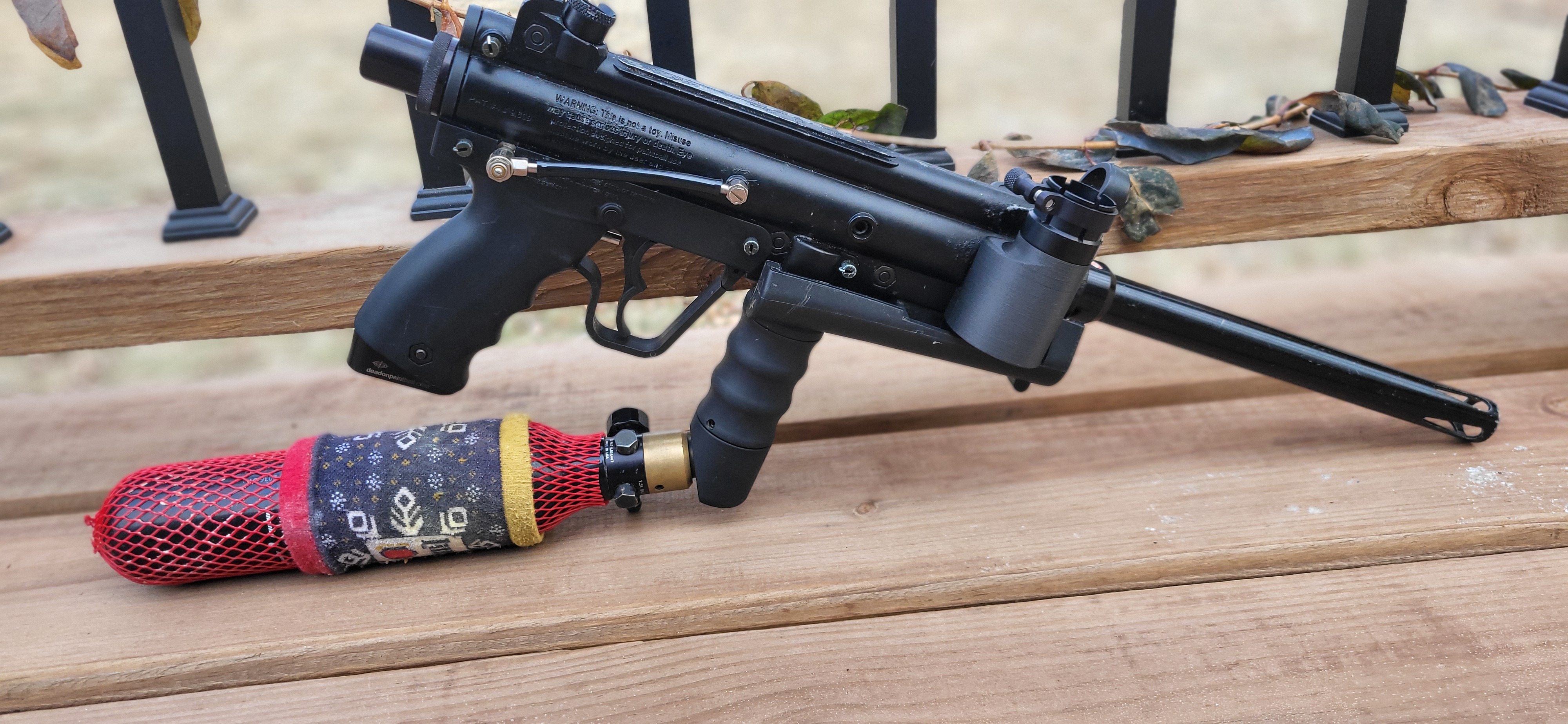

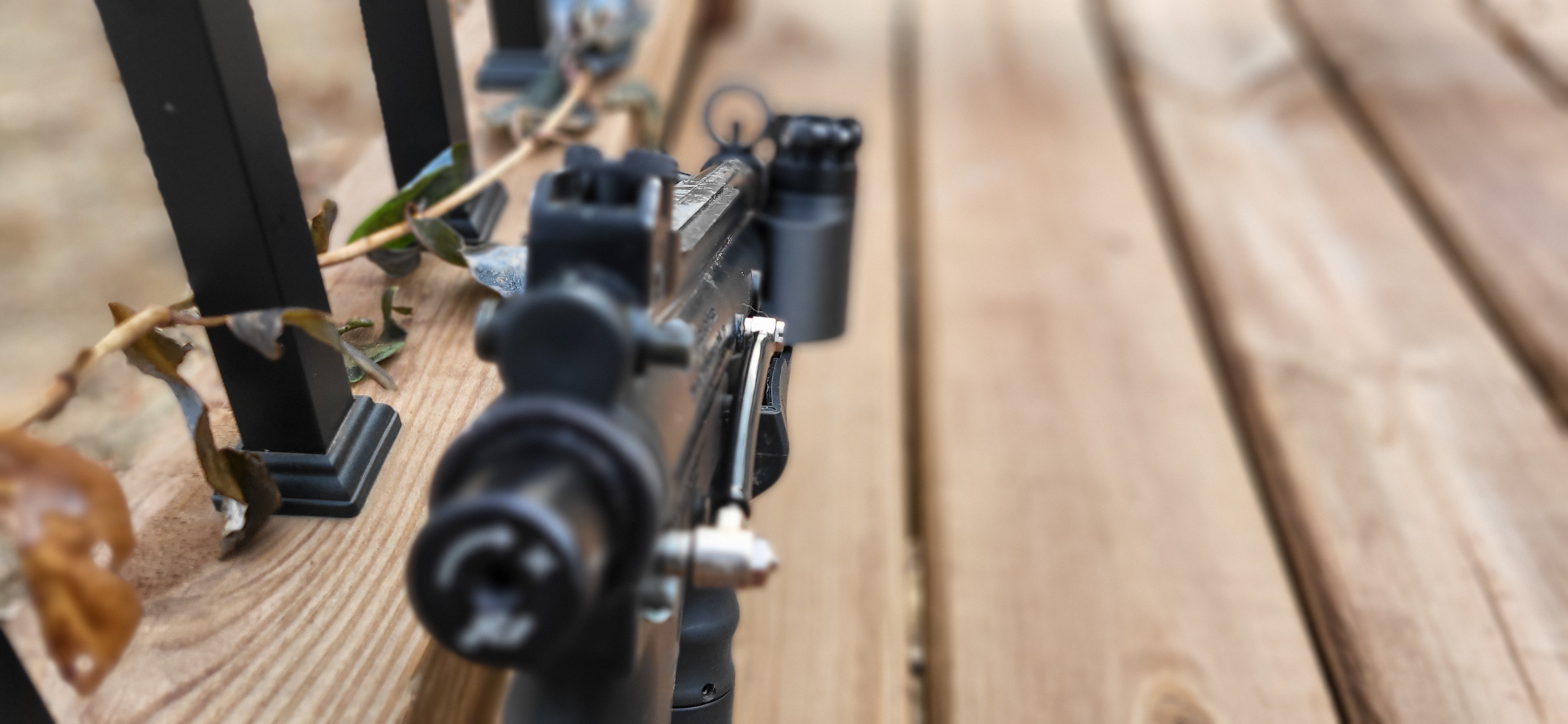

                  Finished up the Prolite PDW with a closeout APP M4 stock with integrated velocity adjuster!
                  • Cross-Country
                    Cross-Country commented
                    Hey, I see someone bought that eBay treasure! How is it with a mask? Also, how’s the efficiency of one of these with 12 grams? This thing is sick!
                  • LudovicoSoldier
                    LudovicoSoldier commented
                    It needs a .50-.75 riser block for the sight to be honest... I might get a custom one made instead of the ones available on the market for dovetail... in terms of 12-gram ohhhh about 20 shots. I use it in the back yard with solid nylon balls. :P This setup is likely to move over to one of my Minilites as I'd prefer the tank or changer to be vertical.
                  • Chappy
                    Chappy commented
                    What sorcery is this?!? My prolite got about six shots on a 12ie when I tried it lolol

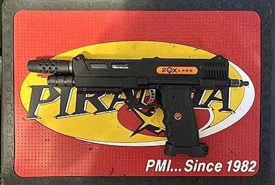

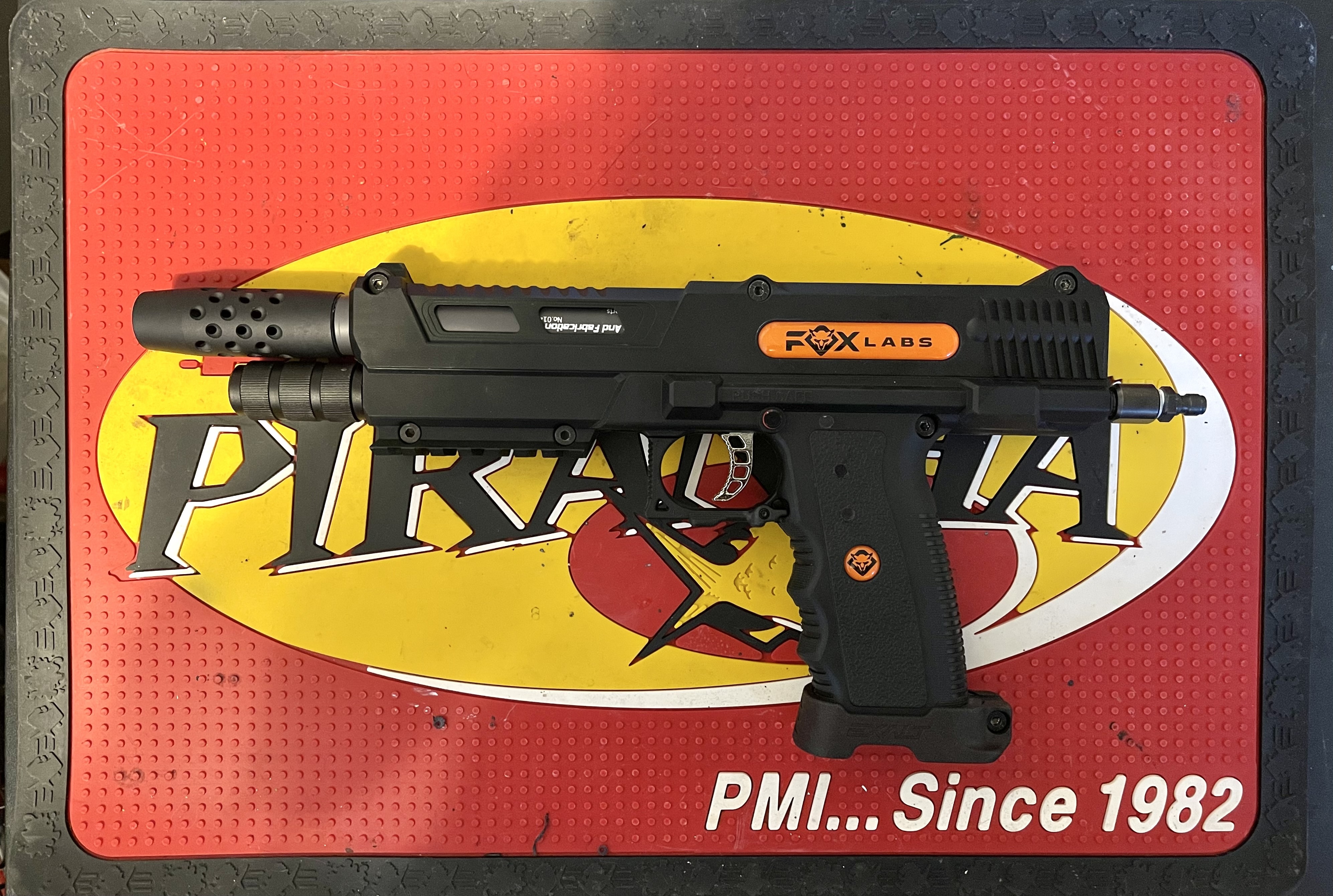

                  IMG_5218.jpg My Fox Labs TIPX:
                  SSC Extendo
                  CS Machine and Fabrication 5” Freak insert barrel with the Hammerhead muzzle tip
                  Exalt Barrel Shroud
                  Exalt Flared Magwell
                  Exalt ambidextrous mag release
                  Remote air adapter​

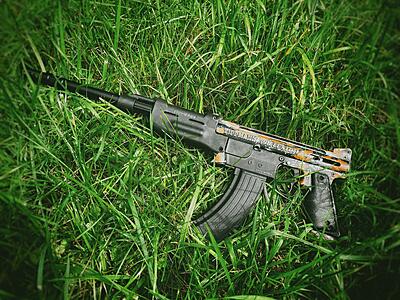

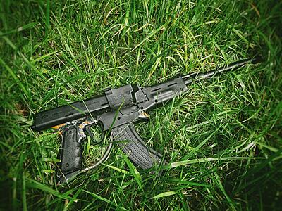

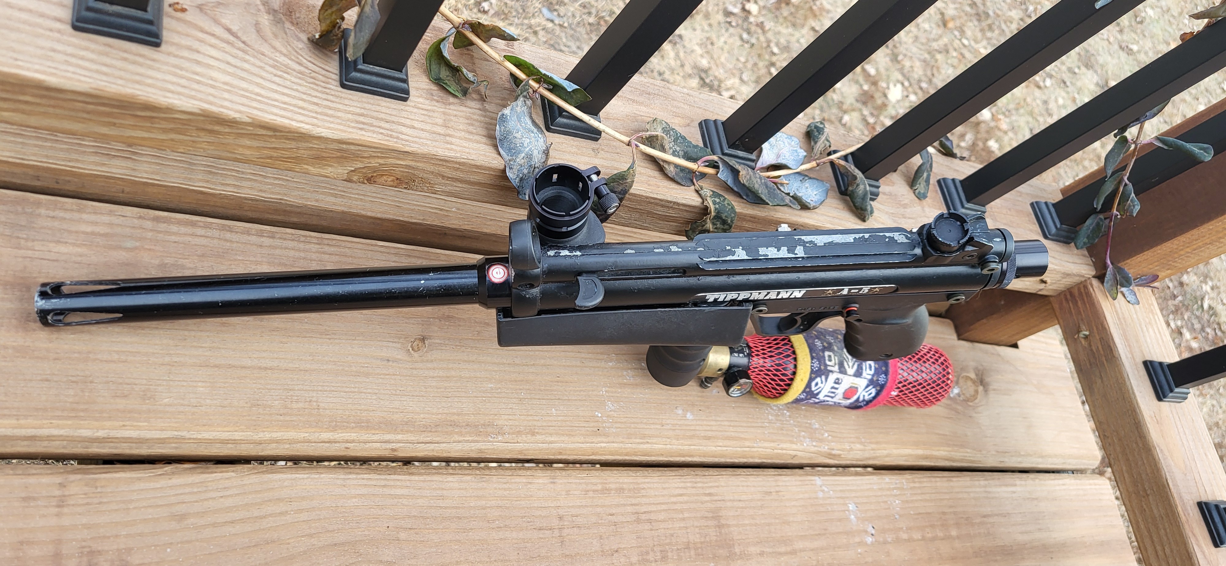

                  Tippmann 98 Custom with Zeta mag adapter, double trigger, and AK kit
