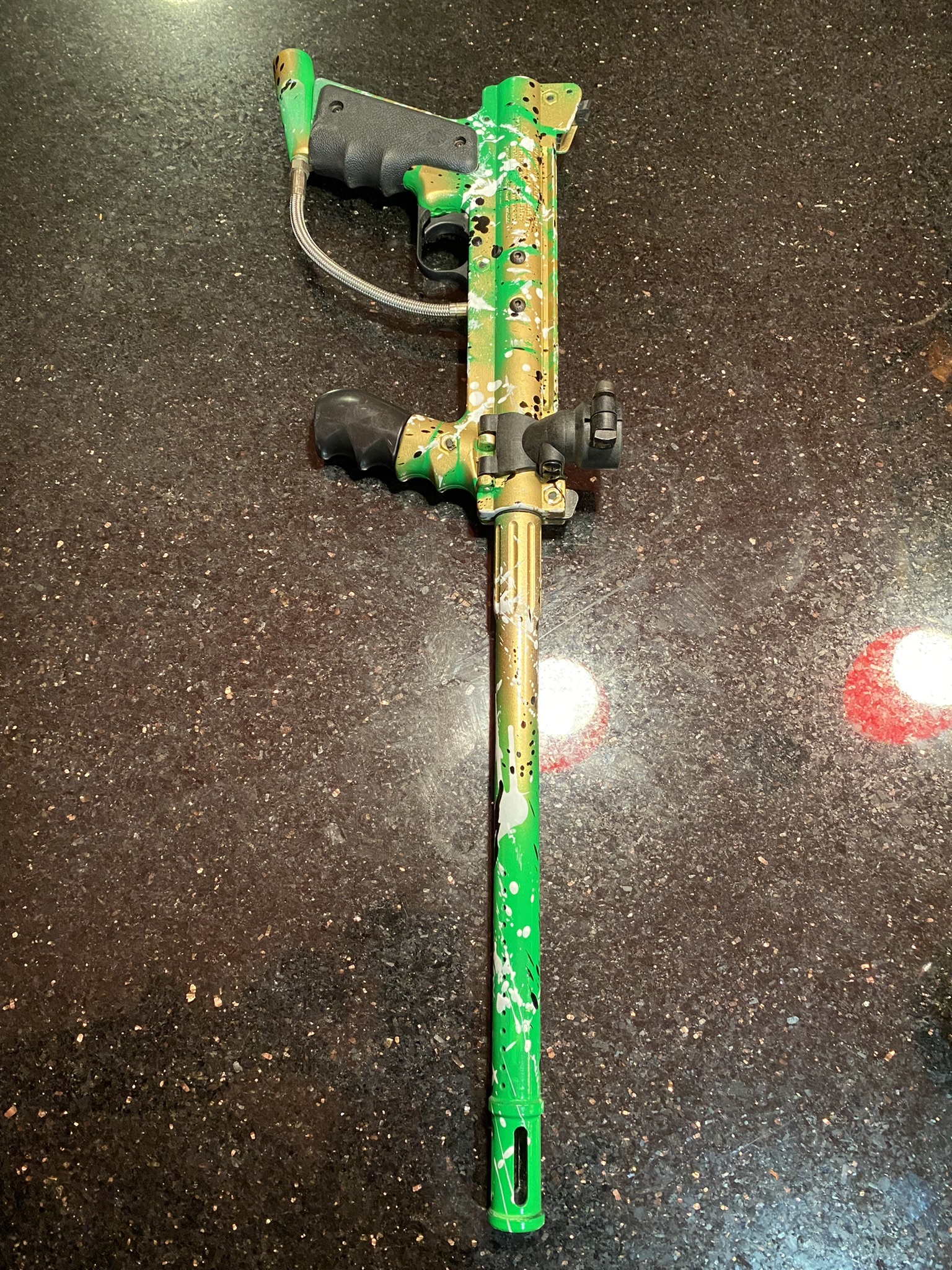

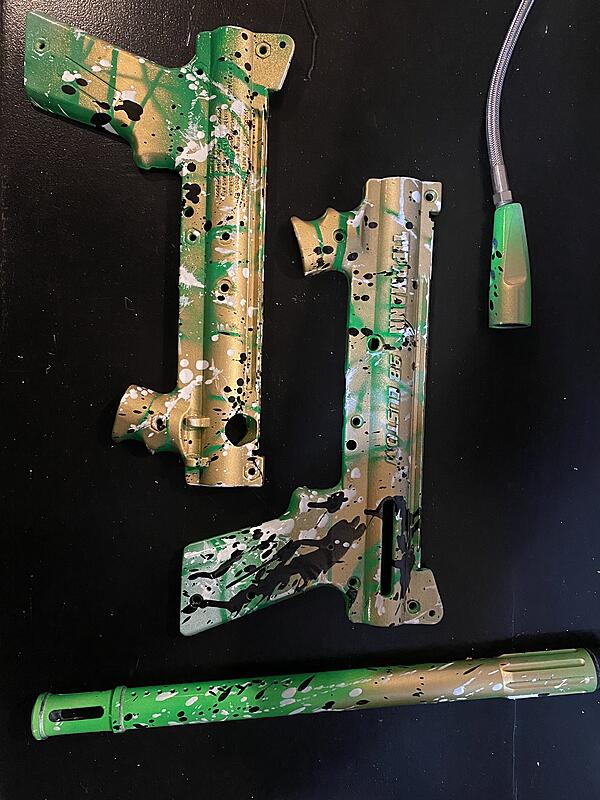

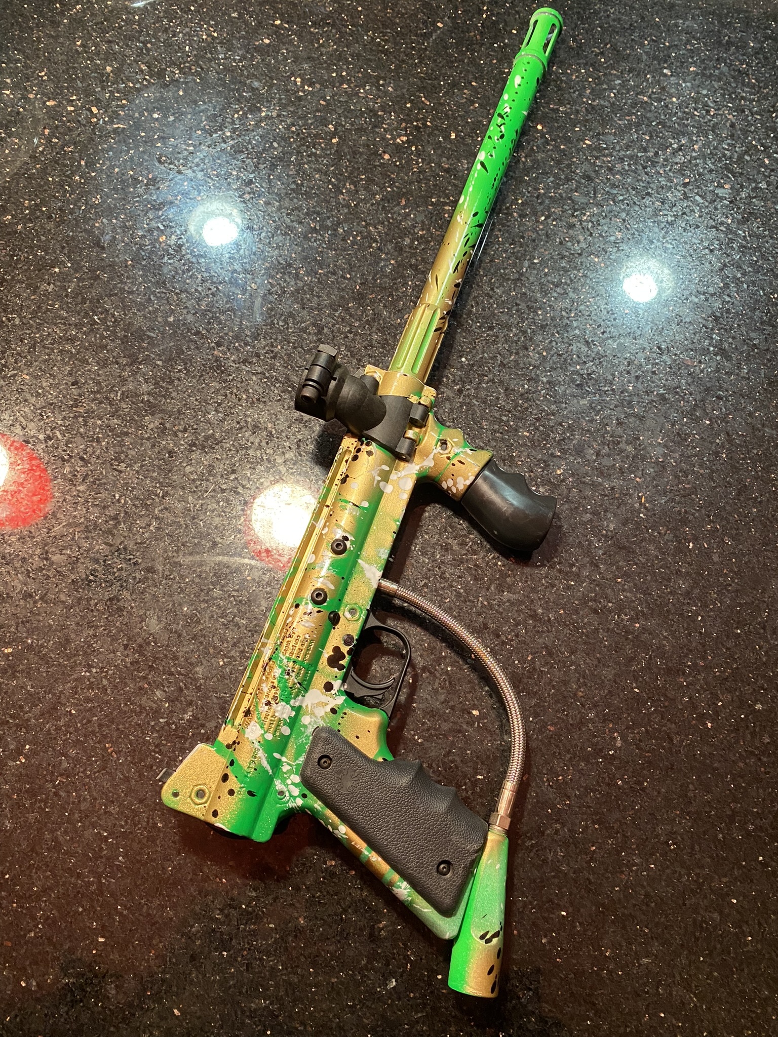

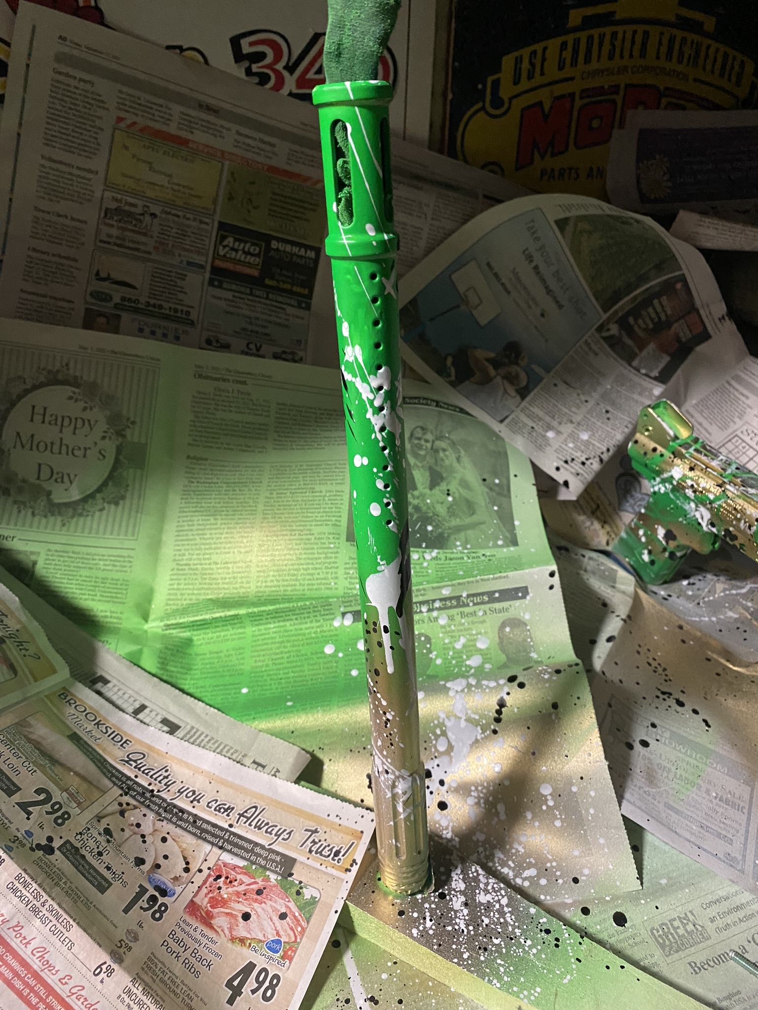

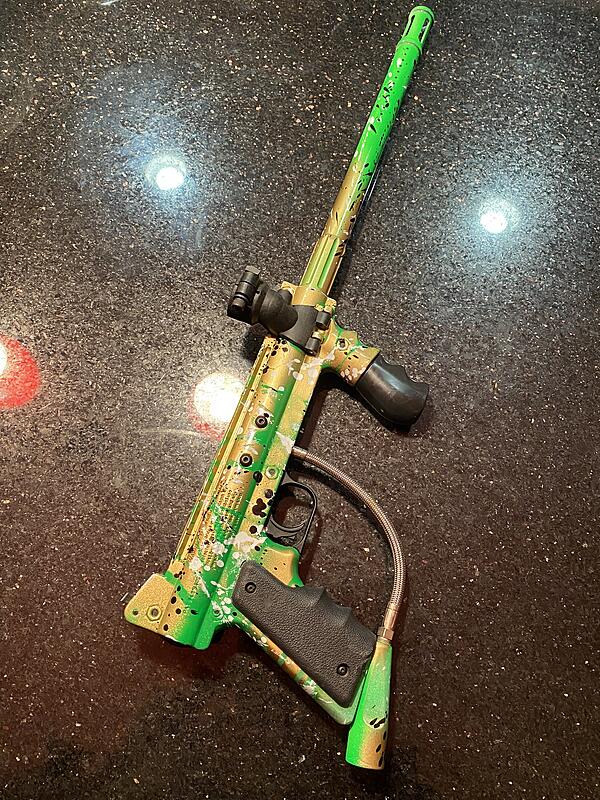

      Jonnydread Did a full rebuild and splash style paint job for Mr Dread. Fun project.
      C2A6317B-378C-4C52-89AF-955659287908.jpeg 1405CEA2-AC24-42A7-BE8A-7280E9A08429.jpeg 4A830594-6EEE-4B2F-82DE-DB130D13BD02.jpeg 89D7C62F-7130-4D9A-9373-2083DBC4E463.jpeg
      • Brokeass_baller
        Brokeass_baller commented
        It's all good man. I appreciate the reply. I'll be voting your technique in the future. Lol
      • Cavemanpaintball
        Cavemanpaintball commented
        We were all praising that custom job at the blow back game! It looks great
      • NONOBLITUS
        NONOBLITUS commented
        Well that’s cool to hear , thanks.

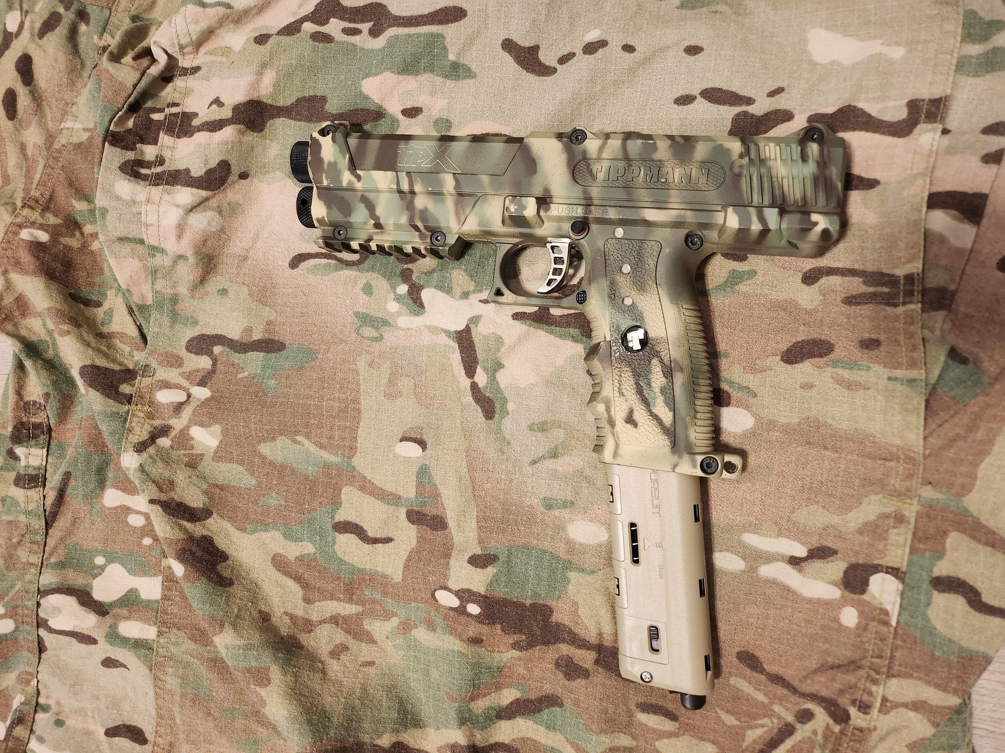

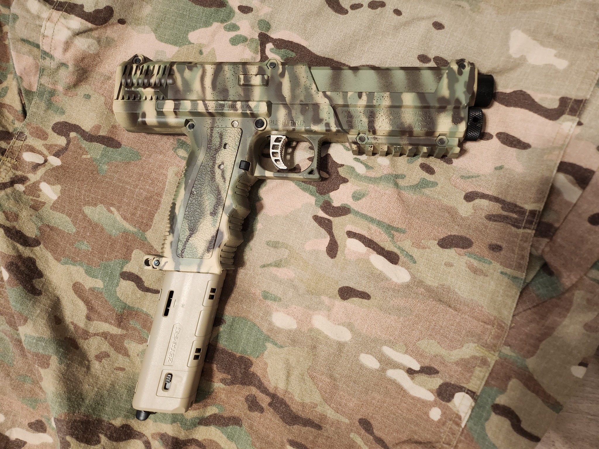

      Here's my impatiently-painted-in-the-backyard TiPX!

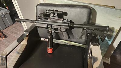

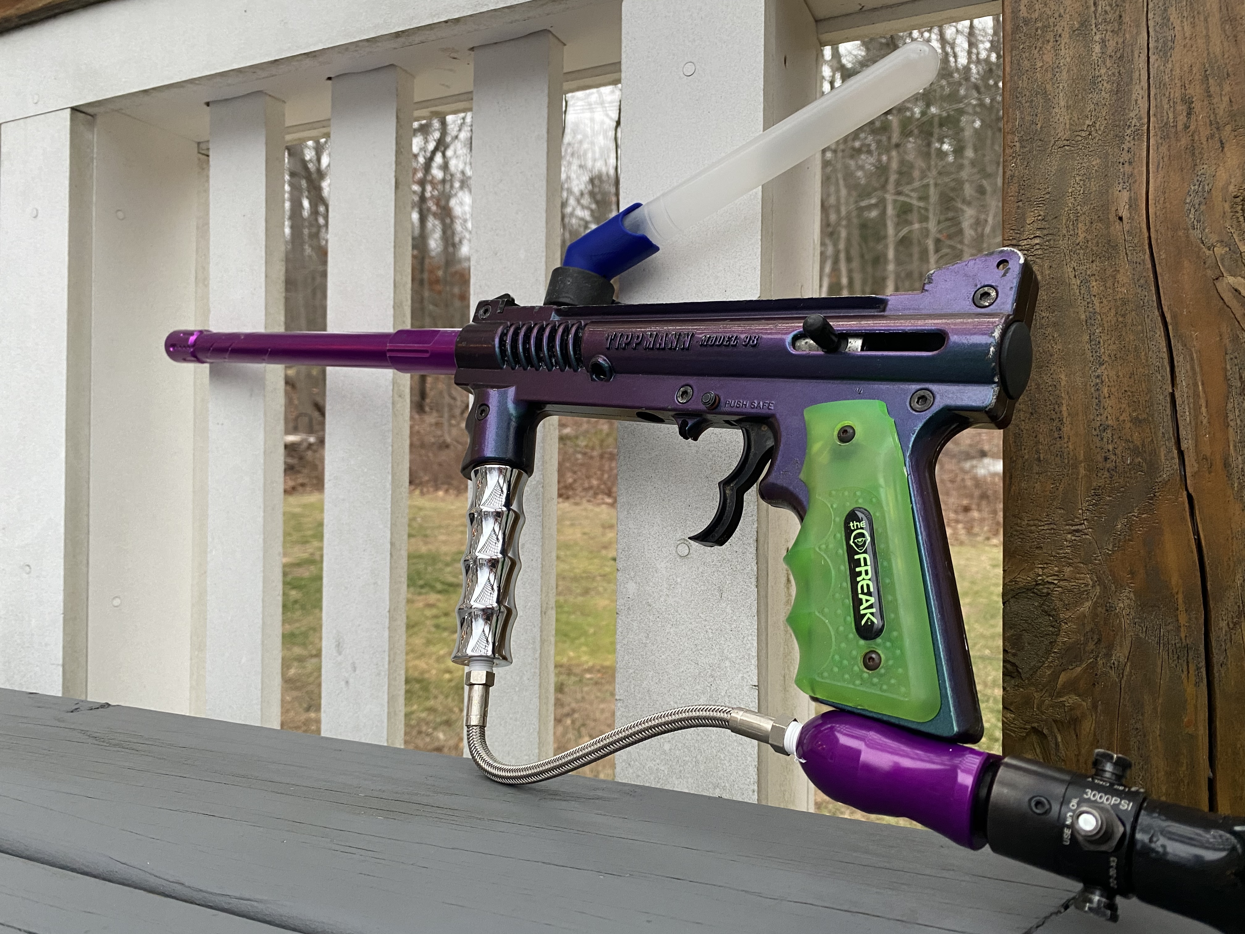

        A "subtle" 98.
        Sight rail, 98, and finger grooves have been filed off. Fresh powder coat. Polished internal clam shells. Safety holes have been filled in with JB weld. Both trigger springs have been lightened. Gas line has been drilled out, Valve plug has been swapped with a smaller carbine style plug for more volume. Trimmed black warrior spyder valve spring, weakest mad man striker spring. Dead On RVA. LAPCO cocking handle. Front bolt has a rear "o" ring upgrade, and a ramp added. Feed neck has been ported for blowback and has the wobble "o" ring fix. APP Front Grip. Not sure if this counts as a sleeper or not.
          Wow that'a really nice build! I love the APP front grip, may have to try and find one myself.
        • Myrkul
          Myrkul commented
          Thanks man! APP still has them listed on their site, and this one came from Tippmann parts so they have them in stock as well. I always hated the stock finger grooves.
        • gnarlynick
          gnarlynick commented
          Curious, what is the carbine valve plug you mention here? Is it literally putting the brass piece from a pro carbine that seals off the front portion of the valve? What benefits does that provide?

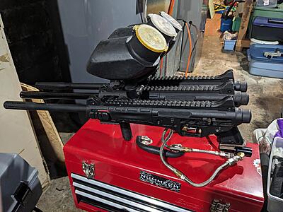

            The Leviathan
            Pneumatic trigger triple Tippmann carver.
            Built for the pile of poo build off.

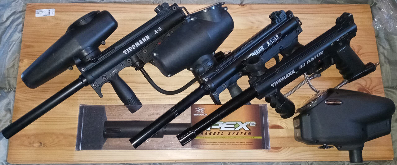

                      I played in the late '90s/early '00s with a Spyder and fawned after the 98C and A-5, but could hardly afford paint and CO2, let alone one of those two markers. I also wanted, but couldn't afford a Viewloader agitator. Now...
                      The 98C has a Response Trigger which is what the Halo Too is for and the middle A-5 has an early e-grip with screwdriver adjustments. There are higher-performance markers available for sure, but these have vintage appeal for me.
                      Late '80s PGP, late '90s Spyder, two A-5s, a 98 Custom, and a TiPX.
