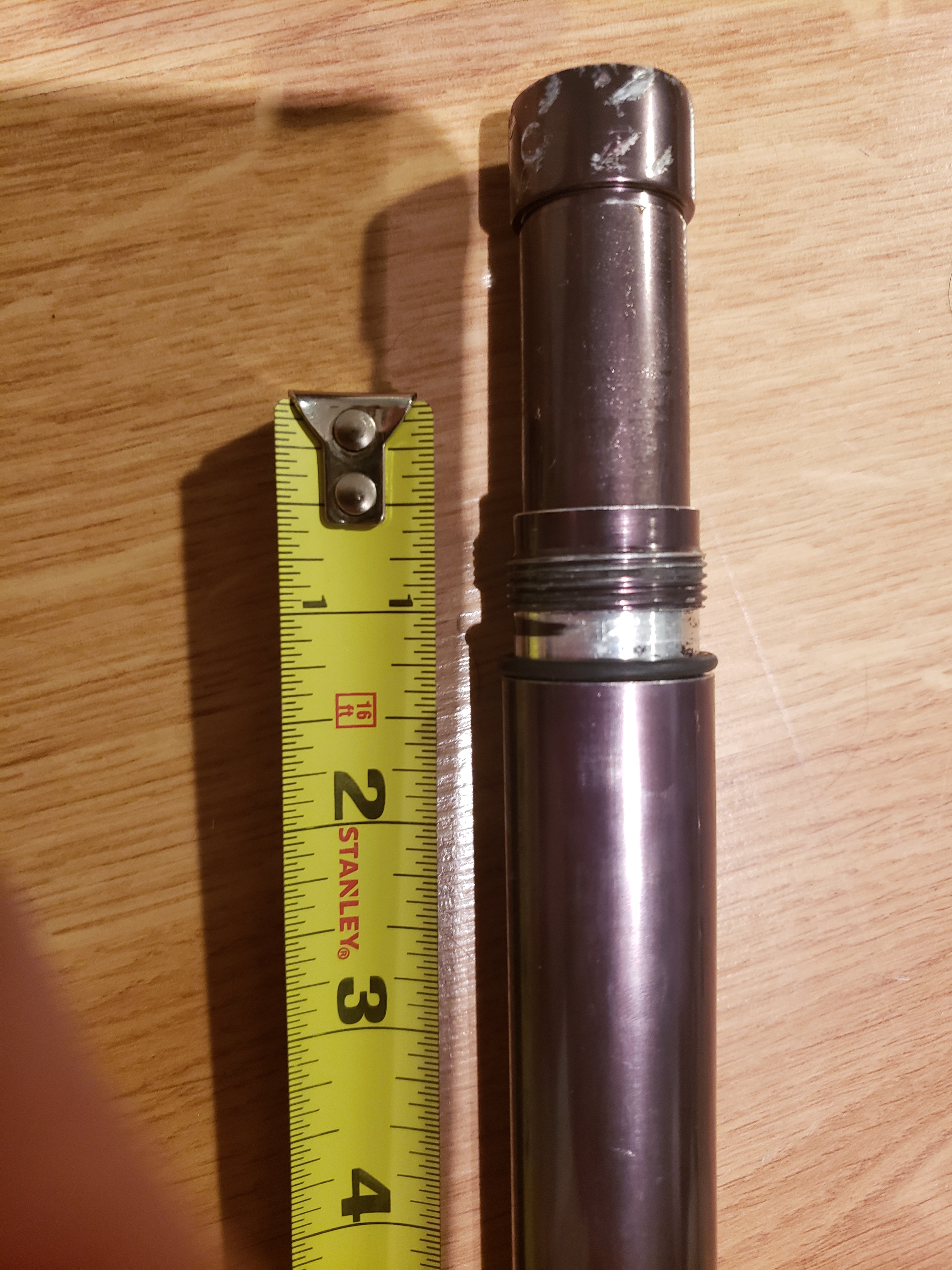

          I have been think about for many year than I found this https://stanchy.com/collections/barr...insert-adapter after some thought you could modify this as a thread adapter
          The other problem you need to find a way to stop the freak insert from coming out the back on some barrels

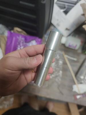

                Here's what started this whole mess. A semi-finished and lightly dinged Freak back, for which I entered a slightly incorrect numerical value, as I was trying to tweak the program on my numerically-controlled lathe.
                As I said at the beginning, I'd been thinking of a mod to make a "retained" barrel for a good while now, and this was the perfect donor.
                After doing a few calculations, I lopped it off 'bout thar, turned a boss and threaded it.
                I then dug a suitable piece out of the cutoffs bin that looked like it wanted to join the fun, drilled and bored it, and then gave it a matching step and matching threads.
                A little cut-and-try got a good snug fit.
                Not shown was a little more cut-and-try to get the depth for the insert just right. But once that was done, I bored it to .693", faced the end to match a Nelson bolt (the O-ring lands on the barrel bore, not the insert bore, but the ball goes entirely inside the insert) and with that dimension, I was able to toss on a ubiquitous WGP thread.
                And it's just that easy! One 'Cocker thread classic-Freak back, 1" nominal OD, with the insert positively retained.
                Now, anyone wanna loan me a Carter?
                I suspect that, like the Bushamsters, the end of the barrel will wind up under the pump grip, so for either a Carter or Ranger use, these will almost certainly need a "Bull" barrel tip, though one could be made to emulate the Carteresque stepped down and AA-drilled factory barrels...

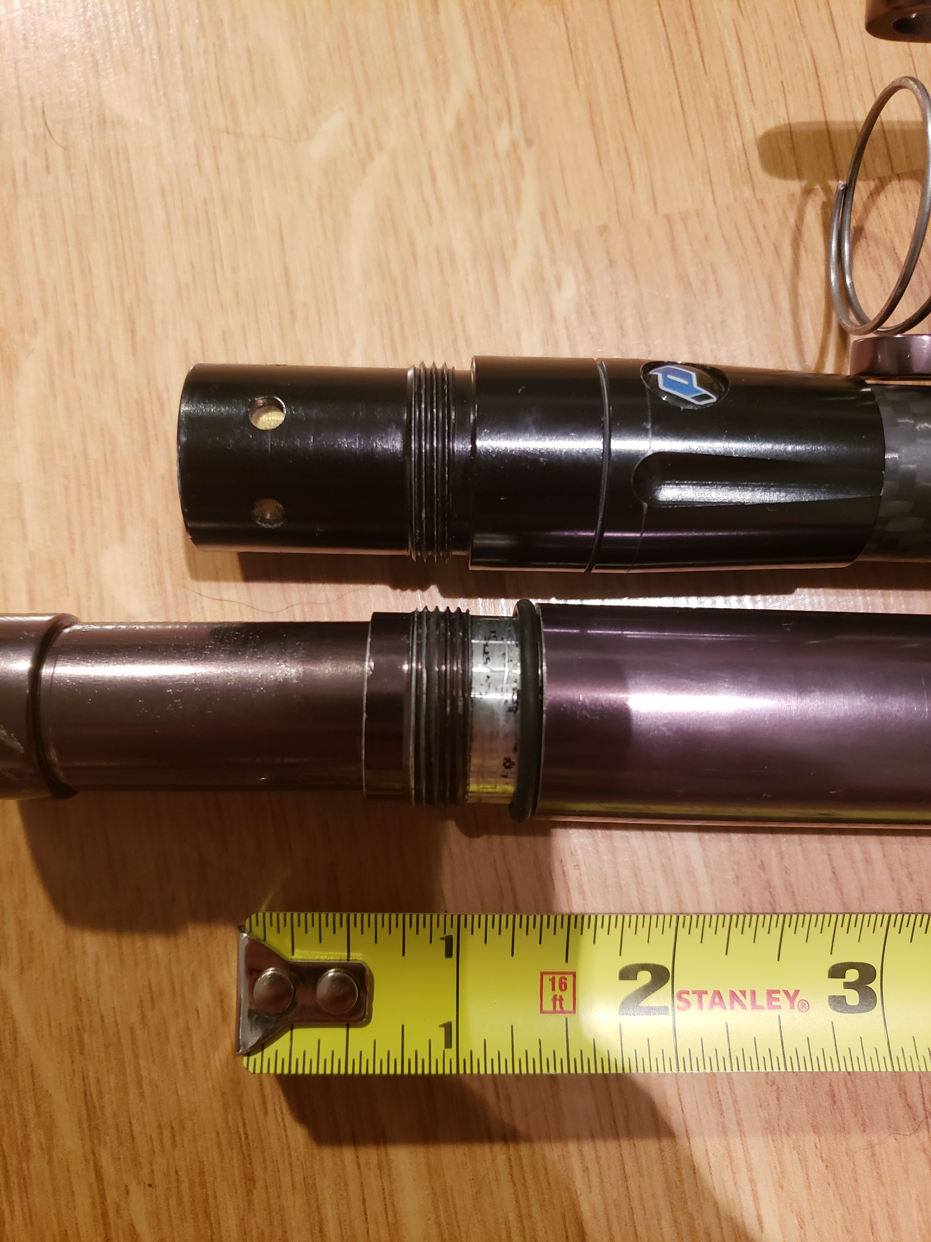

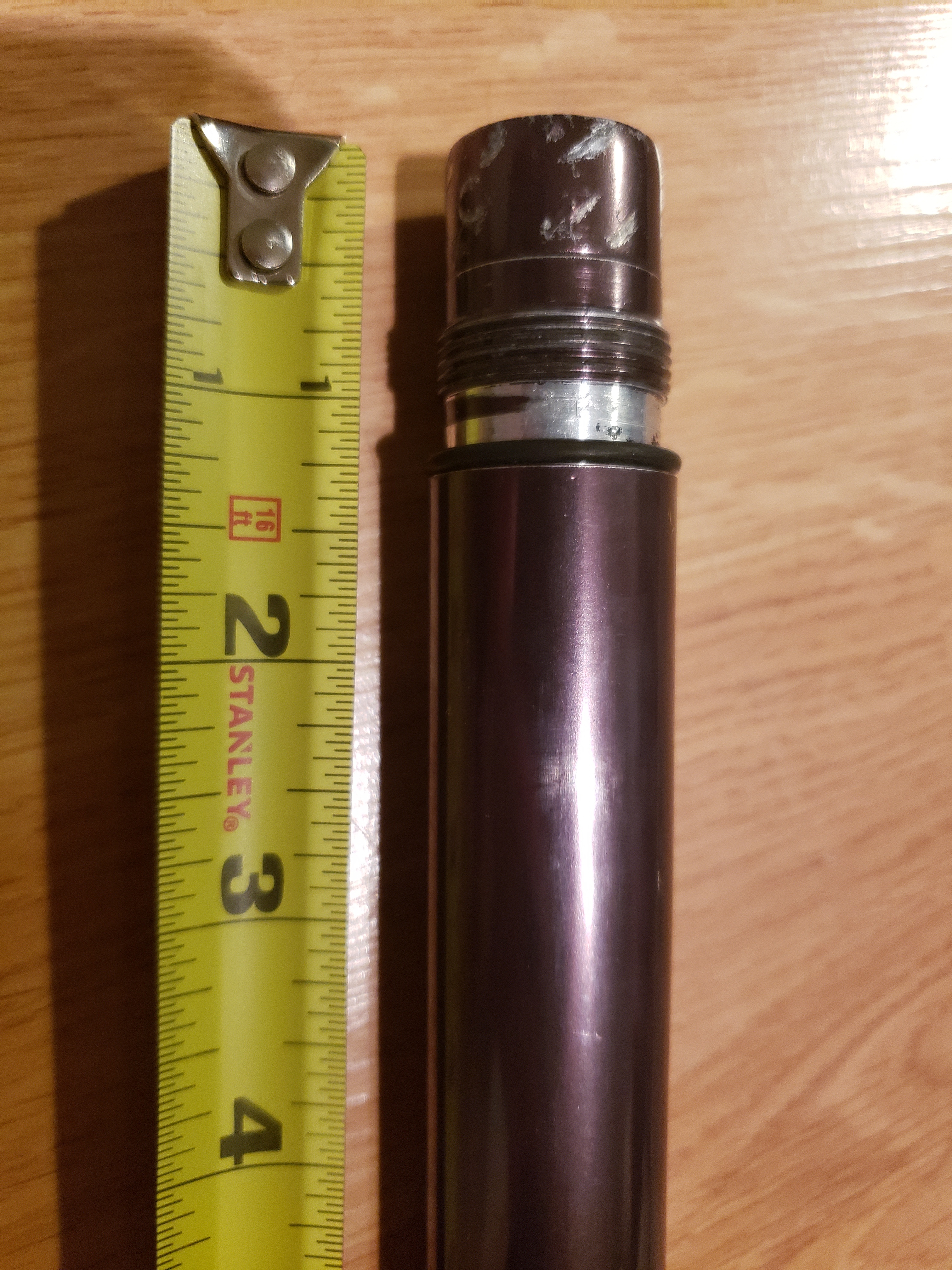

                    Extremely close to WGP Threads but quite a bit Pickier on barrels. Most AC barrels will work for atleast the first couple of threads but might not fit fully threaded in.
                    side by side with a deadly wind autococker barrel:
ID:	353566 Click image for larger version
