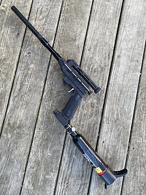

    Well at 450psi input pressure it shoots nicely. Ran about 100 shots through it so far. Maybe I can get out this Sunday and give it a ride.
    I got #2 so that’s pretty cool I like it so far. Seals right up and was GTG out of the box. I’m a lil bummed about no 12g play but it shoots nice and it’s definitely a unique design. Dual detents are great zero roll outs or double feeds. Looking forward to the VASA option. Hopefully I can get out this weekend and stack some bodies with it.

      Dang this thing is loud. Could just be the 6" (hehehe). I did notice that trying to load with 10rd it's not easy to get them to fall into the feed tube (an easy fix).
      Feedback:
        It’s the unported 6” barrel. Mine isn’t bad with a bore matched ported 13”

          I did. It ran okay, I ran into two main issues:
          1 - Paint breakage. I couldn't shoot more than 8-10 shots without one breaking in the barrel.
          2 - Velocity. In order to get close to the field velocity cap of 280 FPS I had to CRANK the regulator as high as it would go. At the highest setting using ~.679 paint, a .680 5" insert, and a 450psi output tank I was getting ~270 FPS. I tried a higher output tank and had the same velocity.
          1a - It was a cold (low 30s°F) and windy day. The cold could definitely have influenced the breakage I was seeing, but it's worth noting my cocker pump (running a .689 barrel and dummy detents) had no paint breakage issues. Additionally, it's possible the very high regulator input pressure could have contributed to the breakage.
          2a - I would imagine that in "normal" playing temperatures (60°F+) velocity wouldn't be as much as an issue, but as a Northeast player who plays all winter this was a stress test and I would say the Phoenix gets a C- grade for performance.
          When shots successfully left the marker (without breaking) the gun shot nicely and it was fun to shoot. The only other minor complaint is that when aired up the marker pumping action felt like it was dragging a little bit. This could likely be solved with some sanding/polishing or even just by breaking the gun in more.
          In summary, it still has some kinks/quirks, but I think with better paint and warmer temps it'll be a weird and fun little marker.​
            Mine were a lil loose I had to re tighten them they moved on me and touched at that point and bound a lil.
          • RuleOfSines
            RuleOfSines commented
            I can’t even get a single tube of rounds before it breaks paint, and velocity is garbage. I believe that is from the orings sticking. Running oil through it clears that up, but damages the clippard valve. Same problem as the Thumper.
          • dozernaut
            dozernaut commented
            I had the same experience with mine this past weekend. Weather was in the 40s all day. Broke 2-3 balls in Chrono. Maxed out the velocity at 270 fps and good paint bore match. Pinched a ball in my first game and couldn't fix it on field. Switched to my empire sniper and had zero issues for the rest of the day. Same barrel, same tank, same paint.

          Is the ball breakage from:
          Air pressure from piston to high?
          The capturing/loading of the next round?
          The double detent being too stiff?
          Temp plus back pressure?
          Or a mix of a few things?
          • RuleOfSines
            • 906
            • Massassassachusetts
            #72
            I’m away from mine at the moment to test, but I think the sticky piston opening too slowly is forcing me to raise the pressure higher and higher until the shot becomes too violent. My thumpers did this too, completely disassembling the marker and oiling the piston rings helped dramatically. Silicone orings also helped, but they tore too easily with the thumpers operation.

              Is anyone else's pump stroke really heavy the last 10% or so? Like the cocking action itself.
                Yeah that was the drag I was referring to in my post.
              • RuleOfSines
                Yep. The return mechanism seems to get kinda crunchy during that last bit of travel. I was considering trying to swap the pump and hammer springs
