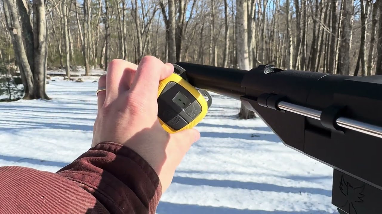

    Got mine working! Only needed a completely redesigned front end.

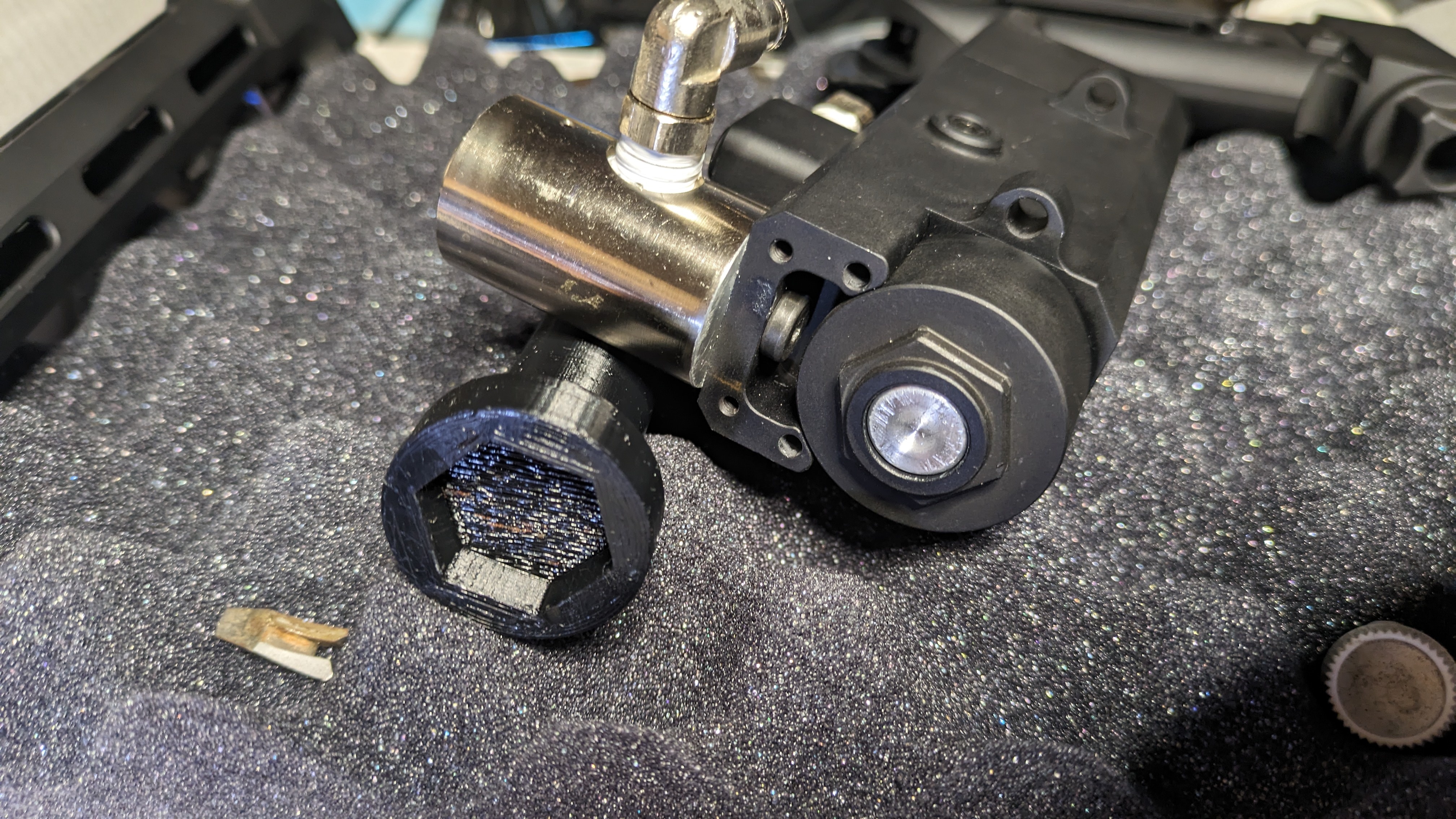

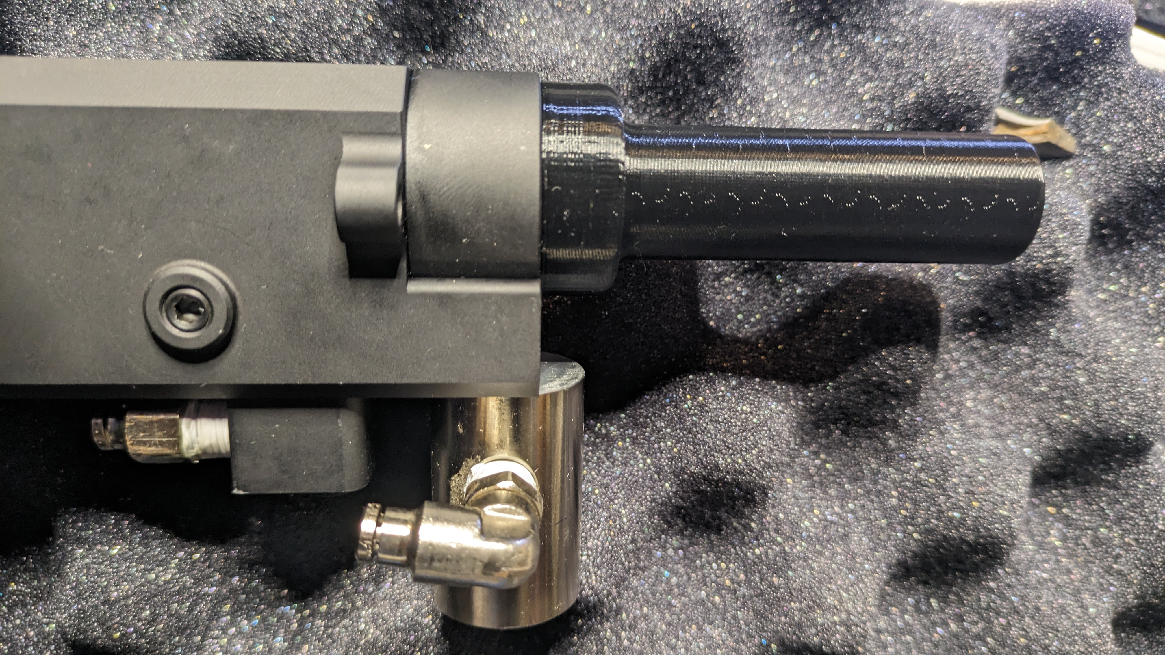

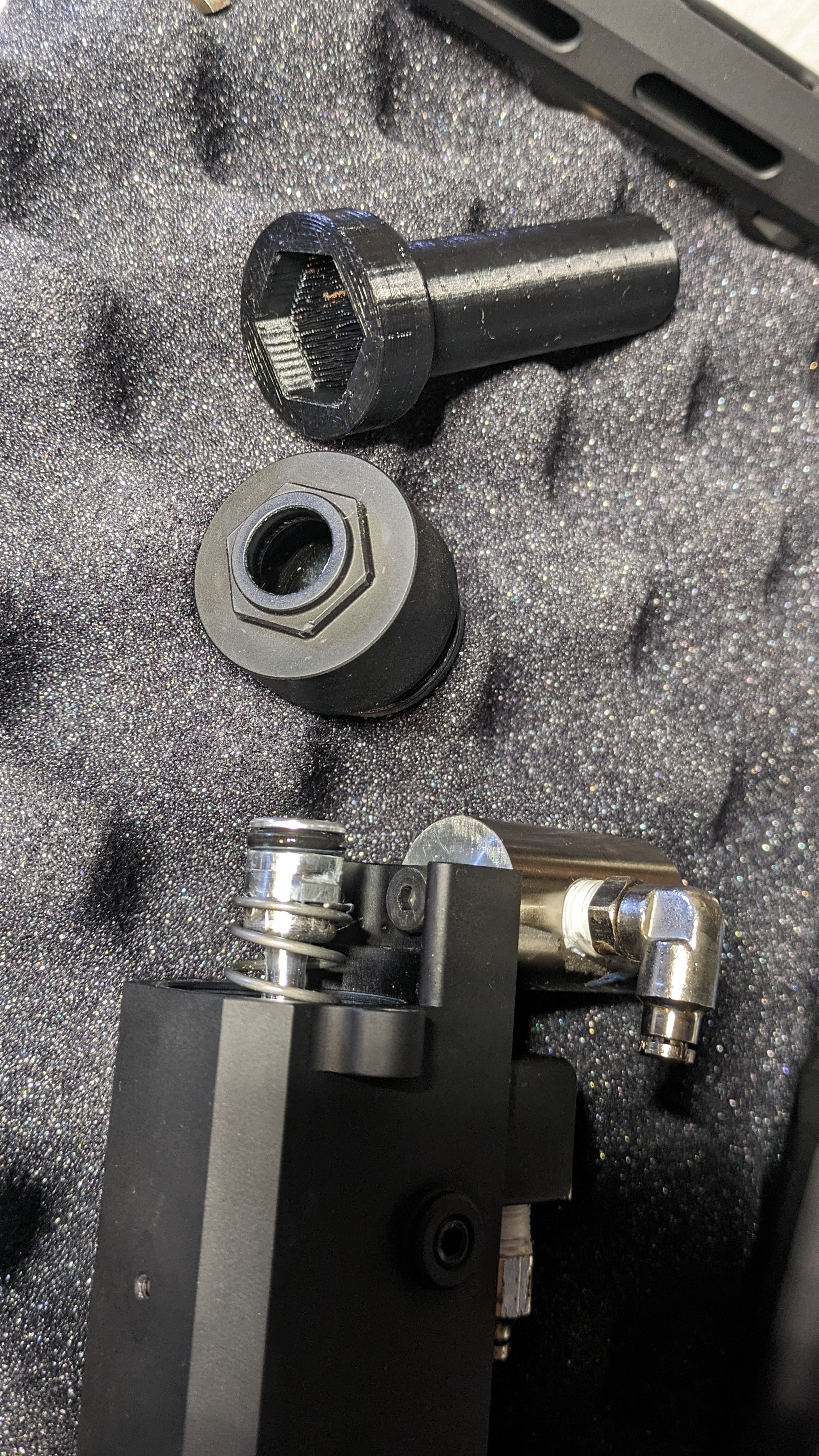

        I tried to buy a spare part and its starting to feels like I'm getting ghosted by Metadyne ... So time to post here (I'll be making a more detailed thread soon)
        Also, got a note removal tool and spring holder tool made.
        Ho, and the first Phoenix with a VASA 😎
        Next: CO2 testing!

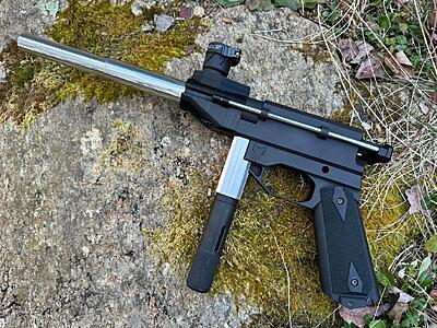

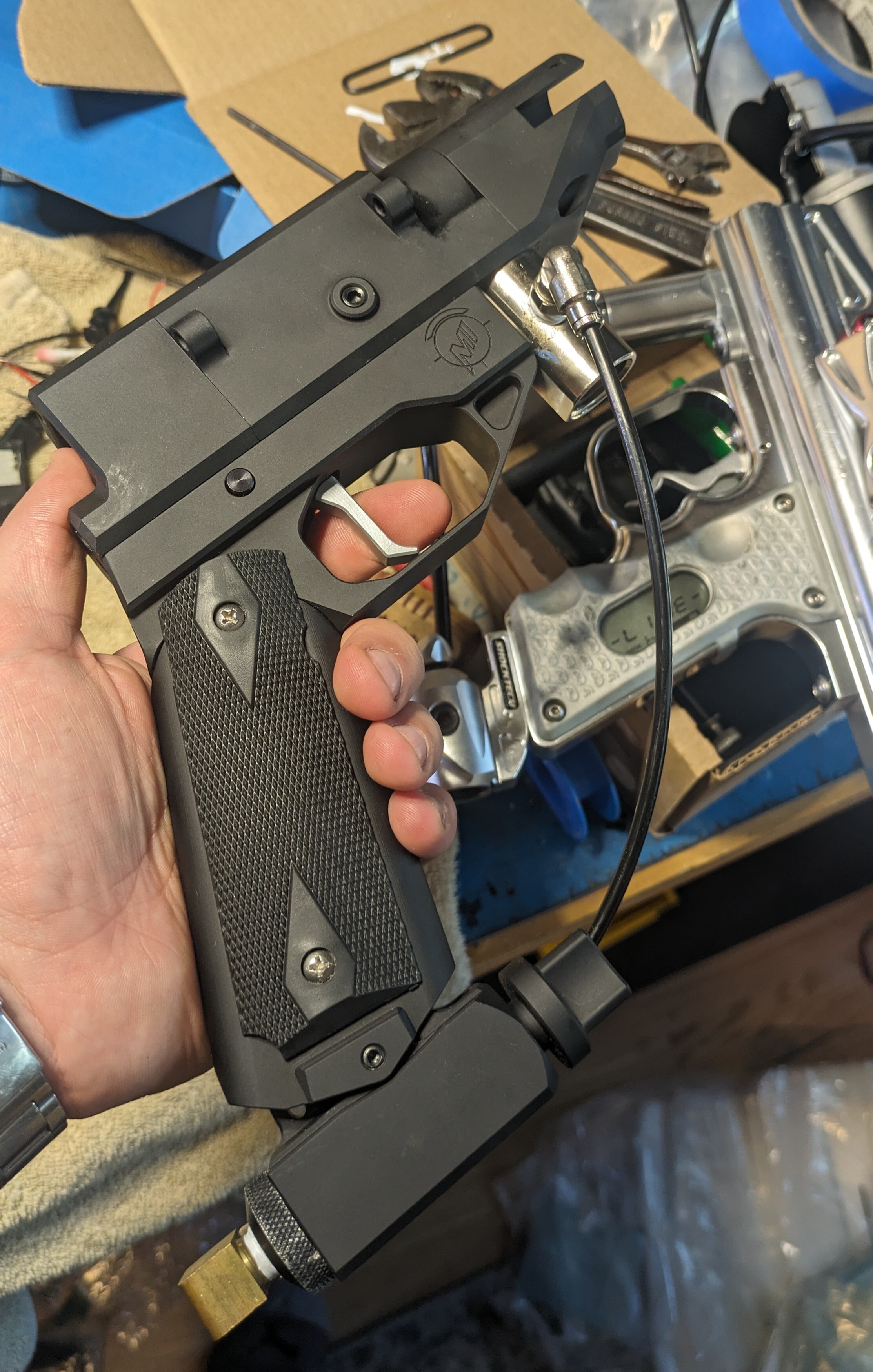

            Working on turning mine into what I wish it was from the beginning.
              Did the same to mine 😅
              still working on thé Airlines...

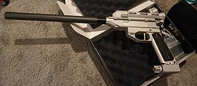

                  Finally got my hands on my phoenix, MI7- 0078.
                  sadly playing may not happen for another month.
                  ​​​​​​Observations:
                  1) all screws for my build had no issues/were not stripped thread wise.
                  2) I understand the crunch every feels and find it to be the captured spring behind the hammer. I'm probably going to file or round the edge down a bit to hopefully improve it.
                  3) Do not see the trigger biting into the body or frame yet, but will be watching for it
                  4) still the same issue on the 10 rd feed, tubes won't load paint without trimming the feed gate
                  5) I feel the detent style is a good cause for chops, if the round leans to one side or the other it will catch the edge of one detent stiffly and stop it from being pushed into its slot.
                  6) paint matching on grey is two different shades of grey. Blah not good
                  7) the adjustable grip is nice, I feel there is enough material to grab onto. The hose is too short to adjust the asa and grip to the extremes.
                  ​​​​​​Looking forward to see if she shoots well, or has the break issues I believe will happen.
