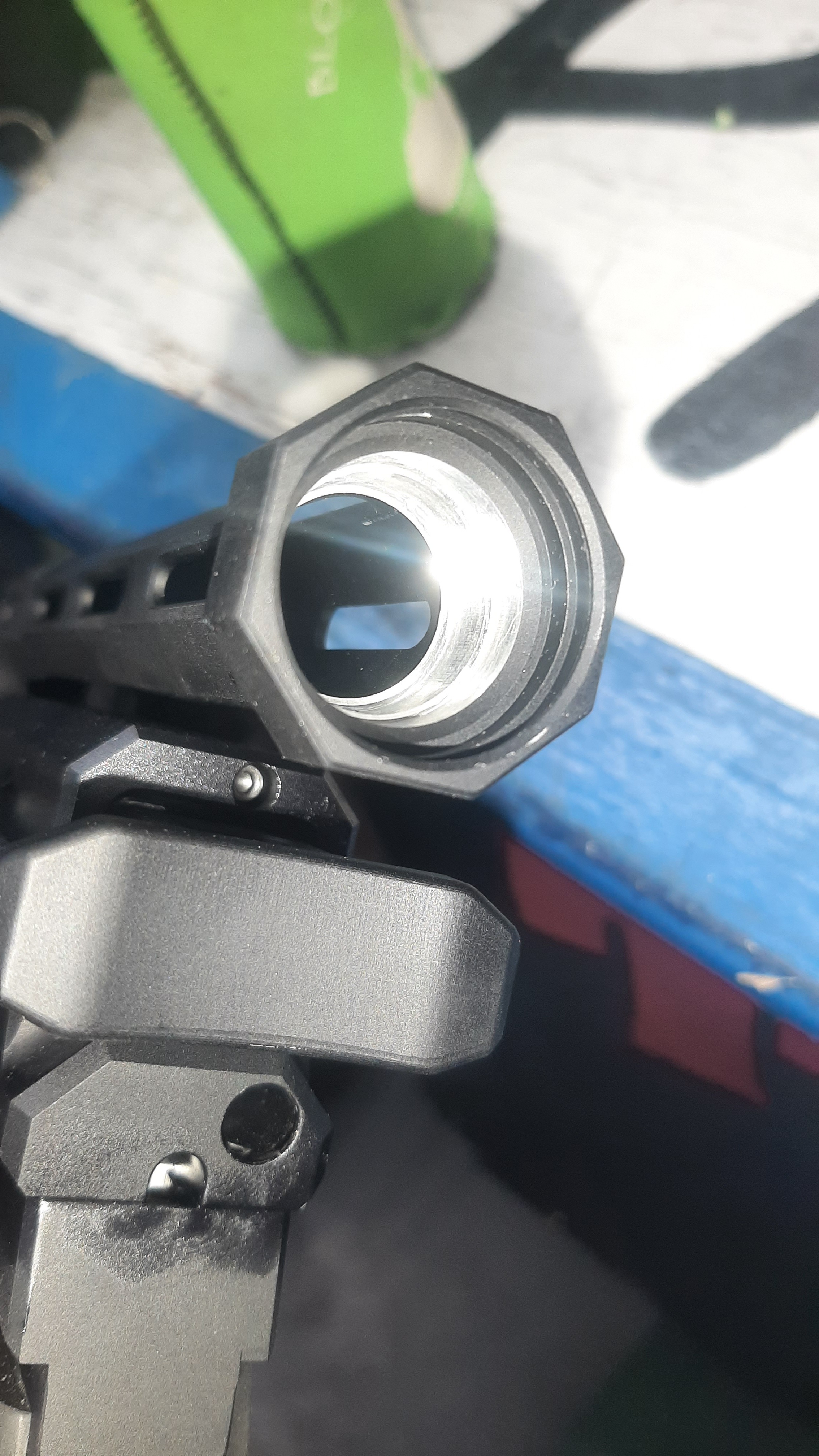

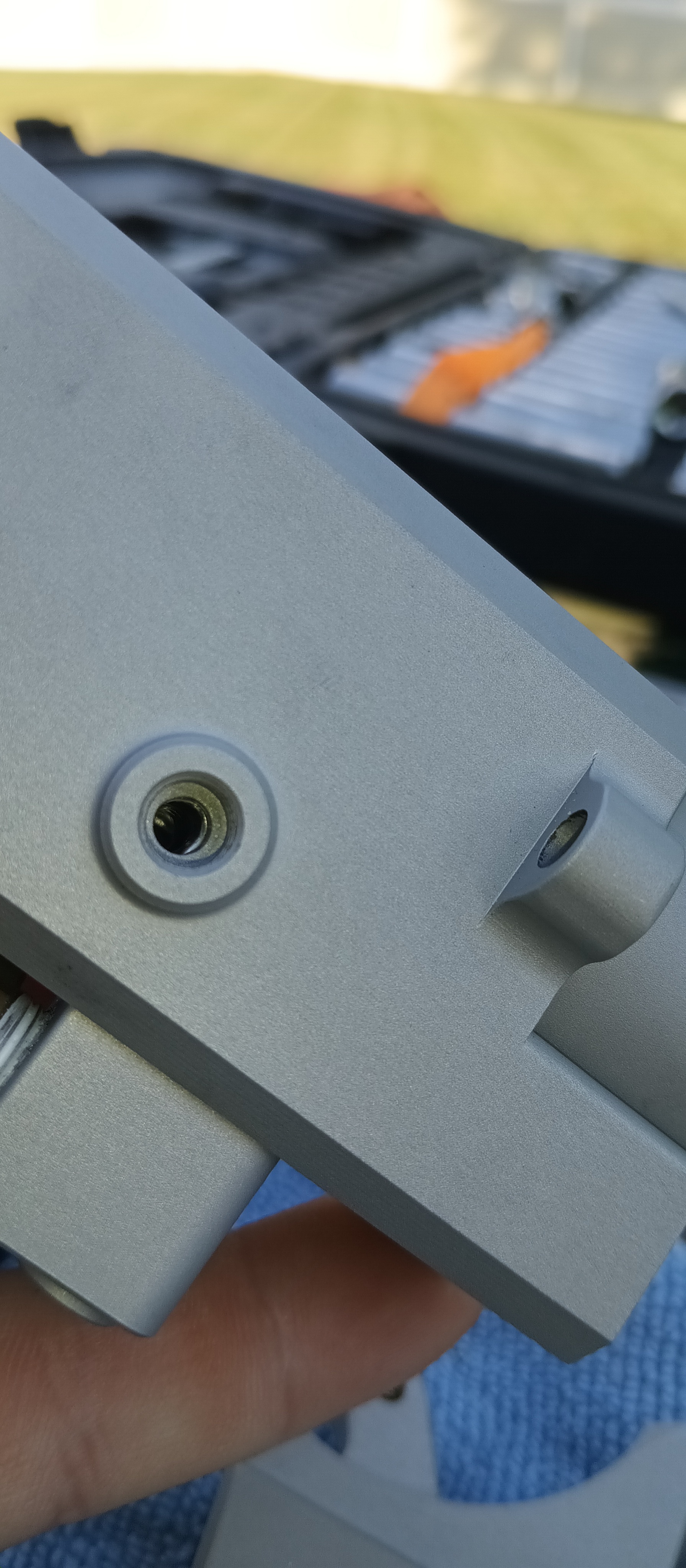

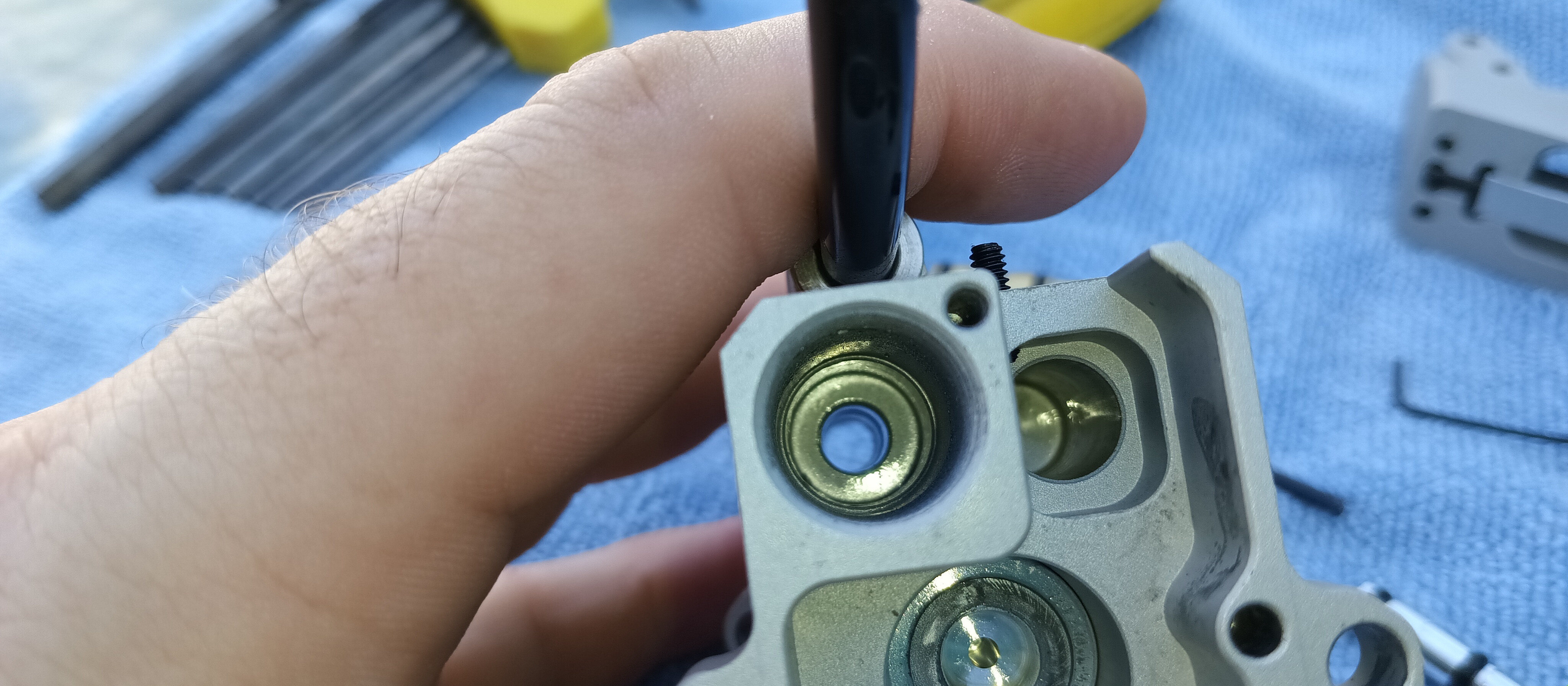

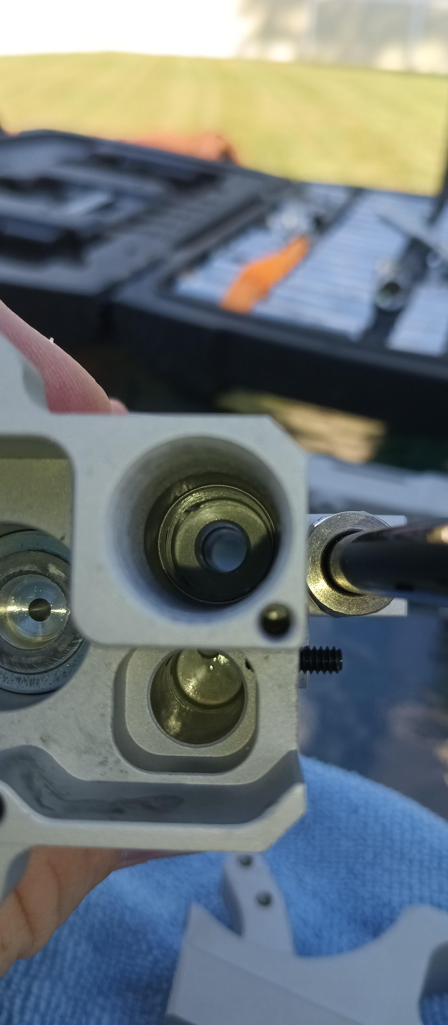

    I know this is not going to go down well, Considering all the problems everyone has had but... i shot it today at stockclass and it performed great. No breaks, chrono'ed 275. Absolutely no issues.
    I bought the phoenix on ebay this week. Its number 0035. It came from Idaho (same as metadyne) i took it apart and lubed it(it was dry inside) it seems the guns has had a few factory fixes, the feed is bored out so tubes fit fine, and the barrel looks re-cut.
    there are definitely things i would have done differently if i was designing it.i was getting 18 shots to a 12gram,slightly worse then the Thumpers 20. And the feed could have been longer, like 12 balls. I miss the vert asa but a icd 12gram stock works great and you can hold the front of the frame and use the thumb paddles.

    Not any from the piston and reg. Area. Is the detent block always raw? Click image for larger version
ID:	558594 Click image for larger version
ID:	558595 Click image for larger version
    • Timefreak17
      Timefreak17 commented
      They really just killed the rear feed tube and left it un-anodized...ok. I feel that's a quick fix and a sharp edge for balls to hit while loading.
      The detent block is a raw finish, but probably clear coat anodized.
    • RuleOfSines
      RuleOfSines commented
      I was wondering if there was enough metal on the feed to bore it out like that without making it too fragile.

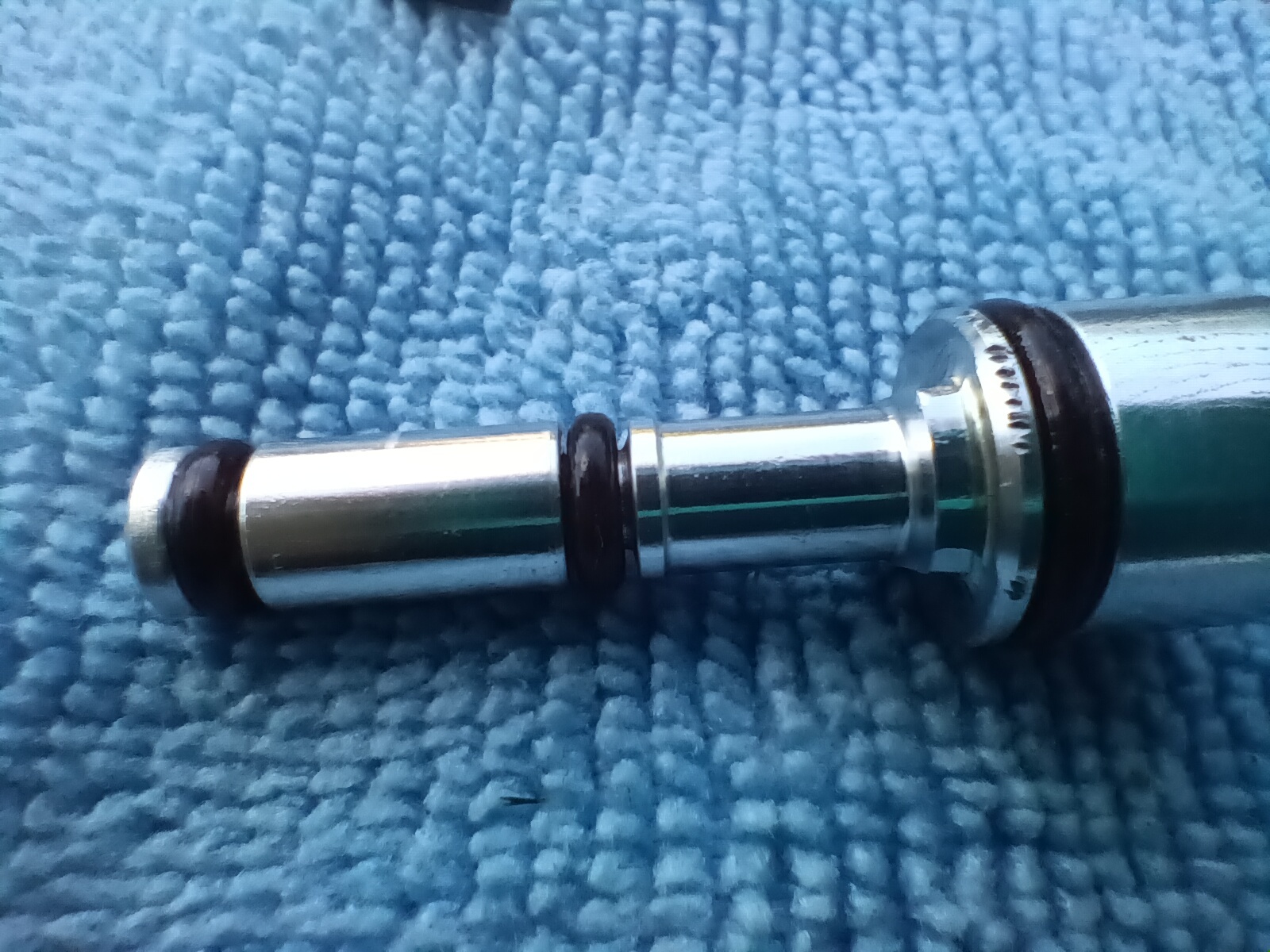

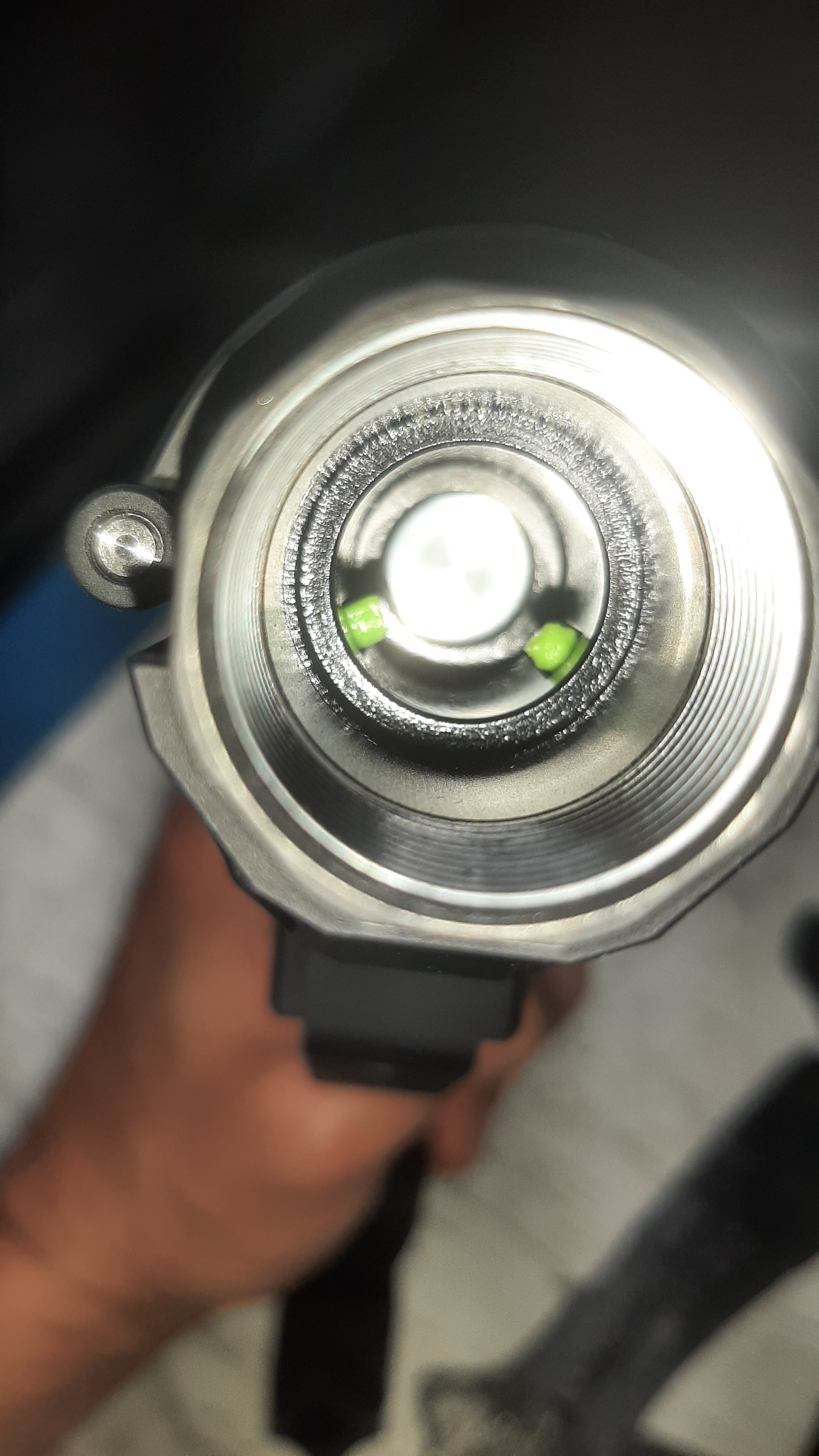

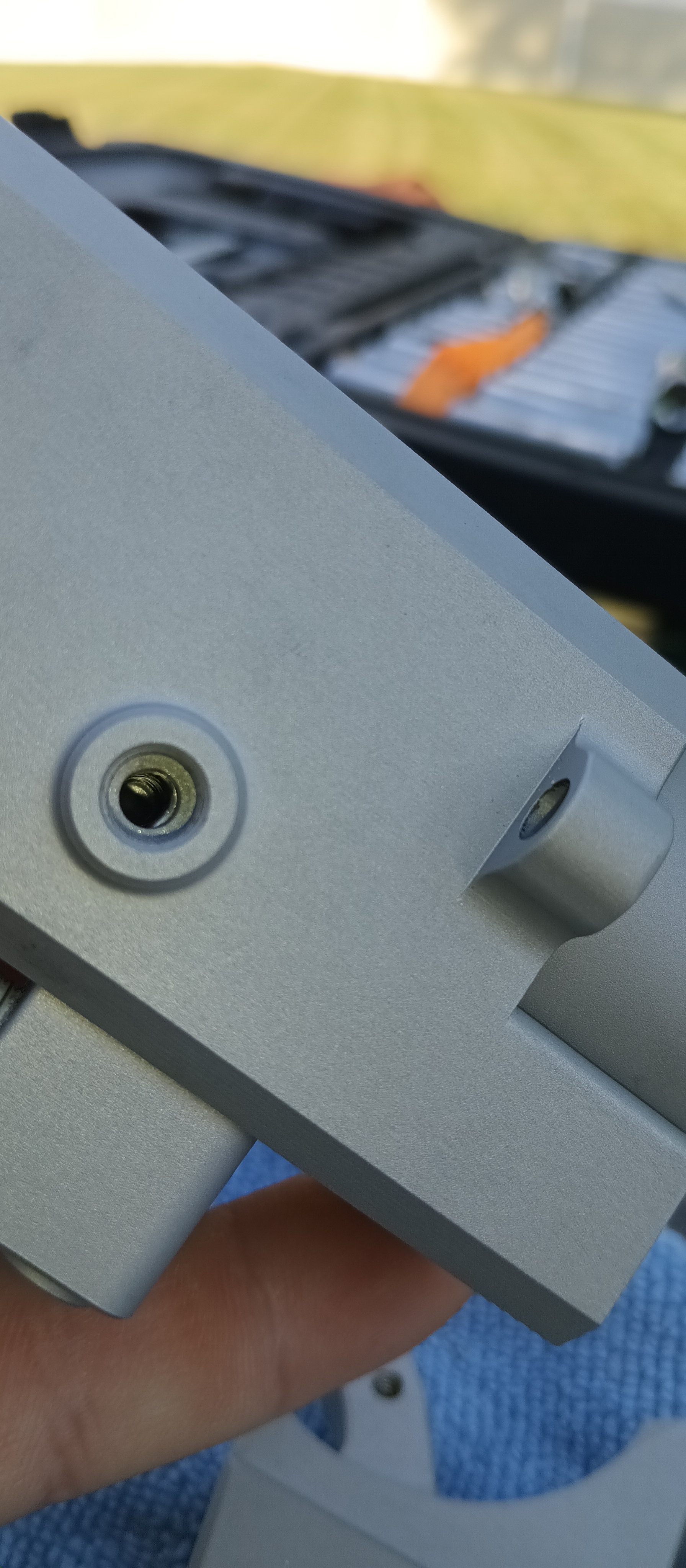

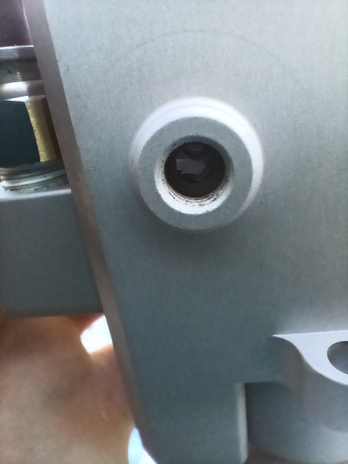

    Phoenix update:
    Replaced rear pump spring for a slightly stiffer spring, same diameter, but slightly longer and thicker wire.
    Re-tapped the ac threads in the breech to allow my older ac barrels to work. Metadyne always has a weird thread issue with their ac threads size.
    Definitely holds the breach tighter to the body.
    Shooting field paint, using reds ac barrel with .687 back.
    Was messing around with velocity again. Could not get consistent velocity for some odd reason. I had it before but now it was all over.
    So tore it down to each part possible and found this problem.
    The velocity adjustment piston was marred up and notched like shark teeth.
    So the drilled air thru hole between the velocity adjustment piston and mav-3c valve had a aluminum burr in the piston housing. So Everytime I would adjust the velocity I would add a notch to the piston when I cocked the phoenix under pressure. Those notches would jam the piston movement as well. So one shot would be 250fps, 134fps, 220fps, 120fps, 105fps, 253fps.
    ​​​​​​So I fine sanded the piston back to smooth. I used a Dremel to de-burr and grind down the problem area in the piston area through the screw thru port.
    Removed all shavings and re-grease the o-ring s and areas needed. Then put everything back together.
    Velocity was 280, 276, 284, 289, 281, 277, 290, 284, 284.
    I think I solved my phoenix. No breaks while shooting or in the breech.
    Shot another 20 rounds just to see what happens, and just worked.
