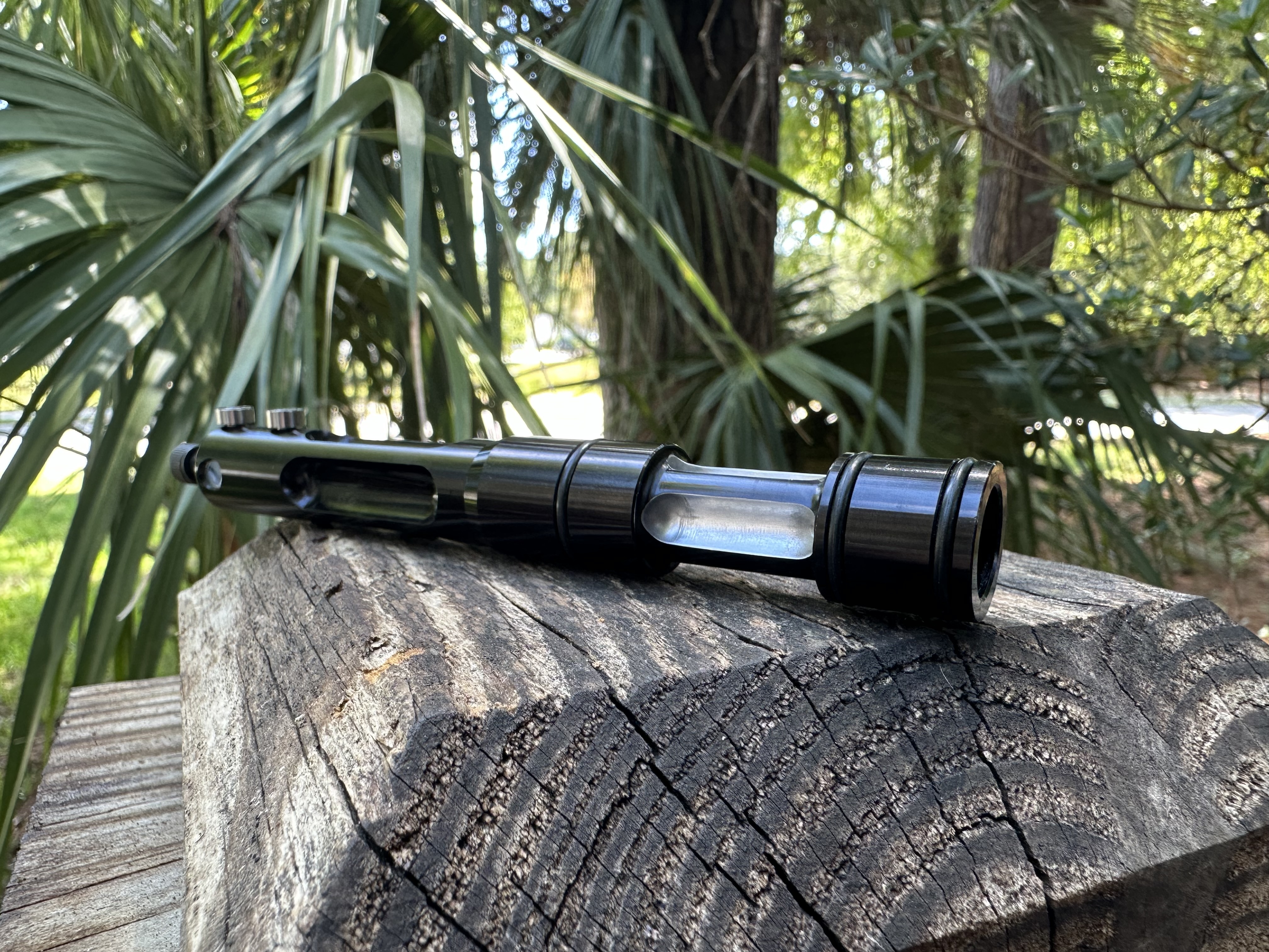

          Well after messaging with latches109 some. I decided to grab my other meteor pump and cut the guide rod in half.
          Installing this is a bit more of a pain, but not to difficult. I was able to drop this to 220psi at 291 fps, 2 oring stock meteor bolt, valve, hammer, inception lightest spring, about half turn in.
          After that i pulled the modified spring perch out and installed the attktx spring perch that came in the mail today. I was able to drop the pressure to 205 psi at 285 fps, everything else the same as above.

          • latches109
            latches109 commented
            That is a super clean cut!! way better than my sawzall

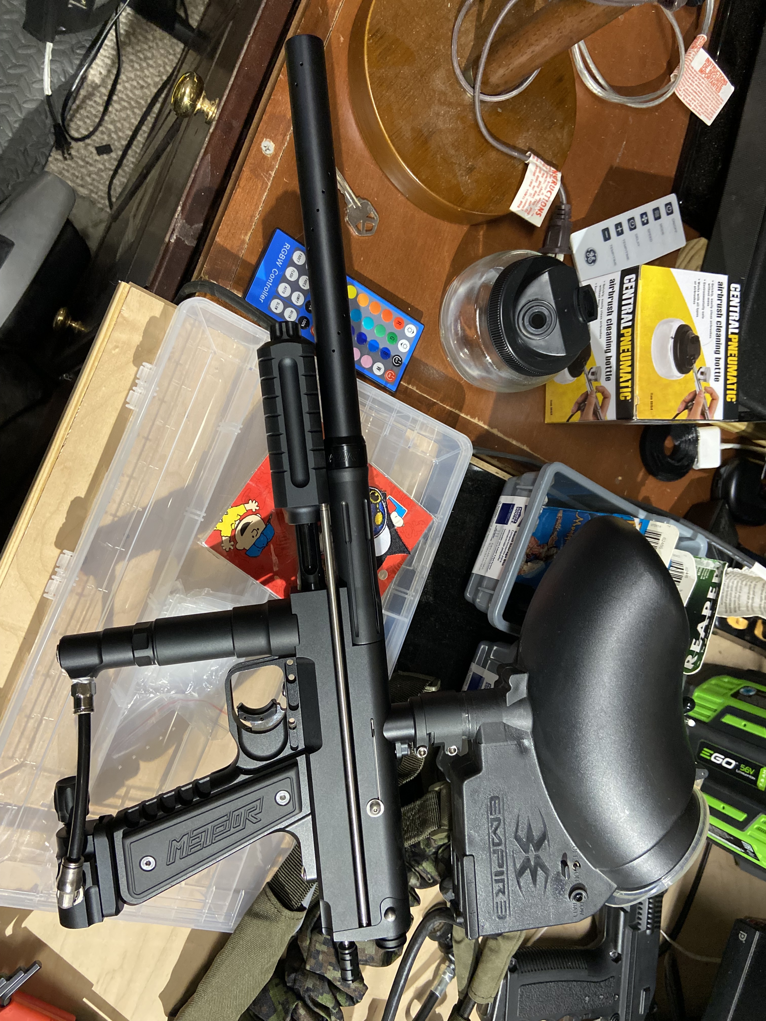

              New meteor sniper with reg will be for sale this week
              • 4423
              #104
              Always when there's no spare change lol
              • GanonsGrin
                Skeet Surfer!
                • 525
                #105
                • GanonsGrin
                  GanonsGrin commented
                  I just bought the reg to finish mine off as I wasn’t happy with the look of the stab that was there. I will get it dialed in this weekend and hopefully getting it shooting smooth. The reg looks GREAT on here though, I just wish they would have made it available from the get go.
                • latches109
                  reg looks great!
