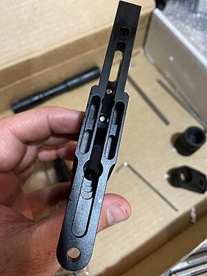

    Stock Internals…
    This gallery has 3 photos.
      Cdn_Cuda commented
      Thank you!
    • Grendel
      Grendel commented
      Conical Compression Spring, they allow more movement without the coils bottoming out on each other. Not really necessary on a valve IMO but would not cause an issue spring rates are the same for the diameter and #coils for a given length just allows more compression distance.
      That’s cool so they don’t stack on each other and kink. That valve is only moving probably like a 1/16” at most. Maybe the cone shape is due to the large bore the Pump handle fits in. The drill strait through the lower tube. Due to its design it dose not have any steps in it. The pump guide rod seals the front end with some orings held in place by the Vert ASA bolt from the bottom up. It probably saves a bunch of Machine time. Likely why they were able to keep the cost down. Quality to price it’s actually really impressive on this thing it’s really well thought out.

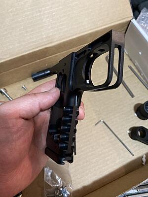

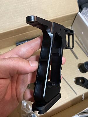

    Frame…

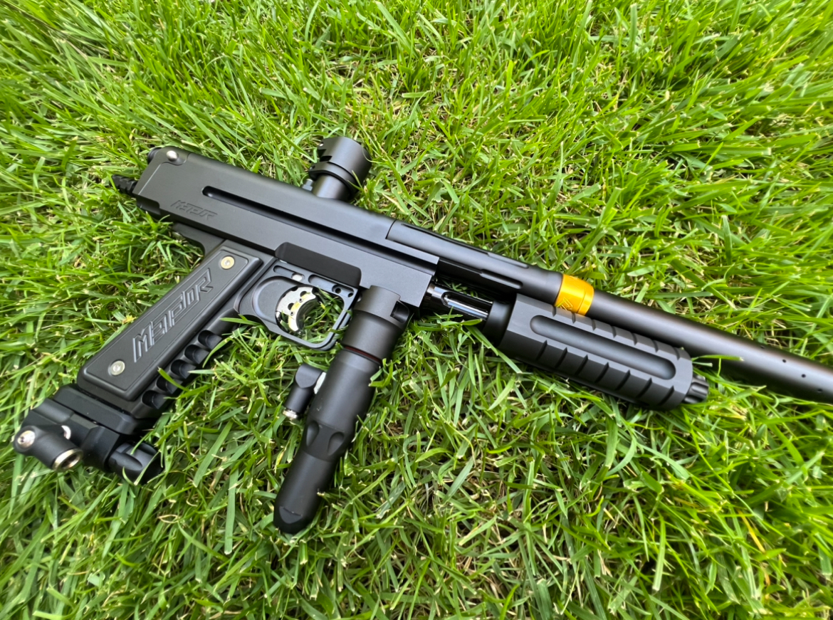

    My Mozak body is going to look very close to this lol. As I impatiently await its completion, I grow jealous seeing these
    Everything is still a thing

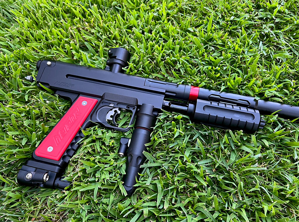

      Love it! This classic cut on the right side just like the old custom tournament guns is perfect! Delivering such quality at $400 is impressive. I’ll be back with a mech build on this body.
        That looks very nice, classy.
        CCM reg looks nice on it. I’m going to put the stock ASA back on when I get a plug for the other side. I threw a pops on mine because I had it in the toolbox. They shoot really nice. Hopefully more come back in stock at the same price. I know a few people wanting one.

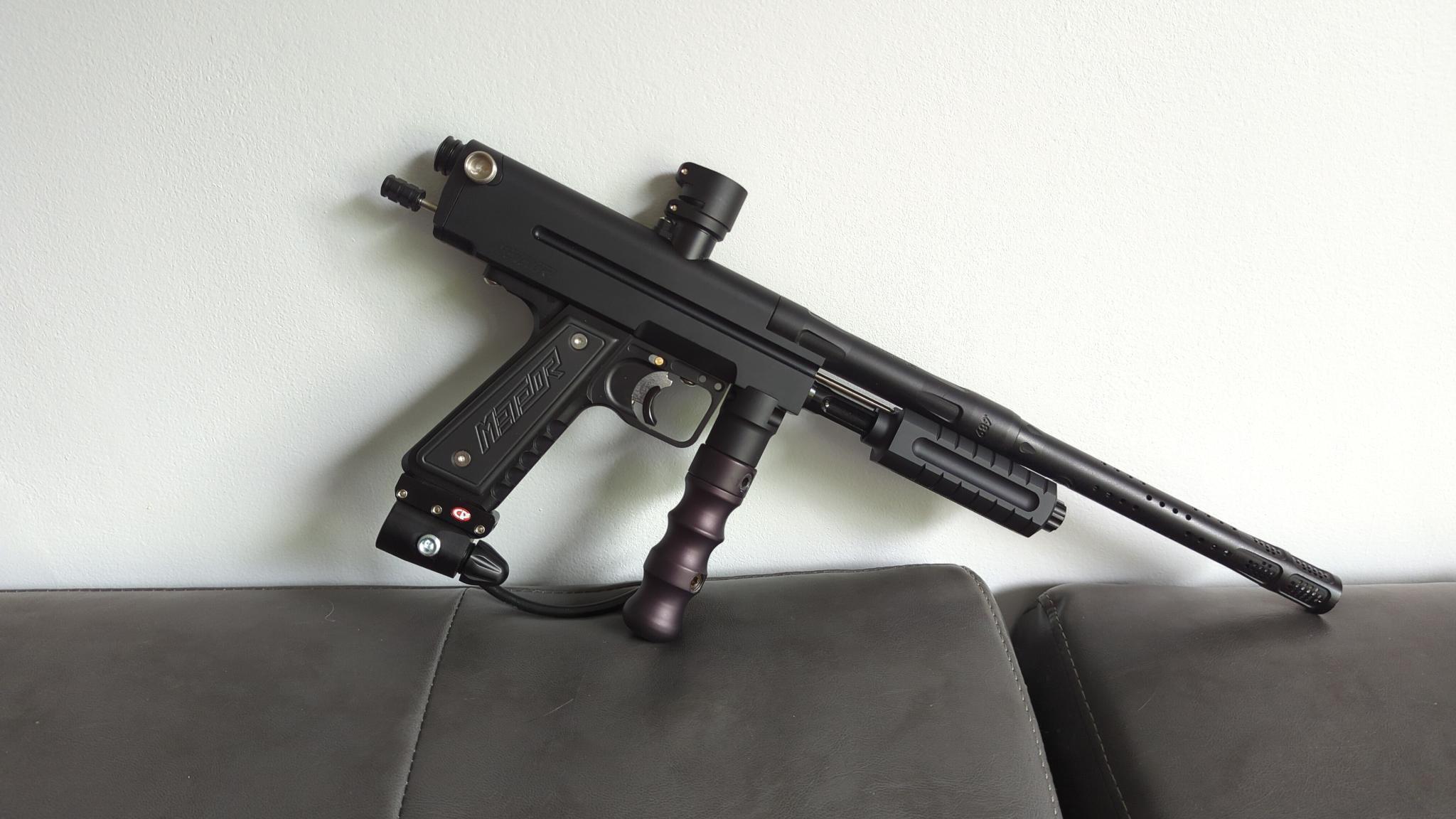

        A regular at our field bought one of these, and he brought it out last weekend. I have to admit, these are quite nice for the price.
        I can haz feedback?

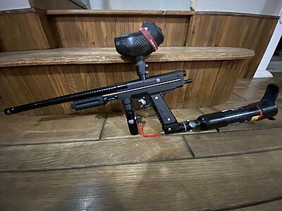

          Installed and tested a LaZ valve today. Chasing that 200psi which I got close to but didn’t feel right. The best combo was my 20g stainless speed hammer, light 2” spring, IVG flush, HPR 250psi, reball with the .677 back on the meteor 2-pc barrel. 285fps +-3. I can air rack it the pump stroke is so light. Feeling really smooth.

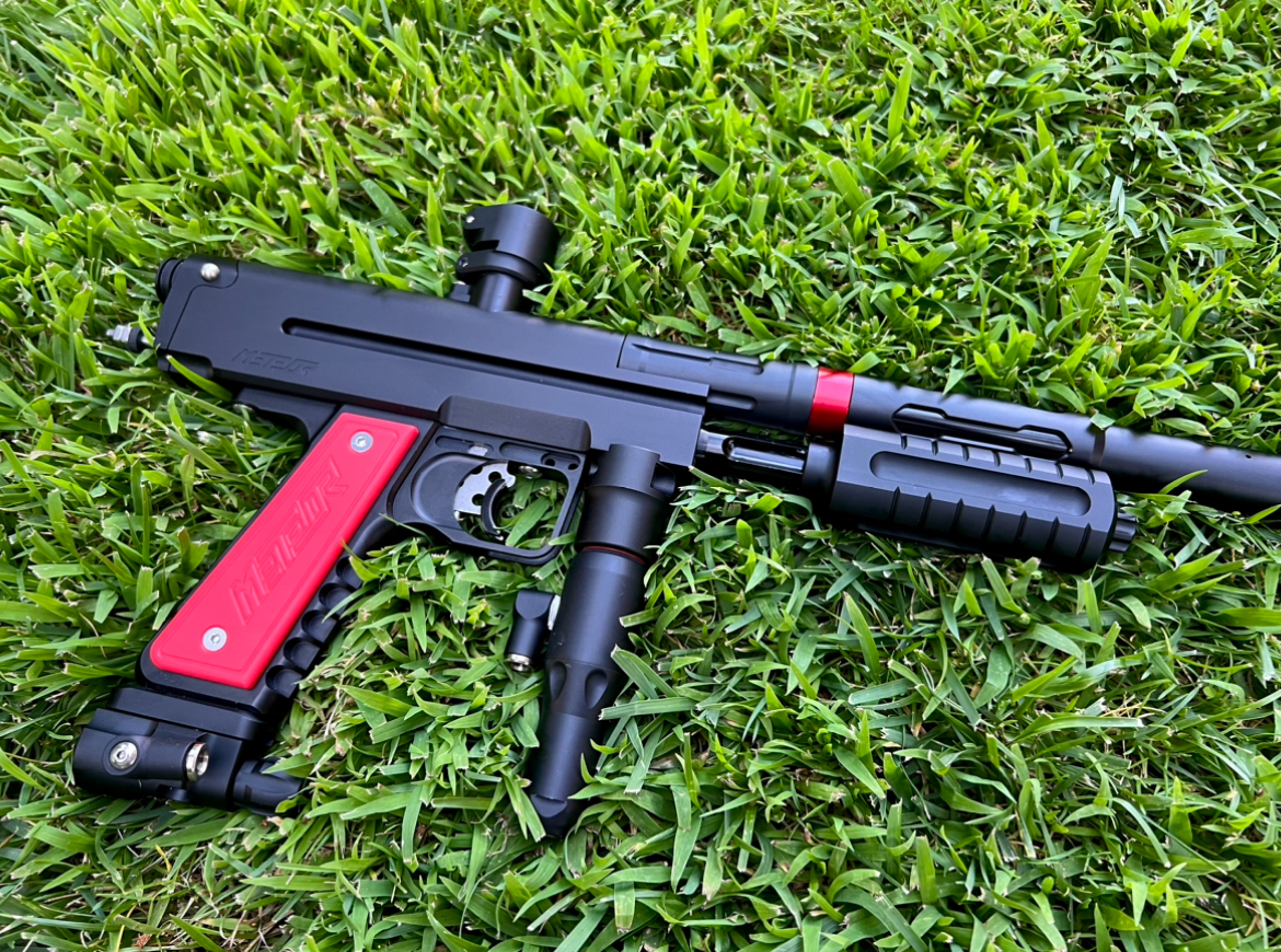

            I had to get in on one of these. The price was just too good.
            Sanchez Orbium, VF Tac Ergo reg, and a CP on/off just because it already had fittings.
            Dropped the Lazarus valve in, but I'll be lucky if I even have time to test it this weekend.
            • RAZRBAKK
              Unburdened by genius.
              • 1388
              • Calgary, Alberta
              #60
              I take it back, I got the afternoon off unexpectedly. The stars aligned and I actually have decent paint AND air on my first NGD in over 10 years.
              Hitting 270-280 fps at 280 psi with the Laz valve. I don't have a light hammer, so I'm actually running the inception heavy hammer with the 2nd lightest inception spring. 2 turns of the IVG.
              The inception hammer weighed in at 45 grams on my kitchen scale, and the meteor came in at 48.
