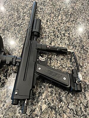

      I've got mine setup the way I want it, and how I envisioned when I bought it. Time to give it some funky ano! Click image for larger version
      • SoCal_Pumper
        SoCal_Pumper commented
        Nice setup, where did you buy the stock class feed tube?
      • KMDPB
        KMDPB commented
        Thanks! The tube is from a phantom and the feedneck adapter I made.

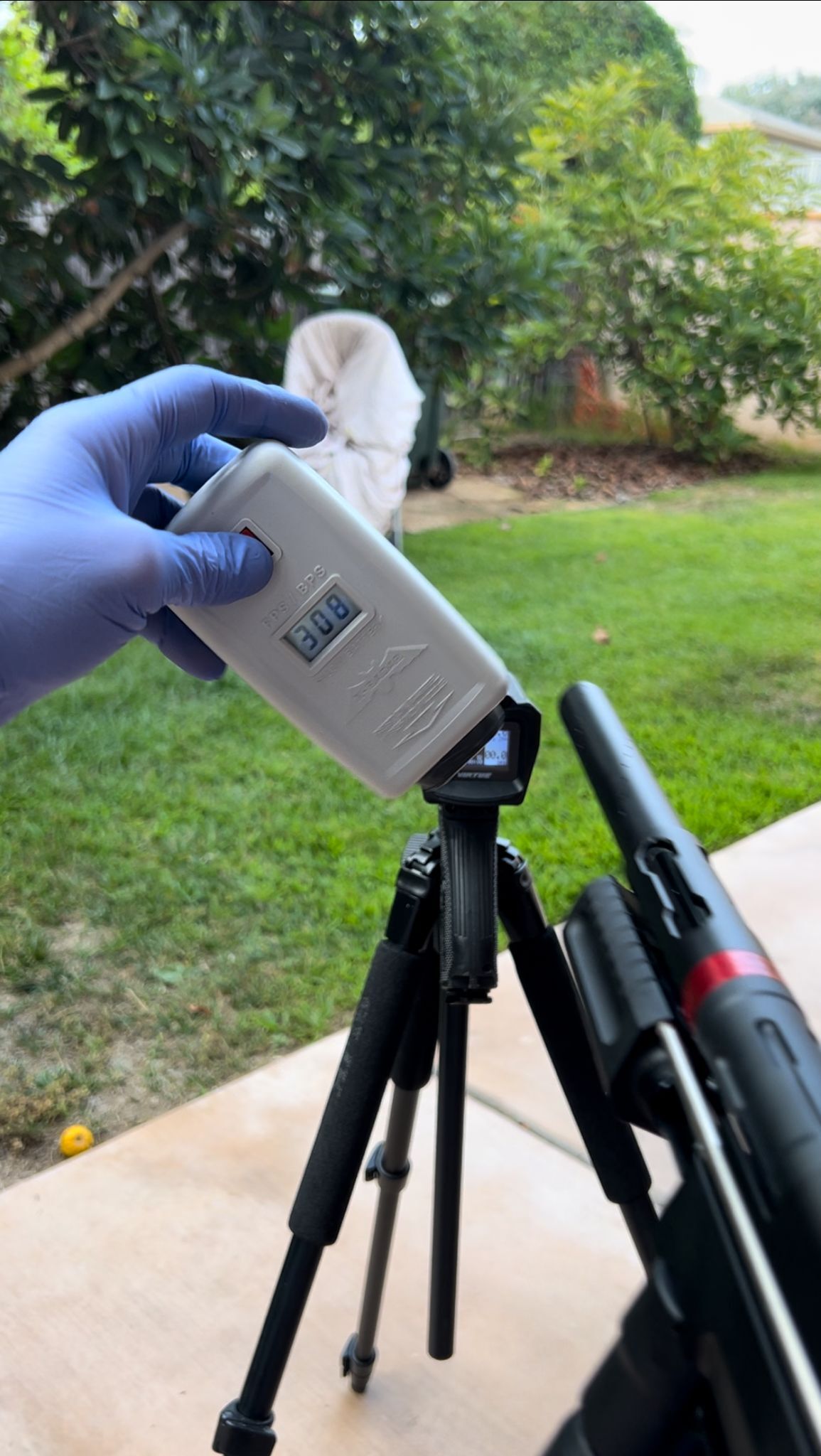

      I tested a few bolts and hammers, stock valve and Laz valve.
      The bolts with a front oring shot 20-30 FPS faster than the ones without. Very little difference between them, other than the sound. The ID trident was louder than the AKA for example.
      With front oring:
      • AKA Lightning
      • ID trident
      Without front oring:
      • Meteor stock
      • Belsales
      • Shocktech
      The stock bolt, valve and hammer feel great with the 2" spring I used, very smooth and a nice combo. I easily hit 300fps with the IVG flush and pressure at 250PSI. For the budget mined person and access to all day air, swap the main spring out for a ~6lbs/in spring and be happy. IF you want to squeeze every last drop of juice from the tank, get the Meteor bolt modded for the front oring, or use a front oring bolt, this gains you ~20fps and the Laz valve will gain you 80FPS or more.
      I have a video I can upload if anyone is interested. I''ll follow up with some screenshots.

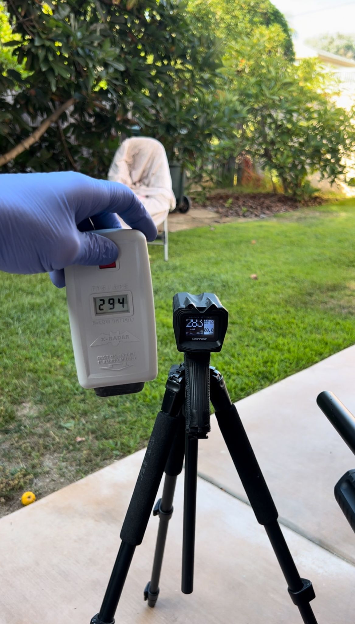

      here are the two hammers I used:
      • custom 20gram hammer + 2g lug
      • stock 46g meteor hammer + 2g lug (kiss polish with 10k grit)
      Click image for larger version  Name:	20g hammer.jpg Views:	0 Size:	91.1 KB ID:	576333 Click image for larger version  Name:	46g hammer.jpg Views:	0 Size:	99.2 KB ID:	576335
      without touching the reg, and the IVG always flush with a set mark, reball with same barrel and tank. Only variables I changed was the hammer and valve.
      Meteor valve, 20g hammer, 2" spring, IVG flush, 250PSI
      Click image for larger version  Name:	Meteor valve, with 20g hammer, 2in spring, IVG flush.jpg Views:	0 Size:	248.6 KB ID:	576332
      Meteor valve, Meteor 46g hammer, 2" spring, IVG flush, 250PSI
      I increased the weight of the hammer by 26g and gained ~100fps. F=MA works!
      Click image for larger version  Name:	Meteor valve, meteor hammer, 2in spring IVG flush.jpg Views:	3 Size:	244.1 KB ID:	576336
      what about using a balanced valve?
      Lazerous valve, 20g hammer, 2" spring, IVG flush, 250PSI
      I did this test first, then swapped valves, and did the hammer test. 99FPS is a fairly large increase over the stock meteor valve with the same hammer - I want to retest or have peer review, just to make sure the valve wasn't doping.
      Click image for larger version  Name:	Laz valve, 20g hammer, 2in spring IVG flush, meteor bolt.jpg Views:	3 Size:	268.8 KB ID:	576334
      aside: Clock 66 measures 10fps slower on average but both are consistent. Either the xradar is fast or the clock is slow.

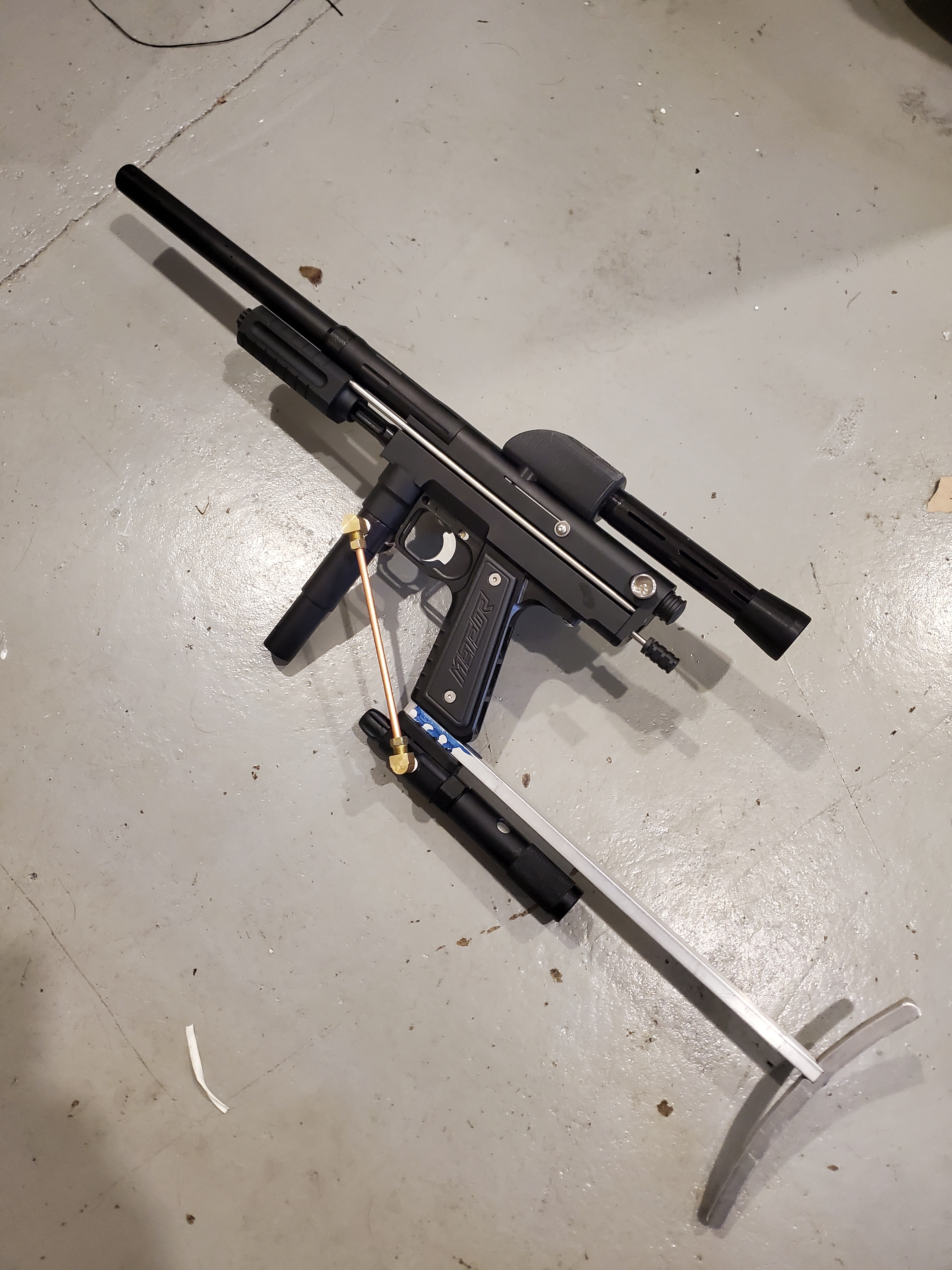

      Finally finished my meteor pump build with a CP reg and Shocktech trigger plate this weekend. Excited to get this on the field!

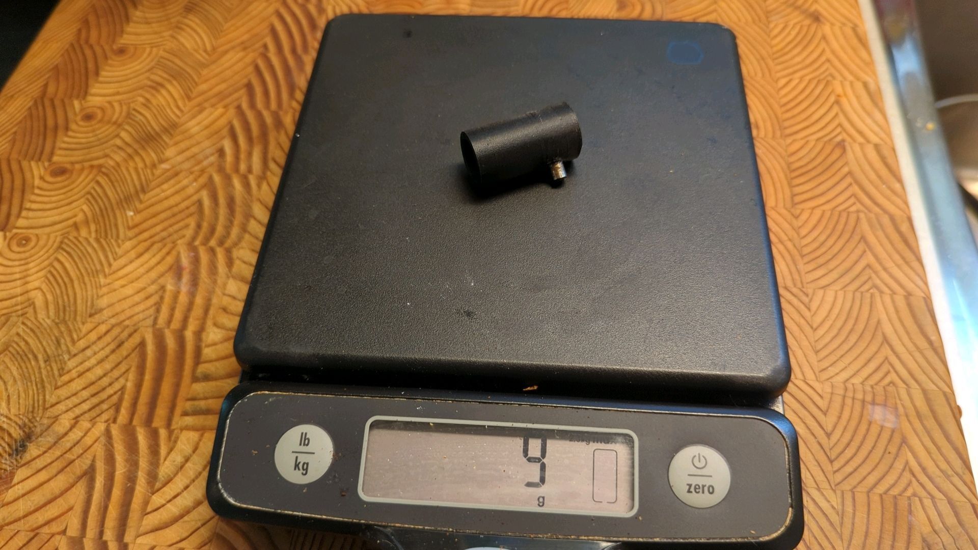

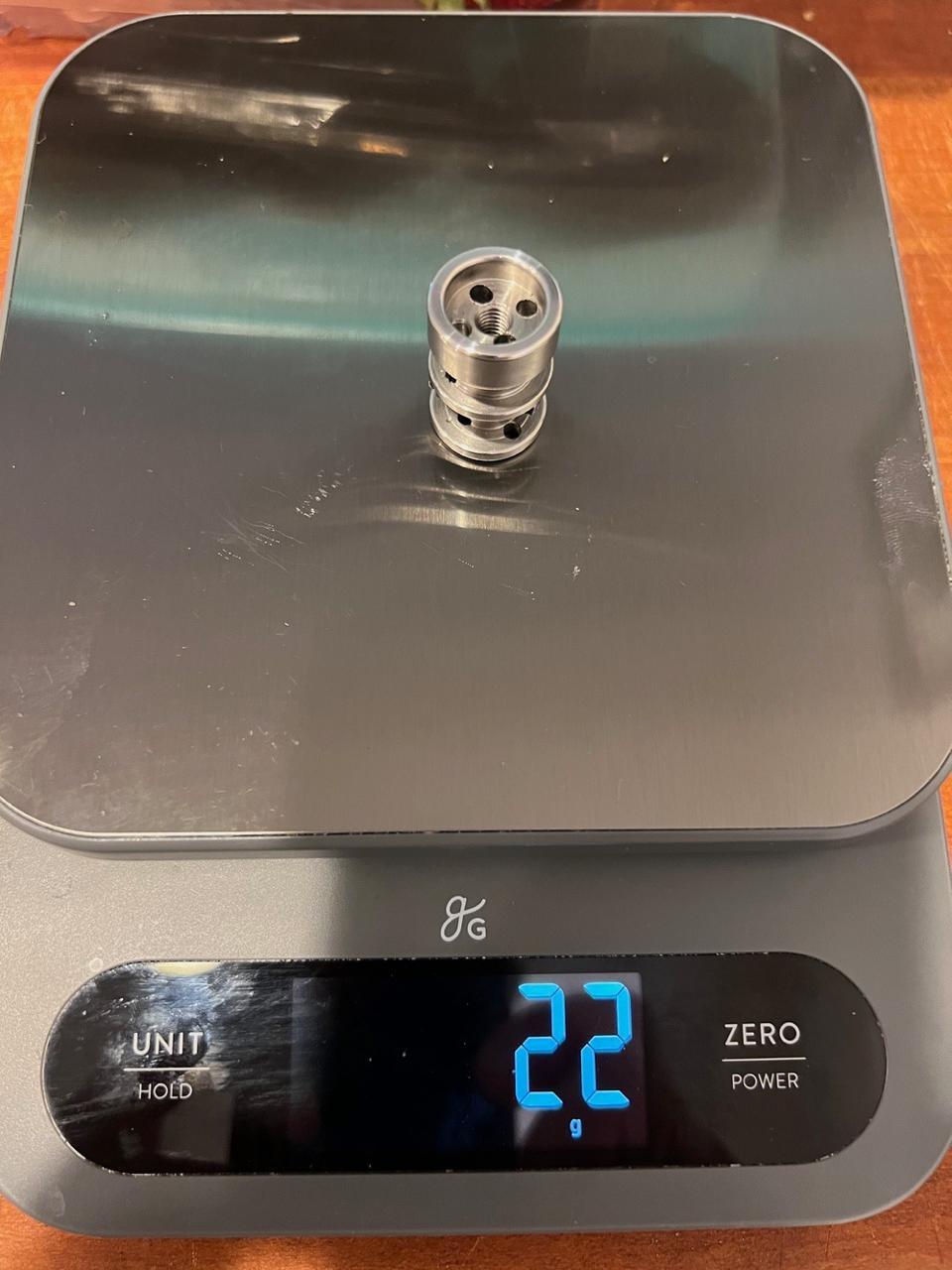

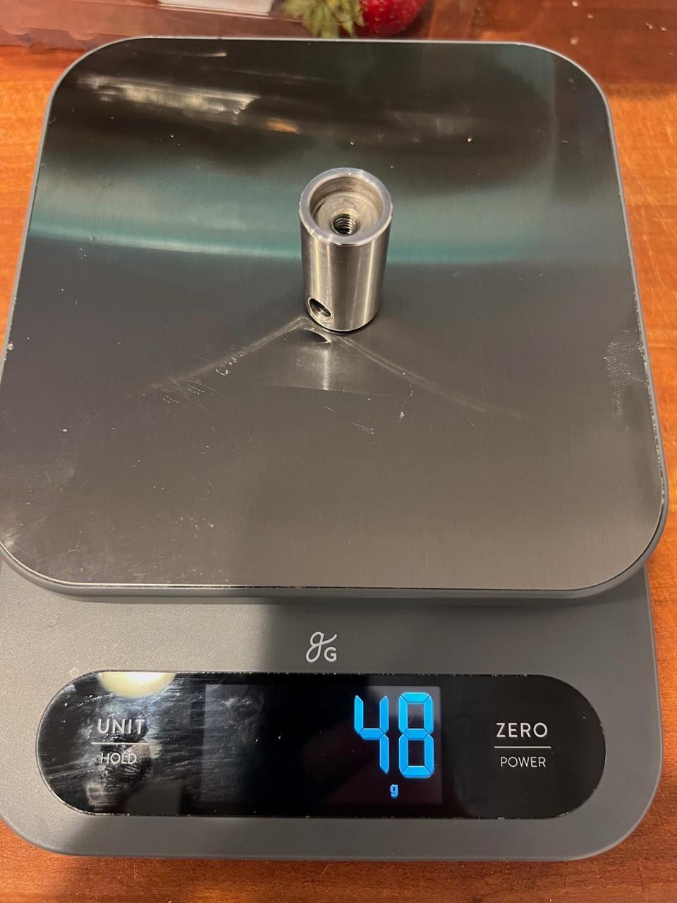

        I'm very curious about the Angry Antle Jenni Kraig hammer/spring combo, but before I go spending the money on it I wanted to get a better understanding of what's happening with the super-light hammer/spring combo.
        I 3D printed a hammer:
        These scales get a little wonky sub 15 grams, but it's safe to say it's less than 15g with the lug installed, so approximated 25-35% of the stock hammer weight.
        The gun is stock, including the barrel, with a WGP Ergo reg, a Dye Lazarus Valve, and a freedummy detent(as this is how i would likely run it at the field).
        Caveats about the testing I did:
        1. The paint is classic youtube-paintball-gun-test spec. Old, oblong, inconsistent, likely smaller than .68 cal to begin with.
        2. I ran out of air before switching back to the stock hammer so I wasn't able to test fully.
        3. The barrel change from my SM1 barrel at .689 to the stock barrel at .681 probably made the biggest difference in operating pressure:velocity.
        4. I don't know how accurate the CP gauge is.​
        Findings:
        I was able to hit 270-290(again, bad paint) at approximated 250-260 PSI. The best spring for the mix was the 2" lighter spring. This is approximately 30 psi lower than I was seeing with the Inception hammer.
        I simply could not achieve a velocity over 200 FPS below 200 PSI on the CP gauge.
        Springs tested:
        Inception Spring kit, approx 2.5" - Lightest, Second Lightest, 2nd heaviest.
        - These were pretty much set with the IVG flush. Some adjustment made, but always returned to flush.
        2" WGP style springs - 1x comparable to the second lightest Inception, one slighter stiffer stock WGP spring
        - These were also run flush, brought up to see, but the stiffer spring actually brought the velocity down when turned in??
        Shorter springs, approx 1.5-1.75". - Stiff, likely more so than the heaviest inception.
        - This one was turned in to where I could feel the spring tension against valve. When turned up this one just leaked.
        Spring changes made a negligible difference over reg pressure, and adjusting the IVG often changed nothing at all. The springing mostly help with stopping barrel leaks at lower pressure. Adjusting the IVG more than 3 turns(from the point of tension) caused barrel leaks, especially with stiffer springs.
        I have also purchased a barrel kit, and am still looking at a bolt upgrade. I will test again with more air and better paint to hopefully get a clearer answer here.
        I would love to achieve a sub 200 psi shot, but maybe that is a fruitless endeavor, and I should be thankful to have a quiet gun.

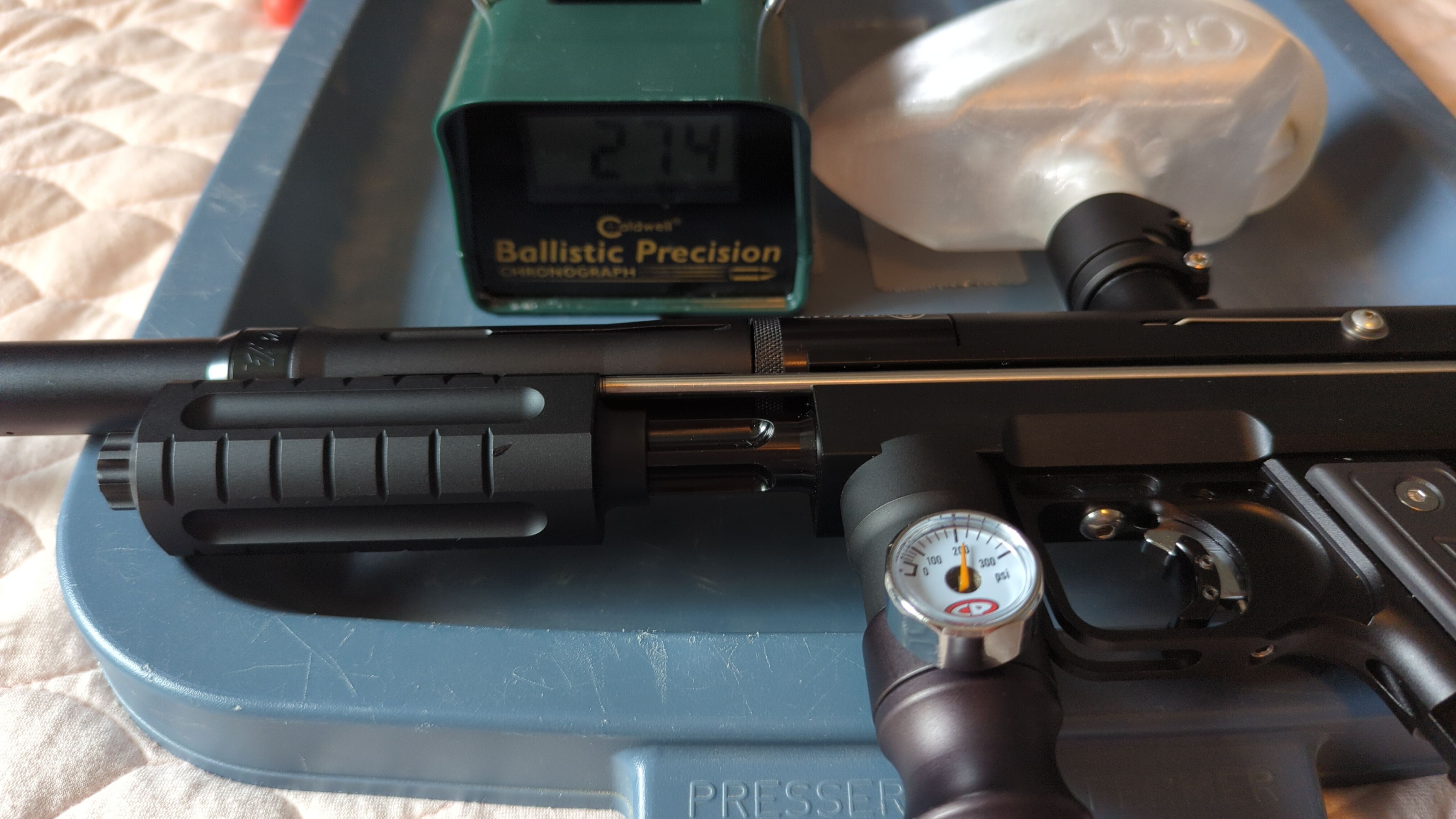

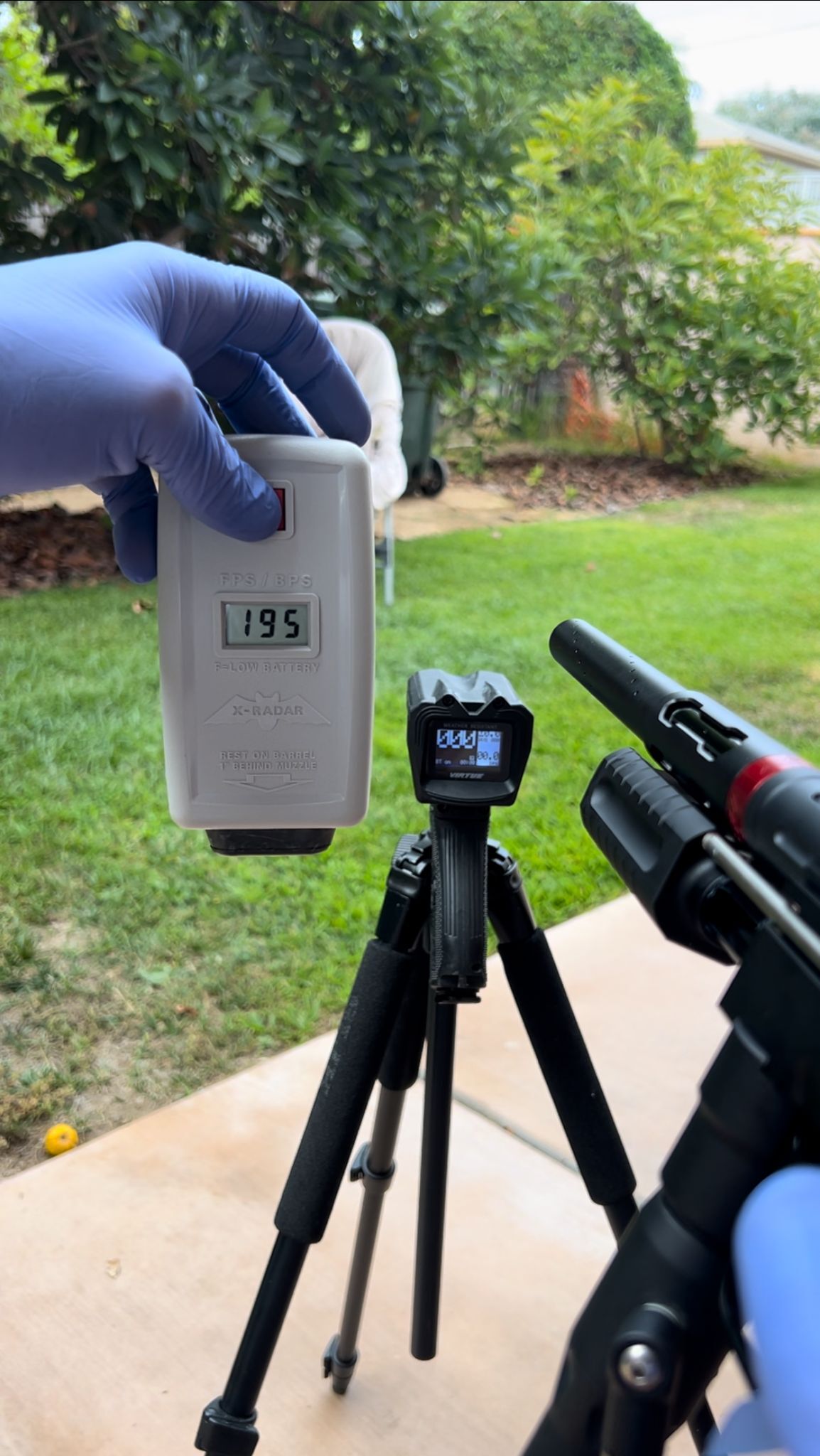

        Alright, got lucky and had a service call down the street from the local proshop so I filled my tank and continued testing today.
        A slight difference in my testing setup. I broke out the reballs, and added a TechT iFit kit with a .670 insert to accommodate reballs.
        I was able to hit 275-280ish at around 210 PSI. This is using the 10 gram 3D printed hammer and the softest Inception spring.
        I actually went as far as trying the pump kit spring, and I was hitting around 260-270 FPS in the same PSI range, but I found that increasing both the reg pressure and spring tension with the IVG resulted in the velocity dropping.
        The light hammer is very interesting, and I feel like once I get a bolt upgrade I will be able to settle in right around 200 PSI. I sent an email to AngryAntle to see about getting one of his hammers shipped up here.
