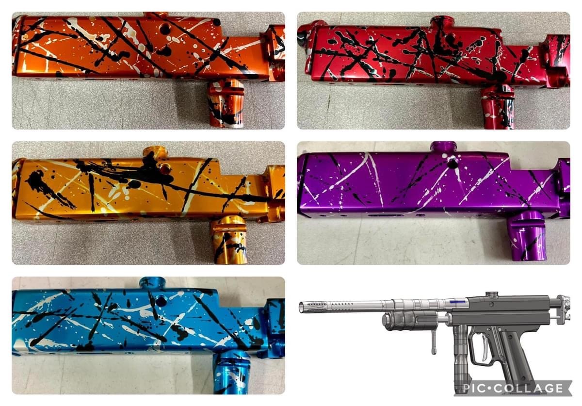

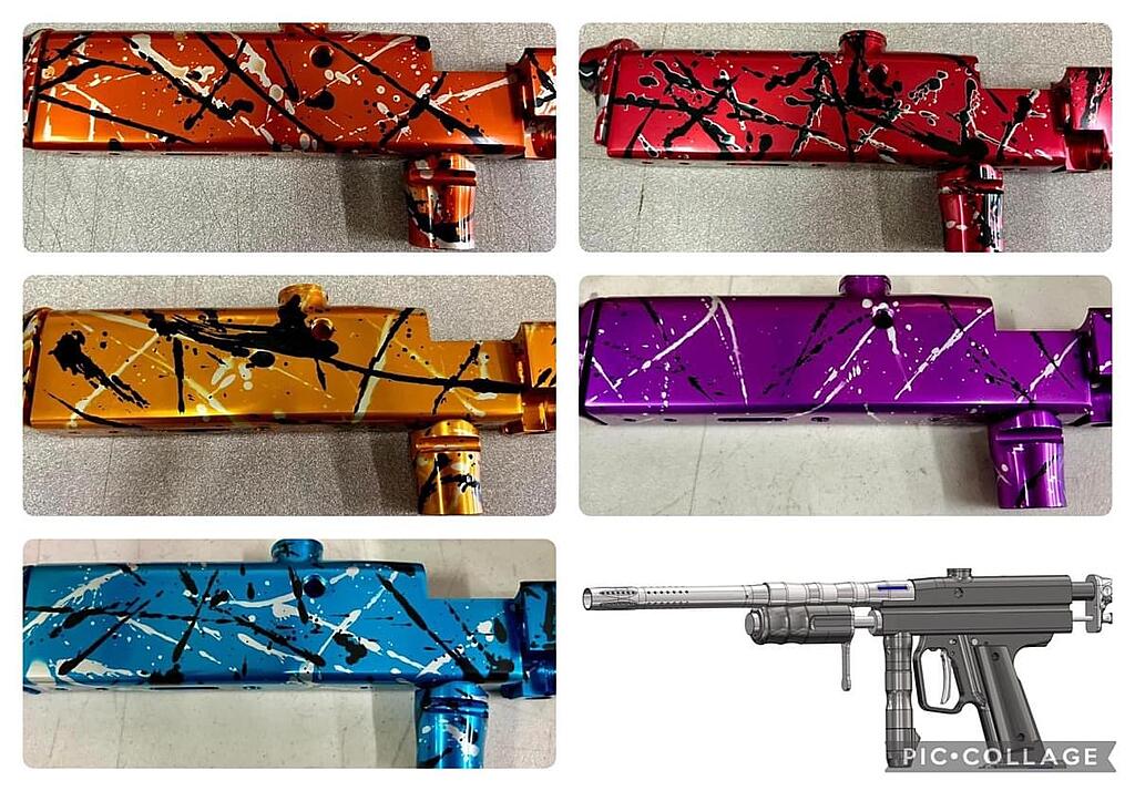

    More photos of bodies taken from bookface:
    Some nice old-school style anno!
    • Apaches
      Apaches commented
      Even more coming.
    • Psycho91
      Psycho91 commented
      Some of these look so sloppy though, like whats with the big splotches in places on some
      iamthelazerviking commented
      I've noticed that too, splotchy ano.

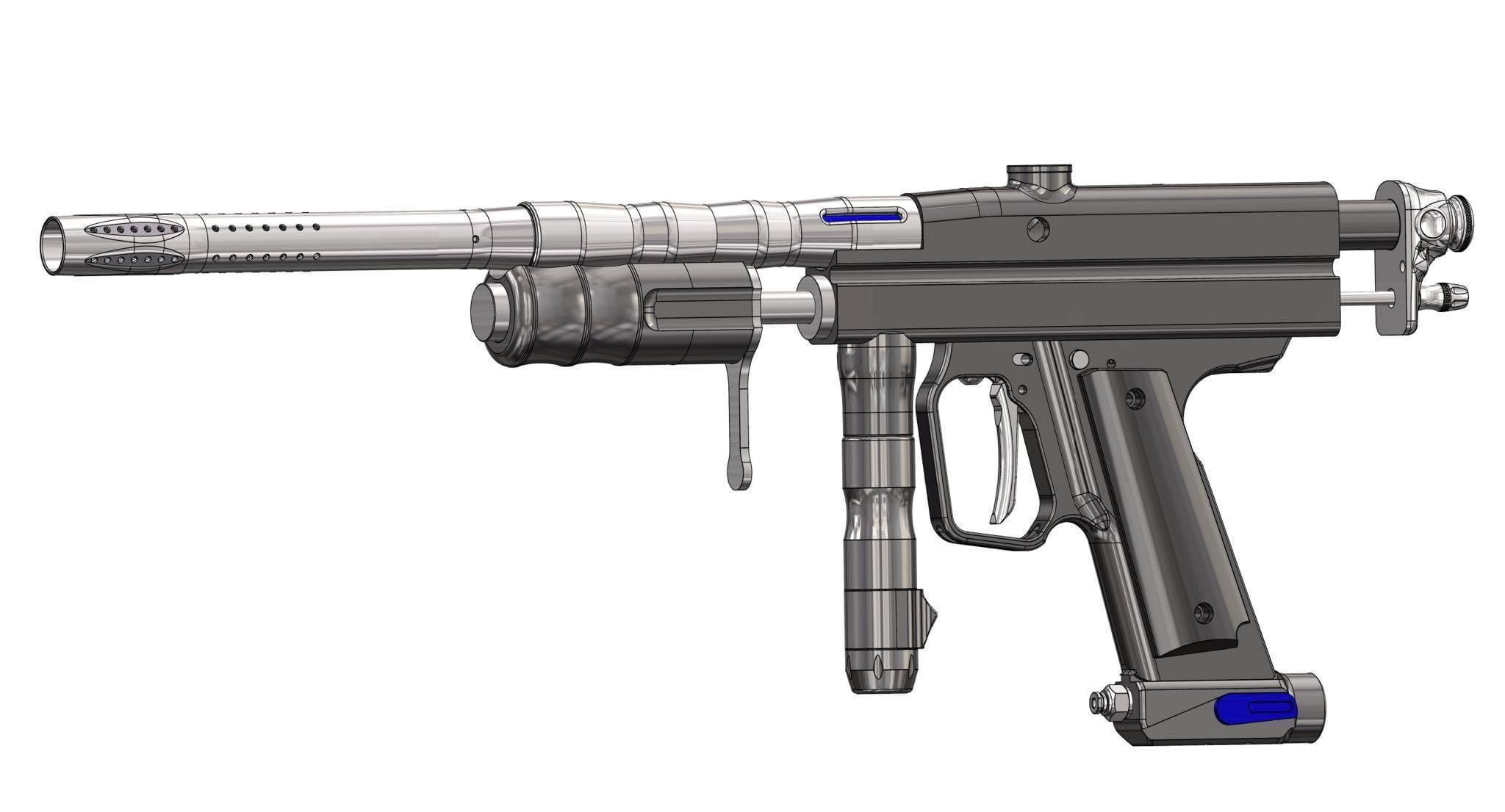

        Frame looks like a grotesque combo of WGP and System X hinges.
        scottieb commented
        Hobbes nailed it.

      I wish they would hand it to someone that plays pump and say what do you want out of this. Then dial it back for costs if they had too.I see a handleful of things i would recommend changing already.
      feedneck should be grooved so it doesn't slide down.
      pump handle doesn't have an anti twist.
      get rid of the hitman plate
      single trigger frame.
      no reason to have the barrel wings
      Auto trigger required.
      back block looks like it doesn't belong.
      If that is a knob on the front, i would much rather have a handle that does not have a rod through it than be able to adjust my tension like the meteor pump kits.

      I agree with what others have said. The double trigger is royally uncool and the lack of autotrigger is very unlikely to ever be fixed by the owner so it should be built in from the factory.
      This pretty much IS a DIY sniper with those two issues. Include a non-freaked barrel with no detent system and your eBay parts crawl pump is done. Pump fast and eff something up or pump slow and watch your paint roll out. There’s a lot to compare to the Merlin. They are brand new guns with 30 year old design issues left in for…nostalgia?

          The only reason a "new" Cocker based pump has any "classic" features is to feed off nostalgia, so to bitch about people wanting a single trigger frame doesn't make sense to me. Otherwise, why bother with a backblock and full-size body?
          • russc
            • 407
            I'm really glad to see Nova jumping in and serving this niche market, but I hope they listen to the feedback they are getting. The early concept looks like a parts bin gun. When Meteor is selling their pump for $400, they've got a tough act to follow.

              That was my exact thought. This literally looks like a parts bin cocker, and not one that I would be particularly fond of. The body just looks like a standard slab and the back block doesn't follow the same concepts. The frame looks like ones that I consider the absolute least desirable in a System X swing. And I'm not in love with that pump kit on the front either. I wish anyone working on cockers the best, and hope it does well for them---but this isn't for me.

            looks like a systemX hinge. very much needs a single trigger. an auto trigger cam would make it much more desirable as a shooter.
            Some other sloppy bits like why the front end and the pump guide aren't both round?
            P block would be better.

              This thing looks like a VERY rough/early design. Lots of things to tweak and add/subtract.

              OK guys if anyone has any questions please feel free to give me a call (864)915-9421 and I will answer them for you but we do have a lot happening atm. Our Pump/Semi will go live tomorrow, a lot of people have thought we were out of stock already but what they have seen on our site are just place holders. We did release a few models at ION and again at Michigan Monster Game mainly for test purposes. We would have already released to the public but mainly my fault we haven't. I wanted to really test a lot more till I was satisfied with the results that I was seeing back. As far our cocker pump goes yes we are going to release with our new hinge frame but we will be doing a slider frame I'm sure in the near future. We are currently going with this decision in order to offer a combo kit in the very near future that includes both our new Auto-cocker semi and the front for our Sniper style pump to keep the cost down for the end user. There are a lot of options that are included with our new marker that the drawing just doesn't show.

              I don’t think I’m speaking for just myself when I say that there is no point in making a sniper that isn’t as good as the Empire Sniper was the last time they manufactured some and it was pretty good. Ugly, but good. “Good” includes autotrigger that works reliably. It also has to have a single trigger. It’s not a pressure washer it’s a gun. Slider or swing, that part is very much secondary, I personally do not care, it has to be single though. Even a PGP frame is better than the 90s caulk gun/strength tester style. Also, go “quad rod”, seriously. If making an all new gun there’s no reason not to. The quality of the pump stroke is what sells a pump. If it twists it’s not so great.
              I LOVE that it’s full block and the ano is so cool. I’m very excited for this.
