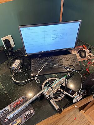

    Did some AKA high rate of fire testing.
    • Cunha
      Cunha commented
      Sweet! If people give you regs will you do a recharge rate / consistency chart and interpret the results for us bone heads too?
      It's been a while. I want to be able to "ackshully" and tell people how superior vikings are to other guns :P
    • Roger7pball
      Roger7pball commented
      Haha
      I have a bunch of different regs and will do a compare test at some point soon.

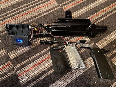

        So, I found Armory paintball had a Shocker body, and I had plenty of extra parts so, why not build a new gun? I want this one to be kinda woodsbally once I am done with it but, it is still in parts:
        And your eyes don't deceive you this thing really is going to be a backbottle shocker:
        I had to spend alot of time filing that ASA so that the Angel frame would fit right up against it lol. So it is going to be a 2000+ Body Shocker with an Angel IR3 grip frame (which I kinda prefer to me Angel A4 frame I have on my other shocker), a Smart Parts LS Turbo board, with switch relocation hooked to a La Cruzet 85g roller switch. I am going to mount the maxflow on the right side of the ASA and that big high pressure gauge on the left side. I took some Delrin round stock, drilled a hole at a slight angle and tapped it, so it will have an almost 15* front grip which I wrapped in grip tape and it works surpsingly well. I also think I may try and use my Evil Shocker "The Part" to replace the poppet valve. Until I can buy a vertical feed shocker this one is gonna be my project. My other right feed one will be the gun I actually play with lol
        Edit: I spent all night messing with it, but now all it needs is the leads connected to an on/off switch, that is the wire hanging out the back, I just didn't have a switch that would fit on hand. I decided the maxflo can sit on my remote instead.

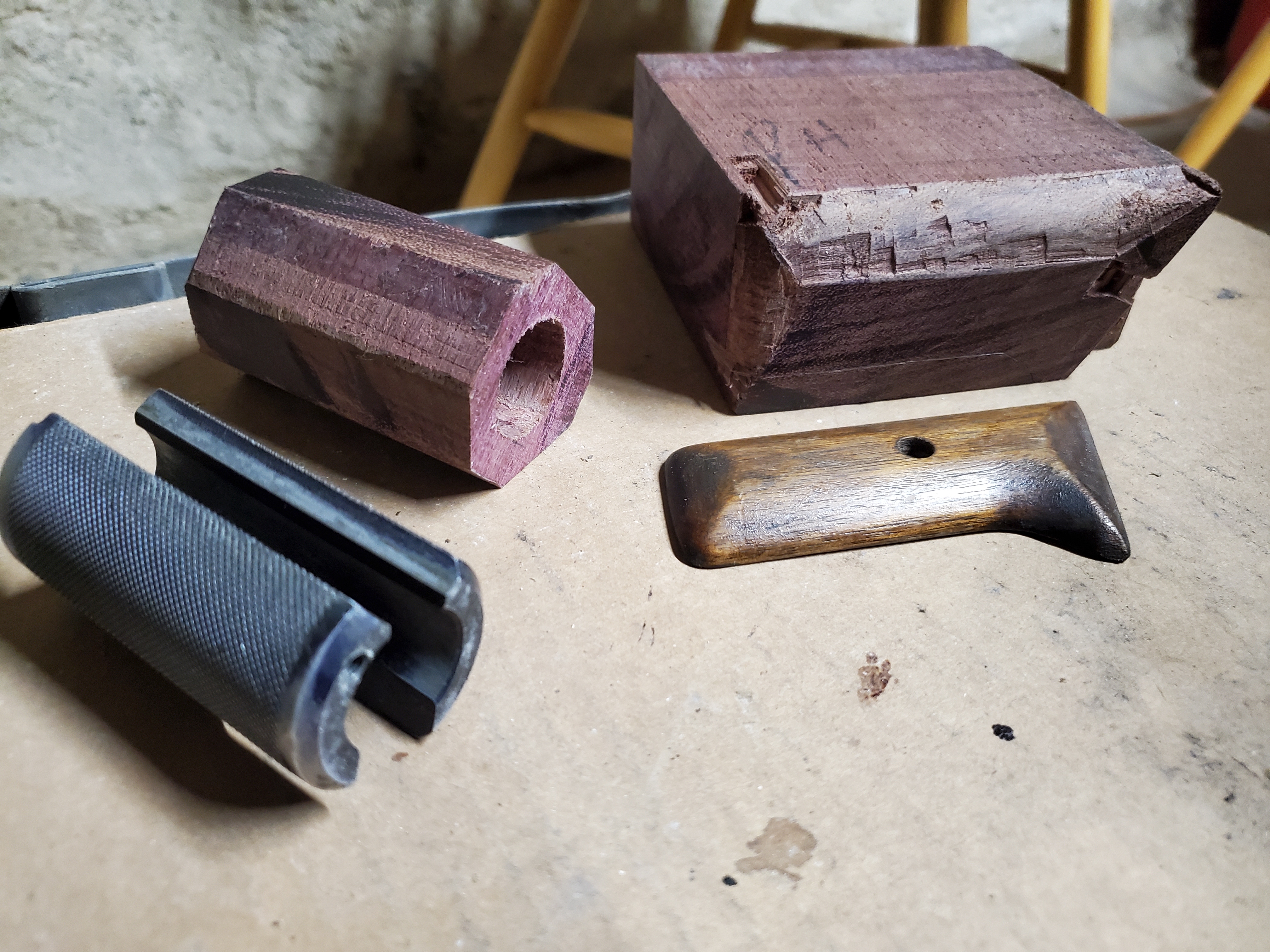

            Learning to carve. I probably picked the worst wood to start with, but I always enjoy a challenge. Currently carving some PGP grips and pump handle...

                I like your hard wood you are sporting, what type is it. Like to see more of your wood, especially once you are done polishing your knob.

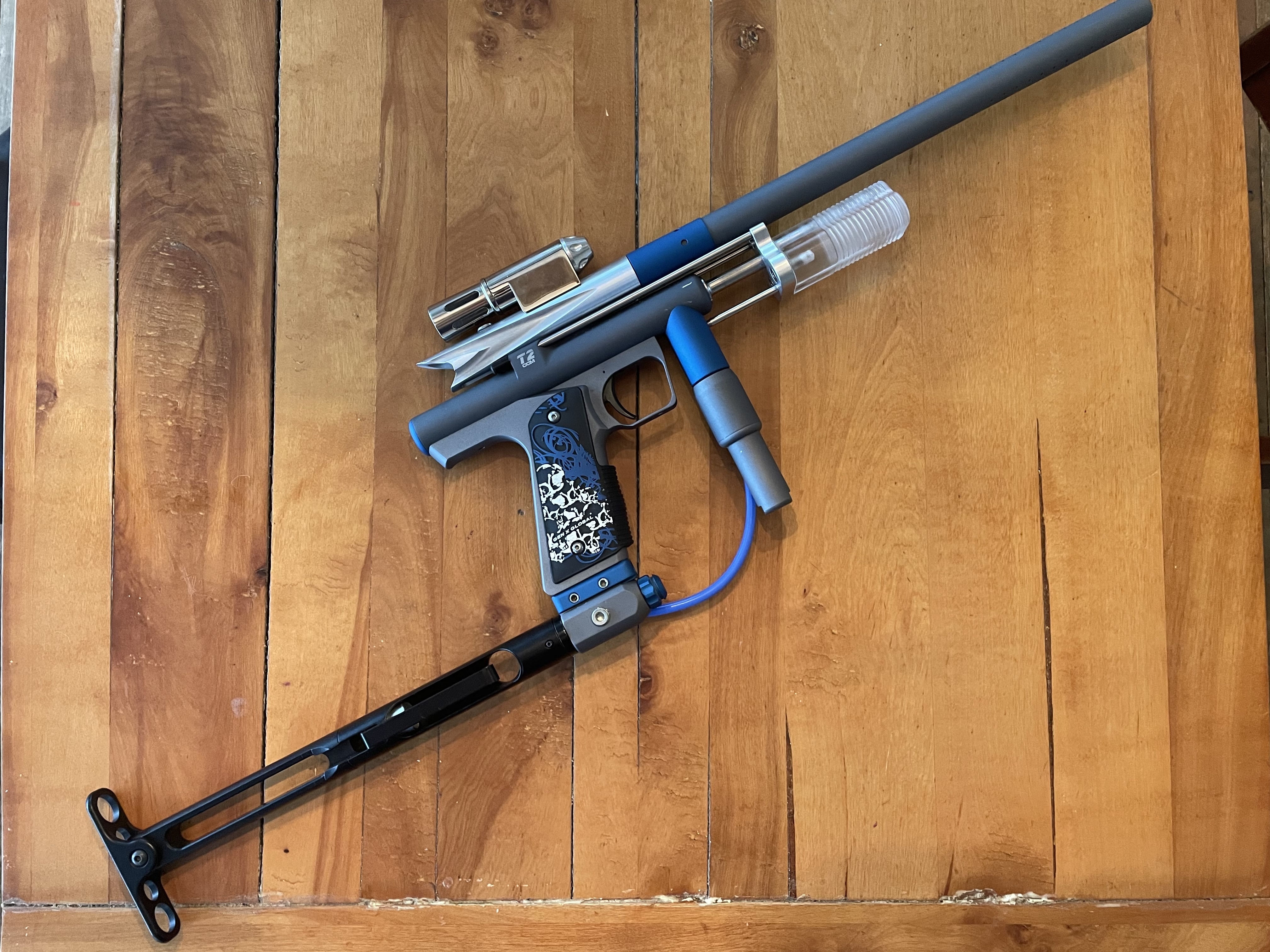

                Not really a project…more of a modification, but I’m counting it. I’ve had the parts and the general idea for a while. I just needed the “donor” marker…
                Going to keep the Cobalt/Flat Grey color scheme. Just need to test and get it out for Cerakoting (I probably won’t re-ano on this one)
                edit: as much as I love it. I’m NOT going to keep the cobalt/grey….I have something special planned for this. More parts headed my way (I just need my other T2 back first so I have a marker to play with while this one gets its makeover)

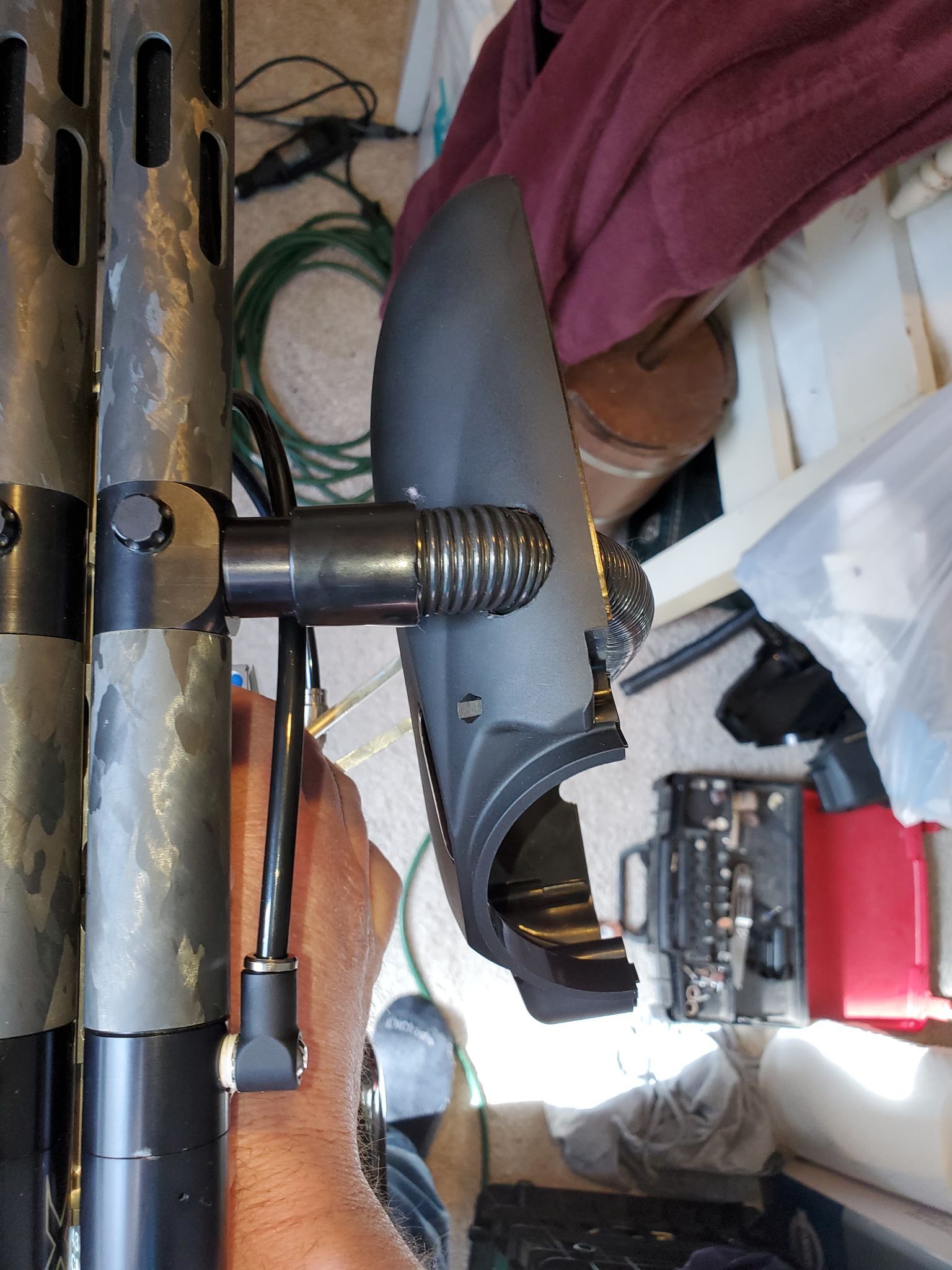

                  My current HELL. Making Loaders do things they were never designed to do. In this case feed upwards.
                  I will be completed once the epoxy dries completely. Which is tomorrow. Then have to do it all over again.

                    I have pondered if you could make a dye rotor feed upwards with two printed bits.
                  • cougar20th
                    cougar20th commented
                    I initially tried dye rotors using box rotor parts. It did not work. It wouldn't feed the stack high enough. So I now use those on my normal guns and am converting a set or reloader b's
