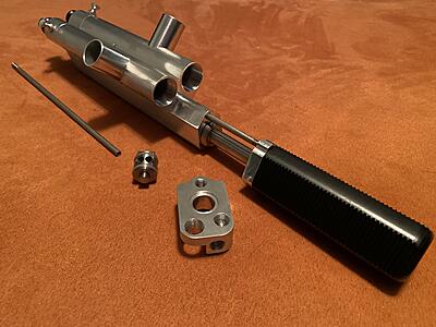

    Example of what I was thinking. If it’s going to be more time consuming just let me know what owe yah. Thanks Doc.
    -I can sure do that, or at least something close to it. Lemme buzz something up and see what'cha think.
    Doc.
    Paintball in the Movies!
      I imagine the top profile will need to be more flat with the double barrel setup. But I like the beveled edges especially at the front and the U shape. If you can texture it a bit like CCM dose I really like that profile and feel.
  • DocsMachine
    • 2811
    #167
    Would this work for you?
    -Only the two "grip pads" are textured, but I have no trouble with it slipping, even with those slightly-oily black-nitrile shop gloves.
    It's not precisely the same as the CCM, but then, I don't have CCM's CNCs.
    Doc.

          An interesting little update.
          I'd originally set out to make eight of these, including the four "blank" bodies I'd had from several years ago. I thought I'd sold seven, and could keep the eighth for myself, but I screwed up- what else is new? - and managed to sell all eight.
          I of course want one for myself, and have at least two high-probables for the next batch, so several weeks ago, I bought more material.
          I was not, however, looking forward to the rather considerable amount of time and labor to rough these down into "blanks". Over the weekend, I had a bit of a brainstorm- one of those "no duh!" type moments, and after I got everything off into the mail today, I figured I'd take a moment and give it a try.
          Basically, pick a thin slitting saw out of my collection, dig out an arbor that would clear the top of the vise, and saw "pie wedges" out of the block:
          Took maybe about 30 minutes, but the old way with the 90-degree endmill probably took two hours, maybe closer to three. And, those two bars would have ended up as loose chips, so there's also the saved time having a lot less to sweep and vacuum up.
          Not a huge time savings in the course of doing the overall body, but still certainly worthwhile.
