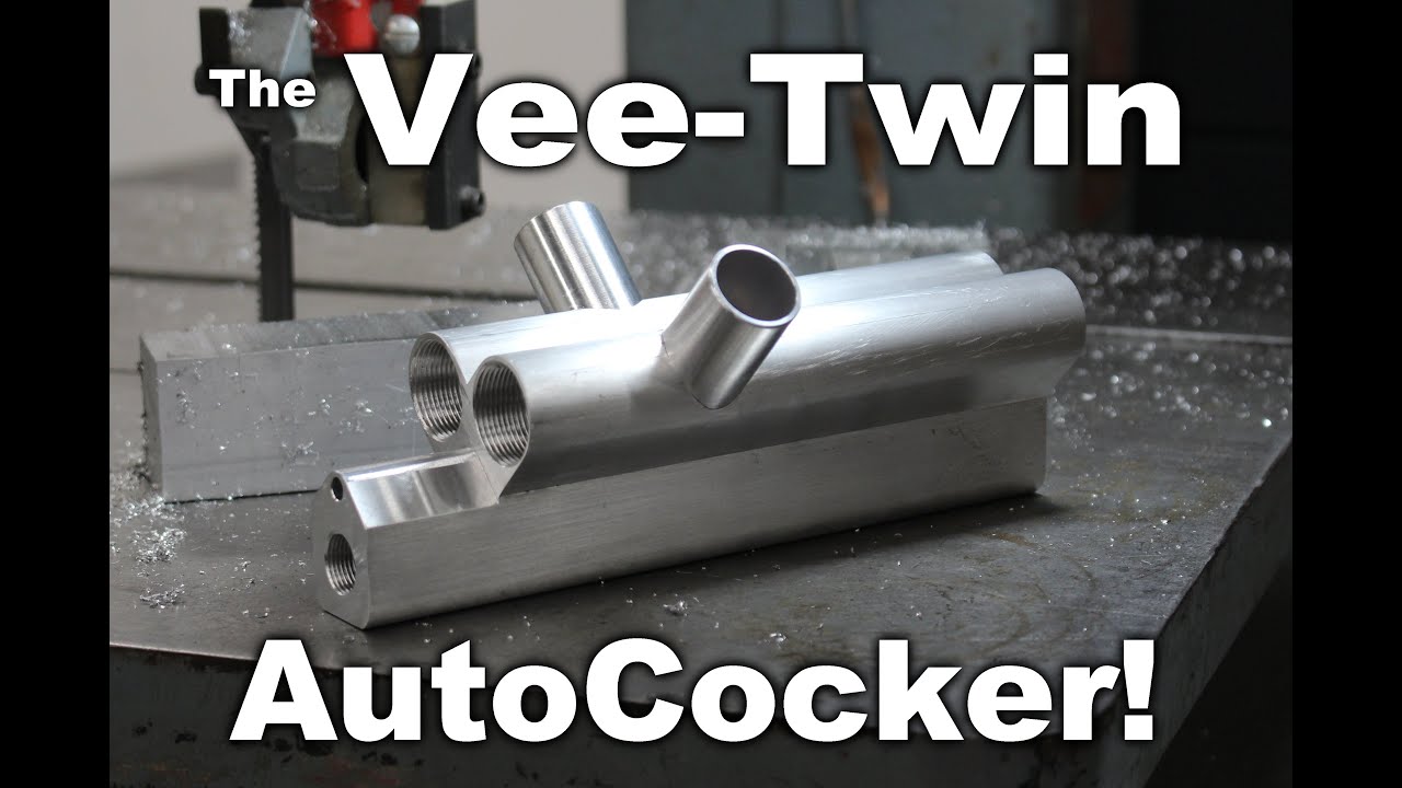

            And we're back!
            I had a ton of must-do work that... well, I had to do, and all of it took me longer than expected. (Which, of course, it always does. You'd think that at some point I'd learn. )
            But, all the immediate fires have been put out, the cat's been fed and I told my secretary to hold all my calls, so it's time to get back to these badboys!
            Starting off, there was this little weehaw on the 'nose' of the body, where I couldn't reach with the corner-rounding endmill.
            Easy enough to take care of- I'm no Clickspring, but I know my way around a file.
            And here's a trick for a situation like this: I want to take the bit at the 'peak' off, but NOT scar up the barrel faces, so you use a "safe edge" file like so:
            I know it's kind of hard to see, but basically I just hit the narrow faces of the file with the belt grinder, 'til the teeth were basically gone. That way, it can't cut on that face, and you get a nice, sharp corner where the two faces meet.
            A few careful minutes on each one and the form is now perfect. A touch of sandpaper when it comes time to finish each body, and it'll be smooth as glass.
            Now, here's one of the tricky bits some of you fellers were asking about. Back when I've made individual bodies, I've just used a cheap angle vise, but in this case, I wanted something faster and more repeatable. So I took a few minutes to make some quick and dirty angled vise jaws:
            Those hold the body just like this, securely and repeatably, at the exact angle necessary to drill the gas ports up from the valve.
            Like so:
            After finding the center of the bore, and the proper spacing, the hole is drilled through from the top, unlike a typical 'Cocker.
            The upper part of the new hole is then tapped in the same setup.
            And looking up from the normal valve retaining screw hole underneath, you can see they juuuust about meet at the top of the valve.
            Do all that approximately sixty more times, and we're partway there!
            Now, the trick: I turn an aluminum plug, with dead-ended threads, like so:
            That gets a liberal dose of red LocTite (one of the very few times you should use red anywhere near a paintball gun) and then screwed hard into the threaded hole.
            After that's had a chance to cure slightly, and the stub is sawed off (that's what the groove is for, to make that easier and quicker) I use the same mill vise setup to very closely shave off the bulk of the plug.
            And then, back to the file vise, a couple careful strokes with a fine file, and the unnecessary part of the hole is basically gone!
            I just have to finish up the rest of the holes, and all of a sudden it'll be time for feed necks!
            As always, Stand By! More coming soon!

                  Not much to show today, apart from getting the holes plugged.
                  I'd hope to get some or all of them filed down, too, but I just didn't have time.
                  It does kind of frustrate me, though: Making these plugs was rather time consuming, and I should be able to do this sort of thing on my shiny new CNCs. Well, actually, I can, this would have been a fairly simple part to code, but in this case, I'm still nowhere near good enough- or fast enough- that it'd actually save time making just sixteen plugs.
                  If I was making 200 or more, you bet your boots I'd take the time to set the CNC up for it. (Although at this point, I'd still need a spindle liner, bar-puller and parting tool to do it right.)
                  Anyway, with a little luck... Feed necks by Friday!

                      Got all (but one) bodies successfully filed and smoothed down today:
                      And now it's time to start segregating the individual bodies, as the overall build and milling will start to vary per customer. These four will be "standard" builds, with normal backblocks and whatnot.
                      I wanted to start installing feed necks today, but as per a conversation over on The Guild, this is, really, a good opportunity to practice a little short-run CNC stuff. As such, I spent the day making another tool for my CNC, so that I can make a batch of them accurately and consistently.
                      I should be able to get that coded up and run on Friday, maybe have the first few installed by Friday afternoon.
                      Get'cher checkbooks ready; with a little luck, I think I might be able to start shipping some of these out next week!

                      Boy, did I need practice. A feed neck tube is absurdly simple, and for whatever reason, this thing took me way to long to program.
                      After all too many iterations, at way too late in the evening, I finally got my first successful part....
                      Which was spot-on dimensionally, even though the code is ugly and about six times longer than it should be, and all my feeds and speeds are seat-of-the-pants.
                      Made my batch plus a few extra, in case I either screw one up or maybe make more VT's in the future.
                      Now it was time to slap one together. Well... 'slap' isn't really the right word, as I'd forgotten one of the big steps. Ideally, one should sand and smooth the body before installing the feed necks. That way it's easier and straighter to sand without the neck in the way.
                      This part is always tedious, and typically takes up a couple sheets of sandpaper- or most of them, anyway. I tend to "wet sand", which helps eliminate the dust issue, and makes the paper last longer- it doesn't load up as fast. (You need "wet or dry" paper, though- and guess what? The purple stuff... isn't. )
                      After approximately fourteen hours and three elbow transplants, I had it at least acceptably smooth. It'll still need some work before polishing, but the heavy sanding to get rid of the tool marks, is done.
                      Then, back to the mill to bore the opening for the new necks...
                      And then a ride through the forty-ton press to mash the neck into place. (Obviously, along with a dash of red Loctite.)
                      That's an .0025" interference fit, she's not comin' out of there.
                      And there she is! I promised feednecks by Friday, and by my clock I still have 30 minutes.
                      Big update on Monday!

                        As usual, hoped to have a little more done this weekend than I managed, but hey, I've always been an optimist.
                        Got the other three of the first four bodies bored and the feed necks pressed in:
                        Then rebored and rereamed to of course remove the parts of both the plugs and the feed necks that protrude into the bolt bore.
                        And, of course I utterly forgot a trick I'd come up with the last time I made one of these, and meant to use on the next one: On these, I drilled and reamed to final bore size before the plug or feed neck were installed. What I should have done is bored to just undersize- the step before reaming- and then left it there 'til it was time to do the plugs and feed necks.
                        After those were in place, then final ream to size. Would have saved a few steps, and on this batch, probably three or four hours, total.
                        Anyway, Et voilá!
                        ... Huh. I should make a sticker out of that.
                        Now, a confession: I, the Mighty Doc... made a mistake. My brain slipped out of gear momentarily and I almost mis-bored one feed neck:
                        I caught it in time, but it left a slight error that is not easily correctible.It does not affect the operation of the marker in any way, nor does it compromise the strength of the feed neck. It's purely cosmetic, and not very obvious.
                        However, I also can't easily fix it, I'd rather not start over, nor do I have a spare to swap over to. I am making one of these for myself, but that's the "mini" body I already had- no one wanted a mini, so I figured I'd just make it for myself.
                        If one of you gents, that are getting a standard full-sized body with back-block, can live with such an obvious and egregious error, I'll take $100 off your bill, OR, your choice, optionally offer $100 (or more) in additional work, such as a full polish job (which would usually be closer to $200) or additional cosmetic body milling.
                        Let me know at doc (at) docsmachine.com and I'll update your order as needed.
                        Anyway- as I said, I didn't have as much time as I wanted this weekend (who does? ) but one other thing I did take a moment to do was chop up some bar to start the front blocks...
                        And chopped, faced and centerdrilled enough Delrin rod to make bolts for these first four.
                        More to come!
