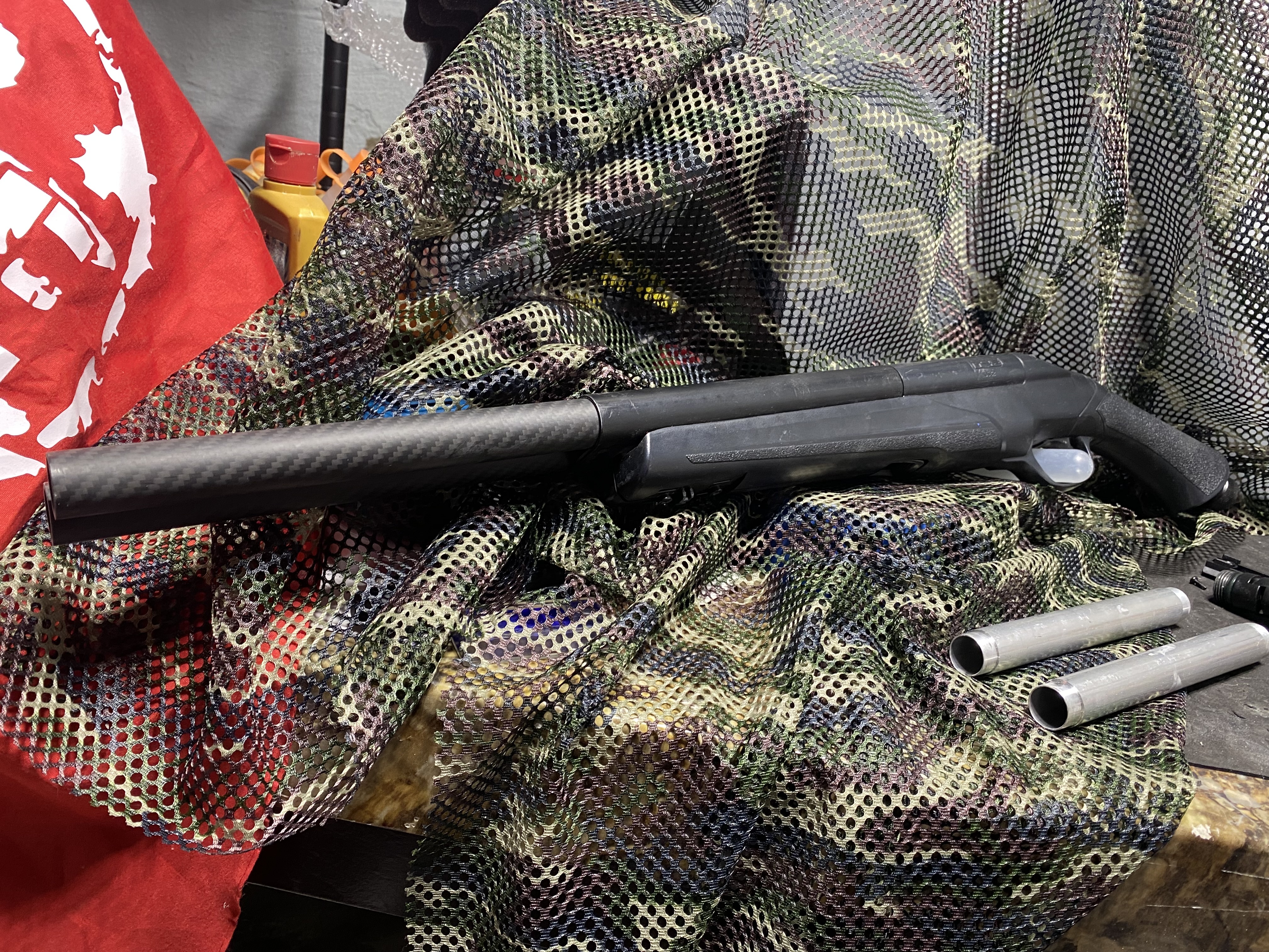

                    The Shotgun works good. Drill the restrictor pull the stock barrels slide in standard freak inserts in there place capture them in some Brass or CF tubing. I built this for Creepers Budget Build off. I’m getting double barrel shots 2 paintballs at like 280ish. I just traded for a Palmers 105* ASA adapter so I can run an HPA tank off the back and I got a NiceButt stock I’m going to put on it for the full size stocked shot gun look.

                      Full coach gun build would be fun. I drilled my restrictor but I don't feel like putting much more effort into it. Cool build buddy

                      I'm intrigued by what one of these would handle like with the Palmer's tank adapter. Having any kind of a stock would definitely cut down on fatigue when holding these things towards the target. However, I'm curious whether the switch the HPA would drop the velocity, since out of the box they're designed to run on liquid CO2.
                      I got an extra reg I'm going to shim up I figure about 850psi should do it. I got one set for my Phantom already so I’m going to try that first see how she shoots. I haven’t really
                      found anything I can’t get to shoot on HPA it’s just a matter of finding the right pressure. It handles C02 so it should handle Higher HPA just fine. It will have a substantial dump chamber of air behind it to due to the adapter and filling the 12g’s location.
