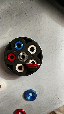

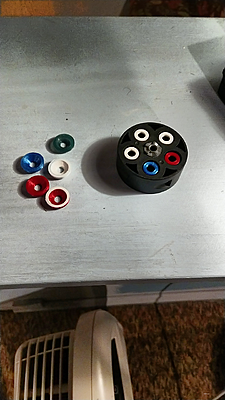

    I forgot all about this project. Probably about a year ago i made these spacers that go in the cylinder to eliminate alot of the "rollback" that these guns have. These inserts fly out with the ball but either tumble a few feet or spin off to the side. I didn't record any sort of testing but it did seem to reduce breaks at ~270 fps

      I've used it at 3 so far but I could see some fields not allowing it.
      Chuck E Ducky
      commented
      Could you Epoxy it in?
    • TKcustoms
      TKcustoms
      commented
      Maybe I don't understand but Wouldn't the bolt smash into the epoxied face and either destroy the cylinder or not fully cycle?

    That's kind of what I'm envisioning, but with these discs permanently glued into the cylinder wells to act as spacers and protect the ball from the bolt. The real question is how far into the cylinder does the bolt intrude, because if it's so far that there's not space for a ball to escape crushing, this isn't going to work.
