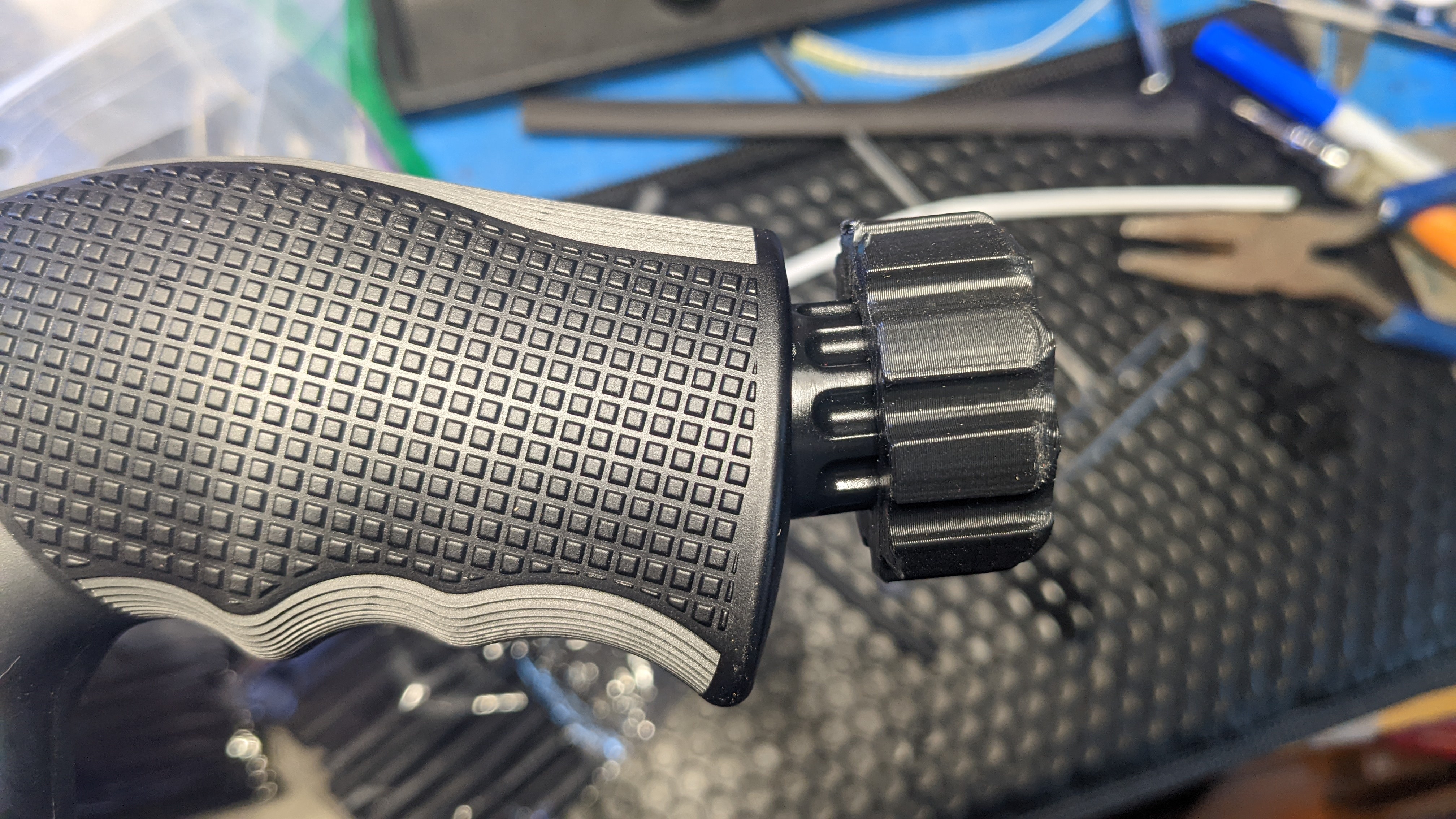

        I am just going to leave this here as a preview of what I am trying to get a bit more control over velocity and maybe efficiency etc.
        I have a in grip regulator for adjustment, I have a handful of springs I will be trying as well to see if I can reduce pressure and spring tension to get a bit deeper in a 12 gram for more shots, and reduce the force on the ball to help with breaks.
