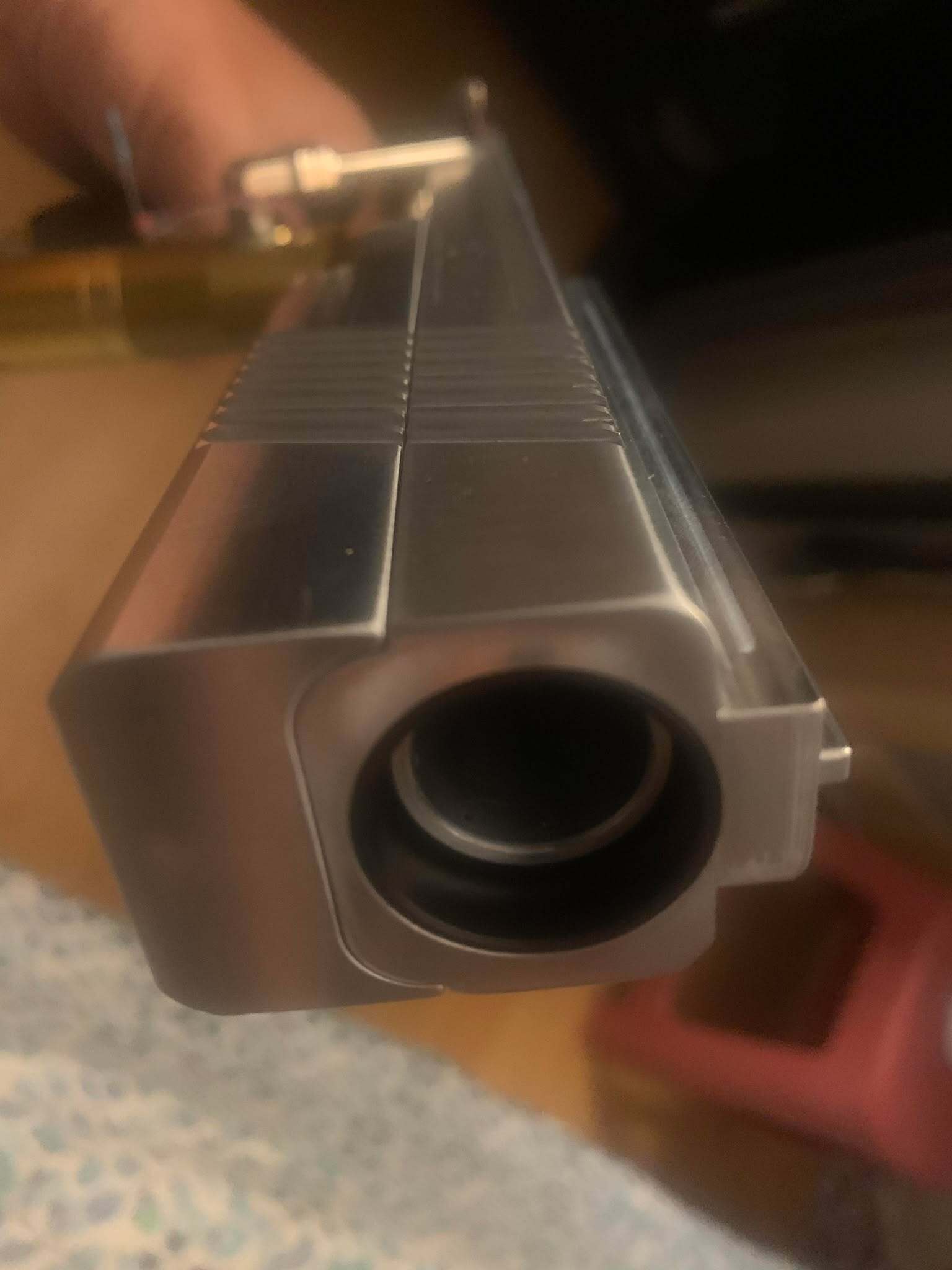

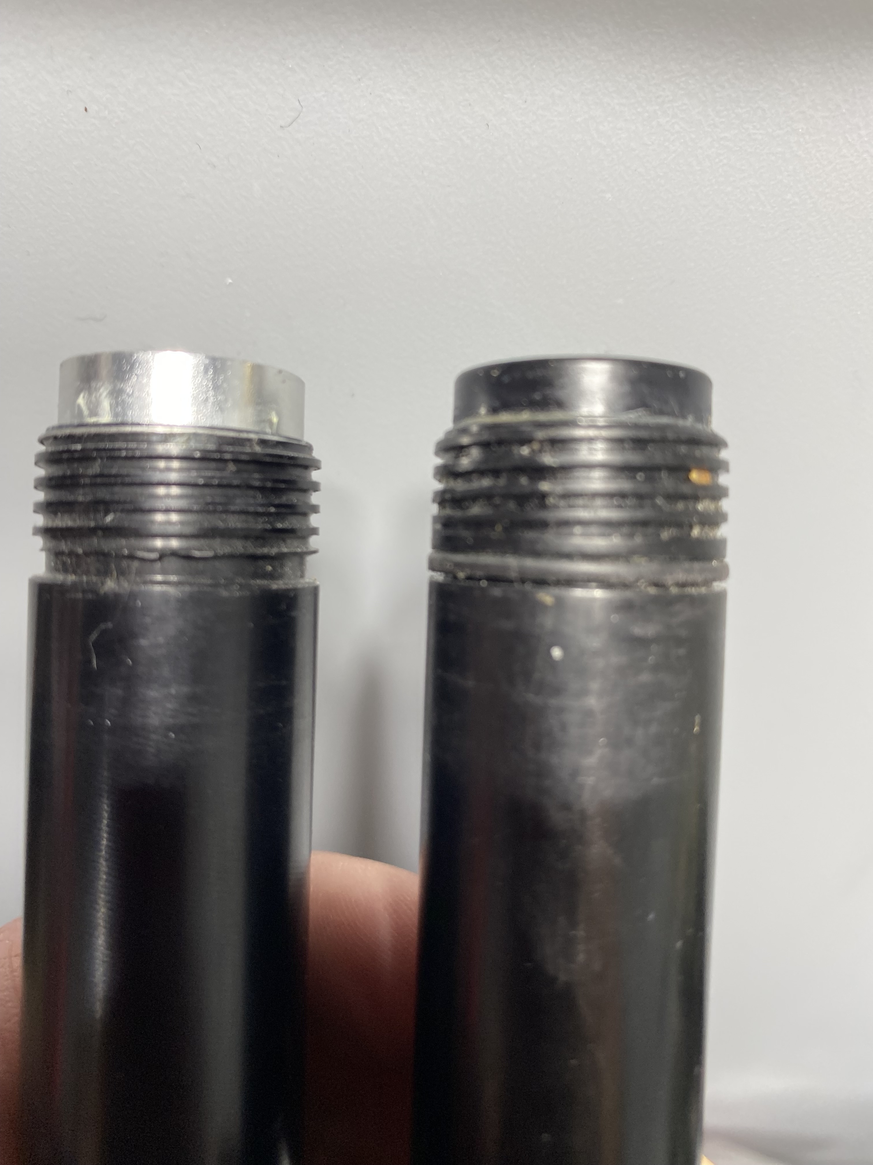

    (Top is Nova, bottom is Freak / standard fixed bore CCI)
    • binson
      binson commented
      That's what I needed to hear because I tried threading the barrel into 2 of my phantom bodies and it was a rough fit. I have to check my phantom thread adapter for deadlywinds

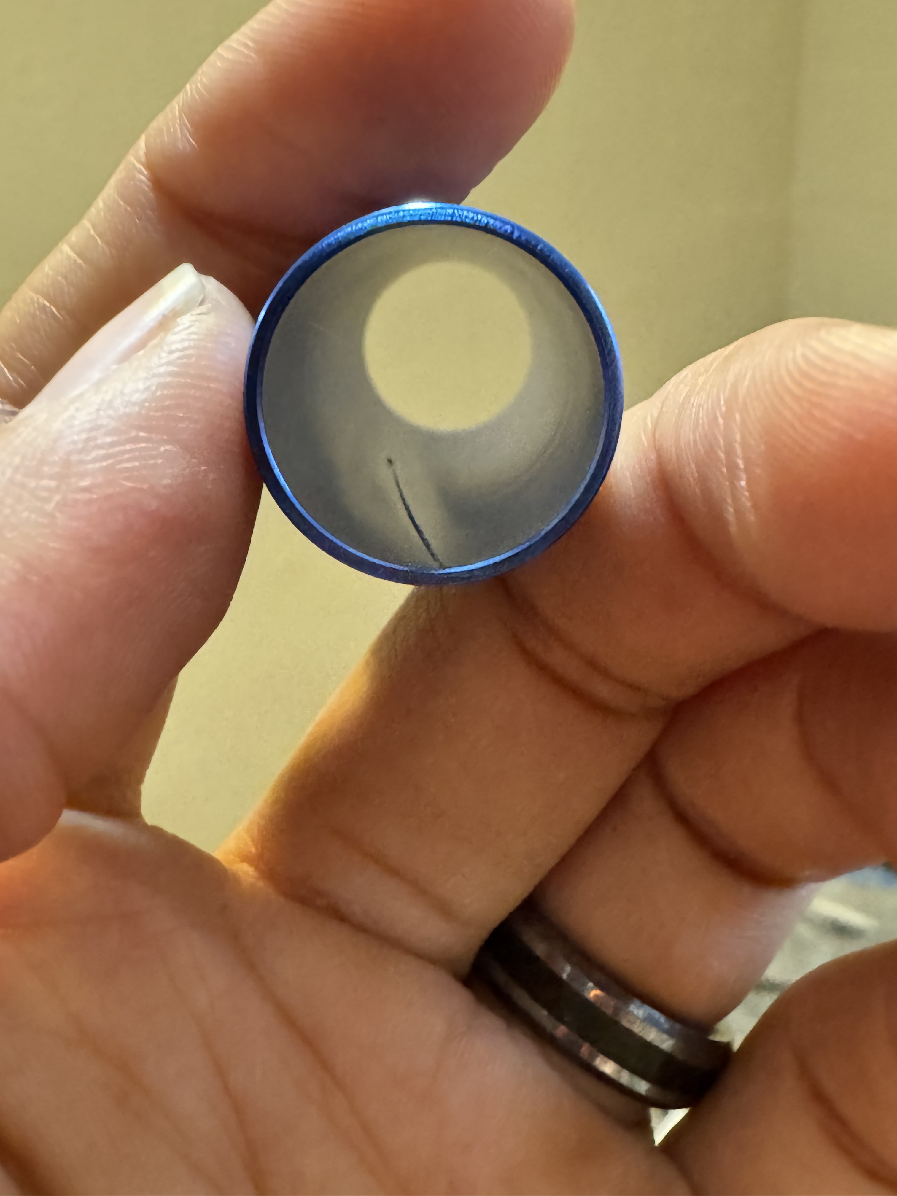

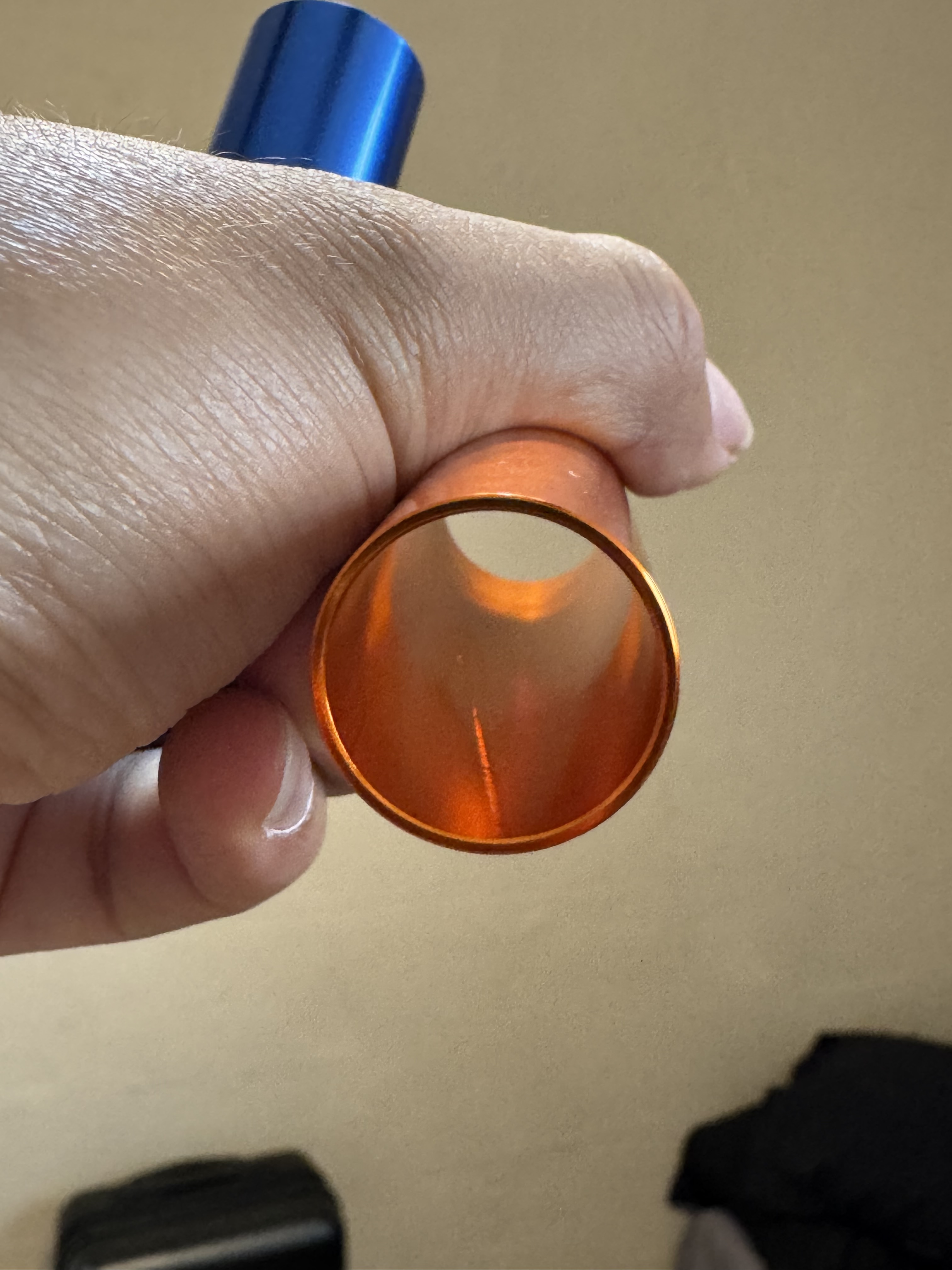

    Nova inserts aren't great quality either unfortunately. Either noticably out of round or a bunch of awful tool marks on the inner bore.
    Everything is still a thing
    • docfire
      docfire commented
      The out of round is due to NOVA slightly crushing them for their Helion (N3). As the N3 need s the insert to stay put when the barrel moves. I suggest buying the inserts for master sconi pb as he is the manufacture of these.
    • redsquirrel
      redsquirrel commented
      Same with the N1. Out of round on purpose. I’ve never had issues with the inserts.

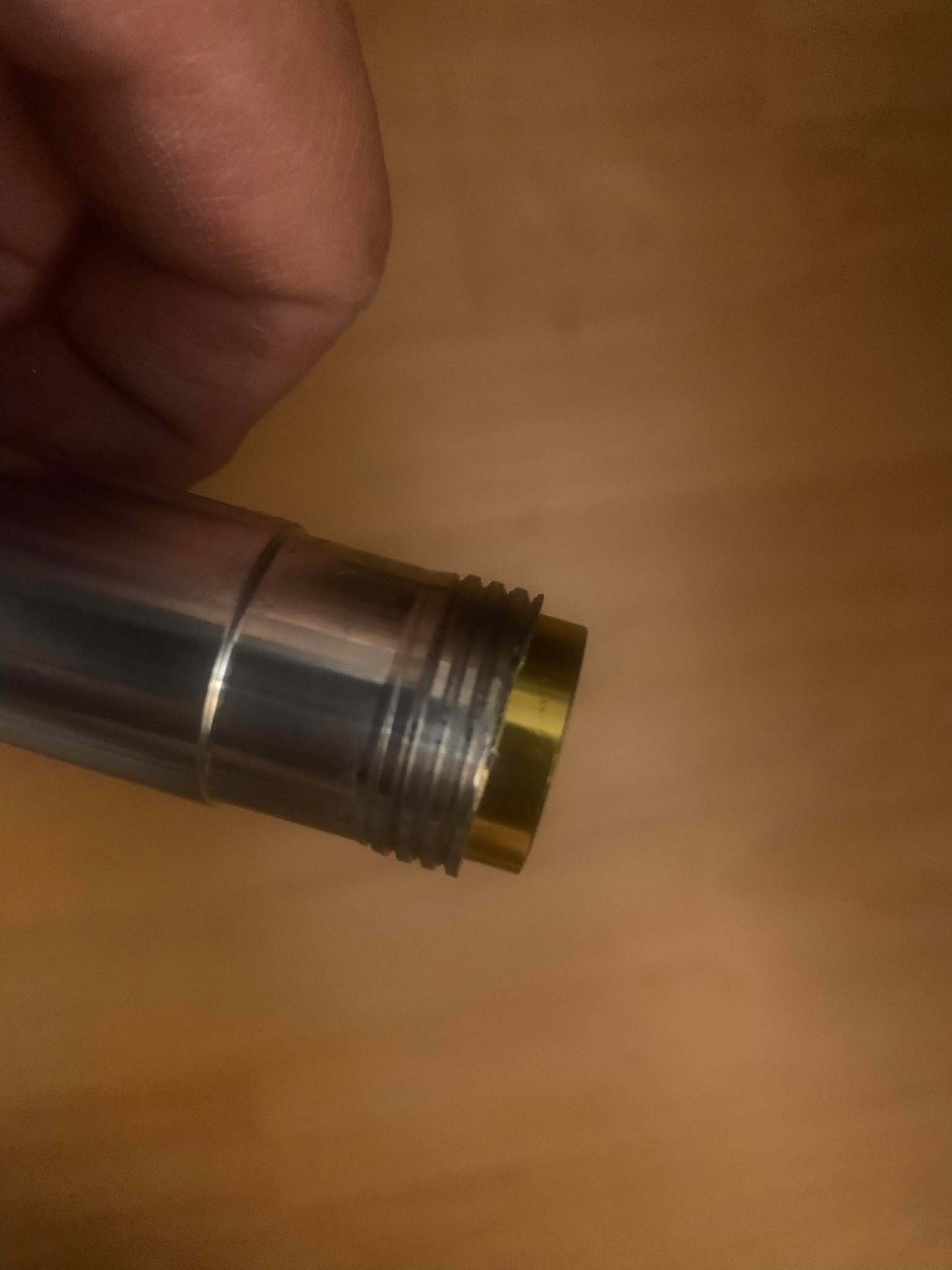

      Wait. These lines are normal?
  • BubbleHead87
    • Sep 2023
    • 88
    #124

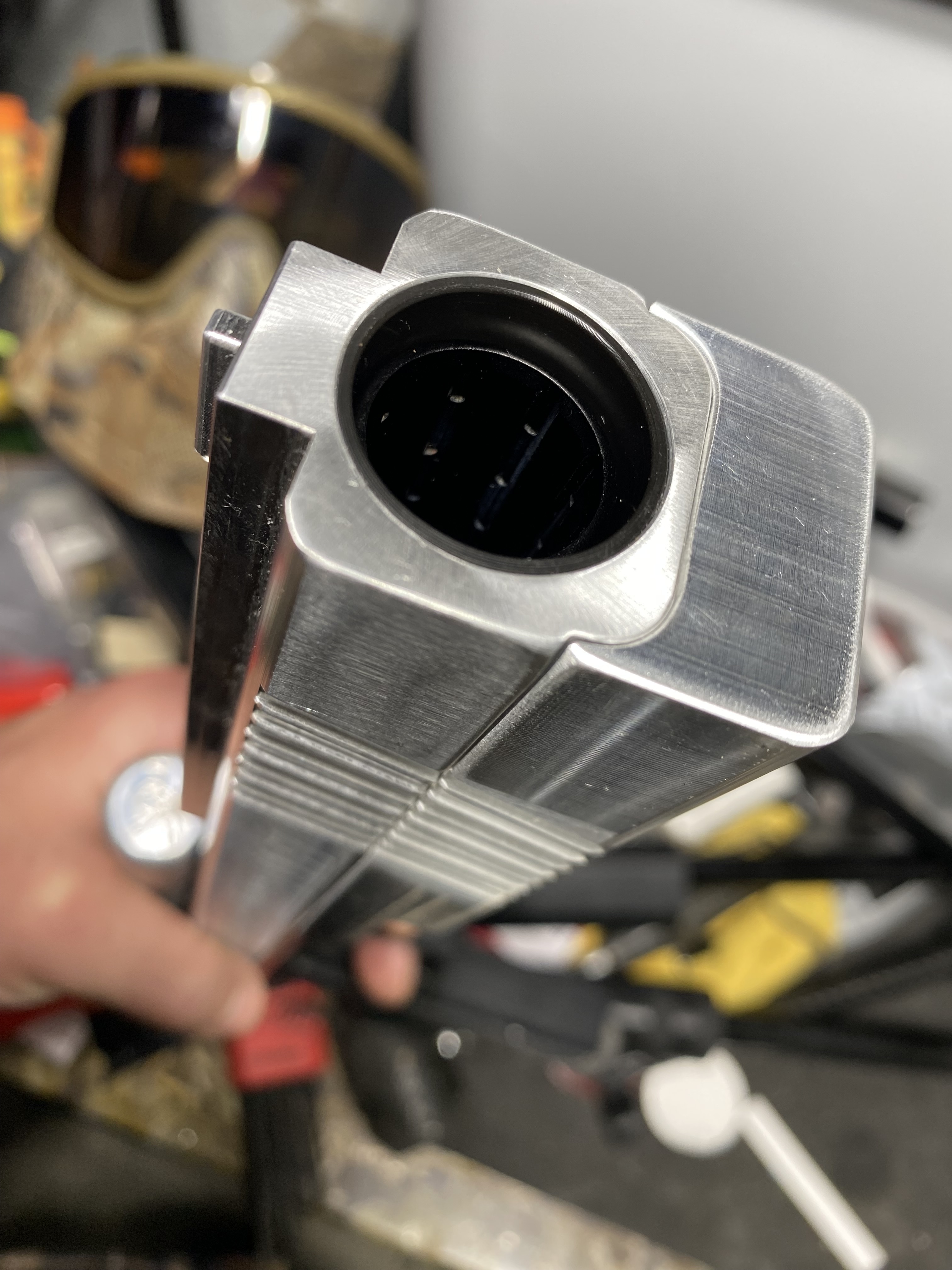

    These are normal?
    • redsquirrel
      Nope. I don’t have imperfections in any of mine.
    • BubbleHead87
      BubbleHead87 commented
      Roger. Trying to start the return process now. Hopefully they don't give me any grief or charge me restocking fees. 6 out of the 7 inserts have that line and the lip once barrel and insert is mated to the phantom body is off putting.
    • docfire
      docfire commented
      In reality the scratch will not affect anything it the paint shot. But its good you are returning them, as this lets them know of QC issue AGAIN!!!

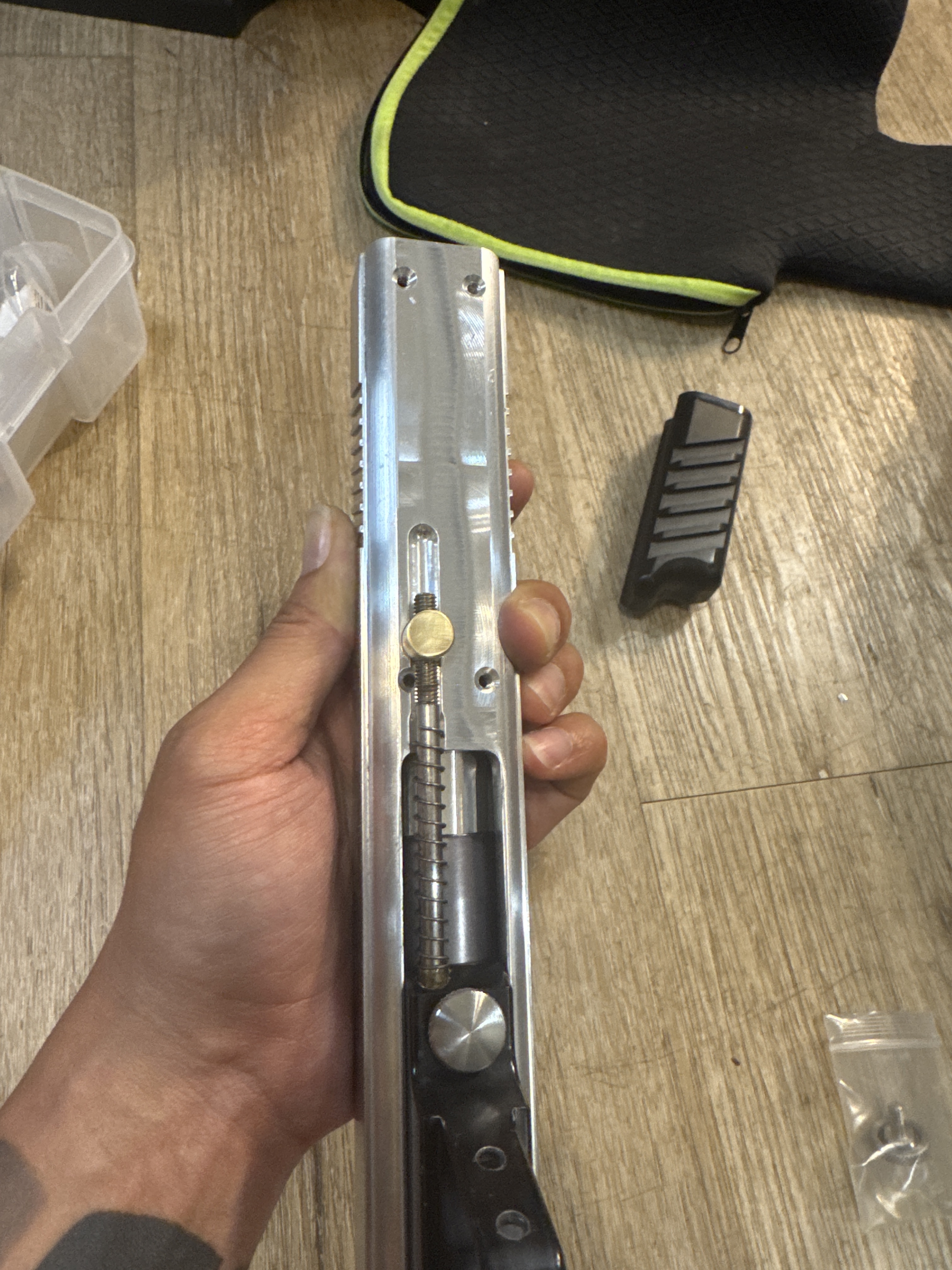

    Got my V2 slide in - Marked improvement from the original. The one thing I don't like is the factory CCI return spring binds like a mother when dry fit. I may have to find another washer or something to put that in place. I've been using return springs on my phantom for so long it feels wrong without.
      I didn’t even try the return spring. You might have to shorten it Murph.

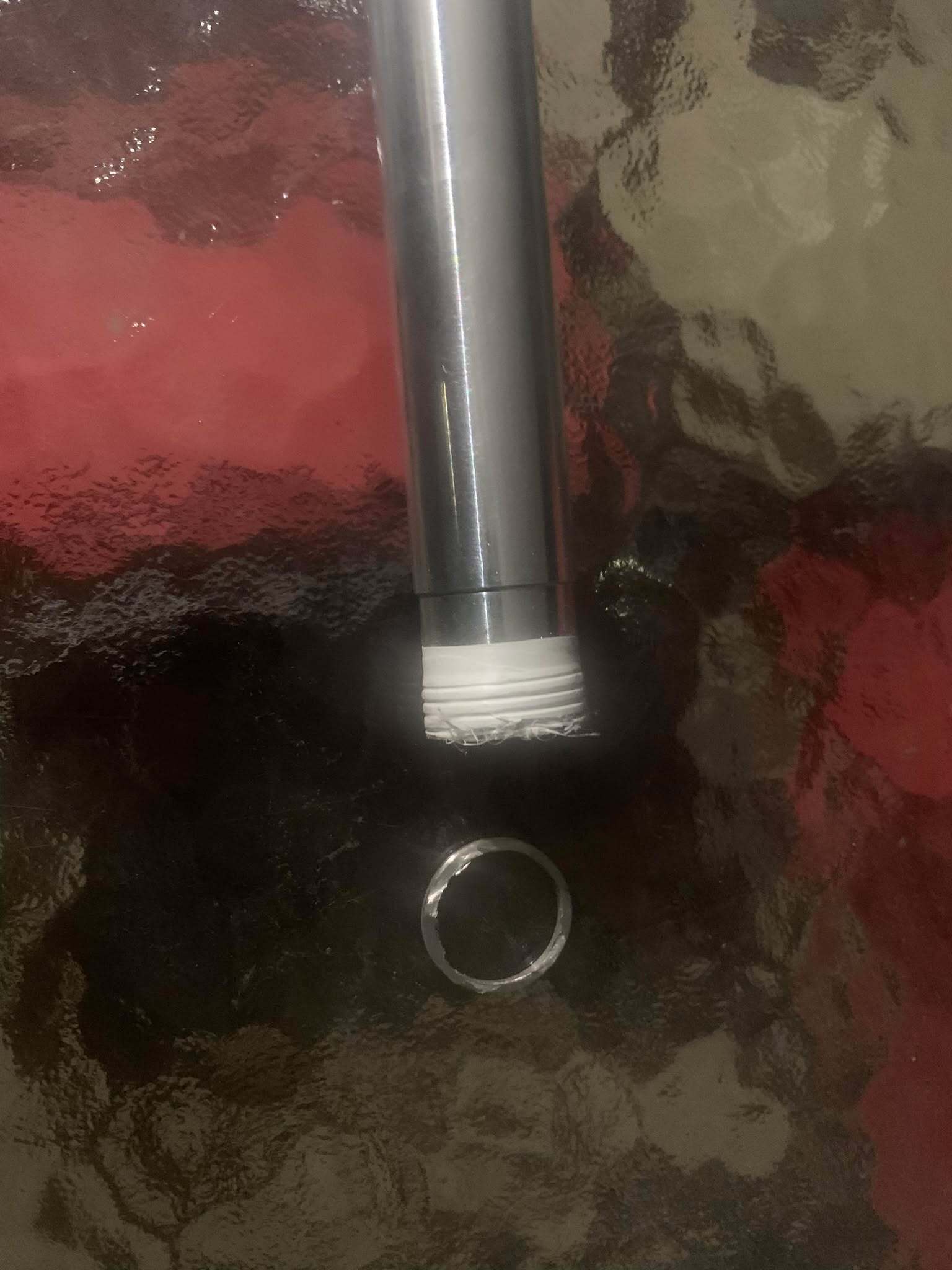

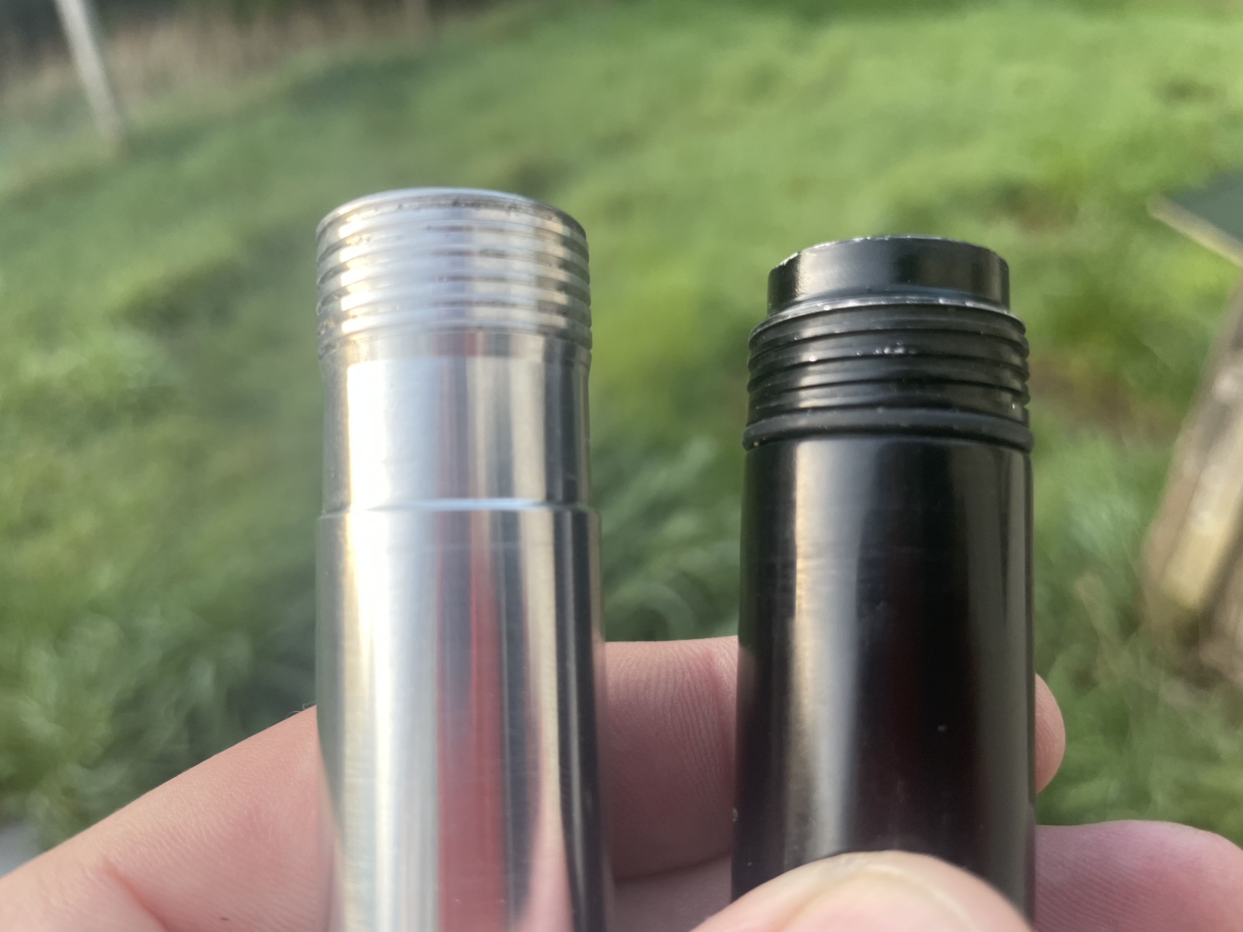

    Out of frustration and lack of patience in returning the item... I've decided to FAFO and removed some material from the rear of the Nova Phantom barrel. At first I was considering to modify some Freak inserts, but then it would be too much work shortening every size I wanted. So far, everything seems to work awesome after the modification granted now that my barrel is recessed into the slide more than it originally was. But for functionality, I'm ok with it.
      The stock 6” sits about the same distance from the end of the slide as well.

      #131
      The barrel is correct size at 6 inches, however it's barrel boring that was milled too deep where the insert is flush to the lip of the barrel back that causes the barrel to recess as it is. By me cutting the back to allow some of the insert being exposed allows the insert to rest onto the breech wall of the body so that there will no longer be any wiggle but of course that would recess the barrel even more. To be frank, I just didn't want to bother with the hassle with a return, from already an unpleasant situation with the v1 slide release. That said, I even kept the v1 because I didn't want to hassle with my slide having to go back and forth and potentially more of the same haha. But barrel works now, may not be pretty to some, eh... i'm ok with it I guess.

      #132

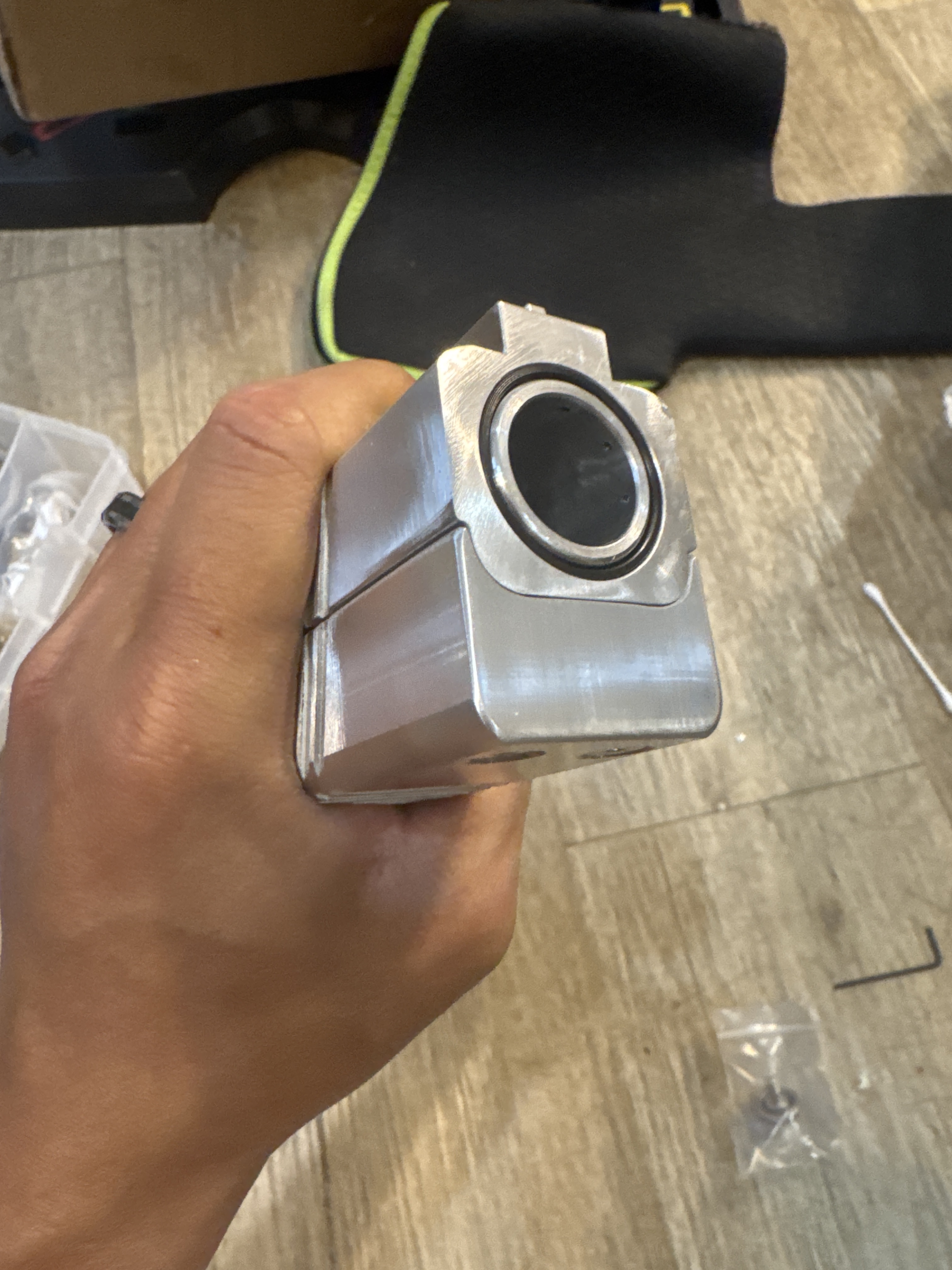

      This is how the barrel looked before being cut. There was still a slight recess with the barrel fully seated. If the inserts were slightly longer by maybe 1/2 inches then there would be enough material from the insert to rest unto the breech wall of the body if that makes any sense. The problem is, these barrels were bored too deep where the insert sits flush to the lip of the barrel

        • sonixr7
          sonixr7 commented
          By threading the pump arm further into the brass insert, I believe the barrel can be made flush. However, causing the slide to bind at the top of the breech.
      • BubbleHead87
        • Sep 2023
        • 88
        #134
        You can get it flush if you don't screw the pump arm all the way. For the most part mine seems to cycle fine unless I slam hard to the rear and it get stuck by my rear gauge on my bobbed valve.
