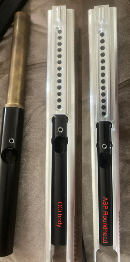

    got mine today.
    pretty sloppy work compared to the real deal.
    lots of "finishing" marks where they got too happy with the files. not just scratches, chunks deep enough to catch my fingernail on.
    some gaps and unnecessary cuts, no ribbing on the sight rail, and the cuts on the lower half of the grip are slightly off from the top.
    i guess for the price its fine. But its definitely more of a knockoff than a reproduction piece

      just checked and they widened the barrel hole for some reason. phantom barrels will have a pretty significant gap and probly be rattling around in there.
      hot dog in a hall way.
      my AA cocker barrel fits in there great but ASP roundhead bodies do not.

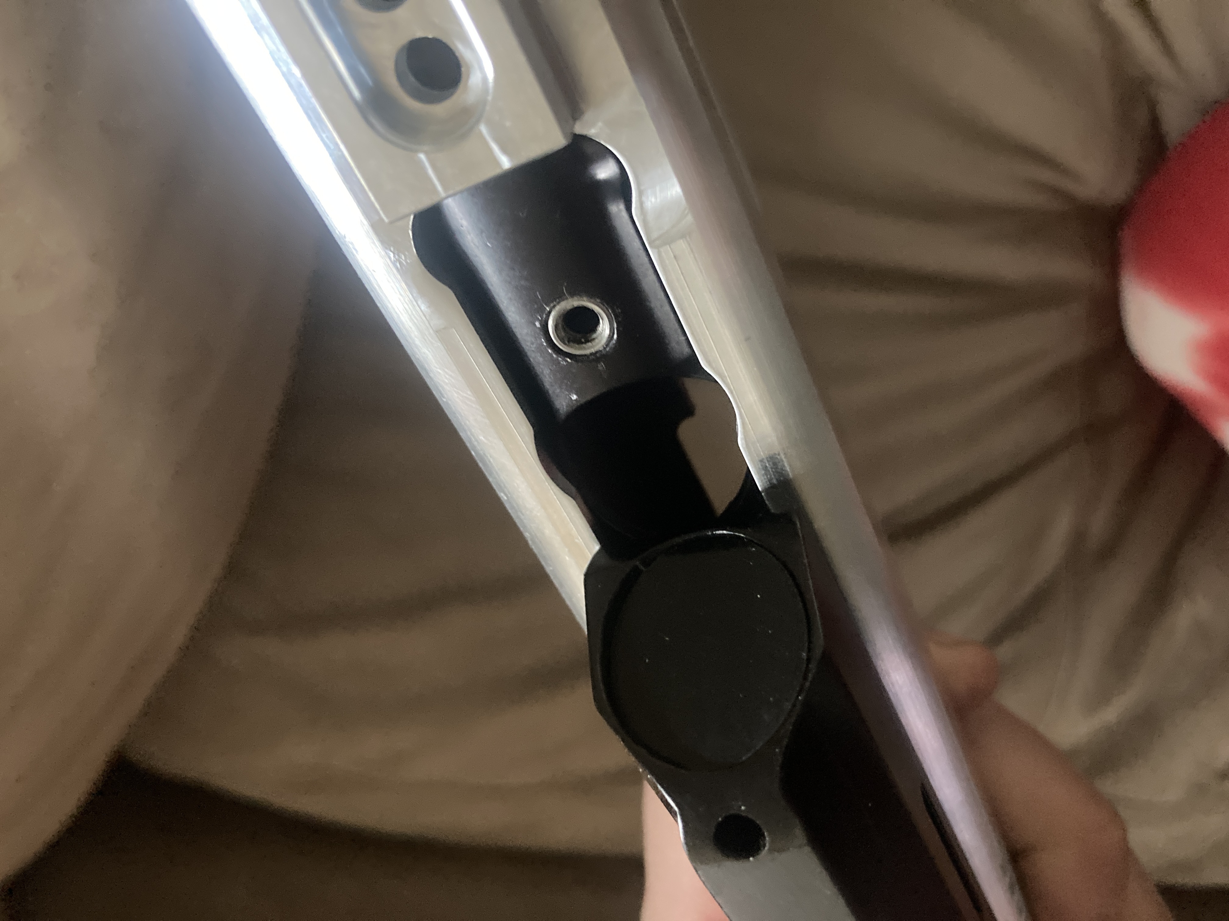

      just getting better and better.
      the slot on these is too small for cci metal feeds

        What are we thinking on fixes? I bet we could get a bushing 3d printed to fix the barrel slop pretty easy, but making room for the cci metal feed is gonna be a bitch comparatively
            I had Kit mill my Duckslide to have the feed attach directly to the body. I'd think that he or any other airsmith should be able to make the slot wider and get rid of the divots milled into the front of the slot.

            ok, so the Nova guys just called me and we talked for an hour on FB Messenger Audio.
            The widened barrel hole is "so they can fit a variety of aftermarket barrels."
            Me: Phantoms are not autocockers. There are a few other brands and sizes but the overwhelming majority of folks will want standard size.
            Nova: " That would be too expensive. We are keeping the bigger size."
            Me: The feedneck issues
            Nova: Totally our fault, we will fix anyones slide if they need it widened.

              Roundhead with cocker barrel works in my Duckslide, not in the Nova unit

              so, there is a single goober on FB that is crying about not being able to use his with a hopper.
              now they are telling him the new run will be cut for that.
              im trying to convince them that 99% of folks do not want that.
              lets see how it goes...
              Riot, not great news.
              Nova: "All nova slides are built to looser tolerances to smooth out the pump stroke and accommodate any variance in the size of the parts used underneath."
              Me: No, all the bodies/valves/frames/barrels anybody will be using with these will be extremely close in size.
              The original Duckslide was a great success partly due to its tight tolerances and the consistency of one phantom to the next.
              so, I just put mine together with internals and everything and the play at the barrel is almost just as bad. and theres wobble down the whole length.
              to them, excessive scratching and rattling around is a feature, not a flaw.
