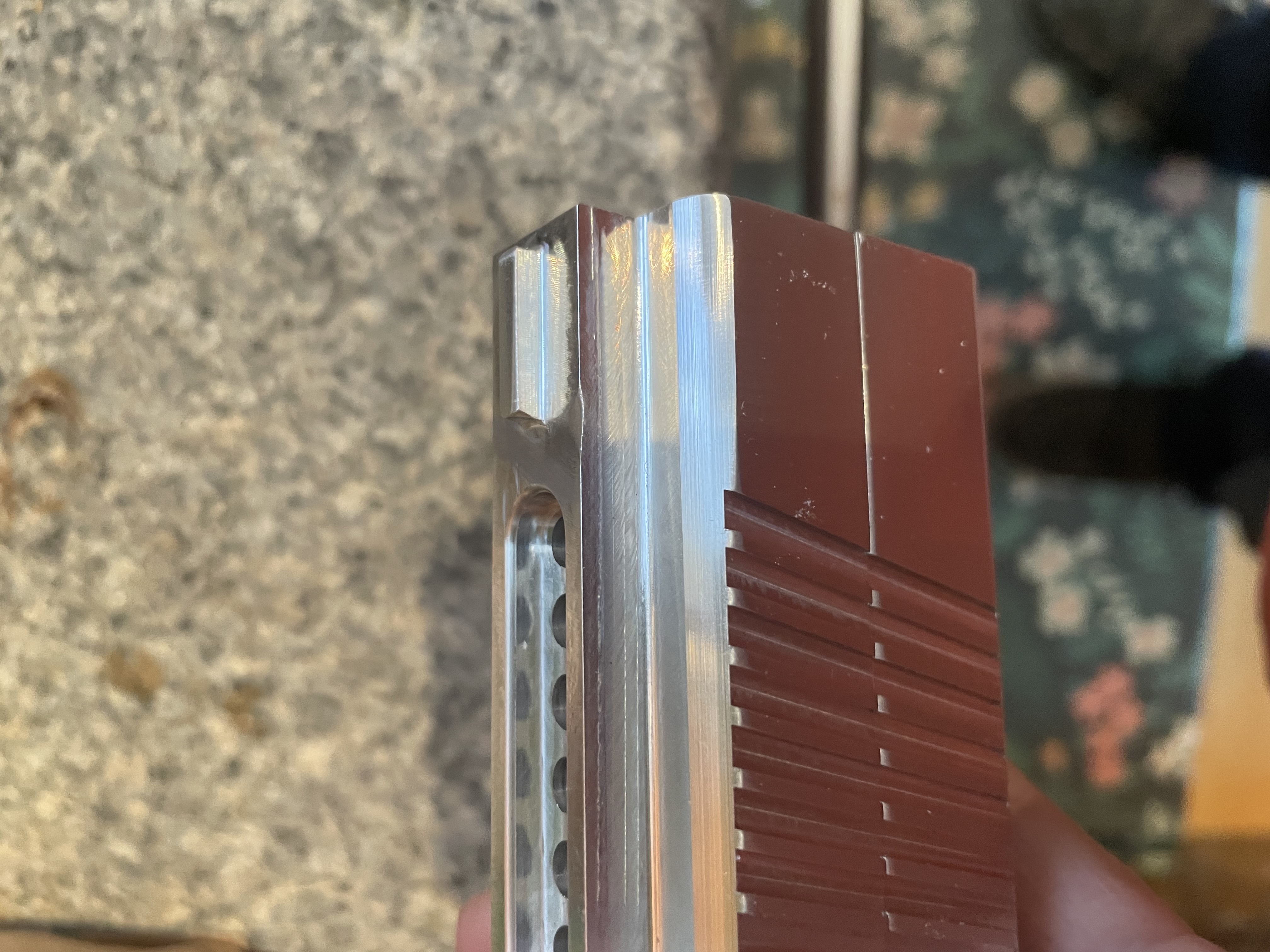

    Another thing I noticed on mine was the lack of finish work inside the slide where the barrel goes. The holes on the top of the site rail and the threaded holes holding the bottom pump portion of the slide together all have small burrs protruding into the slide ID. So if someone gets their slide and tries to fit a larger diameter barrel inside, be careful, it'll scratch the hell out of your barrel without sanding those burrs off first.
    I'm fine with mill marks on parts, but burrs on a marketed drop in ready part isn't cool.

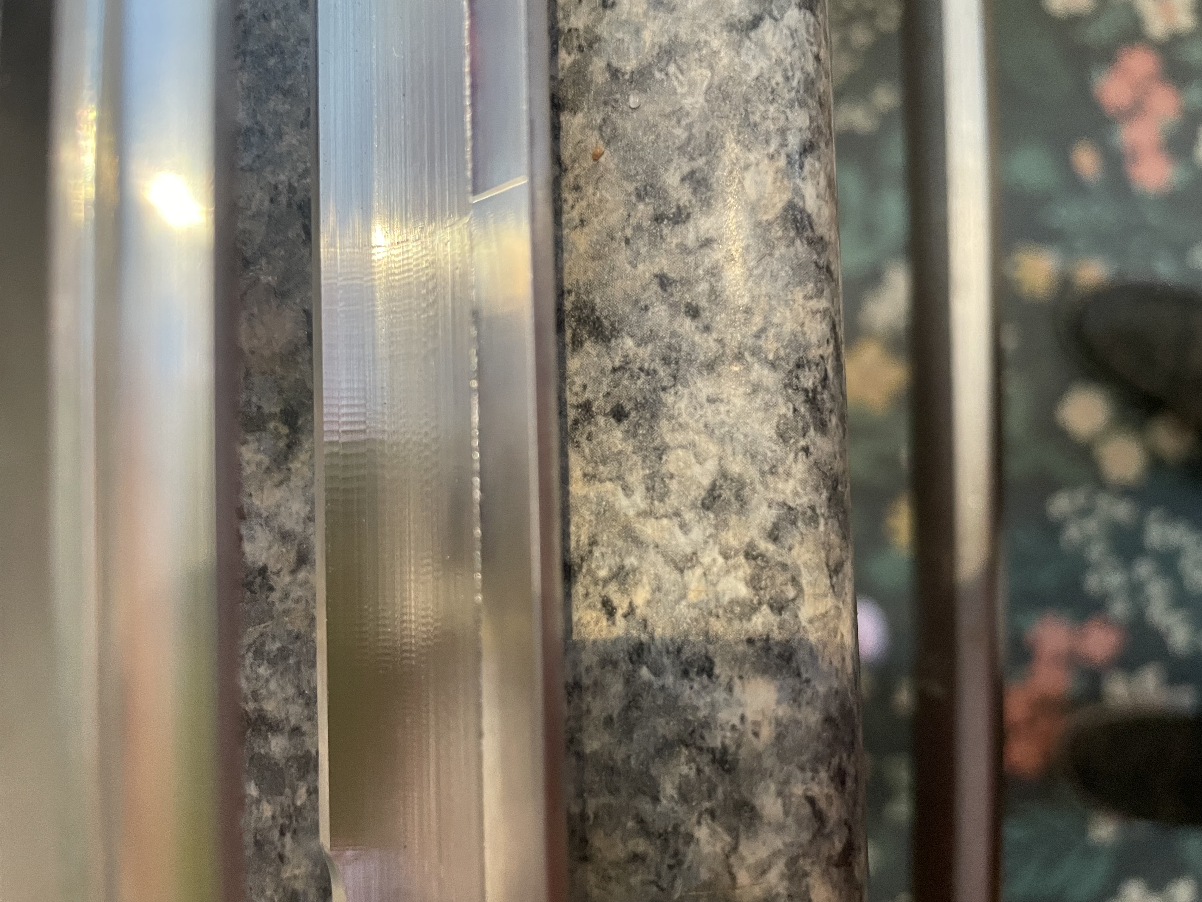

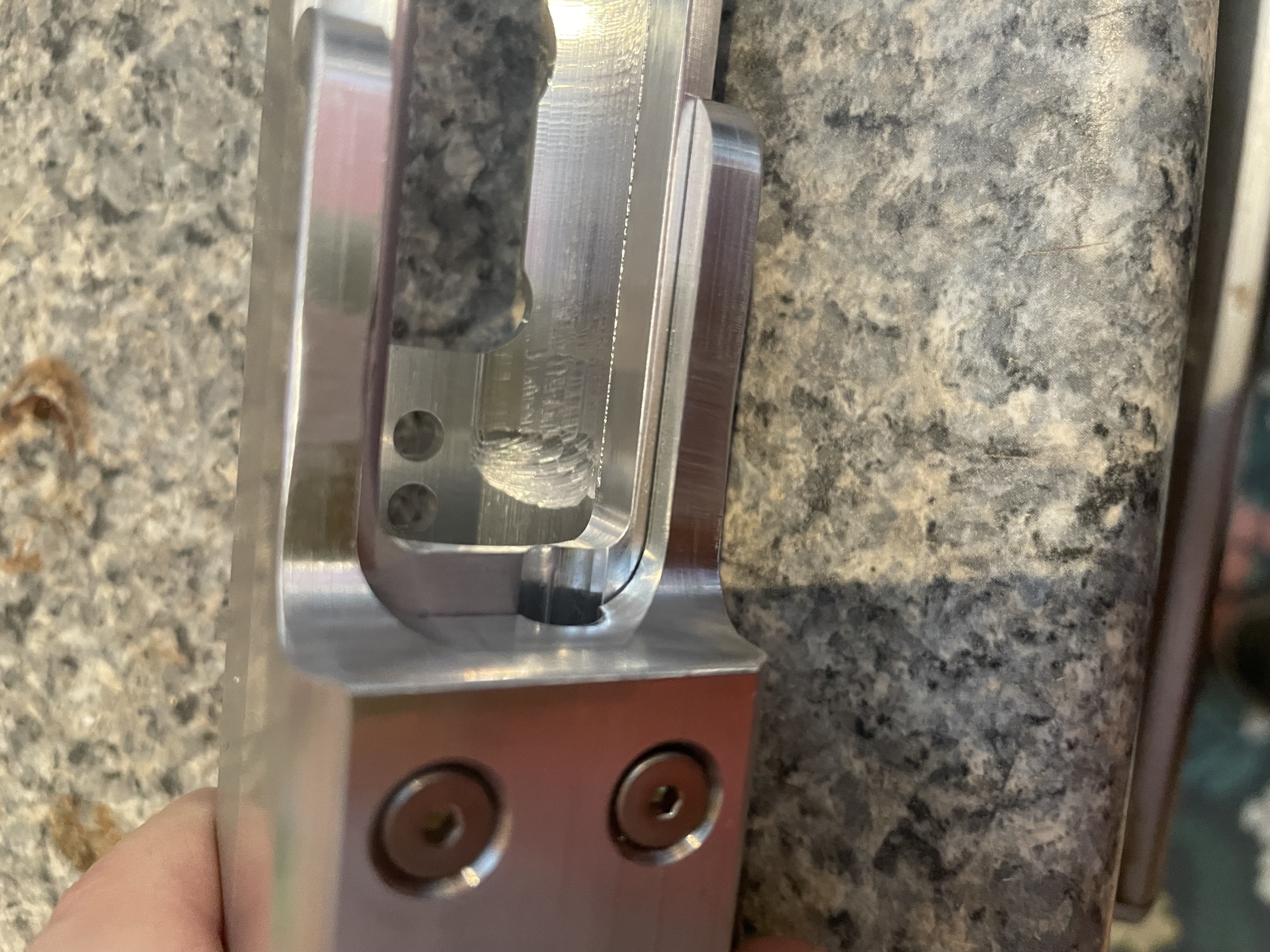

    Mine showed up. There are some very rough cuts, large burrs and surface defects. I may have to find an airsmith to clean it up before anodizing. Wasn’t expecting master craftsmanship but this is still not something I am happy with.
      I feel like it can be saved but it’s not a drop in peace that’s for sure. It needs more work to be right. It’s definitely ruff from an anodizing standpoint. I plan on cutting one up anyway to make it my own. Can you measure the ID of the barrel opening? I wonder if a Doc Bull Cocker barrel will fill the hole if you make room for a round head body.

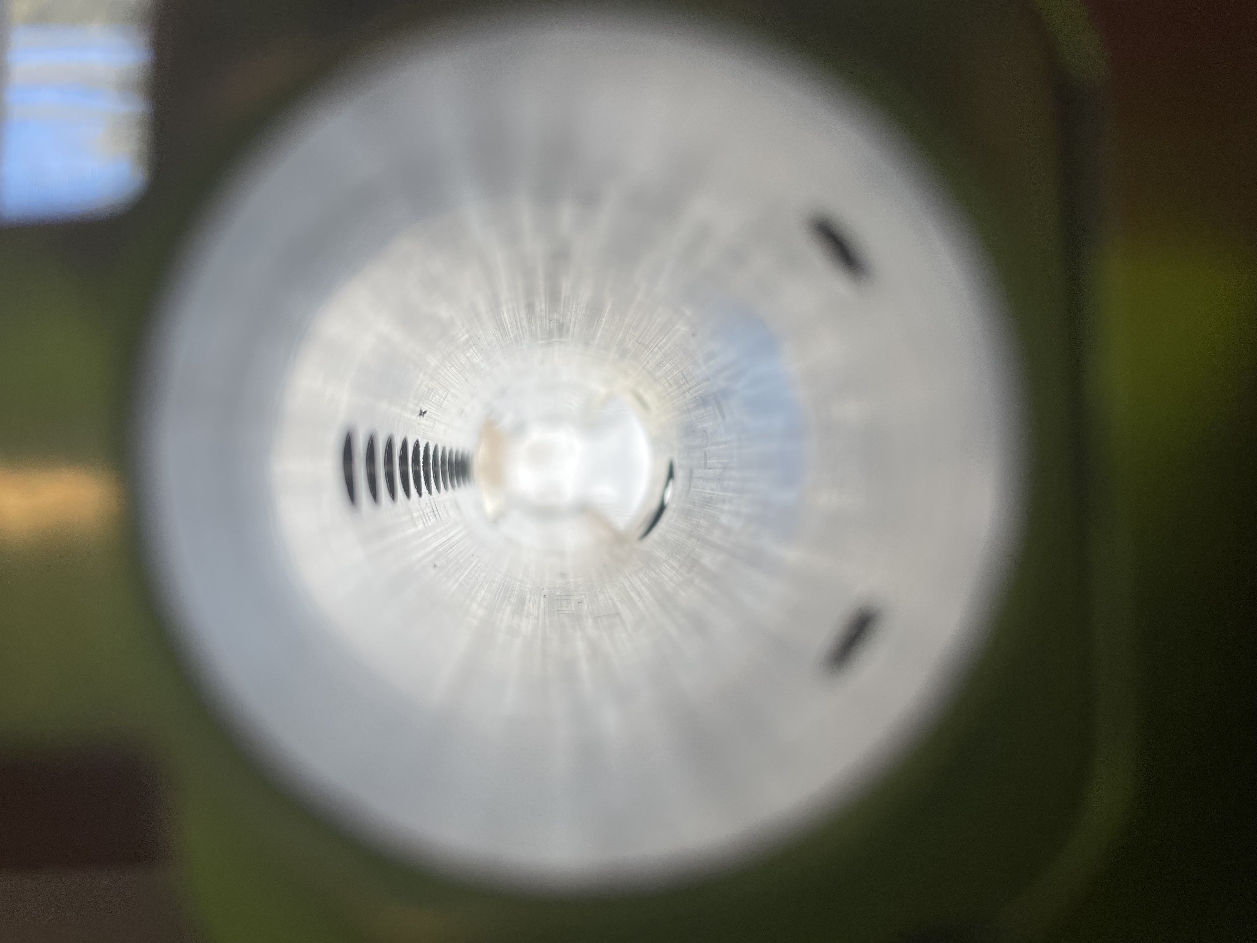

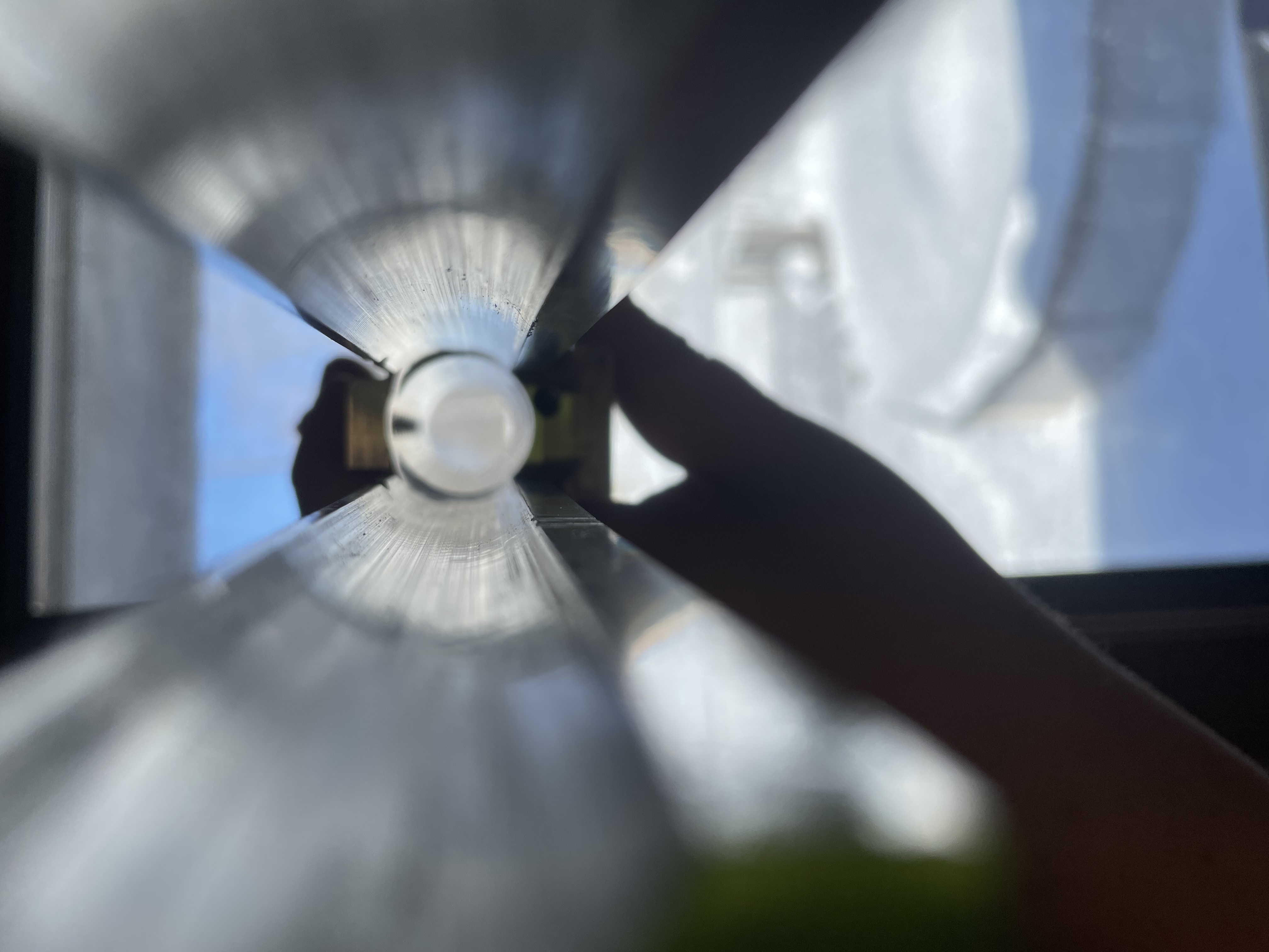

    The bore pictures chuck e ducky asked for

    Chuck E Ducky
    barrel-body not the same bore. close but the barrel is tighter slightly

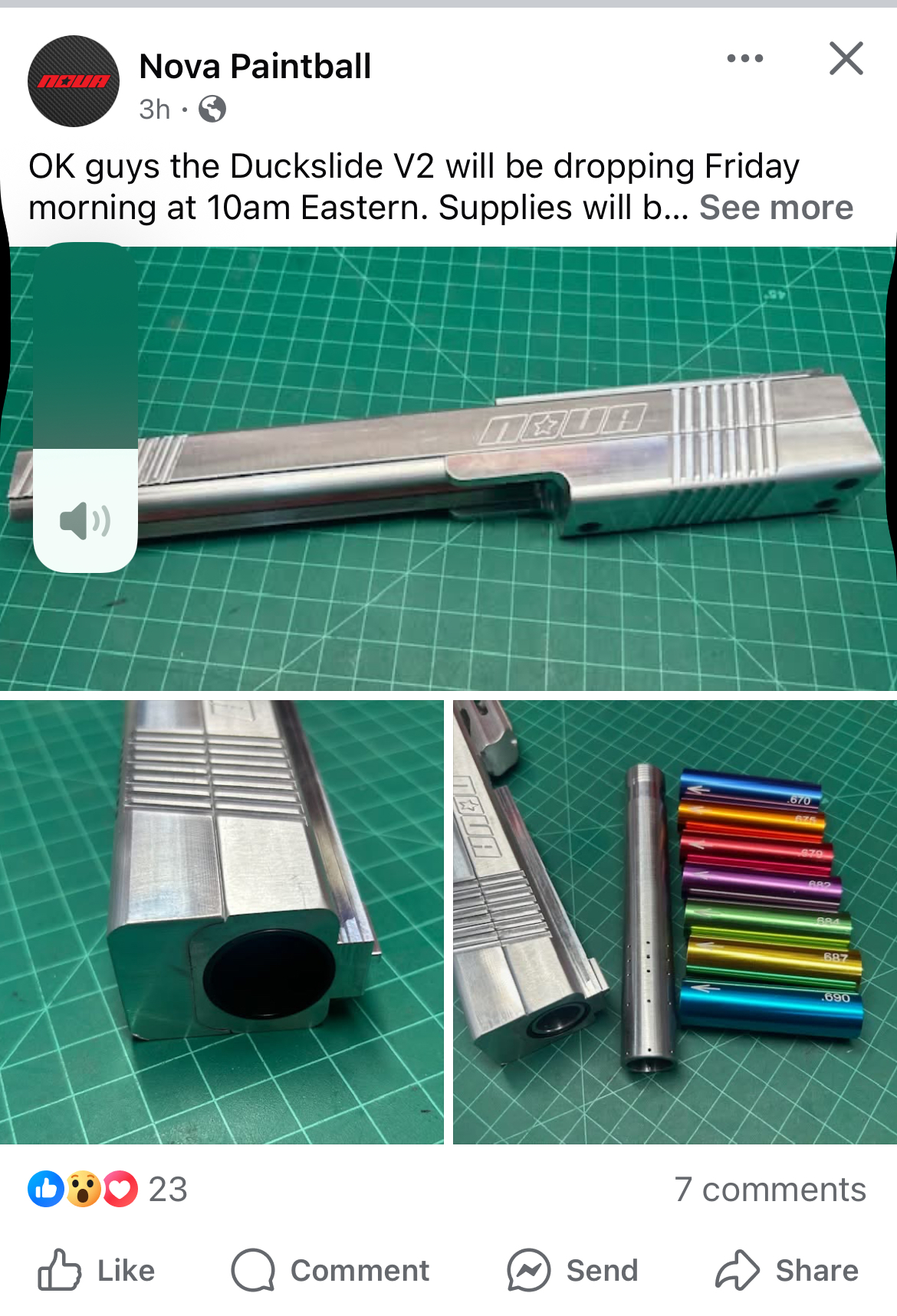

        Here's what TJ posted a few days ago
        image.png​
          I’m using a different feed that don’t need the clearance for my build if you want to sell it Moo
          XEMON commented
          They had a chance to redeem themselves, but it seam they are shooting themselves in the foot ...
          Are they expecting their customer to pay for return shipping for an item that doesn't work as intended?
        • Super Nova
          Super Nova commented
          They didn’t say anything about covering return shipping when I called so yea as far as I know it’s on us.

        They are releasing a version 2 of these.

          Everything I’ve heard is that they’ll be including a delrin sleeve with the v2 to get rid of that slip slop.
          WTB Acid Wash Phantom Parts
            Good that will save us the trouble of figuring it out ourselves. That 3D printed option seems to work well. The picture Cuda just posted looks like it has some kind of an insert.
            Delrin would have good wear properties if the tolerance is good.
            iamthelazerviking commented
            They also have a fatter barrel with their inserts
            They say what the price will be for that

          Looks like they changed the end of the slide too.
