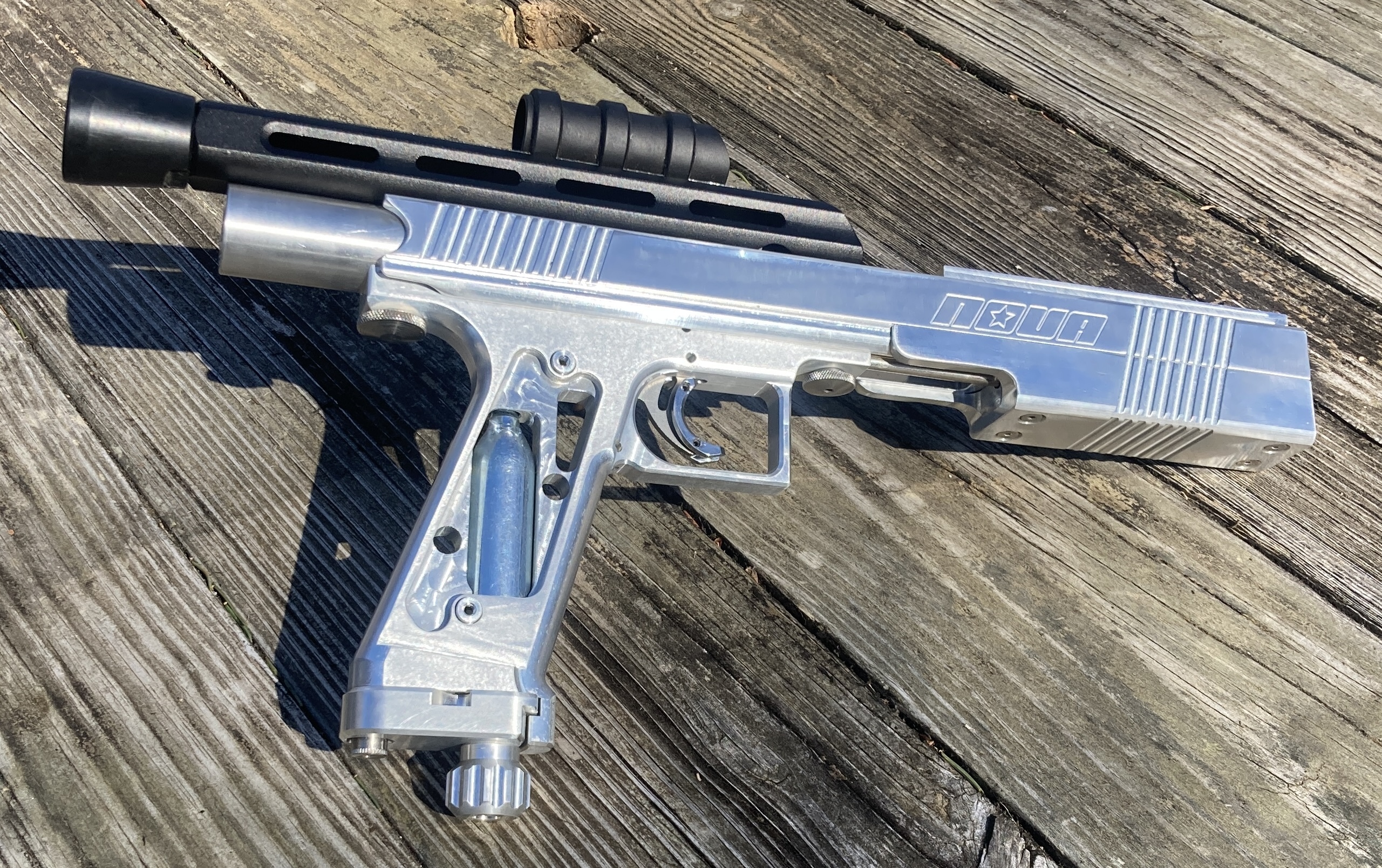

          Magageddon got a pretty crooked hole drilled in the insert with his

          A little comparison video you can watch to see the wobble on an actual Duckslide.
          https://m.youtube.com/shorts/QF77M4g211k

          Hopefully this can help some of you that bought one of the Nova slides or Nova can use it to fix their mistake.
          The slot on my slide is 13/16” wide. A CCI 1 piece feed will fit.
          This is the barrel clearance of a CCI barrel in a Duckslide. The hole is a hair over 7/8”.
          Red One

                    It would be fairly easy to fix the issues at hand on the V1. A Delrin bushing would do wonders for the slop. Or clearance the slide at the back to fit an ASP cocker body and use a Doc Bull Cocker freak barrel. I’m planning on using a different feed anyway my round one would fit that slide easily as is it’s much more low profile then the CCI one.
                    Hopefully, they can get it squared away and the spec right. I will buy one if they can get it right.

                      just sold this. Made the buyer aware of all the issues.
                      Hes having me send it straight to BMC for a delrin barrel bushing.
                      will report back how it goes!
