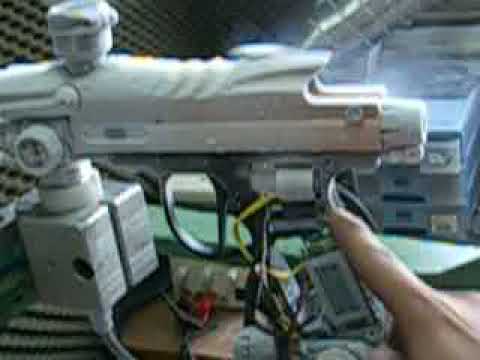

                  I recall once seeing a video Michael Spurlock once posted of an Odyssey O2 or some similar Spyder-bodied FASOR that had no LPR and used one of those clapper-solenoid 3-way valves that was supposedly left running full auto at 50cps for 48 hours and was still cycling. Really wish I had saved the video.
                  Holy cow, I found it!
                  Was backing up some very old pictures from DVD-ROMs I had kept and ran across it.
                  Welcome to 2005!
                  • glaman5266
                    glaman5266 commented
                    That's pretty insane. No LPR, clapper-operated 3-way, 50cps for two days straight (minus the thawing periods). Just wow.
