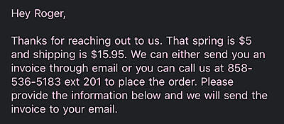

      I somehow mangled a spring, probably when installing a cap while the valve body was still inside the marker. Dye wanted almost $21 for it. I laughed then bought a bag of 10 for $7 shipped off Amazon.
      I’m all about supporting paintball companies but that’s a bit much.

      • Killshot_Kustoms
        Killshot_Kustoms commented
        $5 for a spring isn't bad at all, the cost of shipping is what it is. They have to have someone process the order and package it (who is probably $15-17/hr). $15 for shipping is pretty standard.
