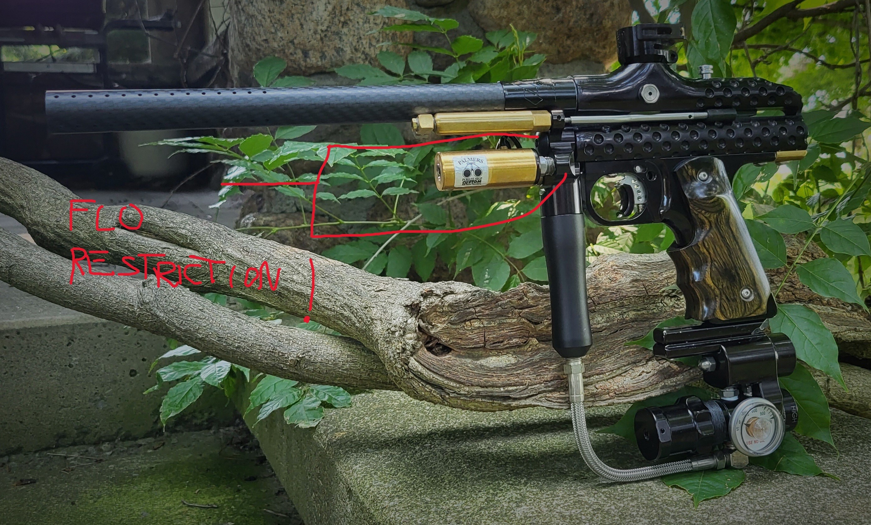

      Originally posted by docfire View Post
      I had a ID front block with a non ID banjo restrict flow to the tune of 20FPS. And withe that large volume chamber front grip if restricted it will make that usless.
      I'm not doubting you when I ask why, just can't wrap my head around it. Why do you think that is? (The banjo part.)
      And God turned to Gabriel and said: β€œI shall create a land called Canada of outstanding natural beauty, with majestic mountains soaring with eagles, sparkling lakes abundant with bass and trout, forests full of elk and moose, and rivers stocked with salmon. I shall make the land rich in oil so the inhabitants prosper and call them Canadians, and they shall be praised as the friendliest of all people.”
      β€œBut Lord,” asked Gabriel, β€œIs this not too generous to these Canadians?”
      And God replied, β€œJust wait and see the neighbors I shall inflict upon them."
      • tyronejk
        tyronejk commented
        If that front grip is a large, empty chamber, having a restrictive banjo bolt would effectively split your firing chamber into two sections. Since the time available to dump all that air out the valve is so short, the effects of any restriction would be magnified.

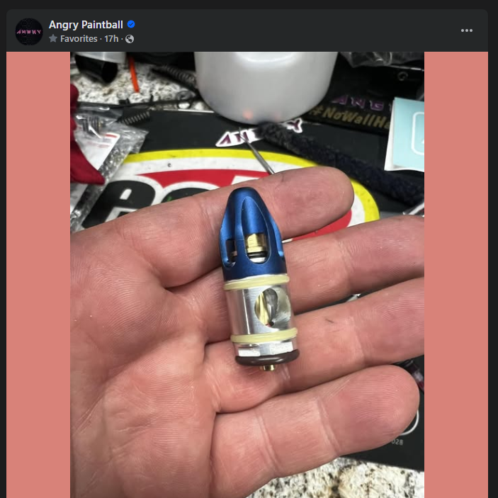

        New from Angry PB
        • docfire
          docfire commented
          I call it FAFO. if your don't FAFO you don't learn.
        • latches109
          latches109
          commented
          I science all the time. The air will quickly decelerate there, I will be curious to see what happens if he matches the body and bolt all the way through.
        • SR_matt
          SR_matt commented
          Based on his video it seems that you can gain either lower operating pressure OR a lighter main spring which will reduce the trigger weight before the sear releases the lug. He used a .031" spring (I believe the normal springs he runs for the JC/stock Laz is .038) and it was working at normal operating pressures. when he went up to the .035" spring he was able to drop operating from 200 to 170 (I think that was the change). I am not sure if he was running the test with a modified bolt but he did post a teaser pic of a milled out bolt (I believe a ST) where the little diffuser in the front was removed and the port was opened up.
          So basically it seems that we are hitting the 80/20 rule. 80% of the improvements have been hit with 20% of the work (just trowing in a lab and JC), now we are at 80% of the work to get the last 20% out (major modifications to body/valve).
          He is going to be doing some pull tests with an actual pull weight tester to show really what the difference ends up being. It will be interesting to see what the actual results are, and I hope he also shows the pull differences between other mods (such as a traditional slider, ST gunfighter with and without ATTKTX plate, with and with out his HOG tuning, and stock vs polished lugs).
          Maybe the mod will be worth it or maybe it will really just be a tiny improvement that a few people really desire... if it gives a measurable improvement and is ready in the next couple of months I may consider doing it for my new build as its already taking forever so a little more time may not be a big deal.
