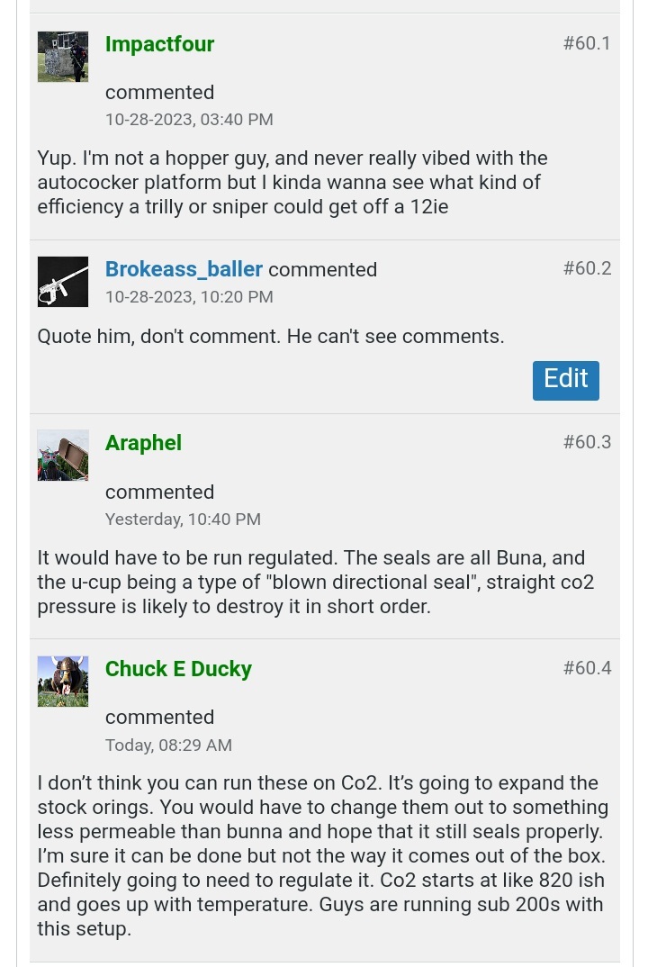

      Originally posted by Trbo323
      Anyone have any efficiency numbers yet? Specifically around 12g.
      Thinking of putting one in a empire sniper
      ​​​​​​Since you can't see the comments on your last post.
        Thanks for doing that. If I know there are comments I can go log in on the Web page version. So no need to take screen shots.
        I'm not worried about the rings. Technically I'm not supposed to run the empire sniper on co2 either and yet it works just fine.
