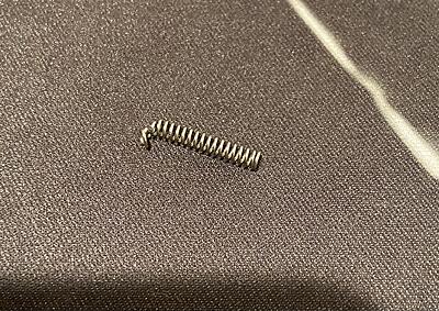

    They’re about 1mm longer but feel like the same spring rate force. I don’t foresee having any issues but will let you know if I do.
  • superman
    commented on 's reply
    Do you have the spec for the spring you ordered?
  • Roger7pball
    replied
    I somehow mangled a spring, probably when installing a cap while the valve body was still inside the marker. Dye wanted almost $21 for it. I laughed then bought a bag of 10 for $7 shipped off Amazon.
    I’m all about supporting paintball companies but that’s a bit much.
