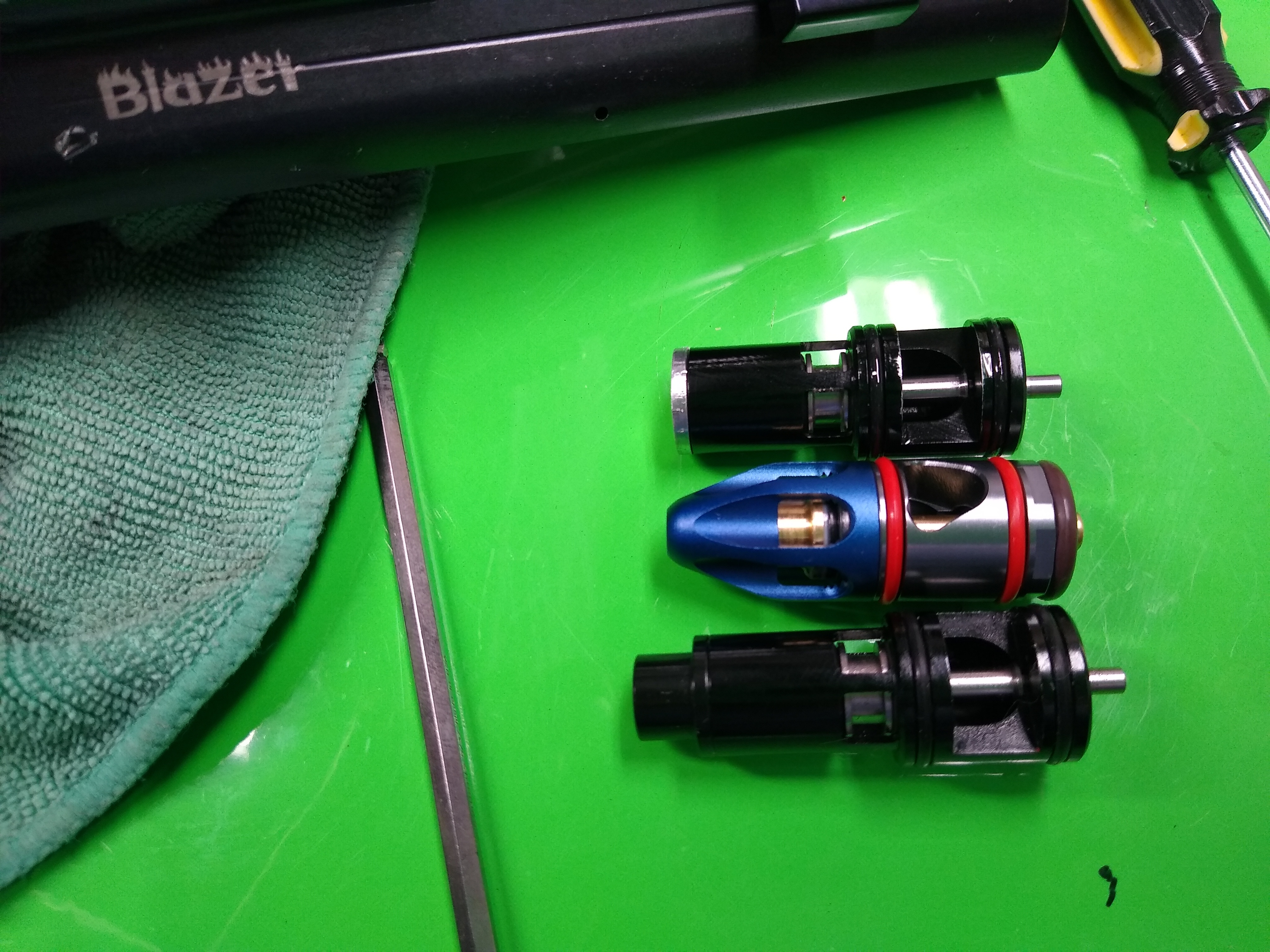

  • Kit
    replied
    I received mines and decided to shove it in my modded Blazer. Click image for larger version
ID:	460150 Click image for larger version
